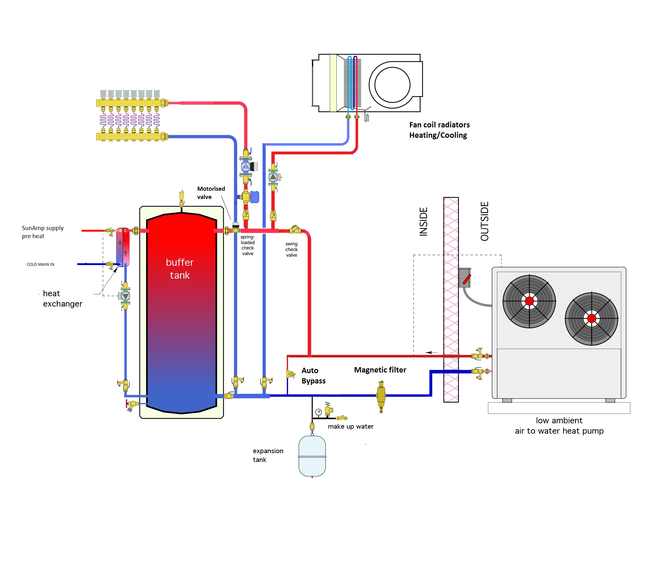

Bumping my old thread as i am starting the plumbing for the Heating and cooling.
I have looked at the examples others have used plus some detail i found on the web
Below is my first draft design
Its based on a two pipe system for a buffer tank with the two spare bosses used for the pre heat for the sunamp
Can anyone see anything that would cause problems?

Get the DHW preheat as an integral coil!!!!!
PHE and pump / flow switch = PITA.....losses......complexity......grief.
Good point, Nick, but I'd do it the other way around - spec a buffer with a solar/heat pump coil and leave the PHE as is.  The big advantage is that you don't need to fill the buffer tank with very expensive antifreeze/inhibitor, only the relatively low volume heat pump and coil circuit.  The buffer can then be filled with cheap standard inhibitor.

Regarding the magnetic filter I would leave it in. A few ashp installation kits from manufacturers come with a magnetic filter.
Good point with ashp coil/heat exchanger to cut antifreeze/inhibitor!

Thanks for the comments everyone. I am stuck with my buffer tank so it was the best option.
The design allows isolation of the buffer tank when cooling so it could still be used as a heat dump for excess PV to pre heat the sunamp.
Any thoughts on this isolation. i was going for a set of either motorised valves or two manual valves. I  have noticed that i need to add a small expansion to the water heating side to manage expansion when isolated.
Other option would be to swap the bottom valve with spring loaded or swing check valve that should allow expansion but prevent the cold and hot mixing.
I do have an issue with space so one expansion vessel would be preferable.

I used a single motorised ball valve to isolate the buffer tank from the ASHP when it's in cooling mode, just where you have one shown.  I chose a motorised ball valve rather than a conventional motorised valve as I wanted to be 100% sure that it would seal when  closed.  Having looked at the inside of a conventional motorised valve I wasn't 100% convinced that it would be a 100% seal, and as even a small amount of chilled water seeping past into the buffer would cool it down a bit, I opted to use a ball valve that I was confident would be a 100% seal when closed.
You could use a manual ball valve, but you'd be operating it a lot in warm weather, when you want to keep the buffer tank warm for preheating hot water but also want to have the floor cooled a bit.
Thanks for the tip.
Looking on my normal places that i buy parts they are quite expensive do you know a cheap supplier that may do them
I have tried to keep my system as simple as possible.  So for example, my 230V side is isolated from from the low voltage stuff by using some Crydom SSRs. This enables my Sparky to raise his Cert to keep BControl happy.  I haven't added any extra valves in my system since they weren't needed, but I will need at least one extra if I add an ASHP.  As to extra expansion, why not just add a trickle bypass and avoid this.
good idea thanks
Hi Jeremy,
Just to clarify your thoughts on the above,
you would recommend a coil for the circuit from the A2W to the buffer tank but you would leave the PHE in place and feed directly off the tank. in that case you would only need Glycol in the heating loop.
So a tank with a single coil would do the trick?
Is your thinking on this that the PHE would be more efficient at exchanging the heat than an internal coil or is it just
Just flicking through this again, and agree on the coil if wanting to reduce the A/F volume, but it would still be better, IMO, to have DHW via a ( second ) internal coil rather than a PHE. Accepting that @dogman has already got his buffer, this can now simply be for reference for other readers.
The next issue would be down to the size of there vessel and just how much coil can be physically fitted inside it, so at that point you'd probably be into a 300L buffer. Not a problem afaic as its low temp storage so lower losses, and id want as much DHW preheat volume as possible ( to get as much of the bathing temp DHW from the HP as possible eg at the lower cost of producing it ).
Current one I'm speccing will be getting a 250L buffer heated primarily by an ASHP, which will be providing DHW preheat for a Sunamp PCM58. Just finalising a decision on the best option for isolating the A/F and primary water bodies. 2 more paracetamol and ill crack it :S

2 minutes ago, Nickfromwales said:
The solar coil would be too low IMO, particularly at the low temp the buffer will operate at, to be fully extracting the heat out at the rate it would be consumed, assuming max ( typical ) flow of 15-20 l/p/m.
So use them the other way up... ST coil to put heat in at the bottom from ASHP, std coil to draw it off for preheat...

To summarize (I think as the SunAmp PCM34 cells aren't available, even though I have 2), you want a cylinder with 2/3 coils:
image.png.c5e2cfc495529b9eae7742ba7c880c14.png     image.png.b308039d673415a3e1589a8f019feb69.png
Then it depends how you plumb it together.  (I would consider 3 coils as at the temperatures this will operate at you need maximum surface area so run the two coils (upper and lower) in sequence.  At a ΔT of 5oC (ASHP normal) you will only get about 5kW from these sort of coils so use two and/or increase the ΔT to 10oC.
Option 1: (Minimises Antifreeze in a Monoblock install)
  • DHW from the DHW coil.
  • ASHP from the other coil(s).
  • UFH from the tank.
Option 2: (Maximises recovery rate)
  • UFH from the other coil(s).
  • ASHP to the tank.
Option 3: (Maximises DHW pre-heat flow)
  • DHW from the tank.
  • ASHP to the DHW coil.
Option 4: (Install a Split ASHP, professional installer required) only DHW coil required as ASHP and UFH can share inhibitor, no antifreeze required.
  • DHW from coil.
  • ASHP and UFH to tank.
Note you only need a professional installer for the refrigerant connection between the internal and external unit. A local refrigerant engineer did this part for me, relatively low cost. The rest is no different than a monobloc install from a "special skills" perspective.
I feel this is a better solution than monobloc. No need to add glycol (which is not a trivial or cheap option if the volume is large), no need to check or top-up glycol, no need to replace glycol every x years.

Ive spoken to Telford to address this and I think there is some middle ground.
Where we are all looking at the buffer tank as, for eg, a 200L buffer then the assumption is that there will be 200L of A/F ( antifreeze solution ) to factor in. Not always the case ;).
If we are to accept that the buffer, in a particular instance, is primarily for cold mains uplift aka DHW preheat, then there will be a whopper of a coil inside the cylinder consuming a large amount of the total cylinder volume. In the case of my current enquiry, around or just over ( TBC ) 50% of the cylinder volume will be occupied by the coil. So, for a 250L buffer, <125L will be A/F. The benefit of having the ASHP to the cylinder ( aka tank ) is it can get all its heat into the cylinder as quickly as possible. Going through a coil isn't as efficient so as this is not just a buffer to prevent short cycling ( eg a much smaller cylinder ) I've looked at maximising heat transfer from ASHP to DHW pre-heat. To get that, somethings gotta give.
My thoughts then turn to the UFH and how to glean heat without having to have A/F in that system too. "Stick another coil in the buffer" I hear you cry, but alas, no room exists inside the buffer now as to get any meaningful uplift from a 250L vessel stored at ~40oC you need a bloody huge coil. It just about leaves room for 1 immersion heater ( 3kW or 6kW ), so where does that leave us? Before anyone asks, a smaller cylinder or smaller coil is a waste of time as the uplift wouldn't make it worth the bother, so 250L is the starting point IF you want to lean heavily on the ASHP at high CoP for DHW production, and also remember that part of this remit is to avoid G3.
From the ASHP I am looking into the pros and cons of fitting an oversized PHE inline with the flow. As its oversized ( to get a top through-flow rate on the primary side ) it should not impede upon the flow velocity of the ASHP pump and not impede upon water circulation to the buffer. So that gets us an A/F rich primary flow that goes from the ASHP to the PHE primary side ( PHE flow ), then it comes out of the PHE primary side ( return ) and then on to the body of the buffer to heat that. Im not bothered about recover / reheat times as this will purposely be set to come on and stay on during occupancy. The benefit of this setup will be no need for an additional pump / flow switch as the UFH manifold pump will simply draw heated water from the PHE as its required.
The other option is Teeing the UFH PHE across the ASHP flow and return.

Oh, and that image in the last but one post shows a TS which I recon will be at least 450 / 500 L to get all those coils inside it and for them to be of any meaningful capacity.

As an alternative you could charge the TS via a PHE from the ASHP (no AF in the TS) , UFH from TS, it however requires an extra pump but you get the rapid recovery due to the PHE!
