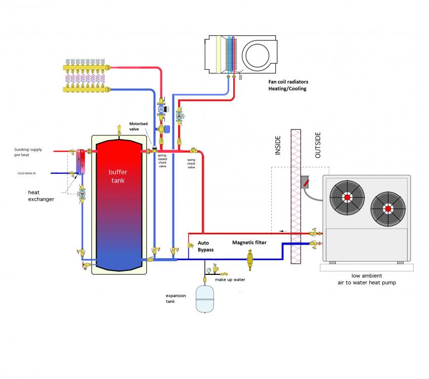

Nickfromwales Posted March 15, 2017 Share Posted March 15, 2017 Buffer tank with a coil is best imo, but @JSHarris has made clever use of convection to preheat his PHE so there is little / no delay in producing cold mains uplift to his SAPV's which is exactly what I would recommend ( if the DHW manifold / distribution point is any real distance from the uplift buffer. Remotely mounting the PHE closer to the manifold location could also be negated by having a buffer in the airing cupboard and also locating the DHW manifolds there. Latent heat loss would be minimal, but useful too then. I cannot see the point / need for a pump to circulate beteeen the buffer and the Ufh manifold. The manifold pump will suck that through with ease unless it's a massively long and complex pipe run. The biggest problems I've had is stopping unwanted ( summertime ) convection circulation from the ( TS ) buffer to the Ufh manifold ! The bloody things pull through without even turning the manifold pump on . That I dealt with by means of a 2-port zone valve, also a requisite if you intend to circulate the Ufh water for solar gain absorption and redistribution throughout the slab, e.g. flow but no heat input. Whovever said these haven't pulled through on their own, I seriously doubt. Link to comment Share on other sites More sharing options...

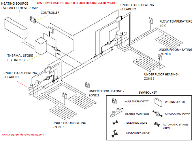

dogman Posted March 15, 2017 Author Share Posted March 15, 2017 trying to get my head around this found this on line Taking into account that this is probably two floors so you can discount zones 3 and 4 from what i am trying to establish This shows a heat pump pumping into a TS or BT. A pump with bypass valve it then goes to the zones where there is a motorised valve a blending valve then the manifold pump so the system has three pumps This is what i understand to be a blending valve set Will one of these pull water from the buffer tank if they do why have a pump at the buffer tank? Link to comment Share on other sites More sharing options...
TerryE Posted March 15, 2017 Share Posted March 15, 2017 @dogman, I used a Wunda pumpset simply because it was the cheapest way to buy the pump and connectors. If you look at my setup then you will see that I have a TMV blender but since my circulation is always cooler than its minimum setting, it will always be open. I have a PHE for a different reason, but this could just a easily be used to link in an ASHP. Also read my blog post on heating the slab and the linked Boffin's corner article. I currently use an immersion heater in a Willis jacket for heating my slab. IMO, if you aren't using the buffer to preheat the DHW, then you don't need one unless you have a gas boiler. You can modulate the output temp of the ASHP down to room temp + 7°C say and at this temperature you can pump the headt directly into the slab and use the slab as the buffer. Link to comment Share on other sites More sharing options...
Jeremy Harris Posted March 15, 2017 Share Posted March 15, 2017 1 hour ago, TerryE said: You can modulate the output temp of the ASHP down to room temp + 7°C say and at this temperature you can pump the headt directly into the slab and use the slab as the buffer. Not that easy, I'm afraid. Anything lower than about 30 deg C causes the heat pump to cycle too much and it will probably go into anti-short cycle mode, staying off for 15 to 20 mins even when there's a call for heat. Heat pump life is closely related to the number of start cycles, rather than the run time, too, so excessive cycling is quite likely to cause early failure. I tried to run ours into the UFH only and ran in to this problem, which is why the logic in our control system now automatically turns the valve to the buffer tank on whenever there is a call for heat. I think it's probably good practice to treat heat pumps like boilers, and try to arrange to run them for as long a period of time as possible when they turn on, and then leave them off as long as possible. Our 6 kW to 7 kW ASHP will modulate down to about 1.5 kW output, minimum, and that is usually far more than the UFH needs. 1 Link to comment Share on other sites More sharing options...
Nickfromwales Posted March 15, 2017 Share Posted March 15, 2017 (edited) I'd 100% be using the ashp for DHW uplift. Why have such a good resource and not use its full ( good CoP ) potential? A buffer with DHW uplift coil ( so actually a TS ) is a no-brainer afaic, unless you have a good PV array where the argument becomes less one sided. With a typical target 'set' buffer / TS temp of 40oC, and showering requiring 38-40oC max, most of your DHW production can then be from low grade / high CoP heat energy, rather than having the ASHP running in DHW mode, at 55oC, with zero or negative CoP. Edited April 18, 2018 by Nickfromwales Good CoP instead of low CoP.....D'oh! 1 Link to comment Share on other sites More sharing options...
