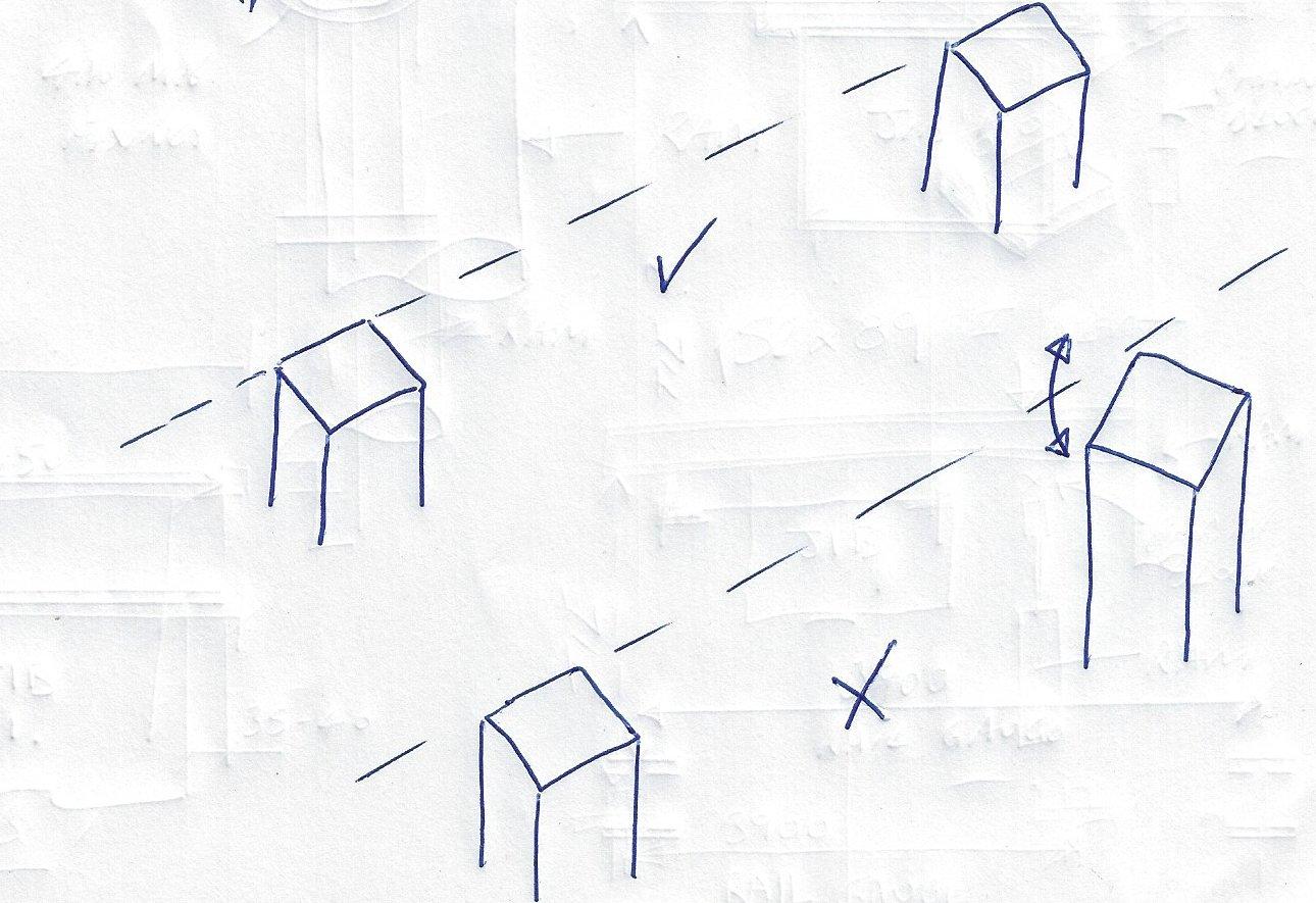

Onoff Posted August 26, 2021 Posted August 26, 2021 Also worth trying to ensure that your eventual 2 posts will be parallel to each other and not twisted. Just put a string on the one you're doing now and drag across to roughly where your other post will be: 1
zoothorn Posted August 26, 2021 Author Posted August 26, 2021 @Onoff hi there Onoff, yes good points. Im doing the line by eye admit to site the 1 st post that is.. looks pretty good. If this one is a mite twisted 'back' it could benefit the gate opening a bit past 90*: was my thinking: ie slight 6" more space on drive when opened fully. But i will use a line for siting Post2. Tbh i dare not whack my stones down now.. i might bodge it up. Thanks zoot
