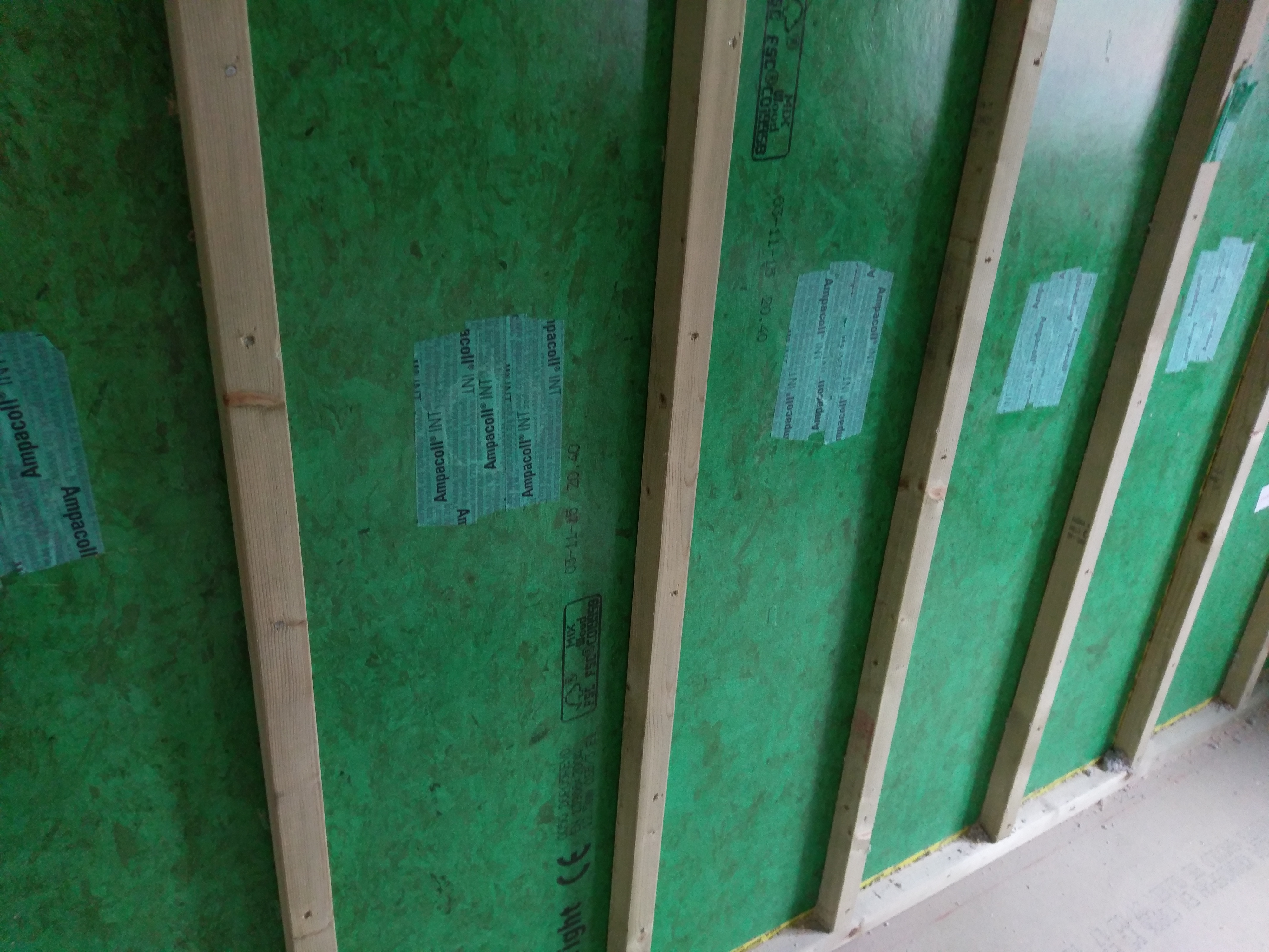

OK so my certificate arrived from the air test people and it's now 0.39 as they had the wrong volume in the program

I'm guessing that this is the Part L1a figure, which is m3/m2 internal surface area/hour at 50 Pa pressure differential, rather than the far more sensible air changes per hour figure that everyone else in the world seem to use................

I was discussing air tests with my builder. His 2 semi detached houses he recently built were 3.6 or 3.7 I think. He had to deliberately make them a bit worse otherwise mvhr would be needed which for some cheap semis in Hucknall would be an eyebrow raiser. I'm glad I picked him to do our work. Yes ideally they would be more airtight and mvhr used but the plans didn't have it included.

figure is . 0.39AC/HR

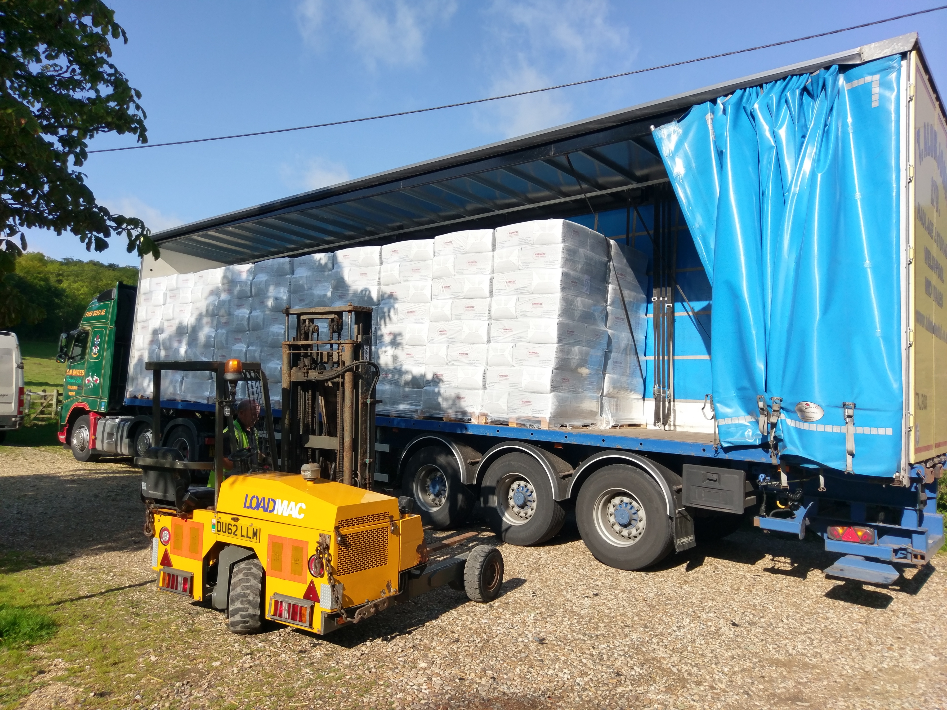

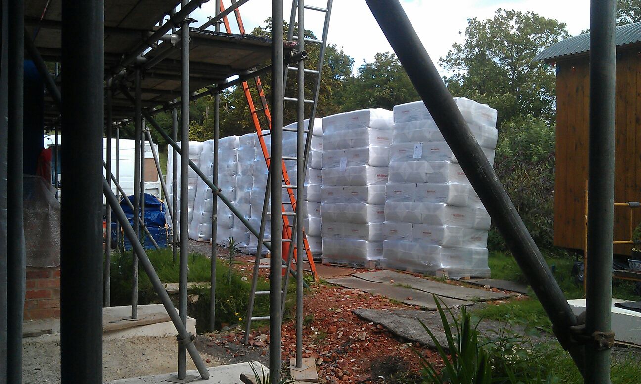

Following on from the air test the insulation guys turned up.
Now I know they said there was a lot but an artic load
After Three days still had all this left for the roof.
599a9602149d7_fac67c99-3399-41da-a661-2be4e3f0b542(1).thumb.jpg.257d5ccadbaa8dd30d7f3ff36f53d970.jpg

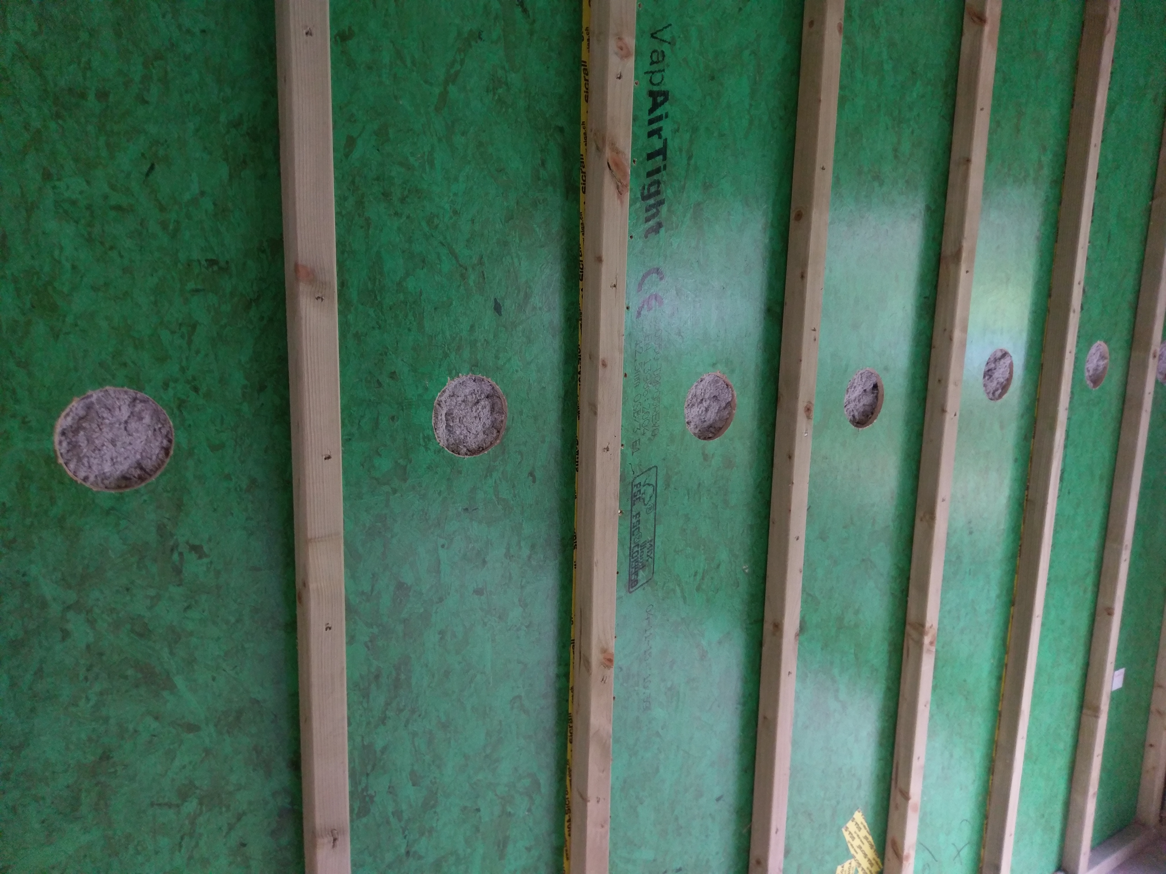

The machine that blows it in is in their van with one person loading, and another with a long hose filling.

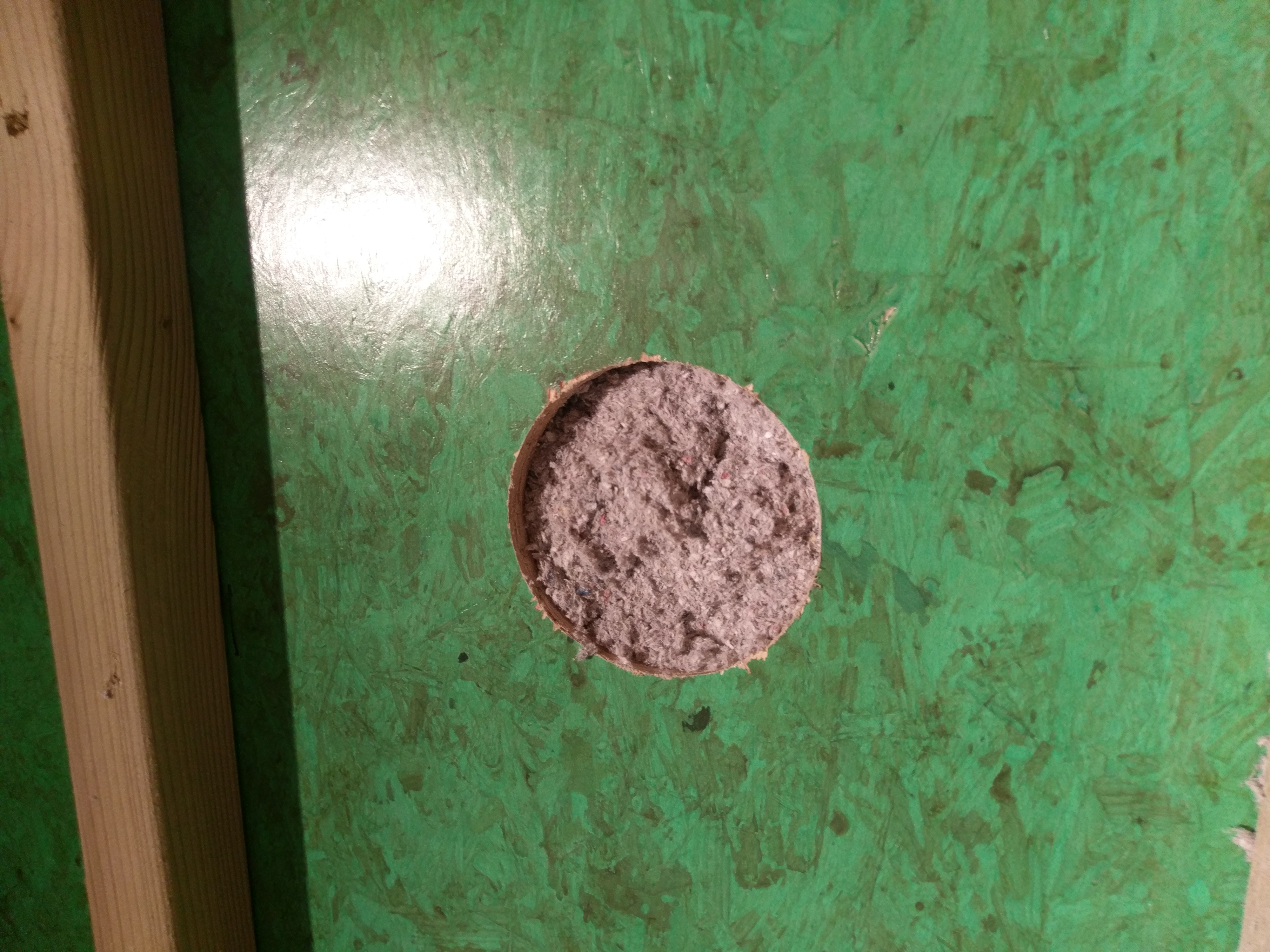

Holes are cut with saw and filled, plugged and taped.

Crickey. How big is your house?
I hope they don't think they'll be delivering mine on an lorry that size. It will take them a long time to walk it down a bale at a time :D

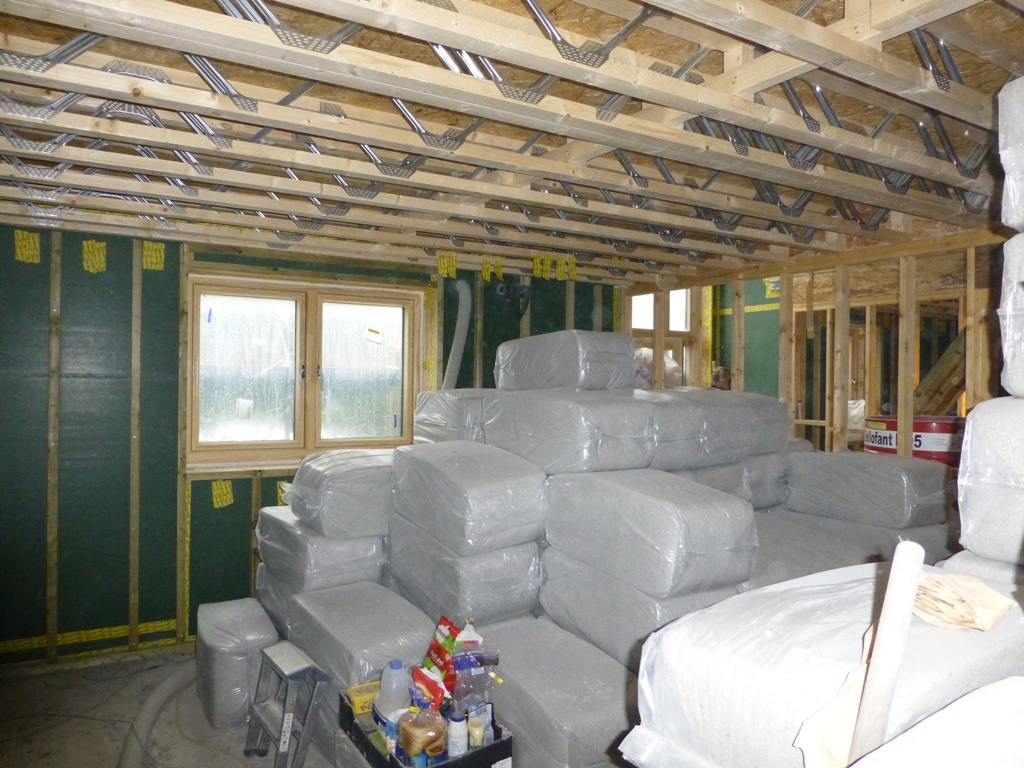

I was a bit taken aback by the sheer volume of warmcell that arrived to insulate our build.  I think we had two trucks a bit smaller than that artic, as there wasn't room to store the stuff.  This is what our kitchen/dining room looked like not long after the first truck load was delivered:

Posted

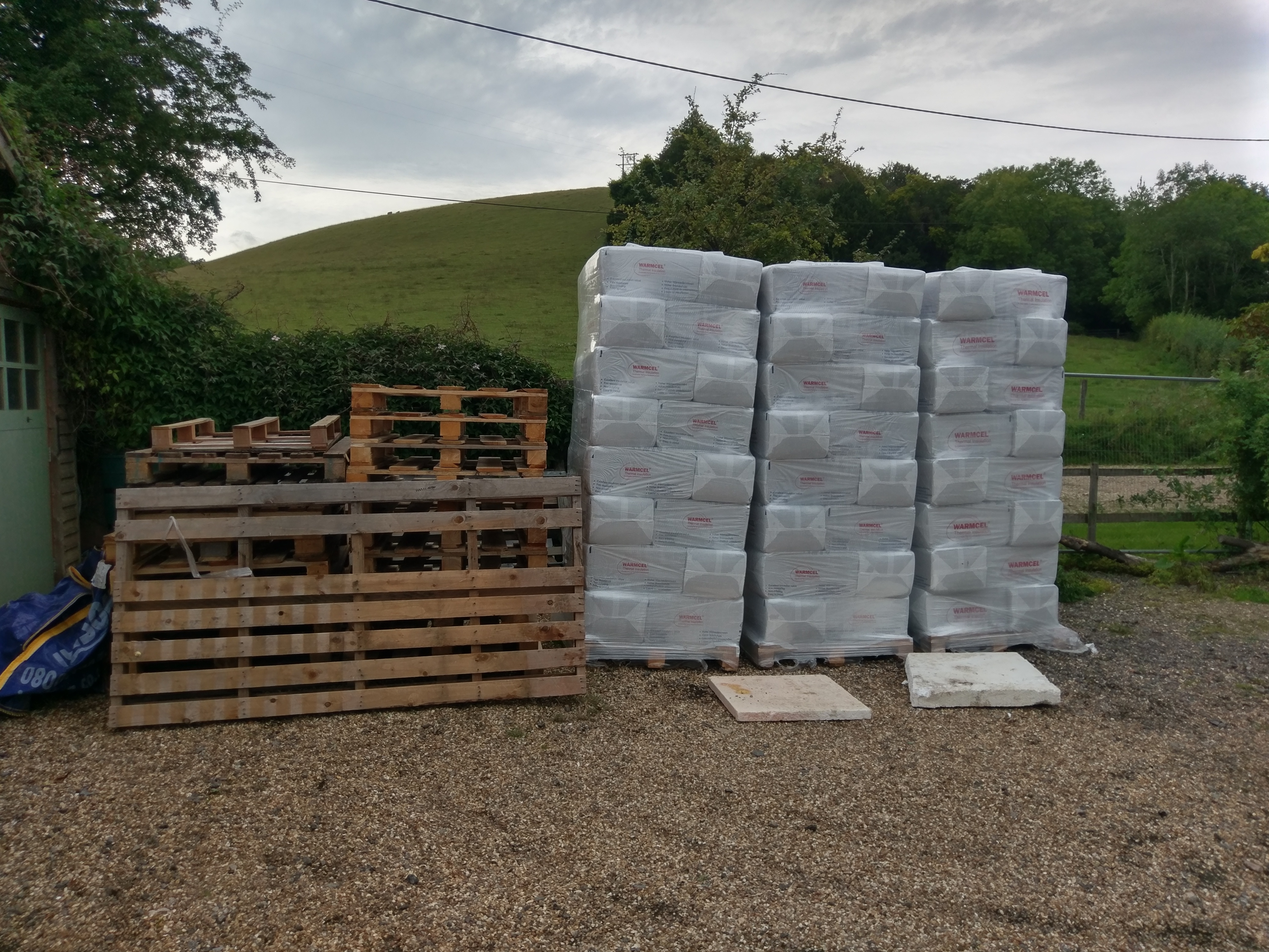

@Barney12 If you are next for the team then its 14-16 pallets according to the lads here.
Some stats to get you thinking.
40 bales on each pallet
Each bale is 12kg so 480 kg.per pallet
20 of mine went in the roof.
So the house is now 9.6 tonnes heavier with nearly 5 tonnes in the roof

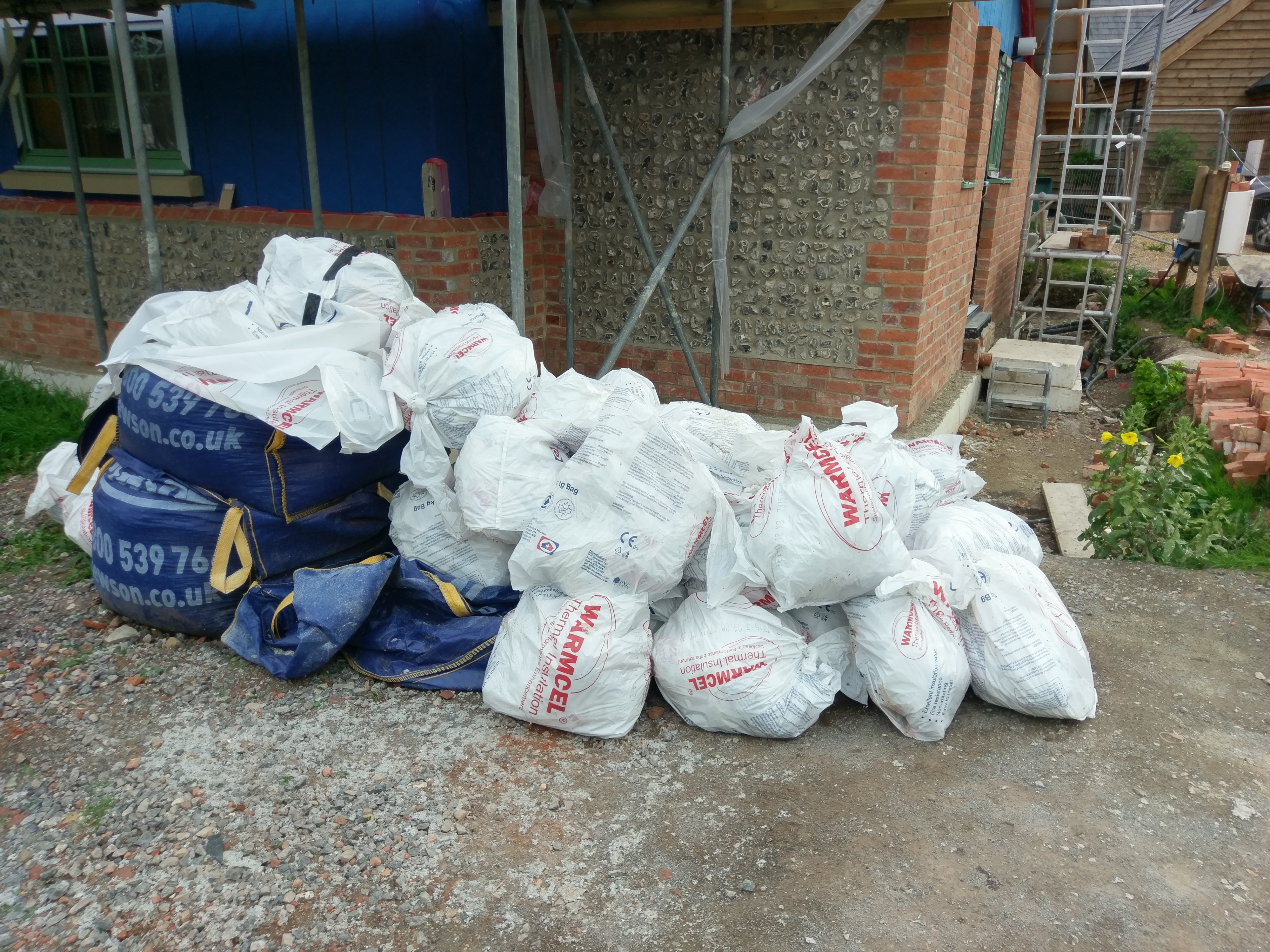

The guys finished on site last night.
we have an insulated air tight house :D
Someone over ordered though.
Anyone want some pallets. @ProDave they are free. maybe another shed.
Left the site clean and tidy.
