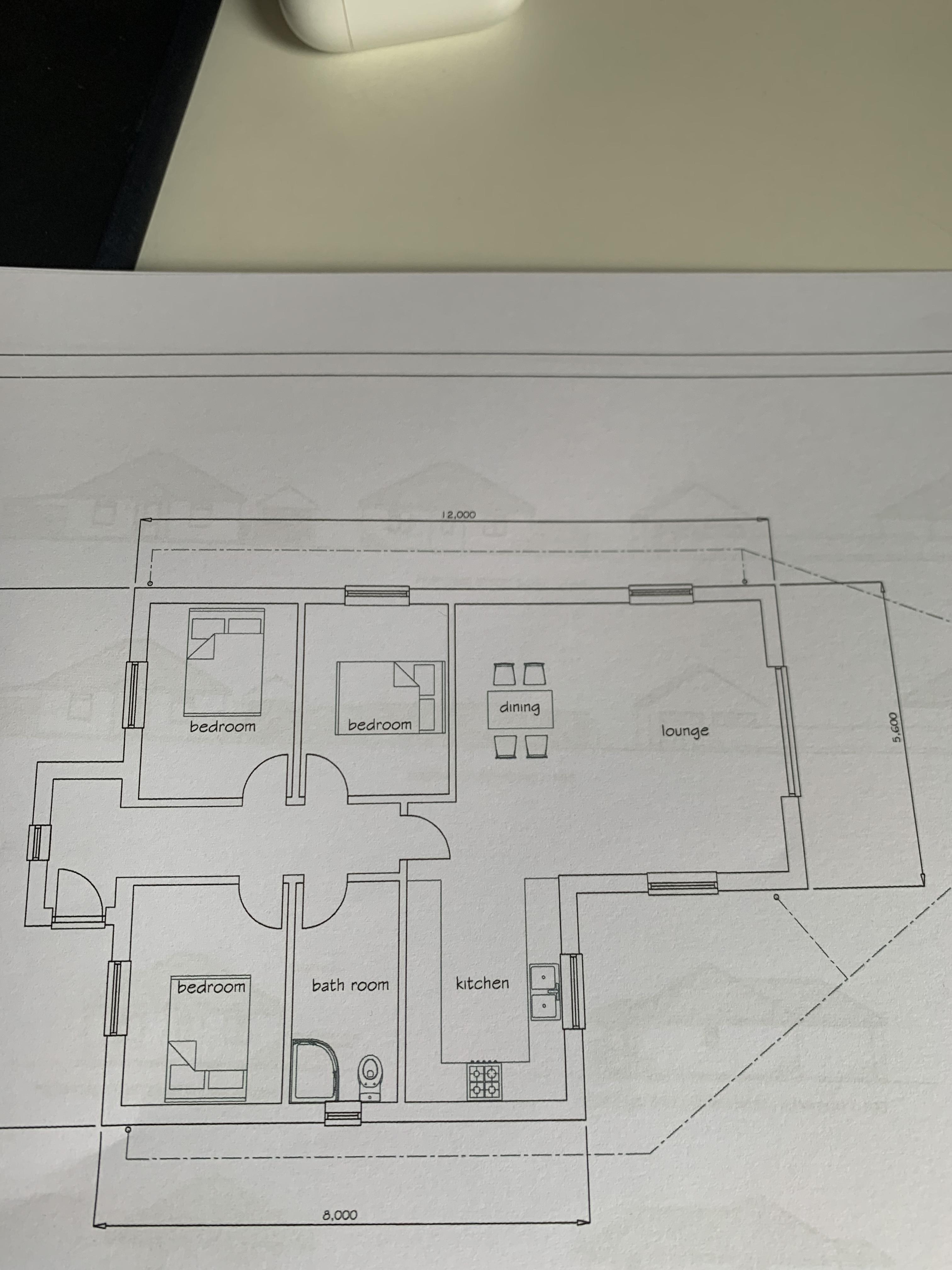

That was the house plan which we got so far.
Your design lends its self to cheap build cost
Especially if ground conditions are favorable
Looks like a nice home

Looking at the drawing the bungalow looks more like about 85m2 rather than the 150m2 you mentioned in your first post.  This will reduce the cost a great deal and you may well be able to achieve this within your proposed £200k budget.
Thanks. We are looking to plan for loft space with PD drawing so that can have 2 bed rooms on top which is the reason said 150sqm but not sure creating loft space into bedrooms will cost how much more.

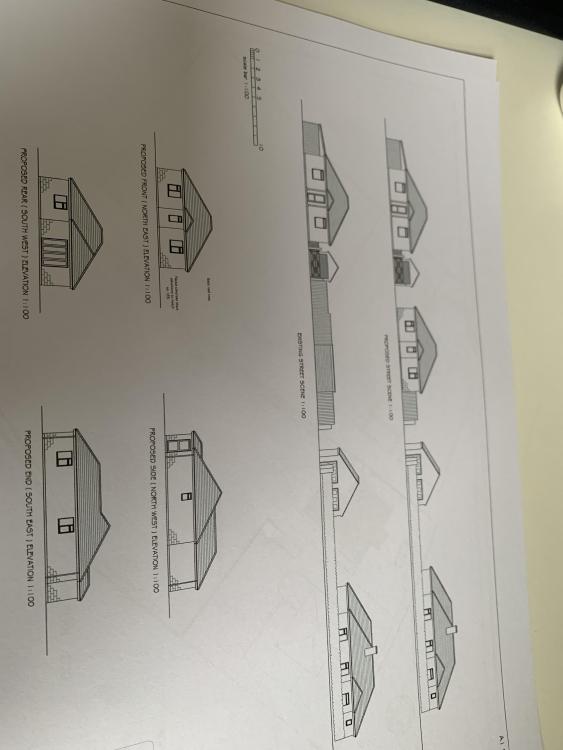

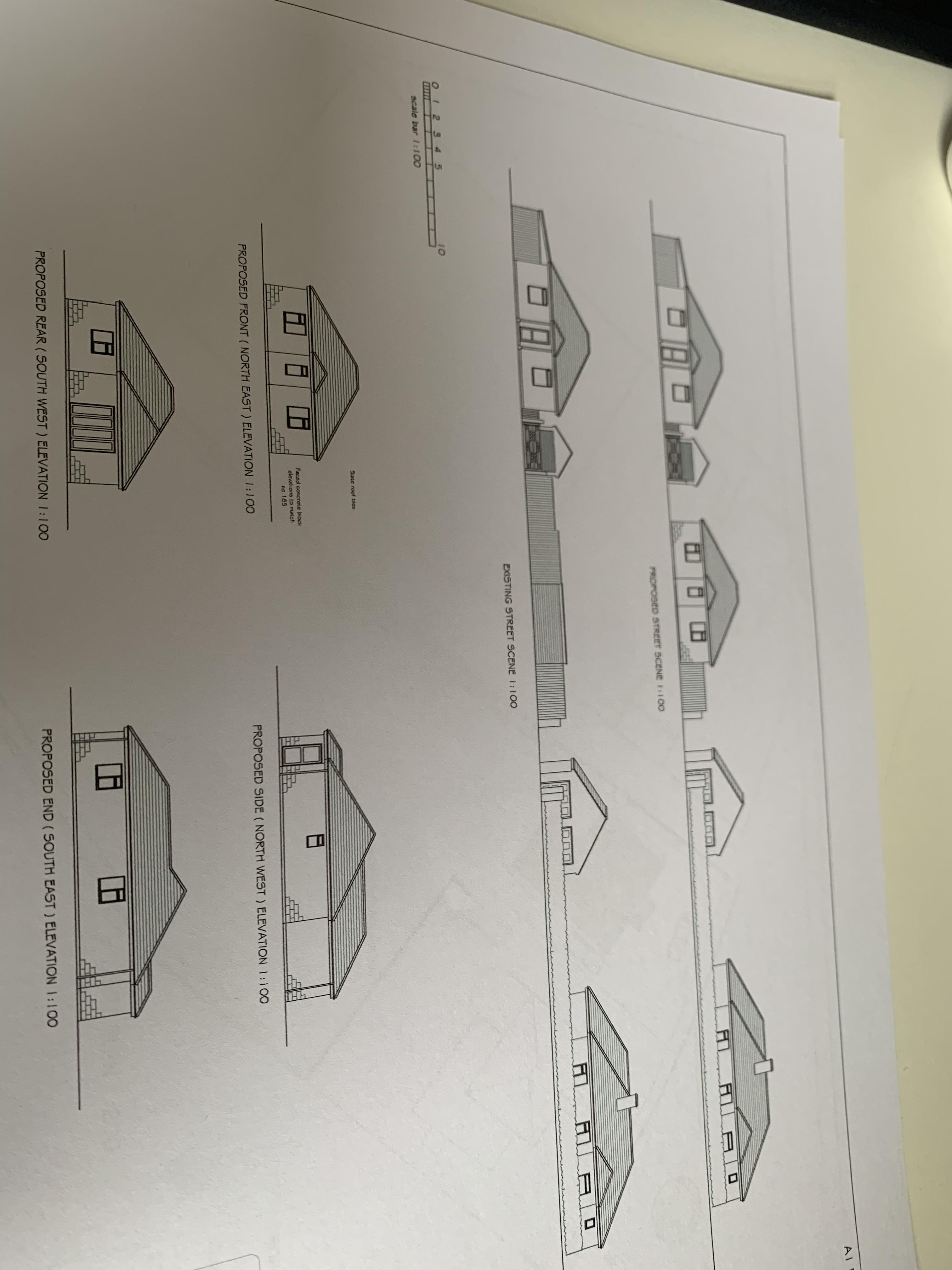

Is there actually enough height in that design for rooms in the attic?
We are looking to submit planning application with attic rooms under PD
