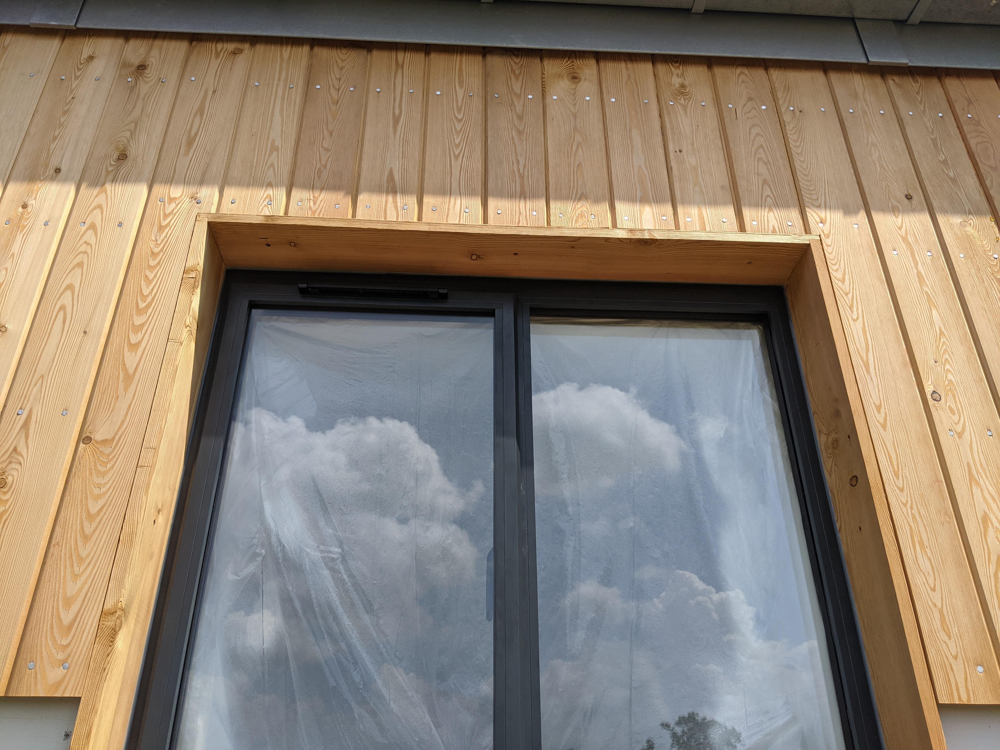

I've Siberian larch cladding and reveals, but now it's up I'm concerned water could run down the cladding, particularly the grooves and hit the reveal where it might track back towards the building and window.
Just wondered what my options are here, I do have extra larch, so could have it oversail the head but was also thinking I could put drainage holes in the reveal or could plane back the reveal so that the cladding is further out Or could fit a metal drip (zinc as per roof) above the reveal or any suggestions/recommendations very welcome..!
I would have taken the cladding over the reveals, not flush - unless the reveal slopes outwards like a cill

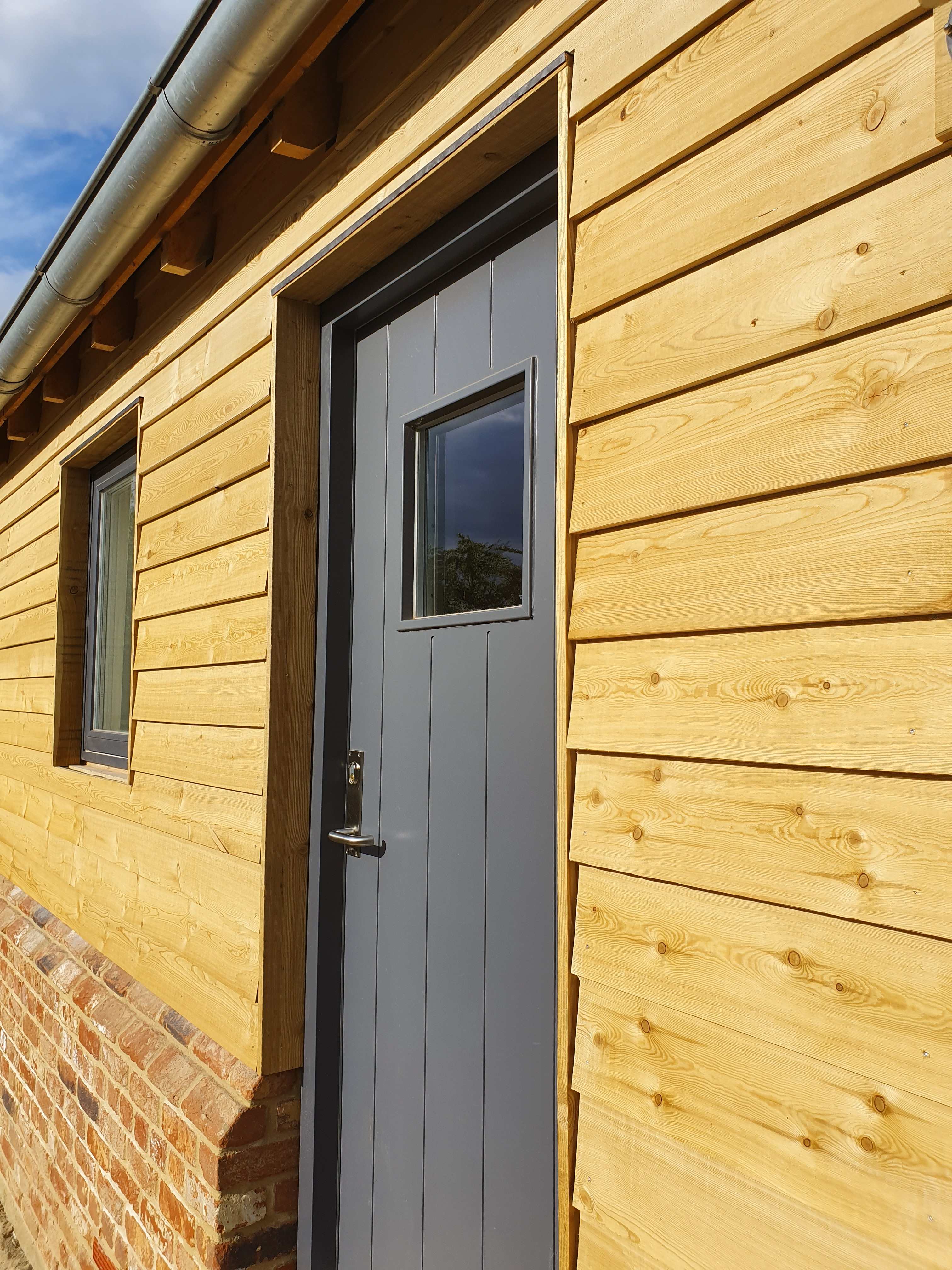

On my timber cladding I ran it down in front of the reveal and left a 3mm gap between the reveal edge and the cladding as a drip gap.
It looks like such a typical English cladding detail.
Do you have any roof overhang? From the photo it looks to me like there is just about 25mm or so for the fascia and then your guttering, but I may be mistaken? If not, then you are going to be fairly exposed. Timber cladding should always have a generous roof overhang for long term performance, but that often gets overlooked, by designers and builders alike in this country.

The roof is standing seam zinc, and so it folds into the gutter - so I think the gutter also acts as an overhang. Except at the gable ends - where the overhang is only as you say - the fascia with no guttering.

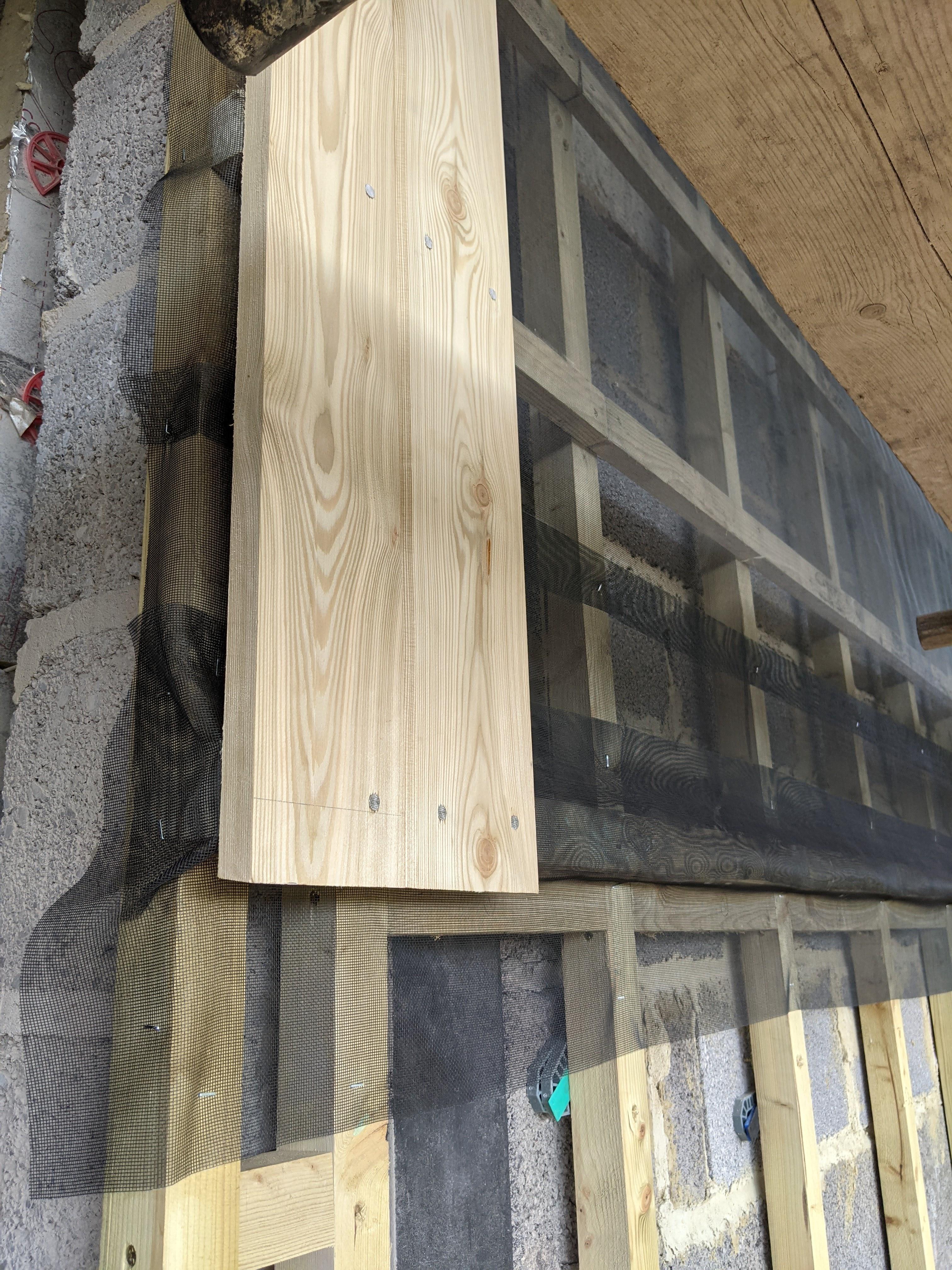

I used a strip of lead flashing folded up behind the cladding and dressed half way down the front of the top reveal lining.
That’s interesting. Did you take that behind the battens ands back to the membrane? Do you have any pictures you’d be happy to share? Ta
Yes, folded up behind the battens.  It was on to blockwork with a cavity, so I didn't bother with a membrane.  I'll be doing another one in the not-to-distant future on a timber frame and plan to slide the lead under the membrane. You can just see the lead on this:

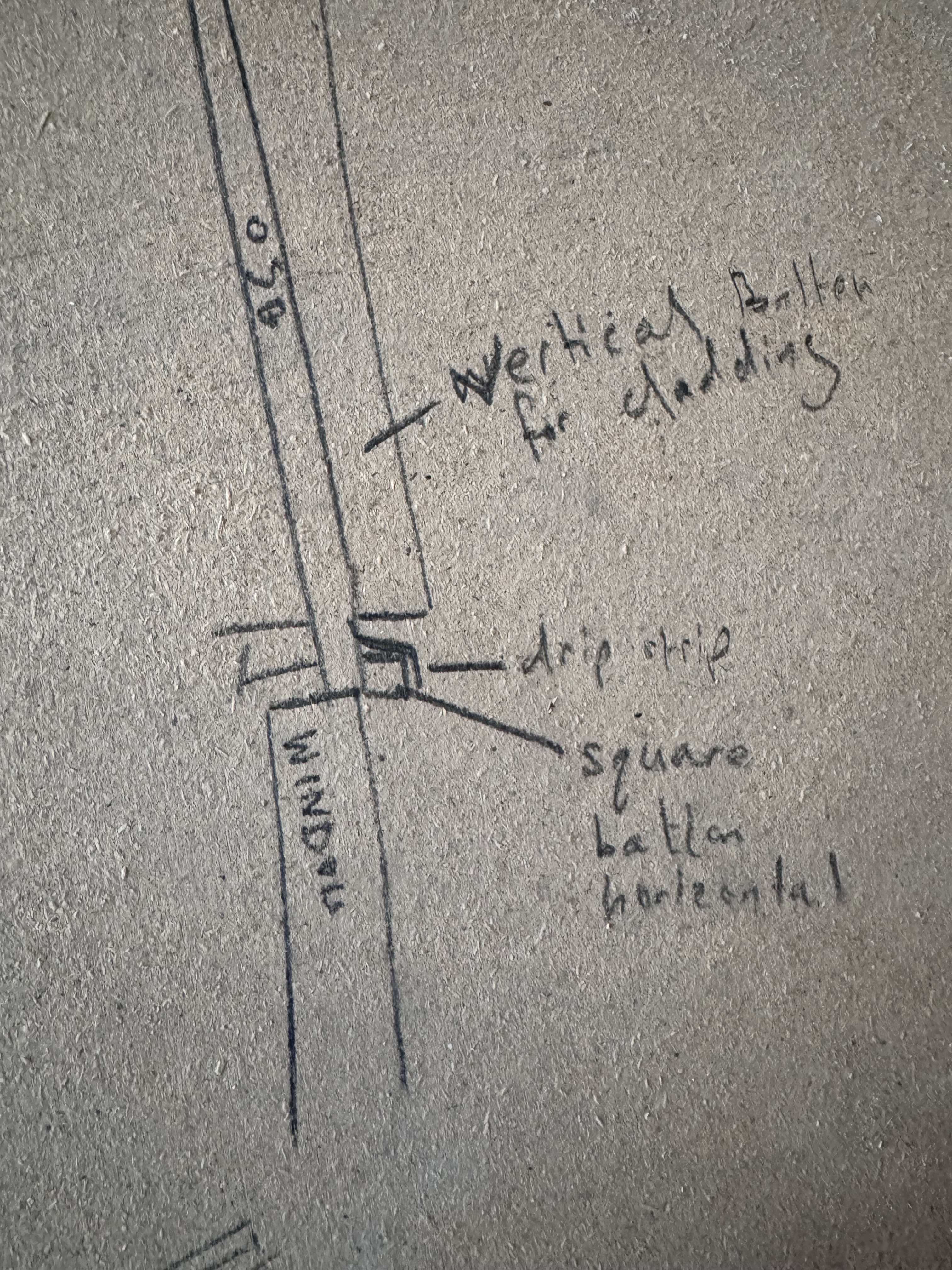

Looking at this again as trying to work out how to make this work…
My windows/doors are pretty much flush to the opening so the reveal will need to attach to the battens. I can’t work out how to put a head drip and reveal in at the top as they would interfere with each other… ideally would like timber reveal all the way around.
 Any advice greatly appreciated.
 Thanks

Thanks. This is what I’m thinking… probably quite fiddly but should give me something to fix a timber reveal too and allow for a drip strip, ventilation and over sail the cladding. I wonder if I’d get away with lead drip or better off getting made with aluminium.

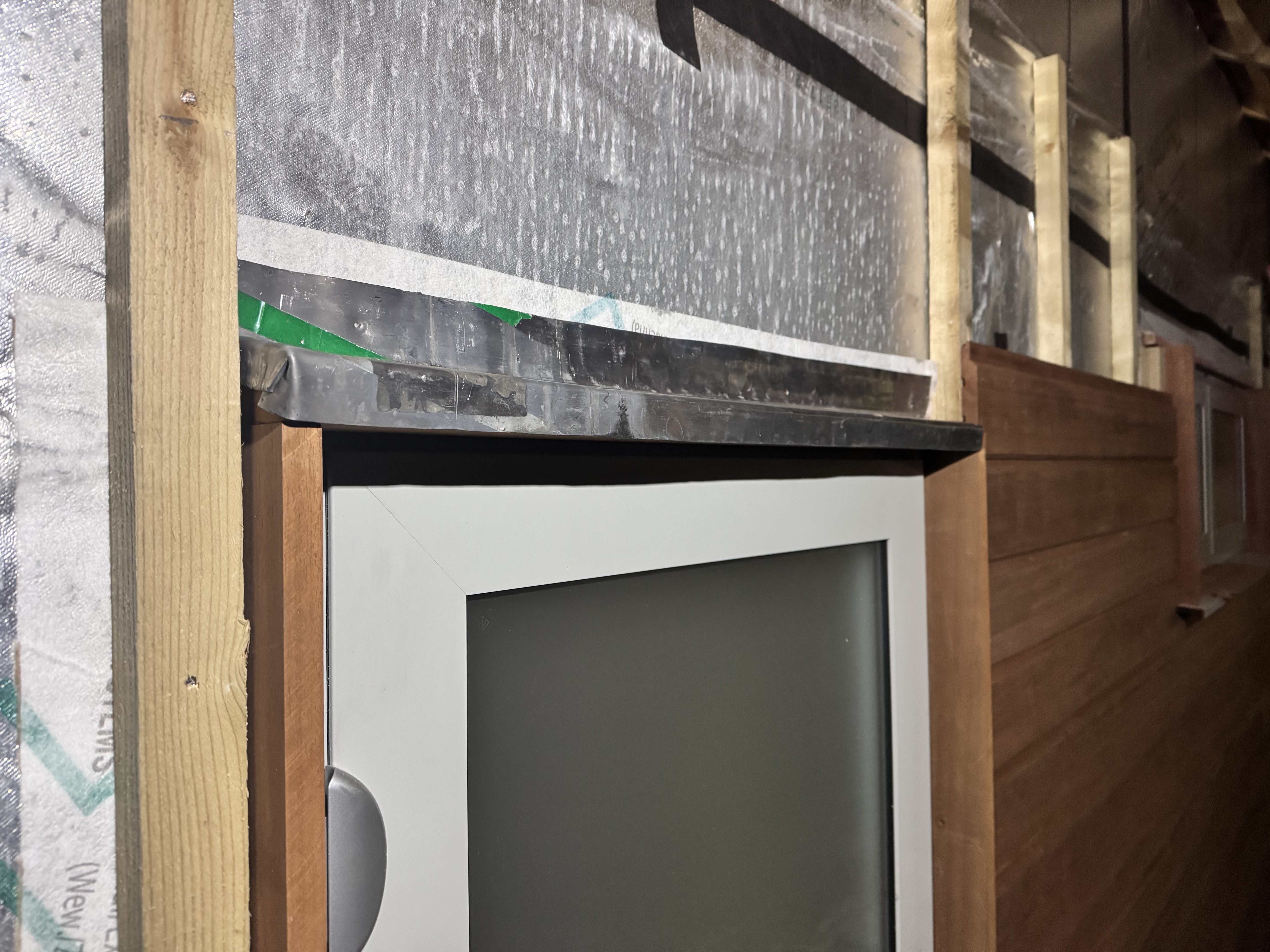

Update: I’ve been playing around today: prototype… think I might go with lead as much easier to manipulate and seal corners. I think something like the attached photo will work…(this is on a door but windows will be the same)
Trim equal all around gives a neater finish then angled wedge on top with lead drip above that. I’ll leave a 5mm gap between lead and the cladding to allow airflow and and insect mesh.
 Ideally lead will run under membrane but may tape instead… something else to decide.
I’d welcome any thoughts and tips anyone else has.
