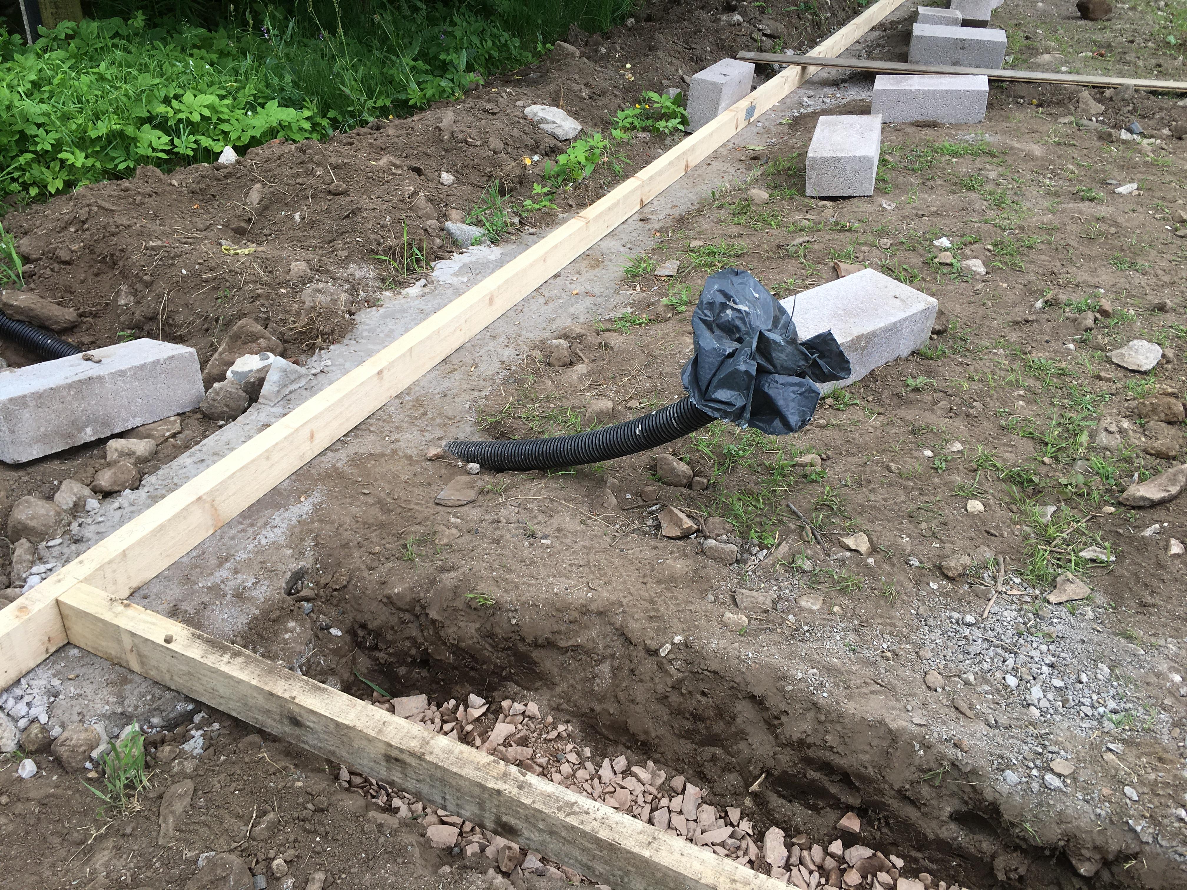

Bozza Posted June 19, 2021 Share Posted June 19, 2021 I was away to post a similar question so have kind of jumped into this post. I decided to have fun by building my own workshop (30sq timber frame) having not been allowed near the actual house. Trying to build to a decent quality. Per attached pic my foundation system is strip foundations, deeper at corners. Hardcore then concrete. Then one course of block work onto which I’ll attach the timber frame. Inside the block work I’m planning on: hardcore, then sand, then DPC, then 50mm PIR, then probably 50mm concrete floor or screed. Would be interested on any thoughts or nuggets of ideas in particular the final floor surface - non load bearing - whether to reinforce with chicken wire. Or better ideas / thoughts. Whether to put the dpc between PIR and concrete for example. ** the timber in the pic is just temporary used to get layout heights levels etc ** answers / thought should help both OP & I Link to comment Share on other sites More sharing options...

TANK Posted June 21, 2021 Author Share Posted June 21, 2021 Thanks for all the replies guys. Mine is a fairly unique situation, and I prob should have elaborated a tad more. Bear with me here... There used to be a prefab outbuilding here for years, built upon a concrete slab. The previous owners pulled it down for some reason just leaving the slab (which was bordered on one side by a path, and the one end by tarmac where it meets the drive). I decided against using the slab on which to build a timber building due to A) close proximity to the border, B) it beginning to crumble in places on the top, and C) I wanted to take the opportunity to place some insulation down, so I did away with it, leaving the dpm and compacted hardcore underneath. So now that I've dug around this, as I build back up from the middle of the foundation strip there will be a gap between the brick and the edge of what used to be the slab, of around 100mm. The other side can just be earth/soil/hardcore I suppose but it is the material on the inner side which I'm confused over. If I put another concrete slab down which stretches to meet the brick work then I suppose the fill will need to be substantial and stable. But I don't even know whether I need to put another Slab down... Are there any other easier alternatives. The shed will mainly be used for general storage, plus a little bit of a workshop, but nothing much heavier than bikes and a lawnmower in there really! Cheers again. Link to comment Share on other sites More sharing options...
Temp Posted June 21, 2021 Share Posted June 21, 2021 (edited) That makes things clearer. Might also help if we knew how much height you have to play with? If you want a solid floor you would either remove the old slab or break it up into hardcore and compact it. They pour a new slab on top. Then sand blind, DPM, Insulation and screed. You could also go for a suspended timber floor but that may need sleeper walls in the middle to reduce the span. What's the shortest dimension of your building? A suspended timber floor also needs ventilating (eg air bricks or periscope vents through the walls). If you go this route I would build and insulate the floor as you go. eg fit a Joist, then Insulation, then a joist. That way the joists are tight up against the insulation and no need to cut insulation to fit between joists. Insulation not shown in this.. You could also go for a concrete beam and block floor with insulation and screed on top. . Edited June 21, 2021 by Temp Link to comment Share on other sites More sharing options...
