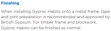

MortarThePoint Posted June 17, 2021 Author Posted June 17, 2021 I don't know why they are drawing the distinction, but I'd be ale to skim Habito boards on metal studs surely:
nod Posted June 17, 2021 Posted June 17, 2021 1 hour ago, markc said: Yes! makes for a very quick install on job-and-knock or price/metres jobs We have a housing site where the builder offers Habito boards as an extra All the rad kitchen cupboards and tv brackets are fitted to them without pattress Only drawback is you can’t use collated screws or Dot and Dab with them 1
