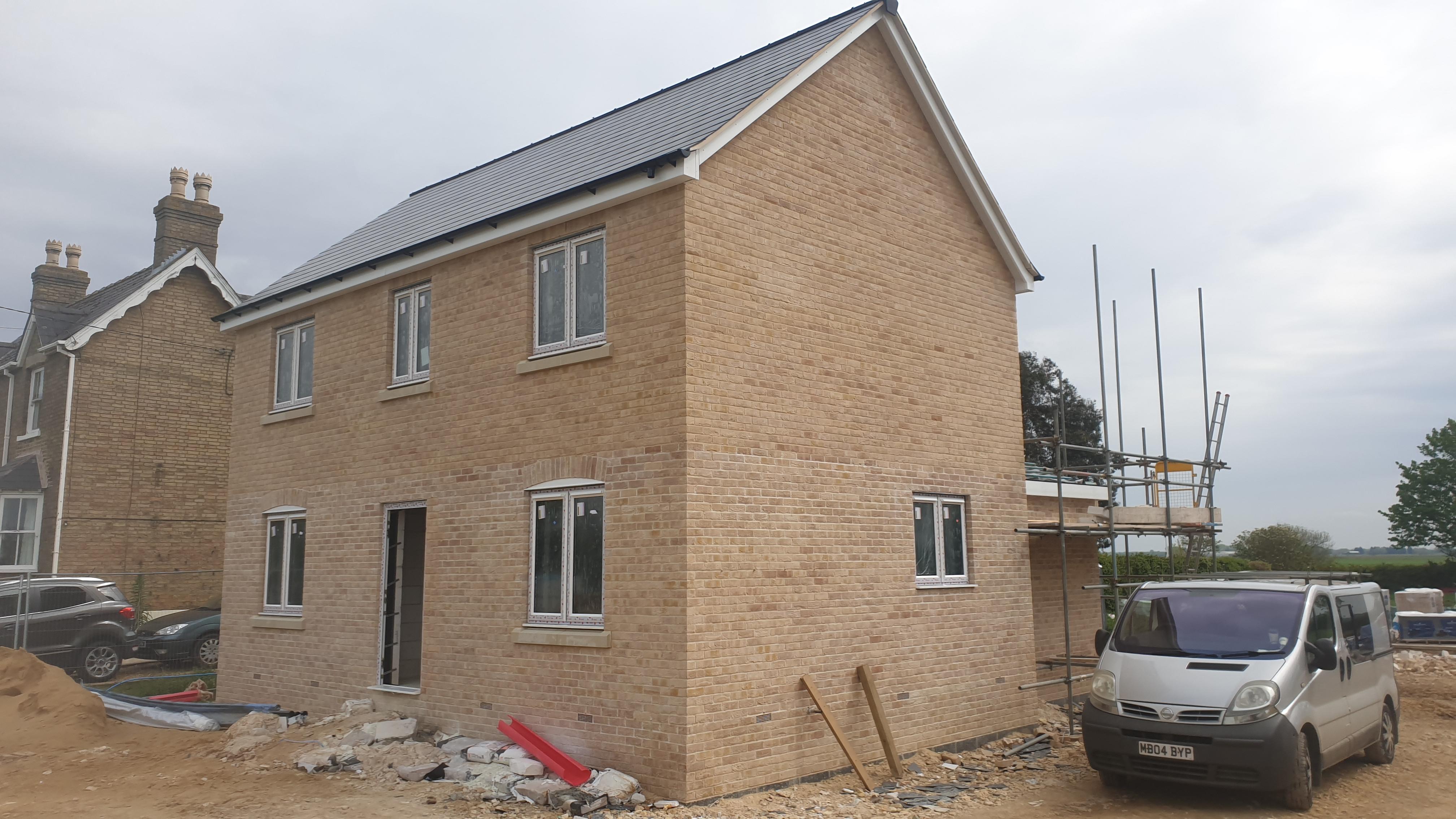

Sorry late reply guys.
I don’t  have the samples anymore but they did have a good colour variation.
The pictures were taken in direct sun light last night at about 1900.
I have since found some more pictures online and they don’t look too bad on a build but still unsure.
Its a nightmare scenario as the national park take up-to 6 weeks to approve materials so this could set us back 2 months as a guess, that’s if we can even return the bricks?
will post some pictures of another build

The second lot of pictures you posted have red mortar.  I assume you are using standard mortar.
If you are sure that the bricks you have are the same make as those that were approved and you are happy with them, just carry on.
With the shortage in labour and materials at the moment you would be crazy to stand your builder and bricklayer down.
