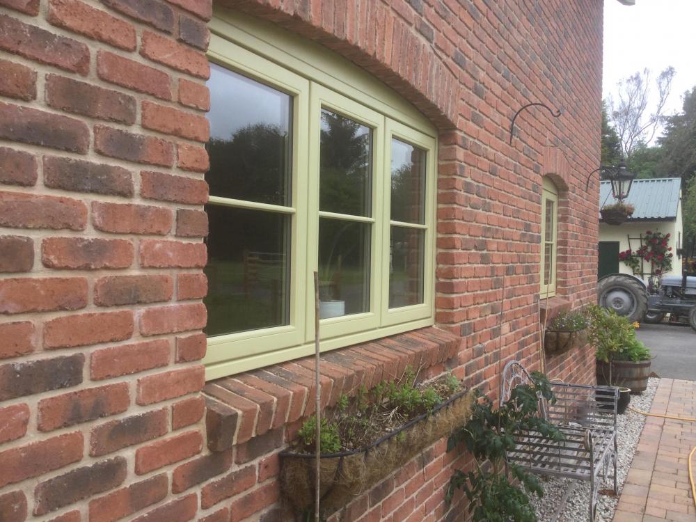

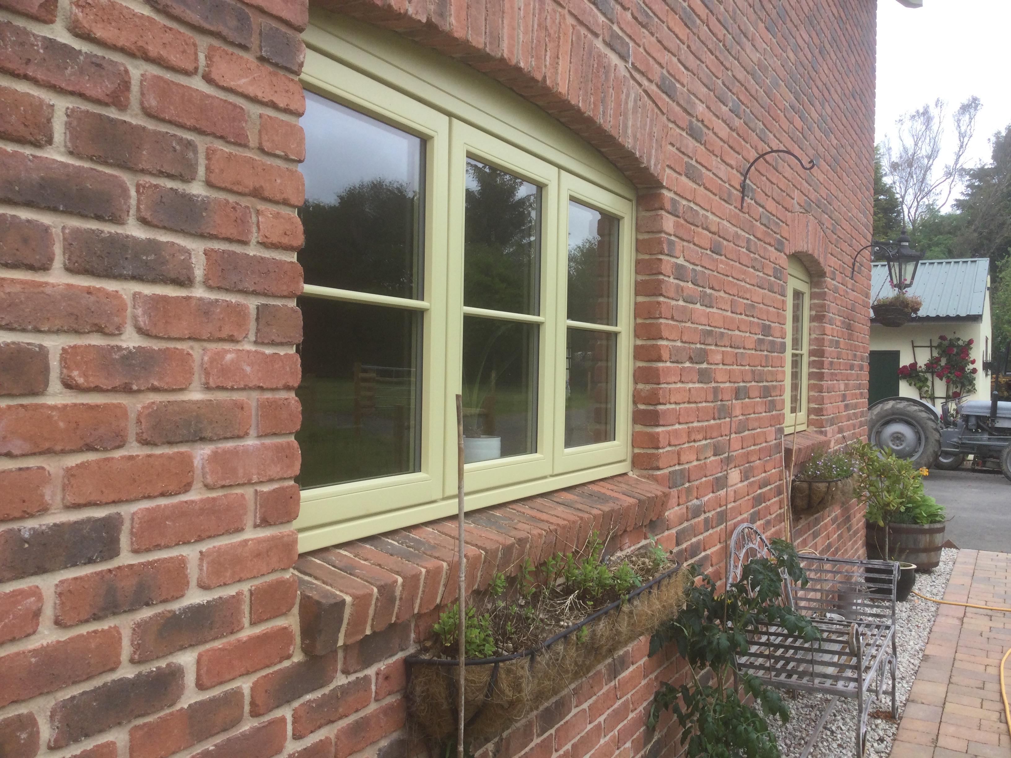

Dudda Posted June 1, 2021 Share Posted June 1, 2021 Would you consider a brick cill? Similar to the below image I found on Google (ignore the head and style of the window, only looking at the cill). Link to comment Share on other sites More sharing options...

newbuild Posted June 11, 2021 Author Share Posted June 11, 2021 On 01/06/2021 at 15:08, Dudda said: Would you consider a brick cill? Similar to the below image I found on Google (ignore the head and style of the window, only looking at the cill). It's a nice idea, thank you. However, I'm wondering how practical it would be considering other comments regarding the porosity of brickwork Link to comment Share on other sites More sharing options...

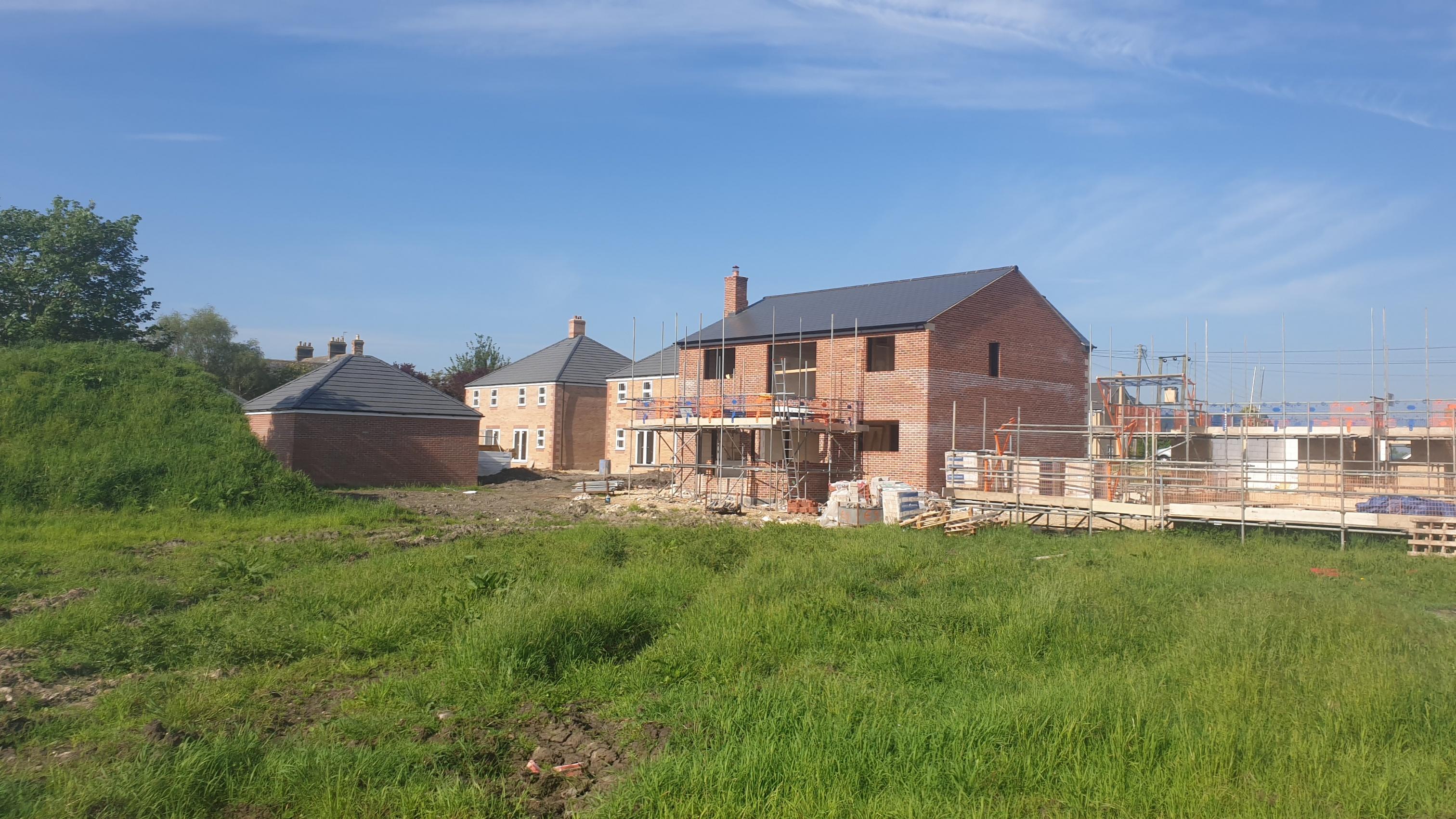

Faz Posted June 11, 2021 Share Posted June 11, 2021 The scheme next to mine installed the windows flush fit and they look shite - in keeping with the rest of his scheme tbh. This photo may help (I took it mind to show how the sun and shadows highlight defects!) Look at the shadows..... Link to comment Share on other sites More sharing options...
Faz Posted June 11, 2021 Share Posted June 11, 2021 Oh - and he hasn't put on any external mastic either - a nice fun detail come winter. Link to comment Share on other sites More sharing options...
