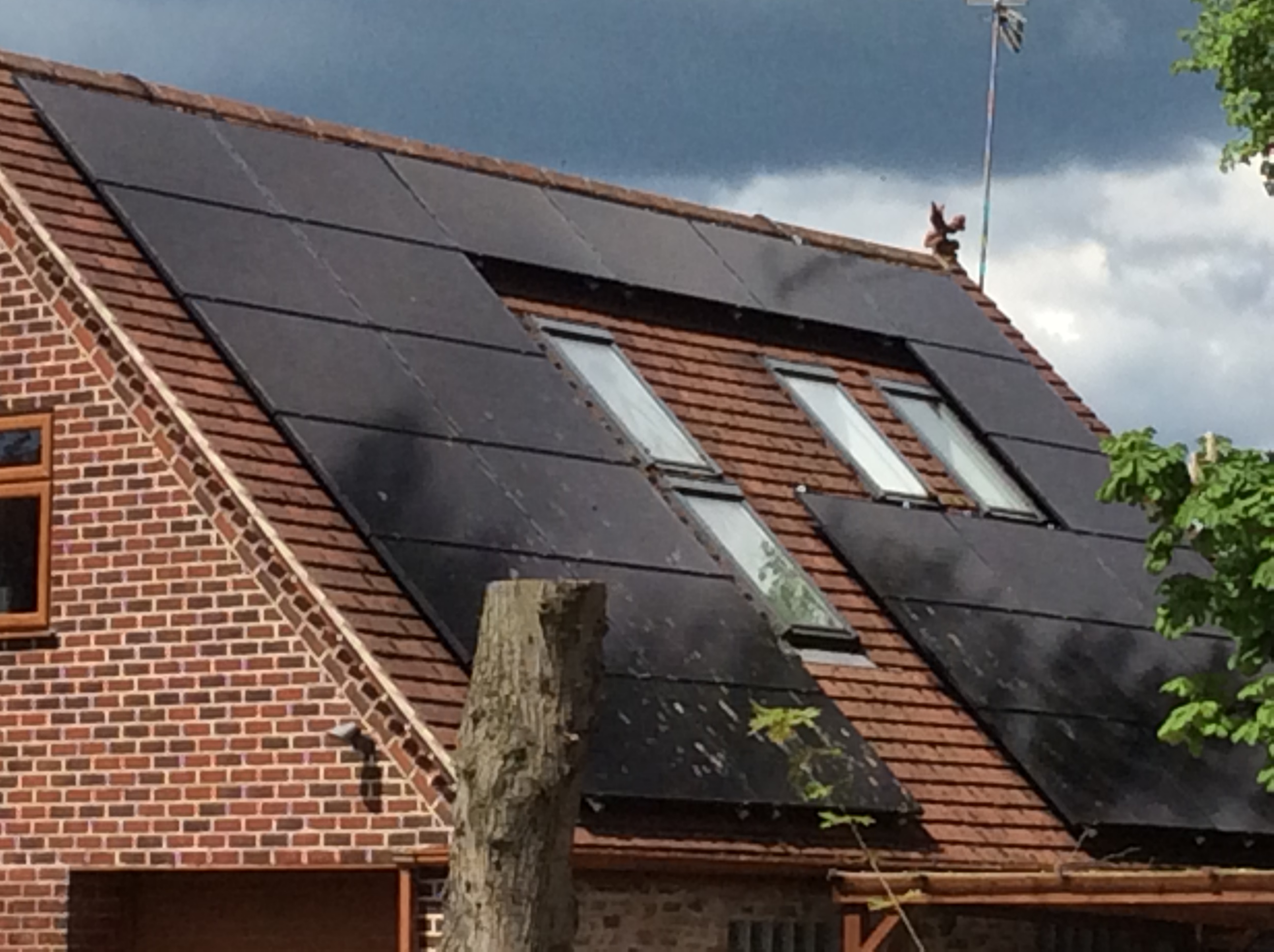

Ferdinand Posted May 26, 2016 Posted May 26, 2016 44 minutes ago, Declan52 said: When sse are looking a reading I have to put in both of my import and export readings from the main meter. I think it was around September that Nie asked for my total export amount and was at the end of March where they wanted my total generated amount. I worked out how my pv was saving me money by looking at my yearly figures. I think my total bill for the year was near £600. I got £55 back from exporting and hope to get near enough £650 back from the generating tariff. So all in by having pv I was £100 up. If I hadn't had pv then my bill would have been £1250 as I would have had to buy in the units i generated. That's not taking into account how much I saved by using pv to heat my water. Well worth having in my view. To me that looks like £650 up - £1250 that you would have paid minus £600 that you had to pay. My (10kw mainly east-facing) array has generated around 1500 kwh since mid-Jan, before the relevant shading 2 large trees were removed by my neighbour. I hope to get 6000-6500 kwh for the year, but we'll see. At my FIT of (iirc) 10.9p/kwh, that will be around £650 plus the electicity saved plus the export, perhaps very approximately £1100-1200 in toto. Perfectly acceptable even in financial terms for a 12k investment. Ferdinand
Declan52 Posted May 26, 2016 Posted May 26, 2016 I didn't count that as that's what you use to cover your initial investment. I was slightly under 3800 units for a 4kw system at a fit rate of 16.4p so am well glad that I installed it.
