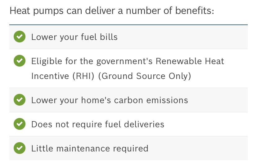

14 minutes ago, Dave Jones said:
The chap from Worcester Bosche explains it very cleary, then again he is probably a troll as well.
He’s hilarious ..!! He’s the one that starts talking about chipboard floors and glued down carpets from memory being a reason not to fit bigger radiators...
This is the WB Heat Pump page btw - they are spending millions investing in the technology.
https://www.worcester-bosch.co.uk/products/heat-pumps
Just to save you looking, they quote the following :
I though you said they were expensive and would fall apart ..?? And are expensive to run...??
Seems WB disagree with you too - as to 99.9997% of the population ...
  • Like 1
  • Haha 1
