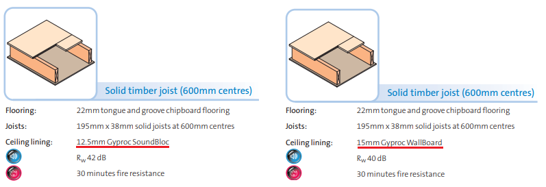

MortarThePoint Posted May 8, 2021 Author Posted May 8, 2021 This is a useful resource that I have just found: Stockist Guide - Construction details. It shows other makeups for ceilings and floors. Some of the other ceilings are surprising less performant than one might expect. 1

MortarThePoint Posted June 15, 2021 Author Posted June 15, 2021 8 hours ago, recoveringbuilder said: As a matter of interest will you have to double sheet your garage ceiling? Just thinking back to when we built our last house it had a studio above the garage and we had to double sheet the garage ceiling. BCO said he's wanting 30 minute fire rating so 15mm of fireline OK. He asked if it was going to be skimmed and I said it was, so that may be significant. If using 12.5 sheets I'd may have to double up. 1
joe90 Posted June 15, 2021 Posted June 15, 2021 I always thought 12.5mm plasterboard (skimmed) was 30min fire rated ?
MortarThePoint Posted June 15, 2021 Author Posted June 15, 2021 21 minutes ago, joe90 said: I always thought 12.5mm plasterboard (skimmed) was 30min fire rated ? Looking at the White Book C06 S06, it seems it can depend if you are trying to achieve BS EN1365-2 or BS 476: Part 21: 1987. No mention of skim. If I read it correctly, 600mm centres requires 1x15mm WallBoard or better. A skimmed 12.5mm sheet feels like it should be as good/thick as a 15mm sheet, but I don't see it sanctioned anywhere. Your BCO may accept it, I don't know. 1
MortarThePoint Posted June 15, 2021 Author Posted June 15, 2021 I was planning to use a single layer of 15mm SoundBloc F mounted @ ~450mm centres in resilient bar for the ceiling. Due to availability I am wondering about changing that to 2 layers of 12.5mm WallBoard mounted @ ~450mm centres in resilient bar. The mass will actually go up from 14.1kg/m2 to 16kg/m2. Both options would be skimmed. Price is about the same and I expect the fire resistance of two layers of 12.5mm WallBoard would be as good as one 15mm layer of SoundBloc F. Any thoughts?
