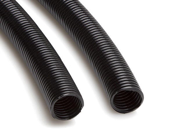

Triassic Posted March 2, 2017 Posted March 2, 2017 (edited) I ran mine through small bore plastic corrugated conduit. The wall of the pipe is thinner and its more flexible than UFH pipe. Edited March 2, 2017 by Triassic
Nickfromwales Posted March 2, 2017 Posted March 2, 2017 (edited) The corrugations are a bit of a concern if you are trying to push a flimsy wire past more than one bend. Fwiw, try long radius bends, or even better, as near to straight as possible. Fine if your getting the sensor in on the day into loose conduit, but a pita when your trying to change one out. Smooth walled pipe for me every time. Edited March 2, 2017 by Nickfromwales Crossed with onoff
Triassic Posted March 2, 2017 Posted March 2, 2017 Should have said the corrugated pipe I used had a smooth lining.

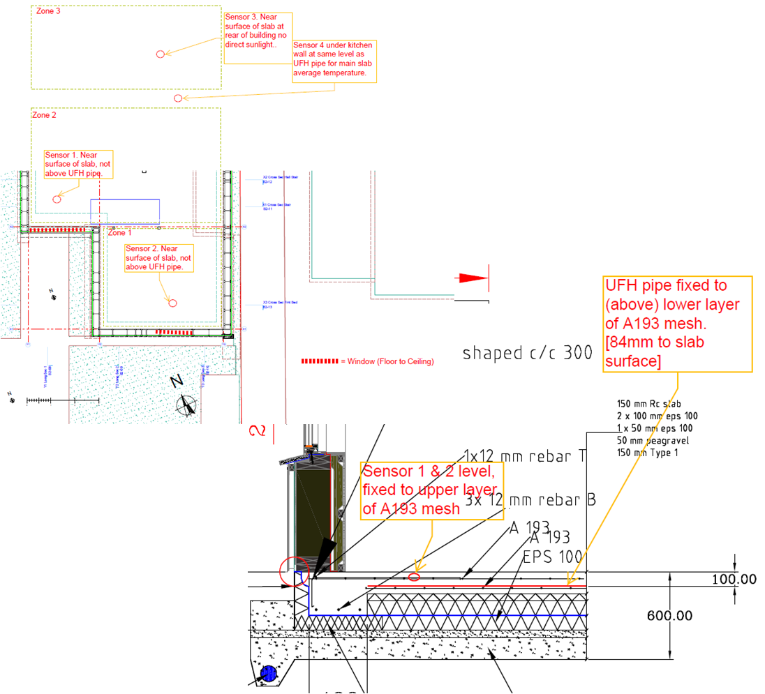

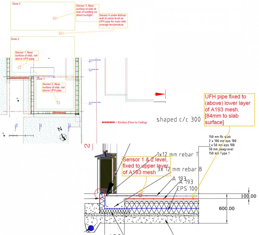

MikeSharp01 Posted June 25, 2018 Posted June 25, 2018 Just planning my sensor locations and after going through all the treads here have come up with my plan. I will have four sensors across / in the slab. The slab has three UFH zones two which get full sun via the windows and one, at the north end, which does not. I plan to monitor the surface temperatures in the three zones, basic layout as attached, and have a fourth sensor in a no UFH area under one of the internal walls which itself is out of the reach of the sun. Another four sensors will monitor the main flow and each return UFH temperature. There are also several air temperature sensors in the scheme to control the UFH and the summer ventilation strategy with the roof vents. I think this layout will give me enough telemetry to enable me to play with things around detecting solar gain happening at the front of the building while also having control of the heating via the under wall / air temperature sensors as @JSHarris suggests. Have I got my locations right I wonder? Air temps can go in later with the frame build but the slab pour must go ahead in 10 days time.
Onoff Posted June 25, 2018 Posted June 25, 2018 Could you not run your sensor ducts to the furthest possible point they can feasibly go but route them via points where they MIGHT be better. Then, knowing the run length, you can just pull them back as required.
MikeSharp01 Posted June 25, 2018 Posted June 25, 2018 6 minutes ago, Onoff said: Could you not run your sensor ducts to the furthest possible point they can feasibly go but route them via points where they MIGHT be better. Then, knowing the run length, you can just pull them back as required. Yes I guess so, I was going to use your Pex-Al-Pex idea and go straight (line) to the sensor points, so I can pull them out for replacements etc, I will fix the runs to the upper R193 mesh.
Onoff Posted June 25, 2018 Posted June 25, 2018 1 minute ago, MikeSharp01 said: Yes I guess so, I was going to use your Pex-Al-Pex idea and go straight (line) to the sensor points, so I can pull them out for replacements etc, I will fix the runs to the upper R193 mesh. Not my idea. It was Nick or Peter's. In fact I think it was Peter sent me the sensor?
