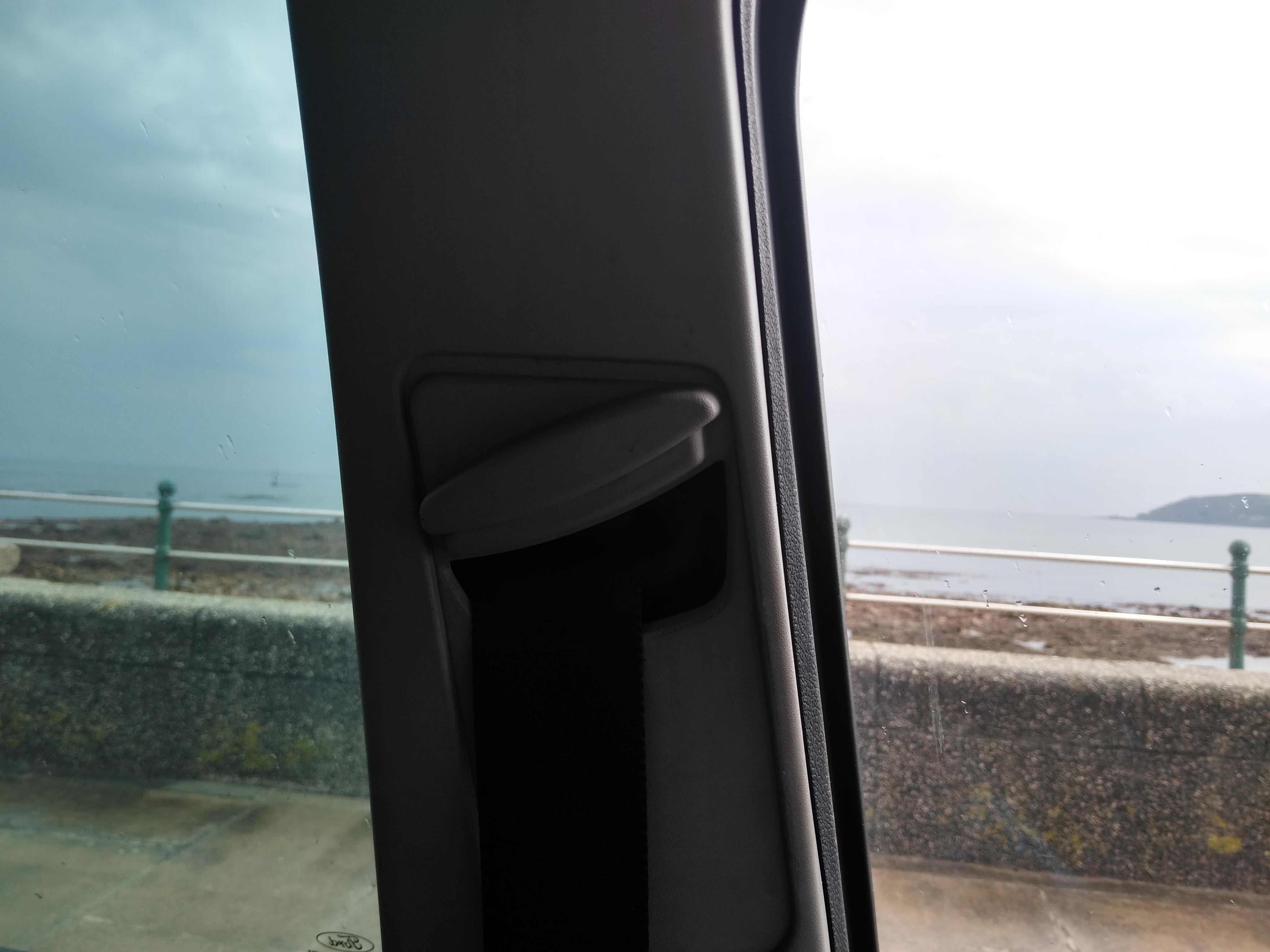

SteamyTea Posted April 29, 2021 Posted April 29, 2021 My car has blacked out rear windows. Hardly notice the difference when looking out. Left is the dark side. 1
Loz Posted April 29, 2021 Author Posted April 29, 2021 Good point I have blacked out windows in rear too but think that is more for privacy rather than reduce of solar gain so not sure how similar they would be in appearance.

hendriQ Posted April 29, 2021 Posted April 29, 2021 @Loz I have opted for SN 70/35 on all of my west facing windows and sliding door and on the only rooflight that is over a bedroom. Details here: https://www.guardianglass.com/gb/en/products/brands/sunguard/super-neutral/70-35 It wasn't that much more expensive that the regular glass, and was the easiest addon to negotiate down in price. The rooflight company eventually gave it to me "for free". If all the glass on the same wall / orientation is the same, you won't notice the colour difference - or at least that is the logic that caused me to specify it on the sliding doors as well, which are about 40cm away from the kitchen window. I am hoping that I won't really notice the colour difference between this and untinted glass as there won't be any untinted glass in the same room and my eyes will just adjust to it. If however you were to have two windows side by side and one has solar control and the other doesn't, you will notice, as with the picture of @SteamyTea bling wagon. I know one can go darker than SN70/35 and block out more solar gain but for me this was the right balance between letting enough light in but not too much heat. Haven't had it delivered or installed yet, so fingers crossed it looks good when it comes. I will upload some photos, probably in June.
SteamyTea Posted April 29, 2021 Posted April 29, 2021 55 minutes ago, hendriQ said: picture of @SteamyTea bling wagon If is a really old C-Max, and the seat belts are still clipped in the back since it was MOTed last September. I don't think I have ever sat in the back.
