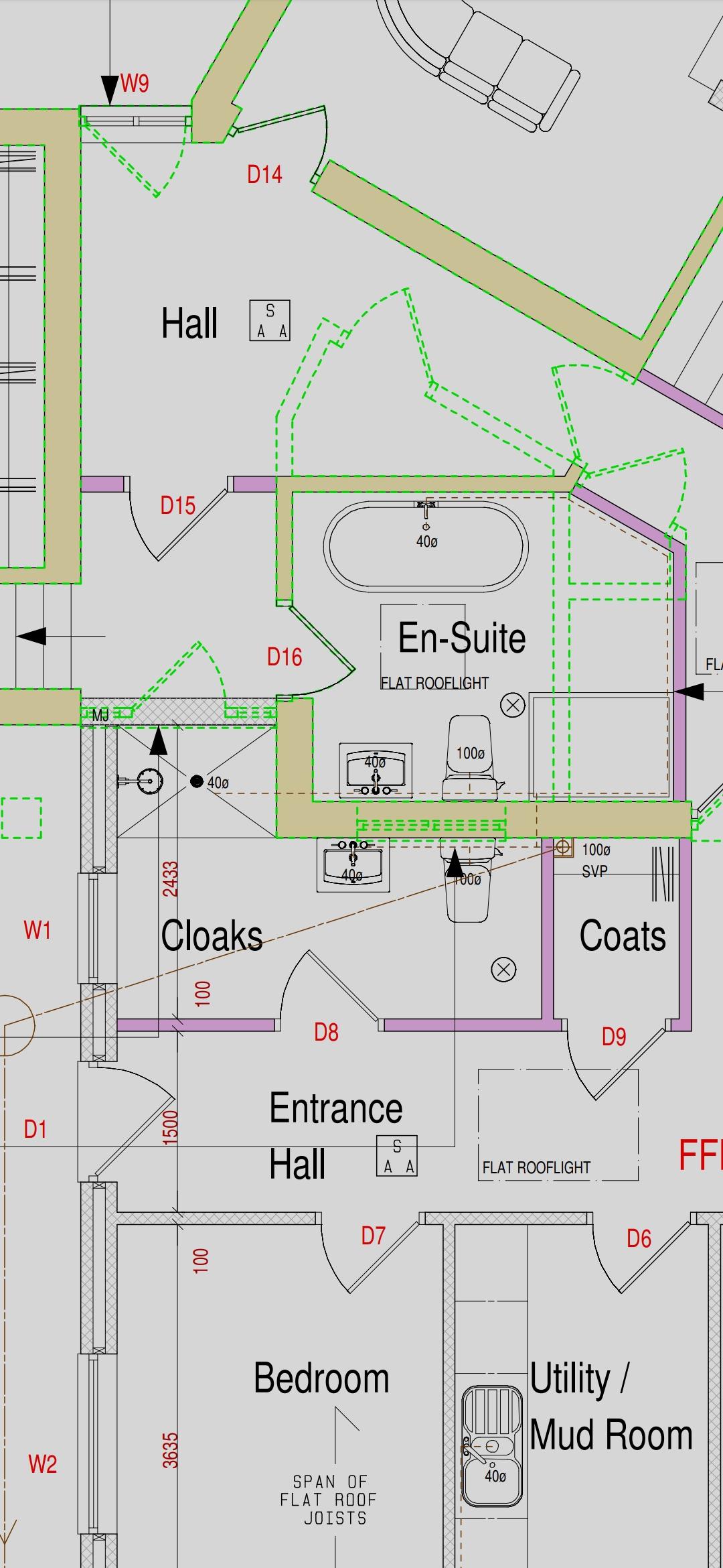

canalsiderenovation Posted April 27, 2021 Author Share Posted April 27, 2021 After the same issue last night I've just plunged the shower with the plunger @newhome recommended. Plot thickens ... Best way of me describing is by highlighting the plans with the areas. In the ensuite where the bath is, is where our shower is as we switched them round. When I plunge the shower the toilet in the cloaks makes a gurgling sound and water rises and falls so what I'm doing in the shower in the ensuite has some impact on the toilet in the cloaks! The toilet and sink in the vanity unit in the ensuite - the same room as the shower is not impacted at all strangely. 1 Link to comment Share on other sites More sharing options...
ProDave Posted April 27, 2021 Share Posted April 27, 2021 So what happens to the shower trap level when you flush the loo in the cloaks? The plan does not help much without seeing a plan of how the pipes are actually connected. Link to comment Share on other sites More sharing options...
canalsiderenovation Posted April 27, 2021 Author Share Posted April 27, 2021 8 minutes ago, ProDave said: So what happens to the shower trap level when you flush the loo in the cloaks? This.... Bit of gurgling and movement. Toilet water levels following plunging are a bit low in the ensuite too. VID_20210427_101832.mp4 8 minutes ago, ProDave said: The plan does not help much without seeing a plan of how the pipes are actually connected. Which we have asked the builder for time and time again. We have sent a sternly worded email to the builder about outstanding work, render, EWI etc and hopefully this will trigger some sort of action and this is now added to the list. Link to comment Share on other sites More sharing options...

canalsiderenovation Posted May 10, 2021 Author Share Posted May 10, 2021 After an unsuccessful visit by the plumber last week with lots of head scratching we were still waiting for a solution. Last night's toilets all started backing up and we still have the issue above but noticed the utility sink drain outside wasn't going down either. Guy who did all drains and septic tank came out today. The issue.....Get ready for this you won't believe it... When the electrician came out 19 days ago to work through some final issues/snagging he turned off the fuse to the treatment plant/pump but didn't tell anyone or turn it back on. It took 19 days of not having the treatment plant or pump working before everything slowly started to back up and not flow. Flicked switch back and hey presto everything hunky dory. Spark must have flicked it off at some point. He's coming back on Wednesday so I'll be having words! 1 Link to comment Share on other sites More sharing options...
