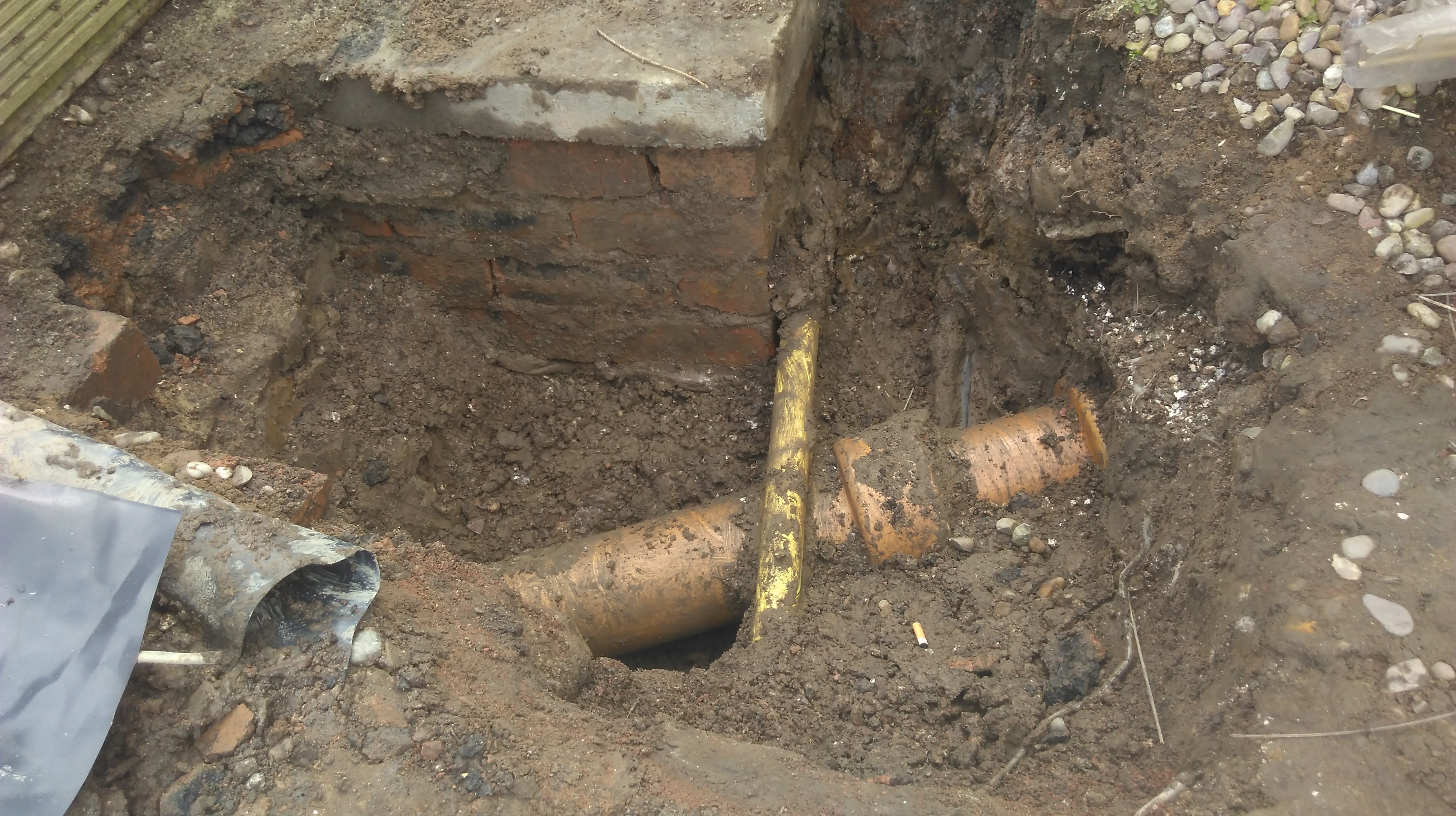

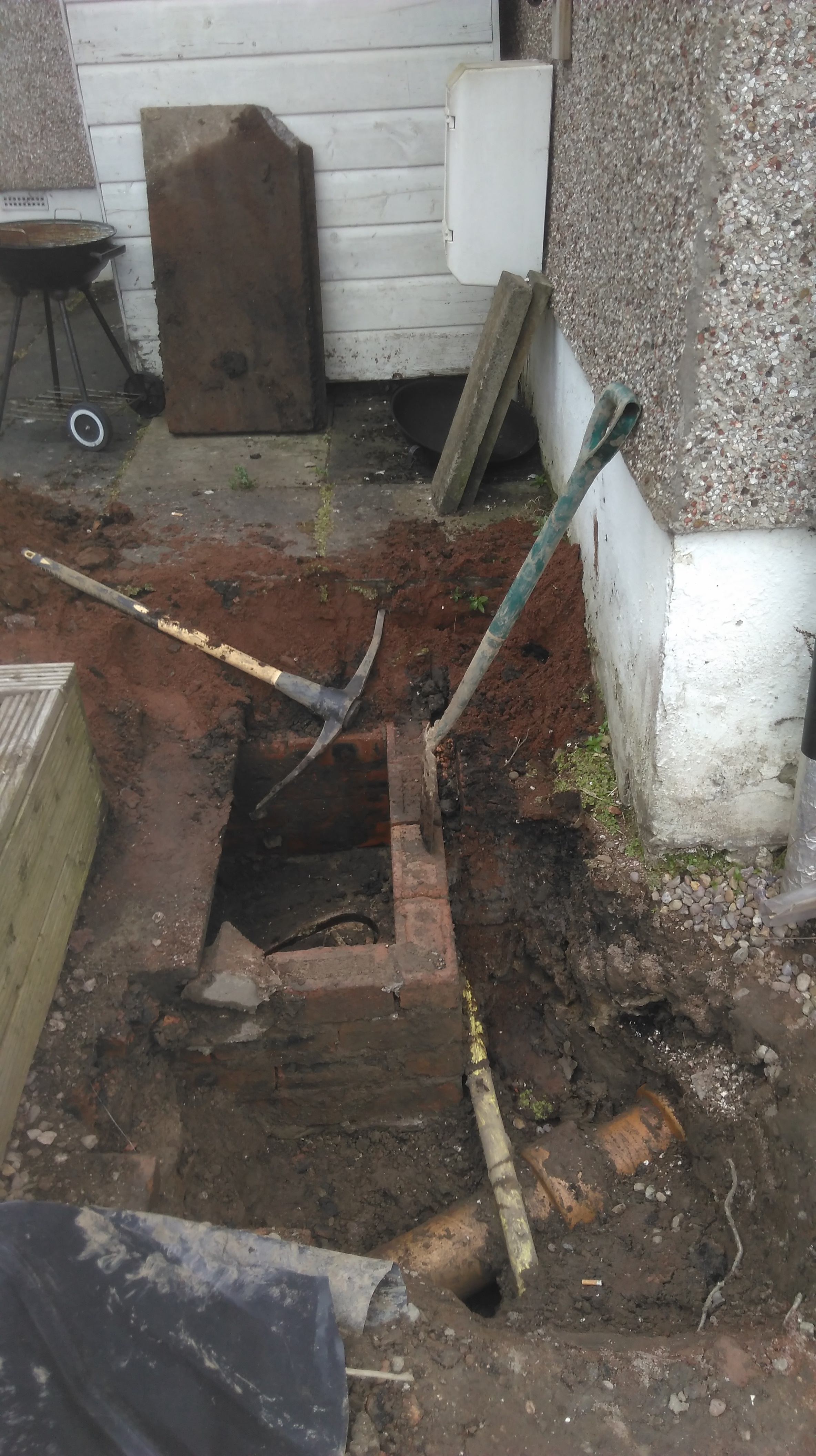

Change of plan...under the floor was never going to work. So dug first hole and found this...
New pipe will be coming in from top of the picture. Plan was to put in a branch to the left of the gas pipe and break up the brick north of it. I thought it was a foundation for an old garden wall but...
It's not!

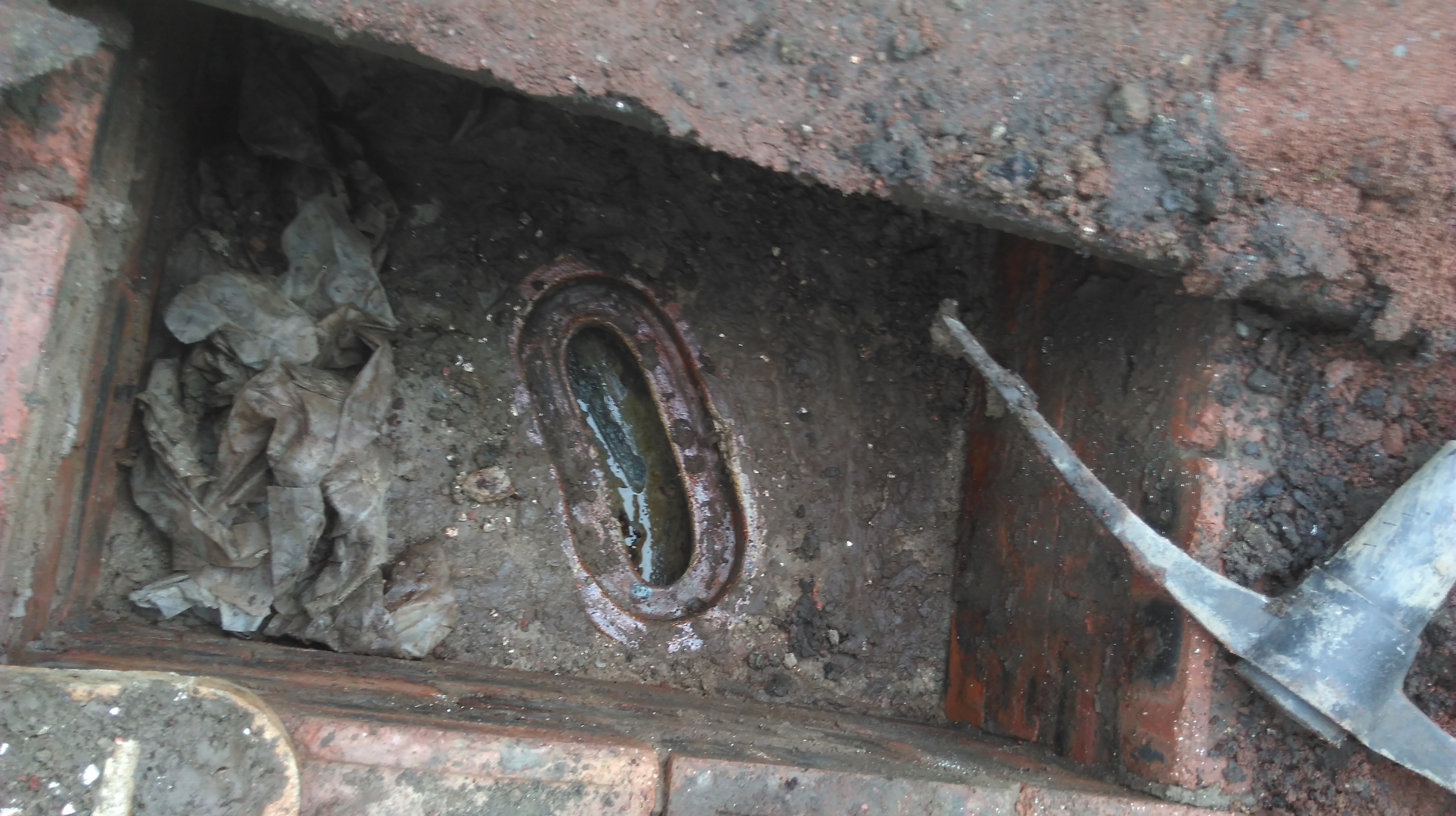

And the inside...
Now for some head scratching.
Could keep digging elsewhere and further wreck the garden or is it feasible to bring the new pvc pipe into the clay pipe and cement it all in place?

A little more digging to the right maybe to lose that clay joint to the right of the gas then TWO clay/pvc rubber couplers with your branch coming off?
Be 'kin careful with the grinder!
That in the trade is called "Jobs F*ked"......
not really, if that is a soil run you are going to need an inspection chamber anyway ( i would have thought,)
cut the clay pipe to the left and right of the gas, install a small chamber to the left of the pipe, infill to the both sides with a short length of plastic connected with an ac4000 (rubber connector)
break out and rebuild the corner of the existing chamber with a chamfer  and let the new pipe come into the 11o/c inlet of the new chamber..... Easy.
that is assuming the original run is flowing left..... if not refer to my opening line :)

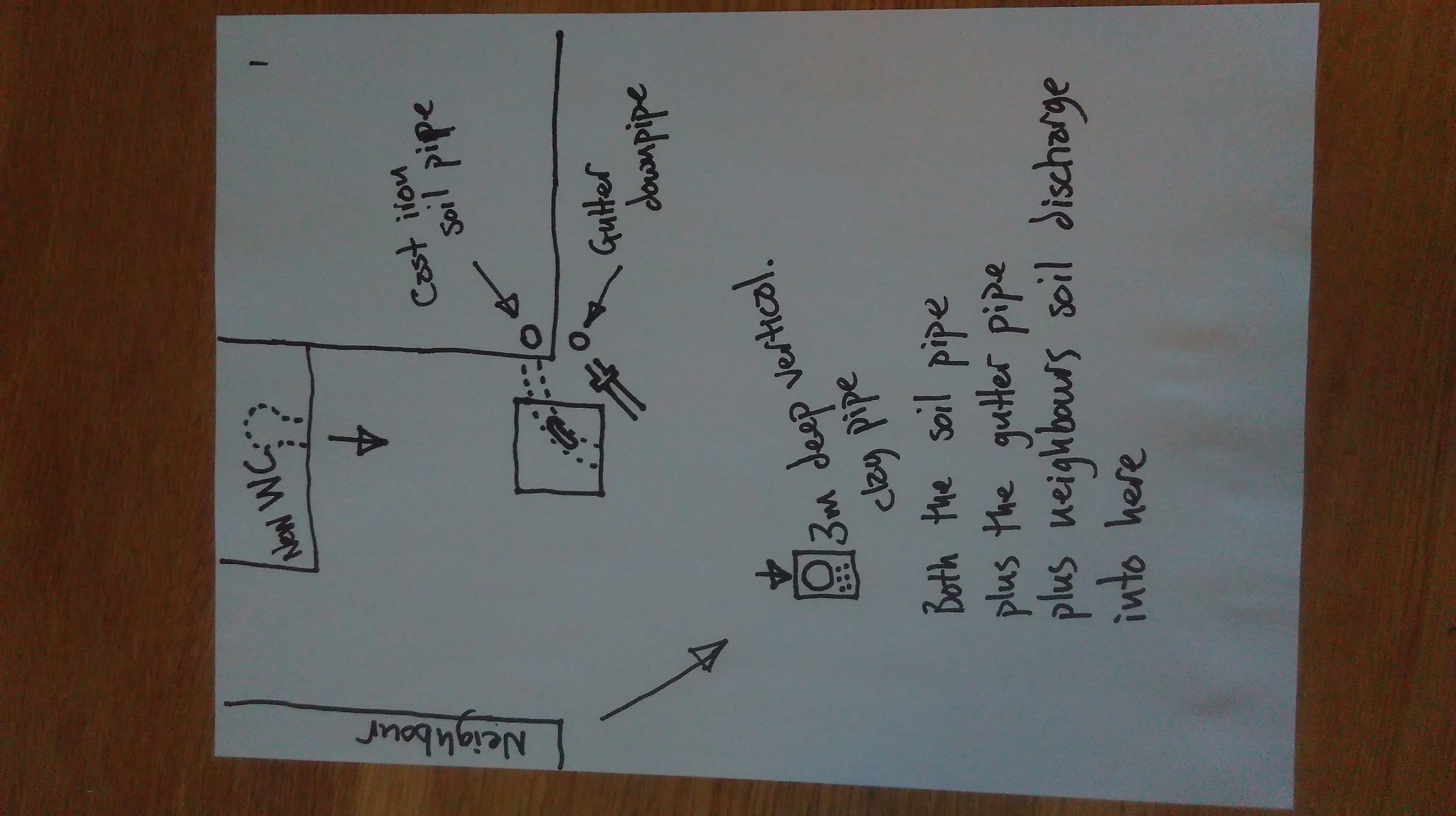

This what I think I know
The big visible clay pipe is for rainwater but runs to the same vertical sewer as the soil pipe which runs through the inspection chamber. I assume they join together before meeting the vertical pipe.
I'm thinking of removing the wall to the north of the chamber then cut a channel from that direction to fit in the new waste pipe and make good.
It will mean the deposits from the new WC will arrive at the old clay pipe exactly where the rodding cut out is situated.
Is this okay?

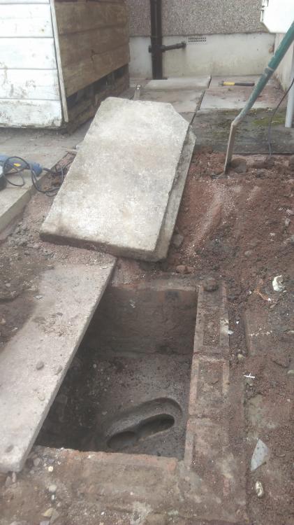

Found a guide on pavingexpert that covers this exact scenario?
The only difference from my plan is he recommends using a 13mm masonry drill bit to stitch cut a hole in the chamber wall to accept the new pipe.
Bingo?
  • 2 weeks later...

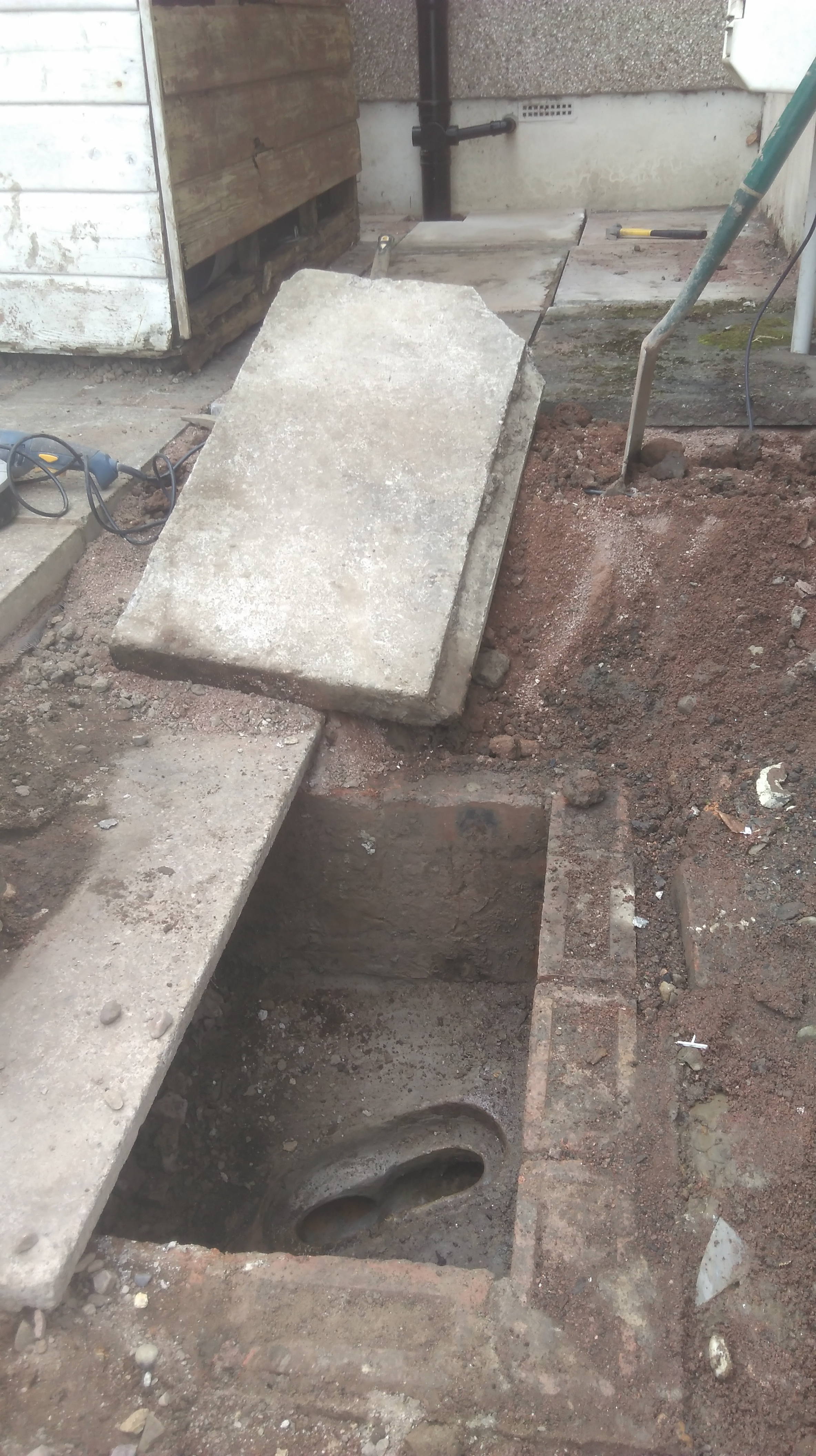

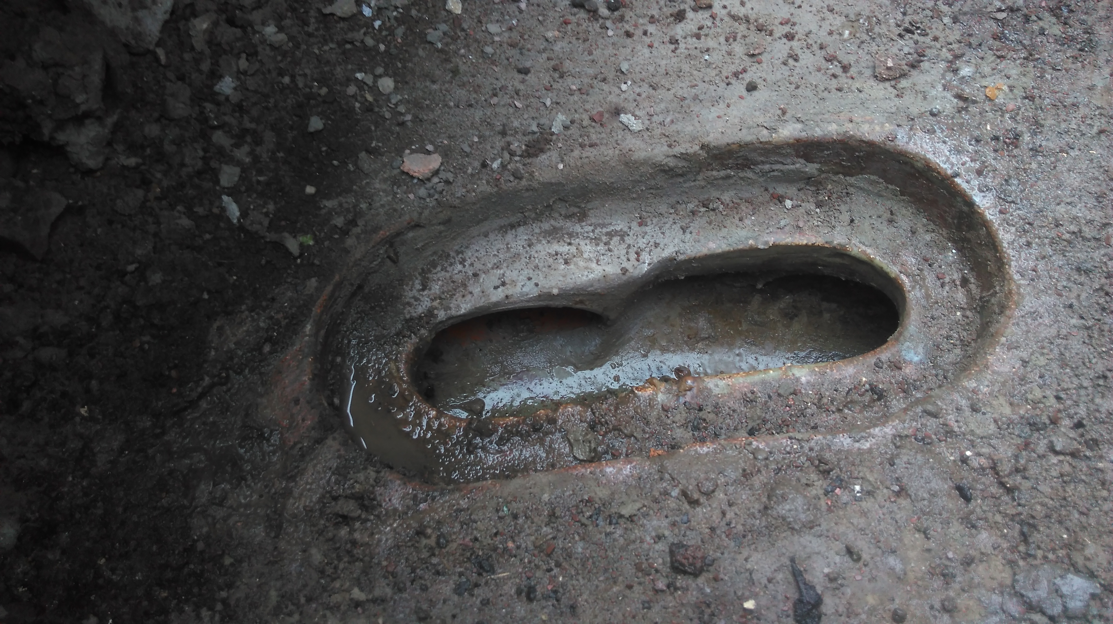

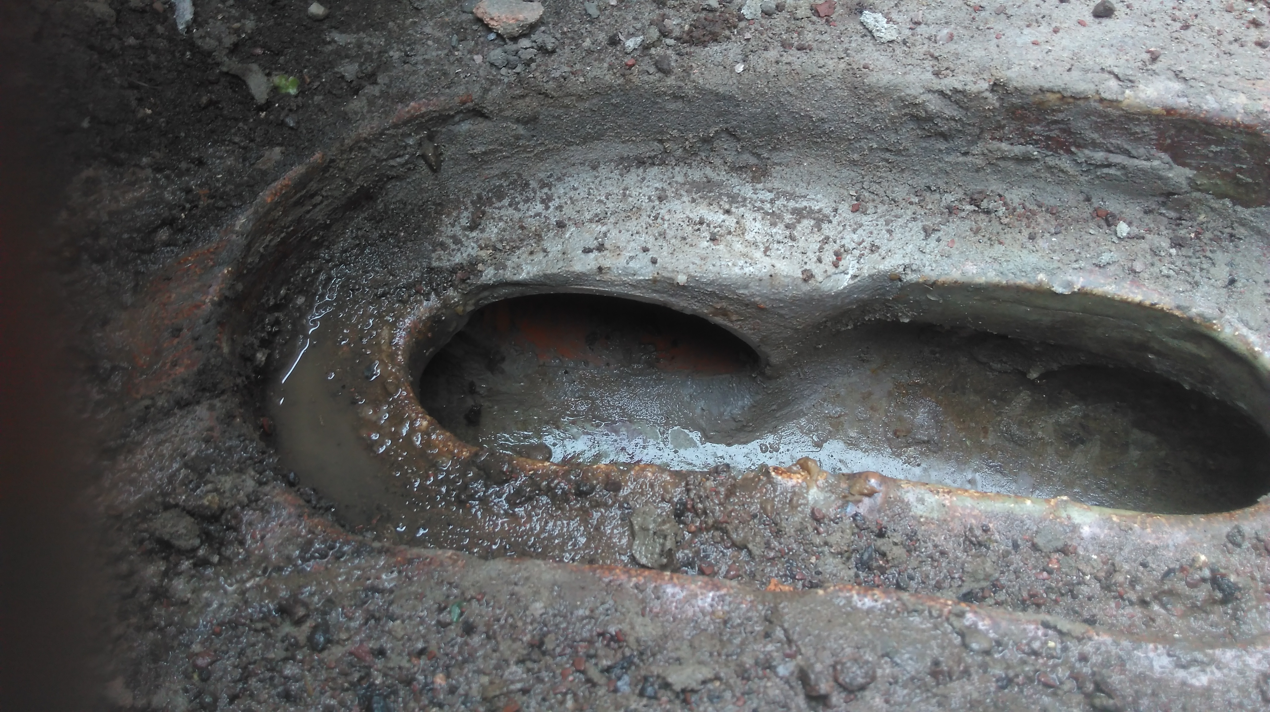

To finish this off...
Decided to excavate outside the inspection chamber and cut a hole to take the new pipe. Cold chisel, hammer and a diamond blade on an angle grinder plus lots of patience and success!
There was a great guide on paving expert website which recommend a nice flowing entry angle for the pipe making sure the bottom of the new pipe was level with the old. We used quick drying cement and did some neat sculpting once it had started to go off to make it all nice and smooth.
The flow is right to left. Think this is called a kidney...new pipe in the centre of the pic.
It's not obvious from this pic but the kidney is on a swept bend which is also dropping away underground from the new pipe entry.
Better view of the made good kidney.
And in this one you can see the 4m run up to the new WC. Only one elbow and one swept bend needed.
It's all tested and working so pretty pleased.?

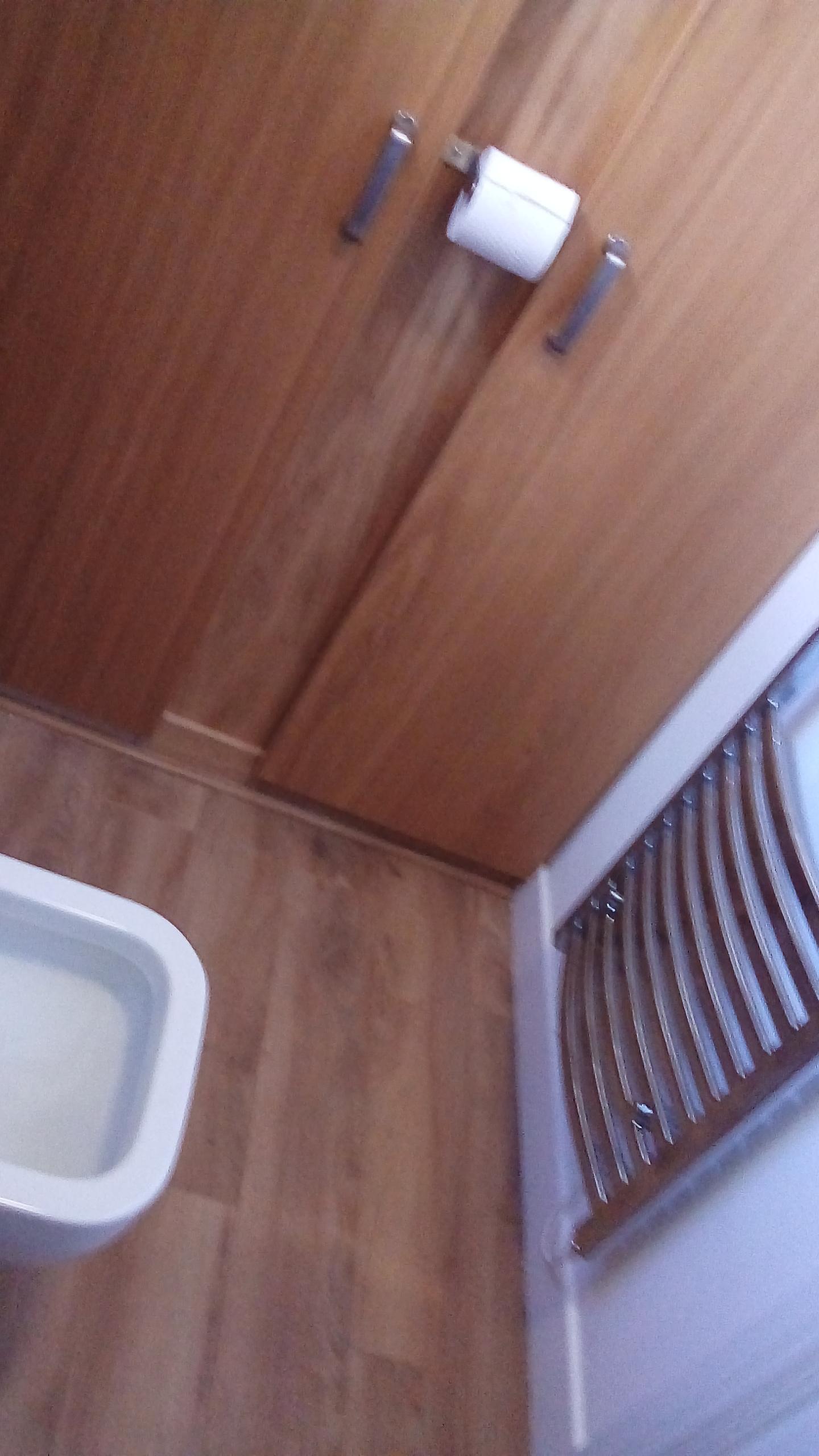

Job done...WC with nice metro tiles
Quirky WC storage made from IKEA Pax range hiding the combi boiler
