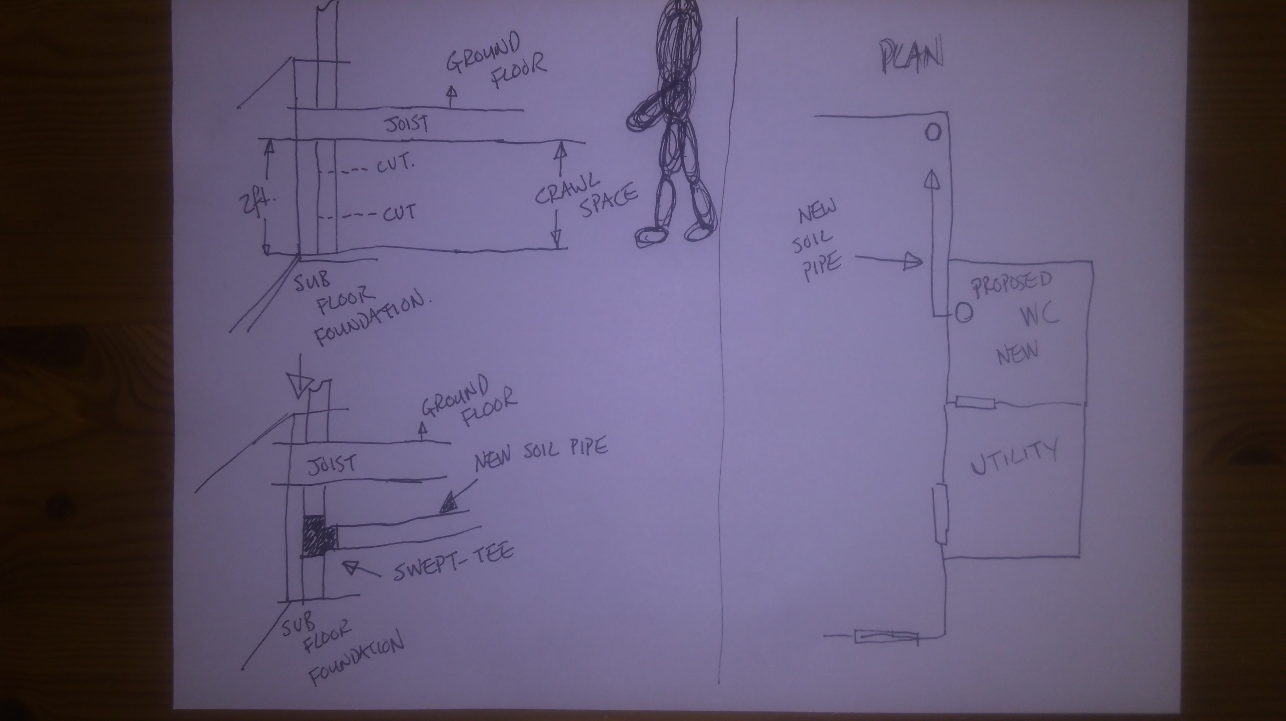

It's right in the corner (vertical stack)and under the floor with very little crawl space so no chance of using a grinder or recip saw.
Can hire a chain cutter for 33 quid and watched a couple of YouTube videos, I know, I know...
Plan is to add a plastic swept tee for the new WC and use two couplers to make the PVC/cast joint good.

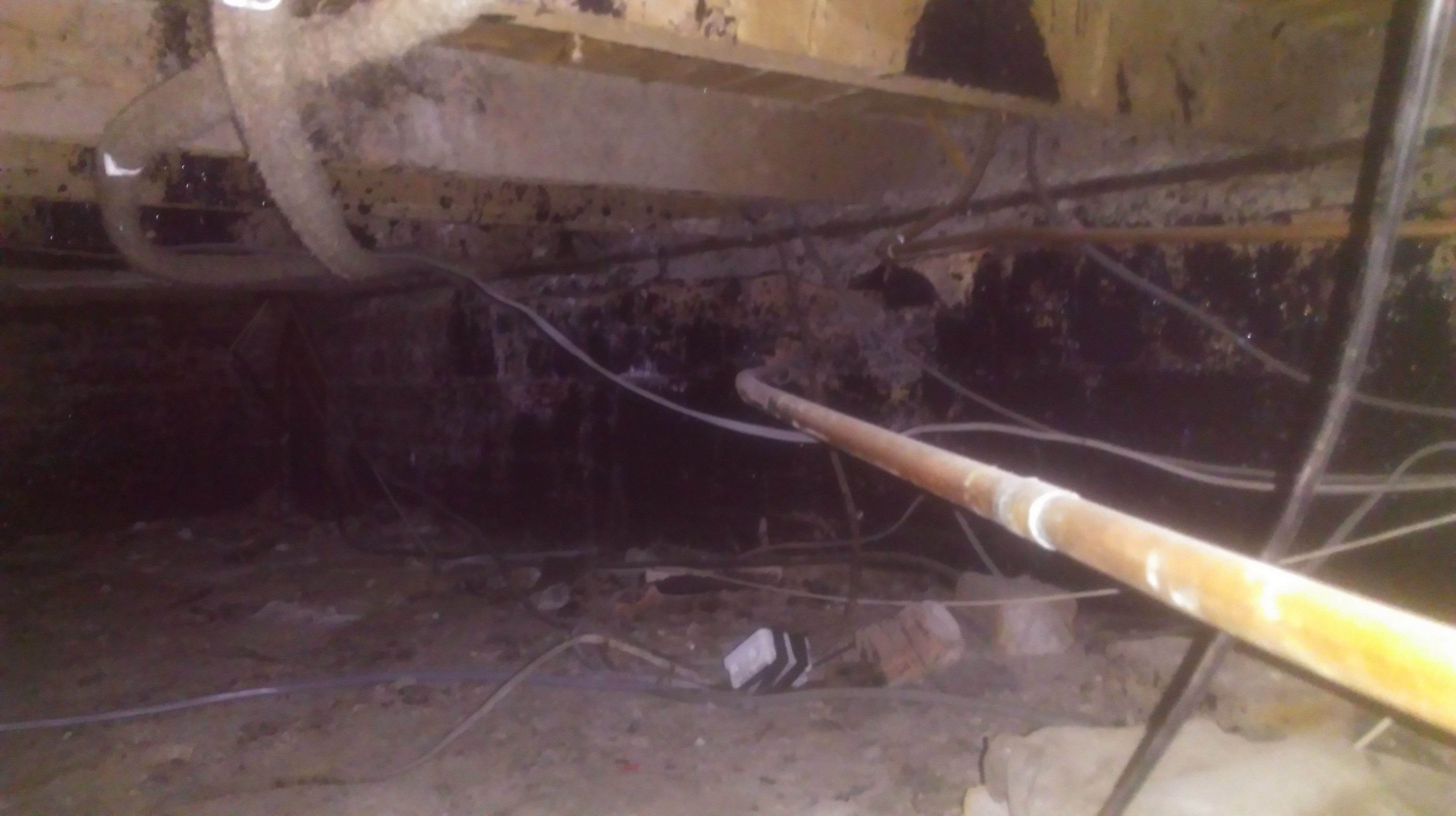

Poor pic, but you can just make out the black pipe right in the corner.

Can't see tbh whether your pipe in the corner stops short under the floor or not. Drill a hole through floor etc. Slitting disc on a bit of studding.

Ok. What's the 'headroom' under there, aka operator space?
Not a lot...under two ft and I've never been described as slight...well, to my face?

Is the existing cast iron soil pipe in use?
Assuming you're replacing above the new swept tee.... you must be otherwise you'd never get it (the tee) in.
Lop it off above the floor then use that mad old bastad's method in the video I posted to cut the pipe from the inside out. Will need to find a suitable washer to go on a slitting/cutting disc and over a length of studding.

2foot is plenty of crawl space, :ph34r:
I've rewired underfloor with less,,,,,.
Wouldn't want to be cutting a soil pipe with contents unknown stuck to the sides in that confined space,,,,. O.o
So ye, I'd go with @Onoff and cut above, then that crazy method of cutting from inside out.
