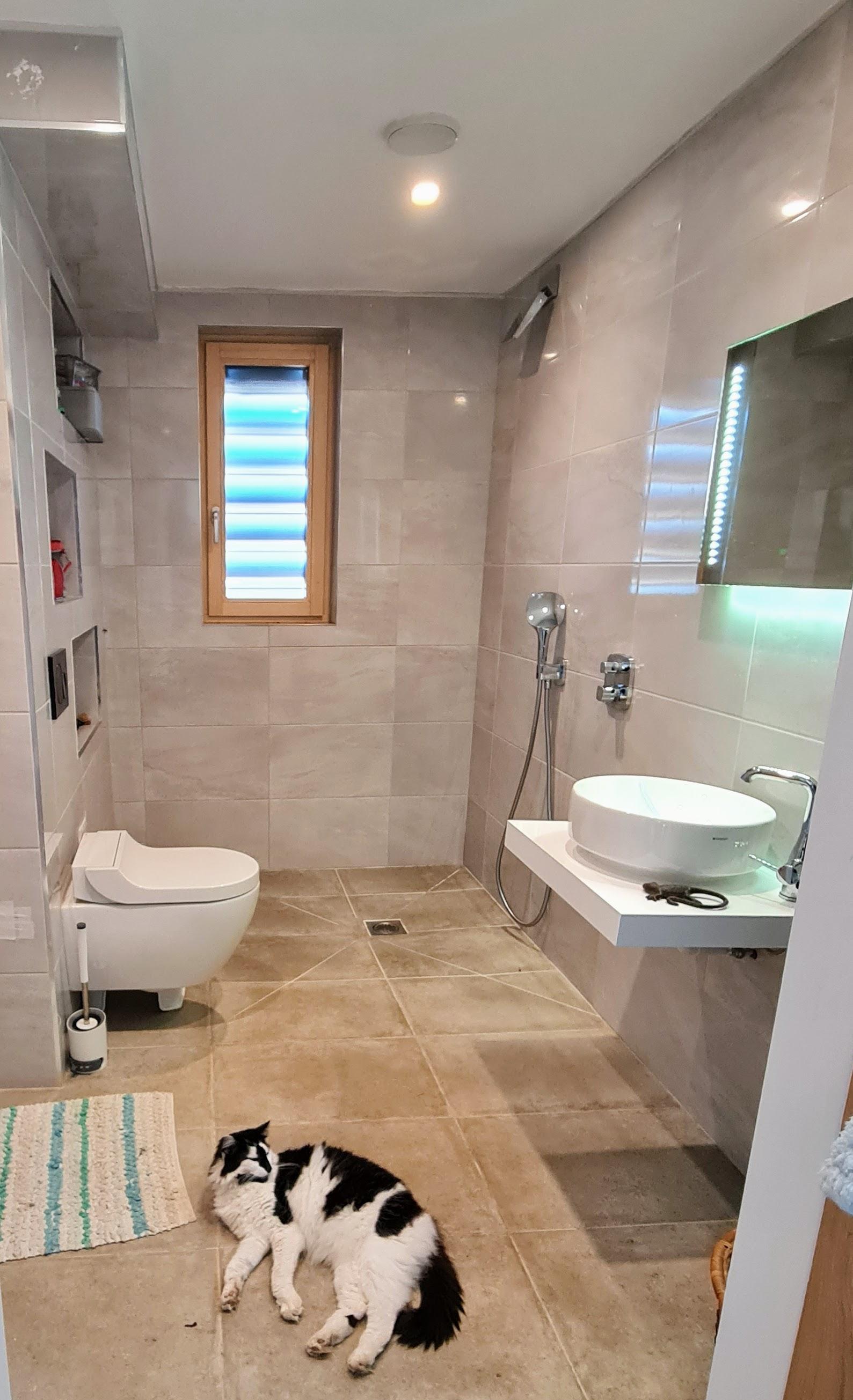

ToughButterCup Posted April 6, 2021 Posted April 6, 2021 (edited) 23 hours ago, MortarThePoint said: ... If you want the warm feet feeling, a 1.5m2 electric UFH mat just in front of the bath/shower could cost around £35. It could come one when the light turns on and draw 225W whilst running and cost £12/year based on 1hour per day ... Is what worth it? What are you measuring? Money? Comfort? The smile on your partner's face? The non-slipiness of the dry patch? The cat's comfort? Yes, you guessed correctly: The bath mat is over an unheated area, Sid (never heard him hiss yet) is on the warm area. This is our downstairs wet room. Upstairs exactly the same arrangement 23 hours ago, MortarThePoint said: ... It's a lot of effort to go to really for the benefit since all our living space is downstairs. It feels too brave to omit it completely though. ... Exactly right. The psychological effect of warmth in a wet room is greater there than anywhere else because most of us shower with no clothes on. It takes a day for ther floor to heat up fully: switch it on for just an hour as you suggest, and we would feel nearly no benefit. You can feel a slight temperature difference where the mat ends ( or begins) I'm willing to pay a lot more for the comfort glow that a really warm wetroom floor gives. It's not just about money. Edited April 6, 2021 by ToughButterCup 3
markc Posted April 6, 2021 Posted April 6, 2021 Got to agree with the above, if you want to experience pure bliss, watch a cat sprawl out on heated tiles, also feels really nice under foot
