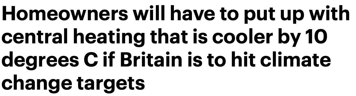

AliG Posted April 5, 2021 Share Posted April 5, 2021 (edited) https://www.dailymail.co.uk/news/article-9436091/Homeowners-turn-radiators-10C-Britain-hit-climate-change-targets.html Even for the DM this is particularly stupid. I am sure it is just to pander to the commenters and clickbait. Read the comments for a laugh/cry. Edited April 5, 2021 by AliG Link to comment Share on other sites More sharing options...
ProDave Posted April 5, 2021 Share Posted April 5, 2021 Yes the headline is moronic. BUT it actually discusses the issue faced with swapping every house from a gas boiler to a heat pump, highlighting that in most cases it is a LOT more than just swap the boiler for a heat pump. Unless we get this discussion and understanding, there are going to be a lot of houses with poor heat pump systems and they really will have houses that cannot get warm enough in very cold weather. Those of us with modern well insulated houses successfully being heated by small ASHP's even in cold climates show it can be done, but the elephant in the room is such a huge amount of the UK housing stock is anything but well insulated and airtight, and that is where the serious money needs to be spent to address that. But how. I often feel a 21st century "slum clearance" is needed to flatten and rebuild some of the worst housing, but I can't see it happening. Instead we will bumble along carefully avoiding that elephant and thus not making so much of a difference to energy use and CO2 emissions. And this quote However one of the Government's flagship plans to support homeowners in going green last month fell flat, when ministers scrapped the Green Homes Grant after just six months. The £1.5bn programme offered households grants of up to £5,000 or £10,000 to put in insulation or low-carbon heating. While the initial uptake was good, with more than 123,000 applications for the grant by the end of February, only 28,000 vouchers were issued. And of those, only 5,800 energy efficiency measures had been installed. Red tape was blamed as one of the reasons for the failure of the scheme. Does not give me ANY confidence that a government run scheme will ever be able to solve the problem. We (the government) just seem incapable of managing such a thing. 3 Link to comment Share on other sites More sharing options...
