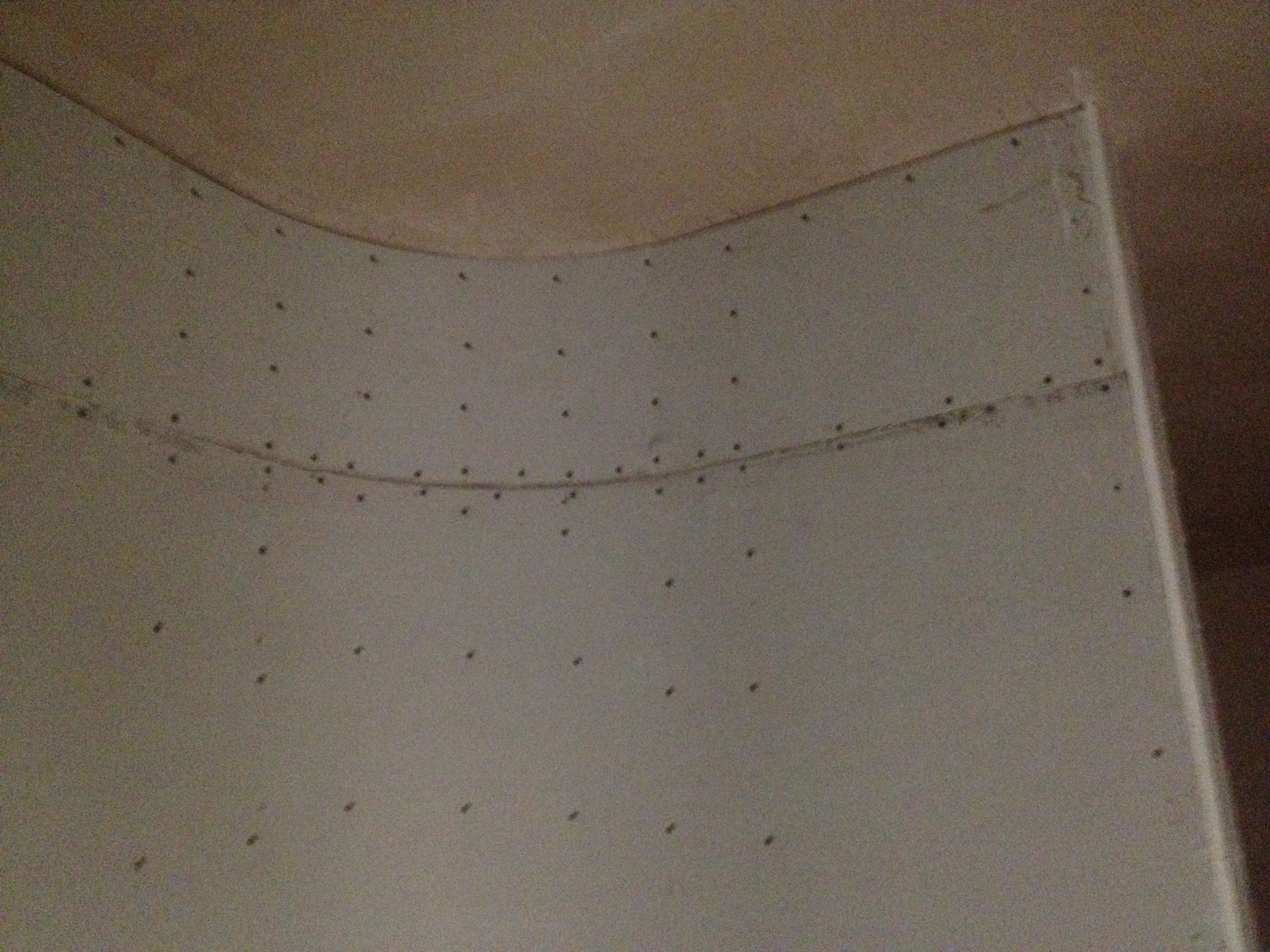

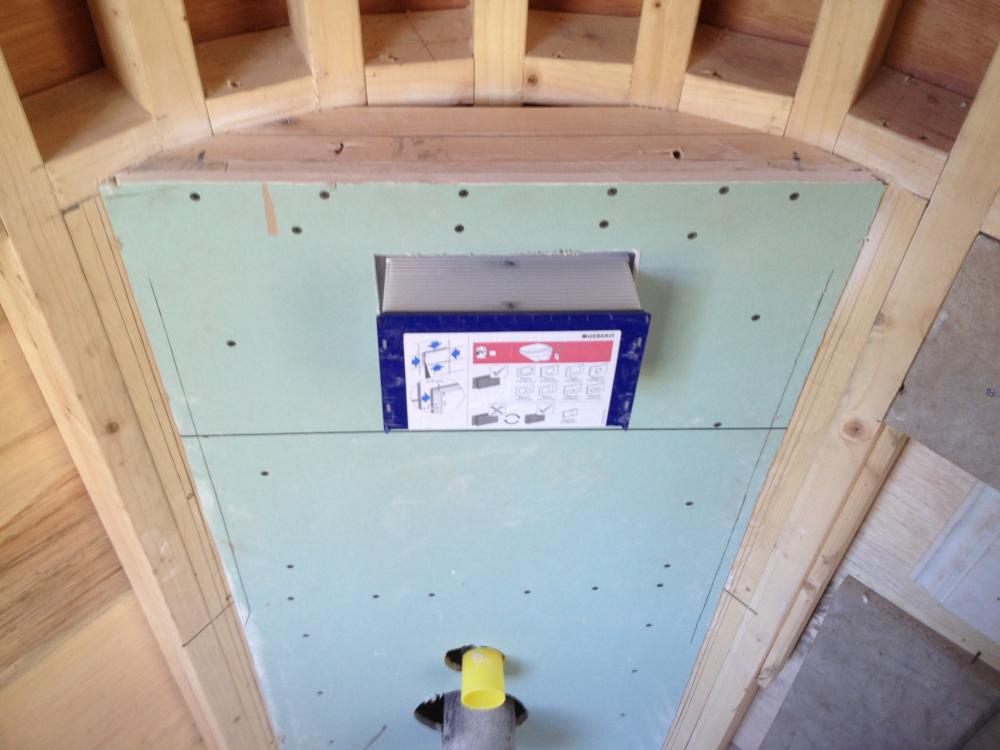

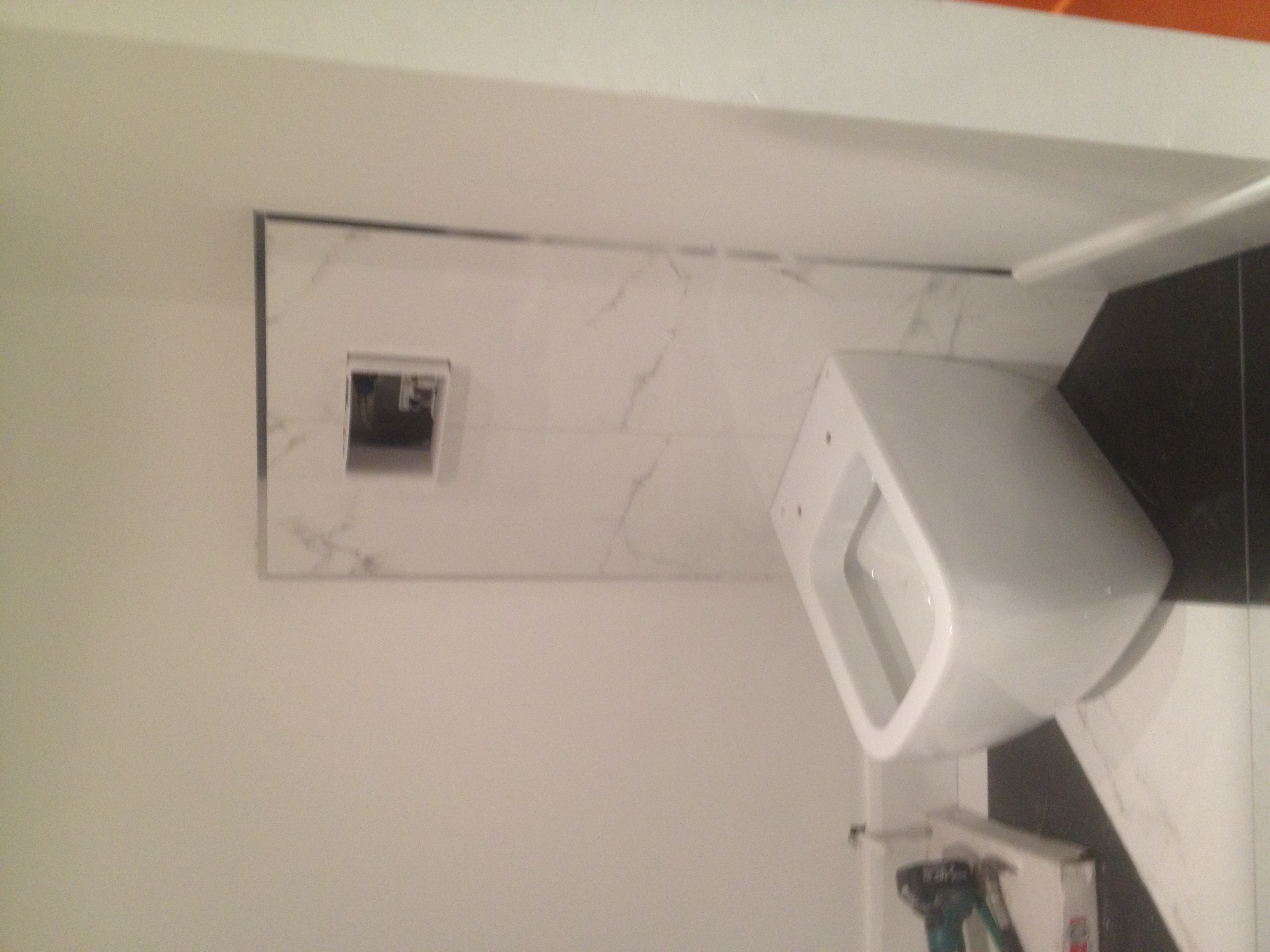

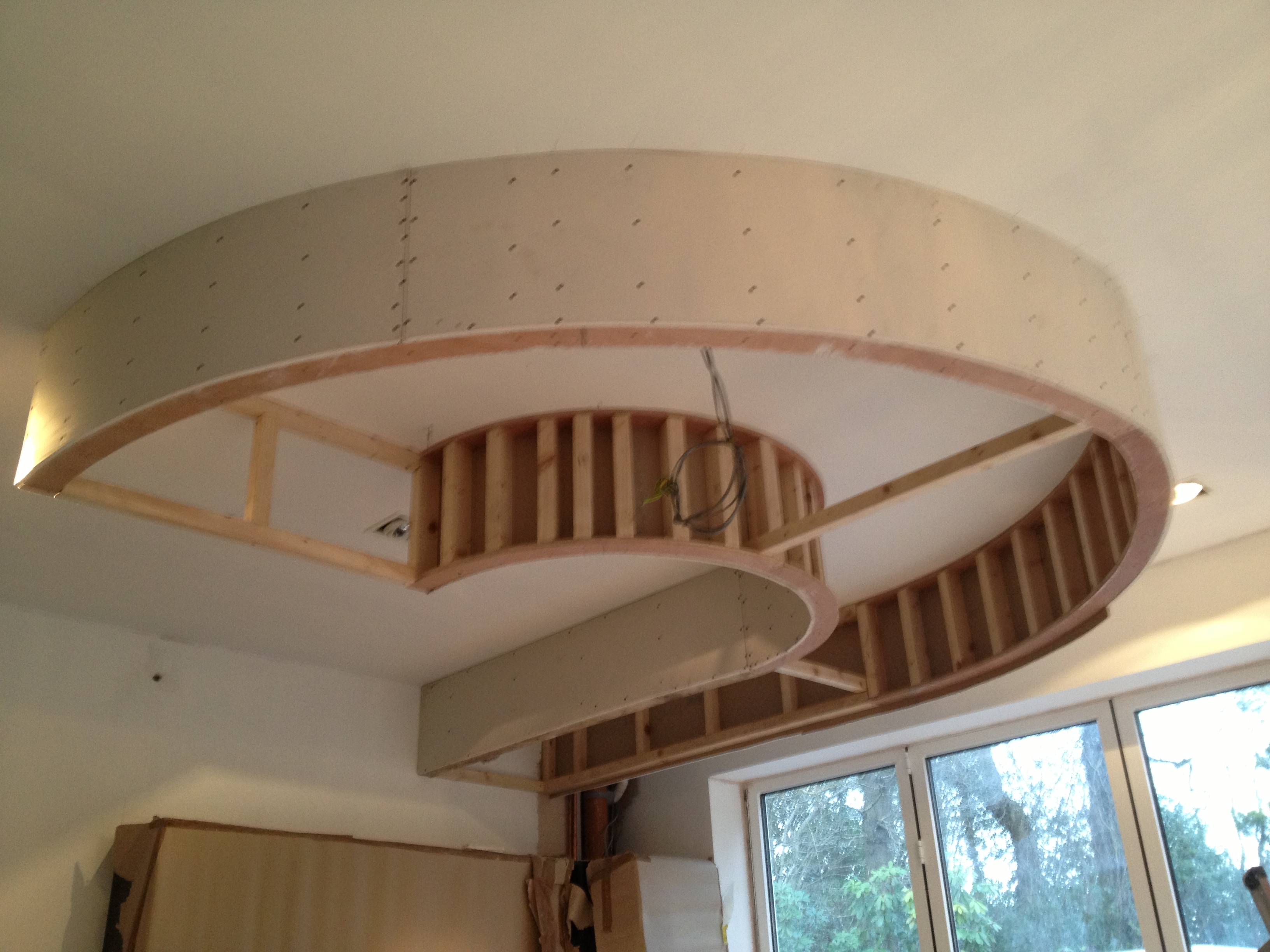

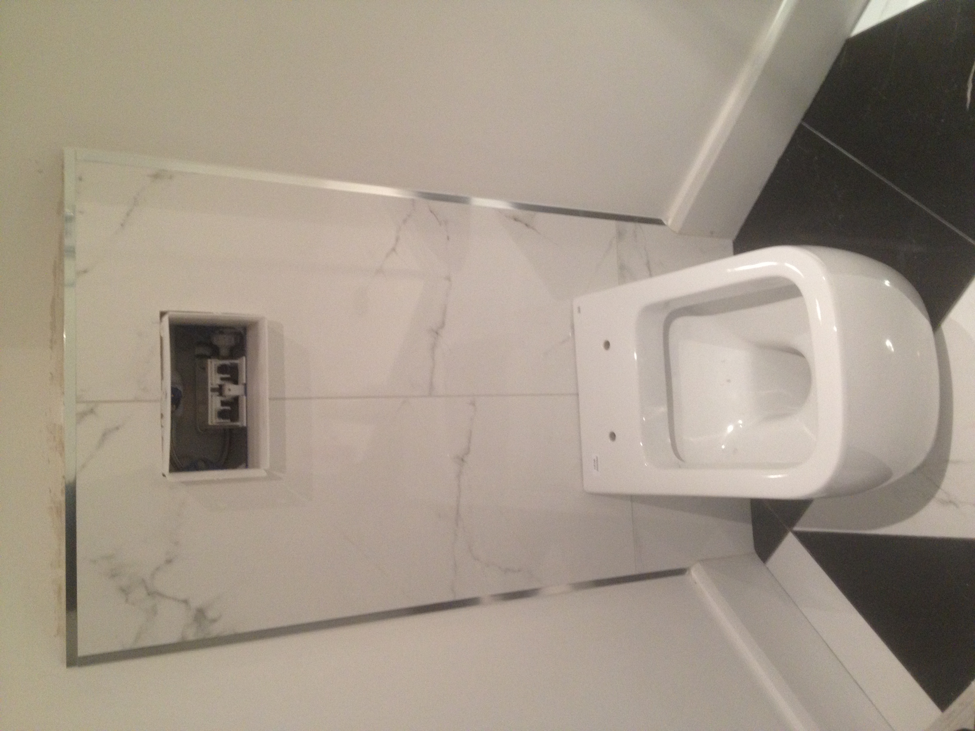

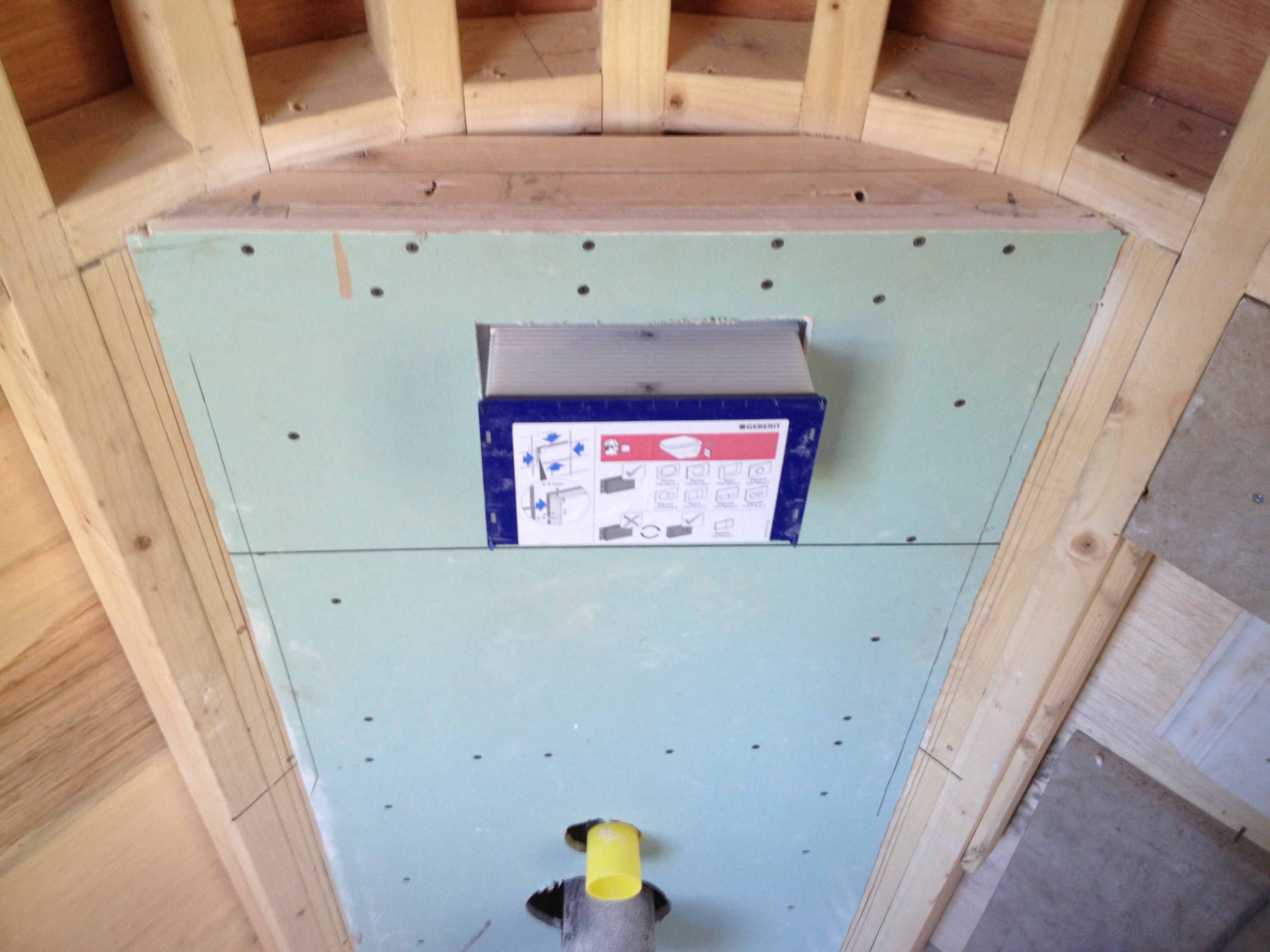

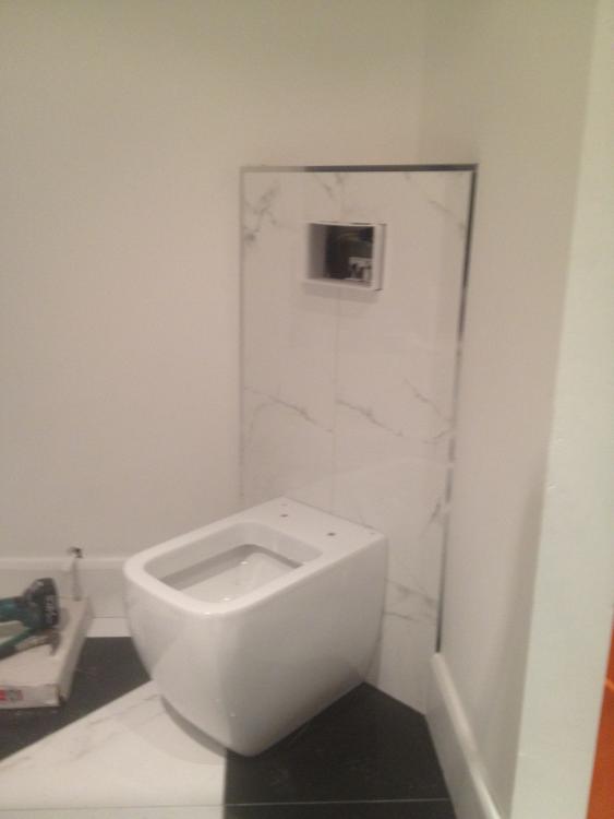

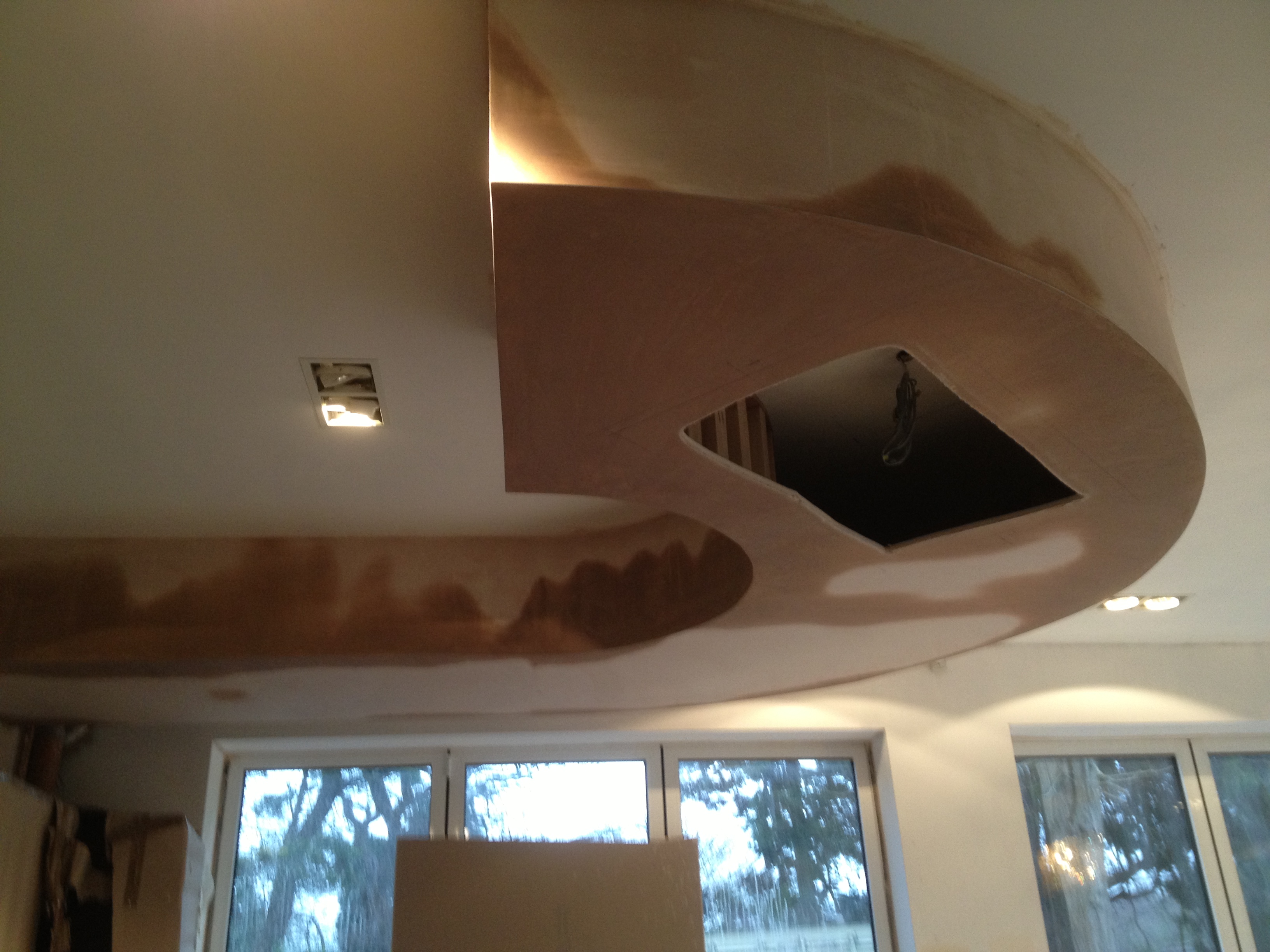

IMG_1324.thumb.JPG.a8de45c01217b19bed1e383d8bf1de83.JPGIMG_1327.thumb.JPG.899c55d9b5b43fbacbb05b7f8593189e.JPGIMG_1326.thumb.JPG.a3dcb4a6747f12b5bd67b8ac167385ba.JPG
Did this to get a BFO extractor in below pozi-joists. 9mm PB wetted both sides 5 mins before fitting. Internal radius done in 4 pieces.

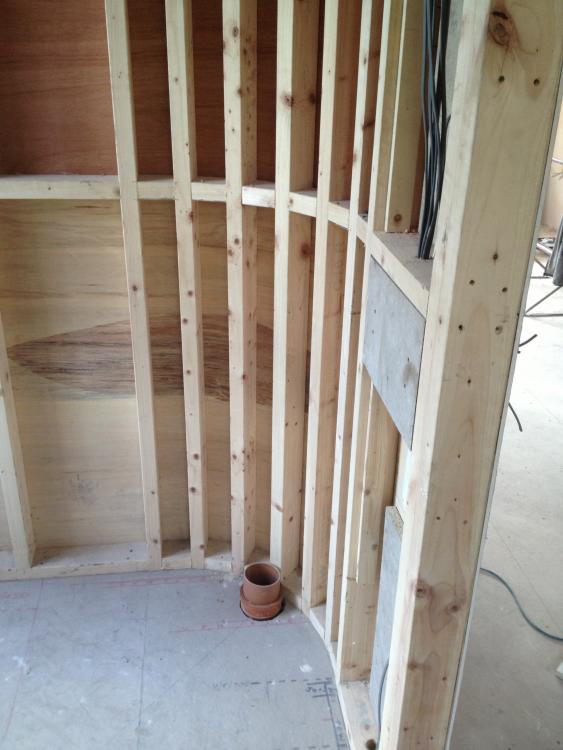

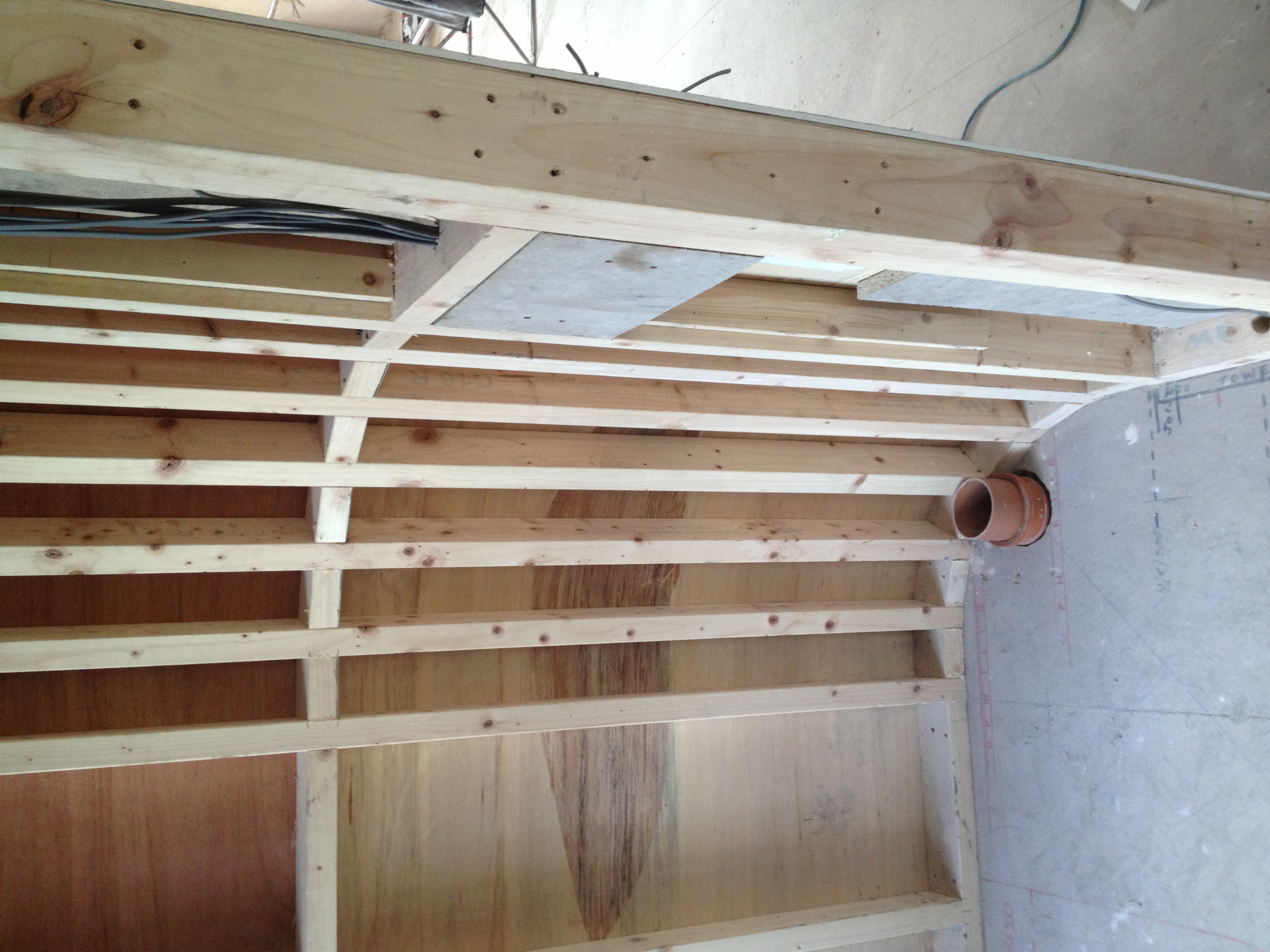

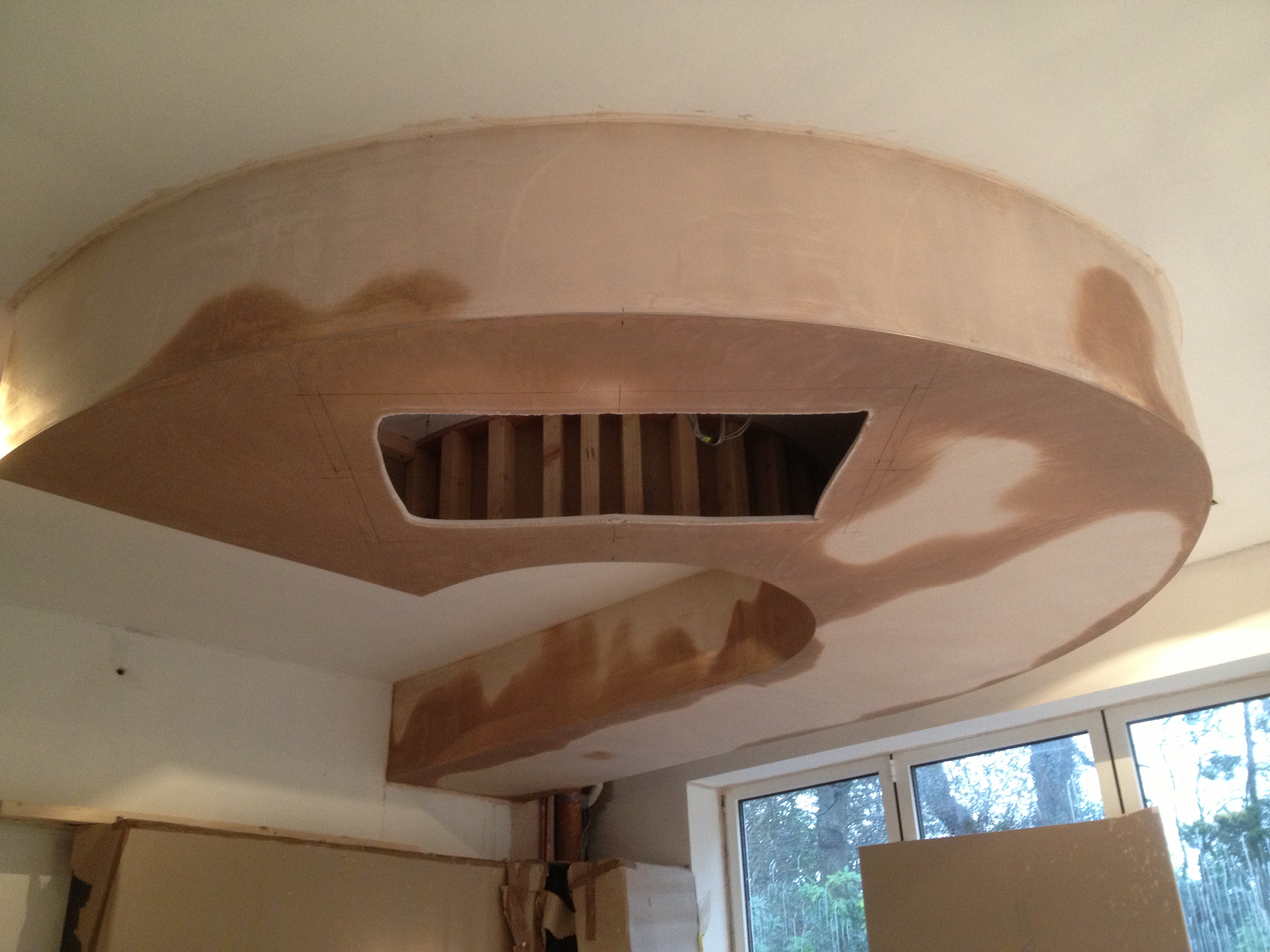

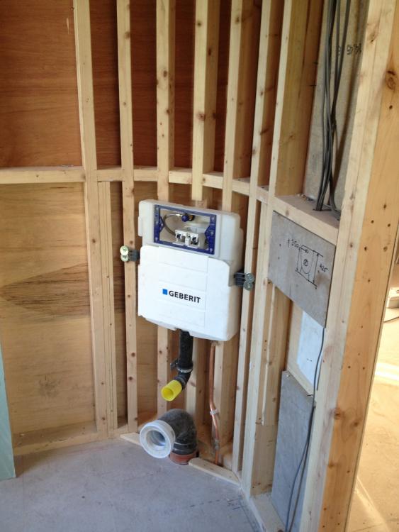

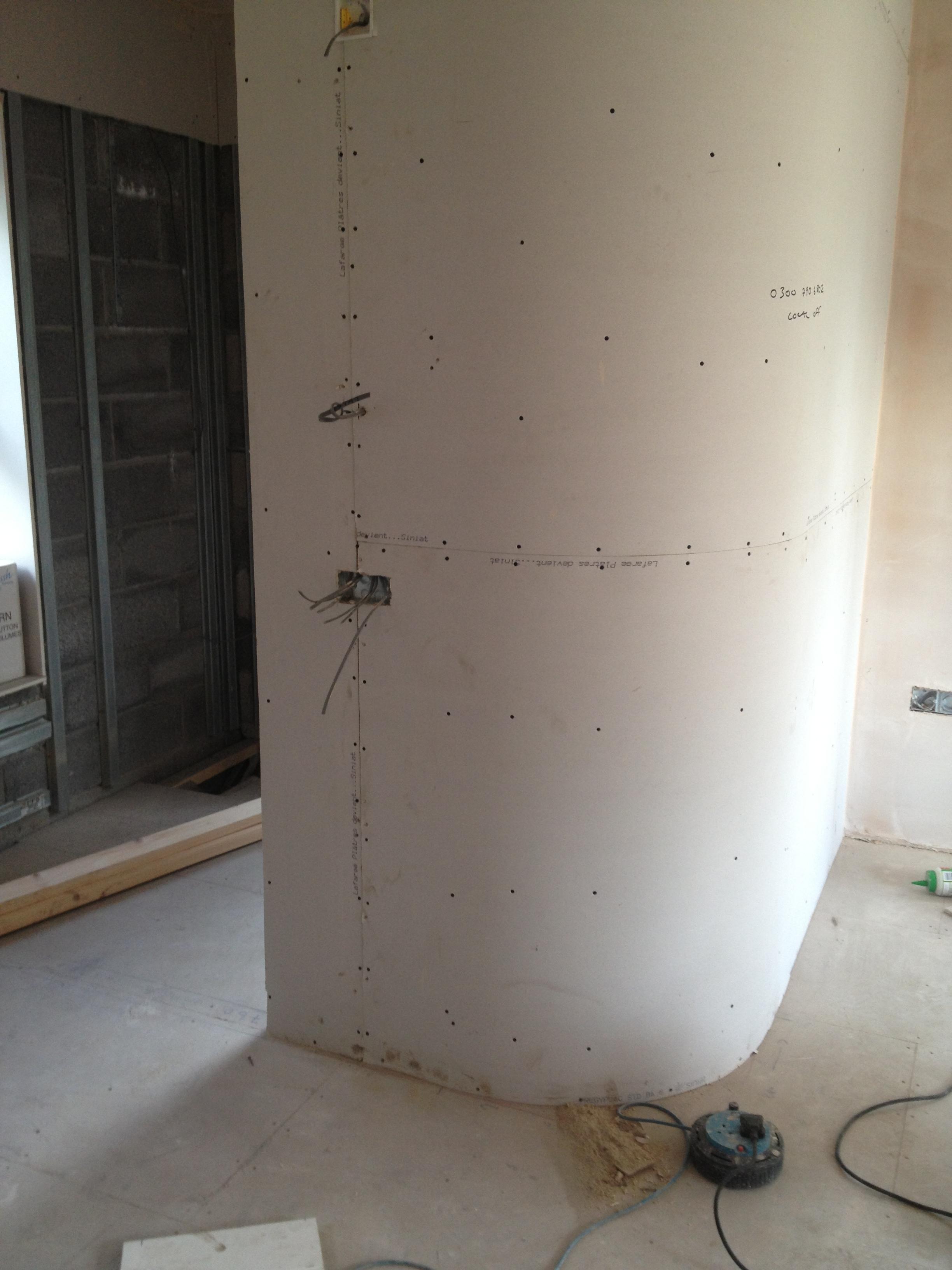

IMG_1204.thumb.JPG.8c29419204933cec91b75883714c9a09.JPGIMG_1206.thumb.JPG.2b0f8b45251800f06b03b9ed5267b8a8.JPGIMG_1211.thumb.JPG.ea507923df733c2874c2c5b904ece6b9.JPGIMG_1215.thumb.JPG.53b29b4e3259d0b26973749a2abc4a2d.JPGIMG_1220.thumb.JPG.46c8a9d833ab830e4a497e0838929942.JPGIMG_1199.thumb.JPG.e54fef1445418f0ad7e8a1e54ba6f822.JPGIMG_1314.thumb.JPG.6c8d00b1f2fa748f47358f5d17e7d64e.JPG

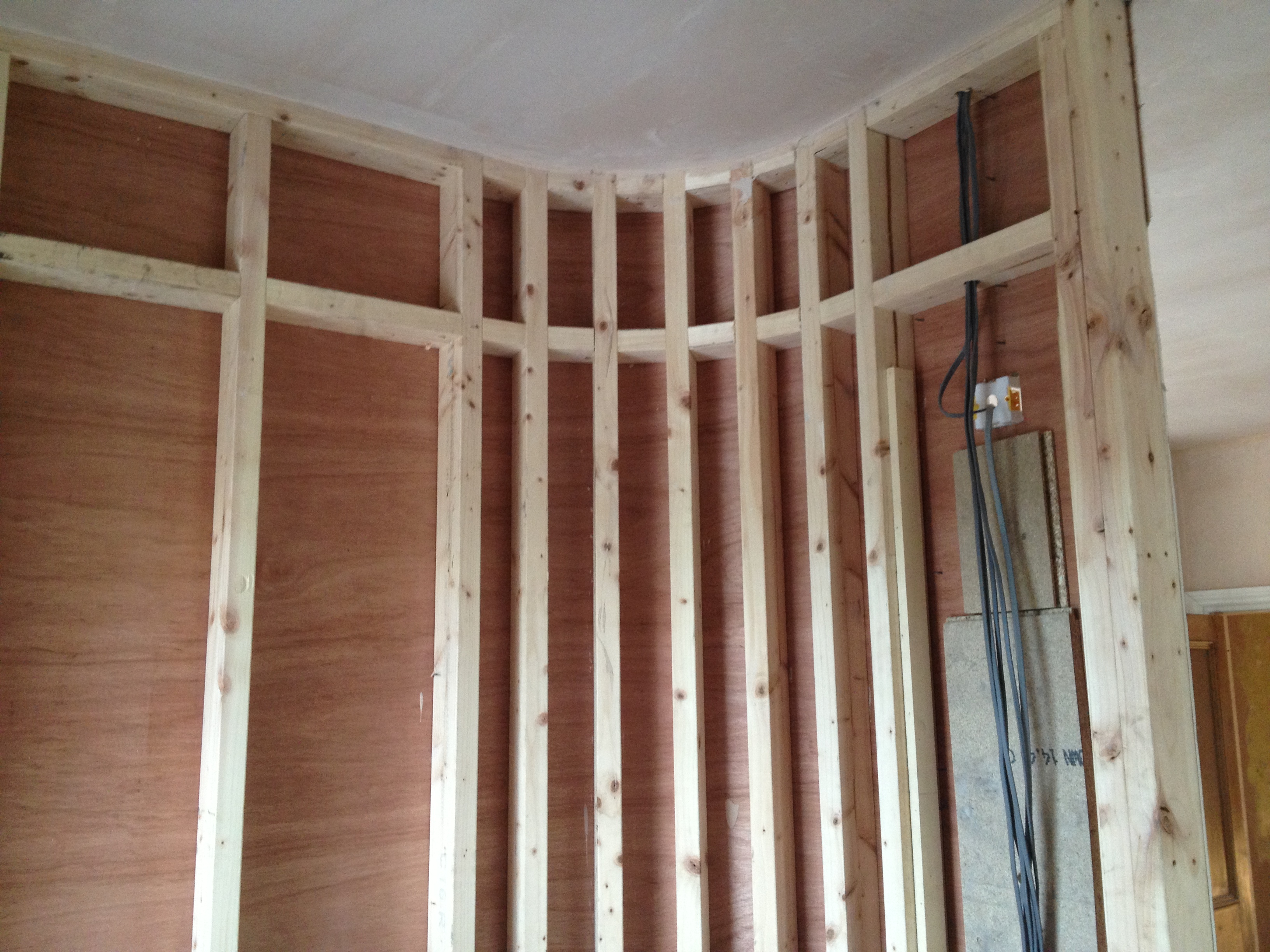

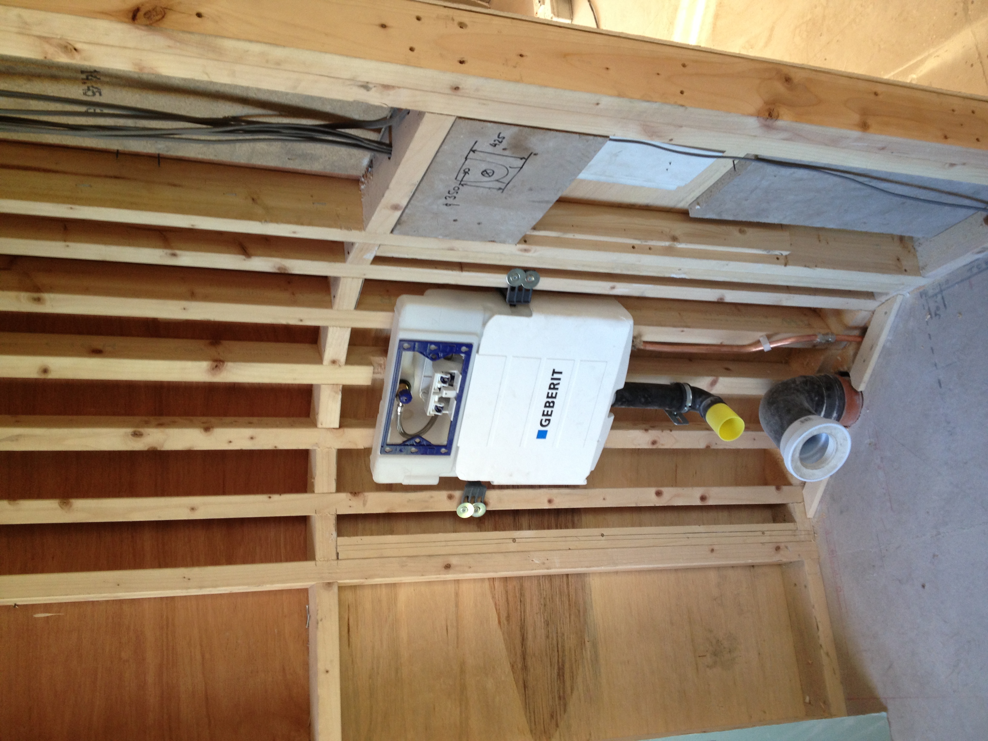

This was in the ensuite upstairs. Formed with 4x2" and double boarded with 4mm ply. I soaked the ply ( dripping wet ) for a couple of hours and then rolled the 2 sheets up then ratchet strapped them overnight to dry. Straps came off and they retained about 50% of the curve so happy days.
The PB was special order 6mm and that was wetted both sides and left to stand up against the wall, getting further wetted by brush where I wanted the radius, throughout the day. Just wet it and push against it, leave for an hour and repeat. The weight of the board pushes down and helps. Prop the top of the PB with a dead man ( timber T piece ) so it can't fall over ;)
Easier to do than most think. ?
