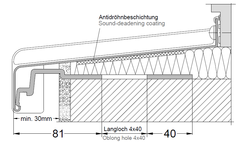

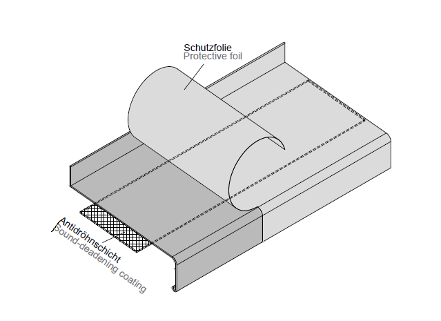

craig Posted March 26, 2021 Share Posted March 26, 2021 (edited) 6 hours ago, jack said: Big drops fall off the head of the window onto the cill. They're more annoying than the general sound of rain because they're a lot louder, You need the dampener, severely reduces the impact but it’s very rare they are supplied Certainly with the cills we supply, not all alu cills with have this option. Edited March 26, 2021 by craig Link to comment Share on other sites More sharing options...
jack Posted March 26, 2021 Share Posted March 26, 2021 3 minutes ago, craig said: You need the dampener, severely reduces the impact but it’s very rare they are supplied Is the dampener a layer of nitrile-rubber-like material stuck to the underside? If so, we have that. Still loud, although I do find noise very distracting in general. Link to comment Share on other sites More sharing options...
Roundtuit Posted March 26, 2021 Share Posted March 26, 2021 We've got Rationel aluminium cills, and I've never noticed any rain noise. If this is one of those things that you can't ignore once someone has pointed it out, I'm gonna be well pi$$ed off with you lot? Back to the OP; if you're having a timber frame with brick outer skin, then I expect the cills will go on after the brickwork. (My windows didn't go in until the brickwork was finished). 1 Link to comment Share on other sites More sharing options...
craig Posted March 26, 2021 Share Posted March 26, 2021 21 minutes ago, jack said: Is the dampener a layer of nitrile-rubber-like material stuck to the underside? If so, we have that. Still loud, although I do find noise very distracting in general. More like an insulation material that goes underneath. I’ll get the detail to show you. 1 Link to comment Share on other sites More sharing options...
jack Posted March 26, 2021 Share Posted March 26, 2021 46 minutes ago, Roundtuit said: We've got Rationel aluminium cills, and I've never noticed any rain noise. If this is one of those things that you can't ignore once someone has pointed it out, I'm gonna be well pi$$ed off with you lot Why should I suffer alone? 2 Link to comment Share on other sites More sharing options...
craig Posted March 27, 2021 Share Posted March 27, 2021 (edited) @jack It is a strip, but when insulated underneath also, has a much bigger difference. Edited March 27, 2021 by craig 1 Link to comment Share on other sites More sharing options...
jack Posted March 28, 2021 Share Posted March 28, 2021 Thanks @craig. No, we definitely don't have anything like that. We just have the strip of "sound-deadening coating". Link to comment Share on other sites More sharing options...
