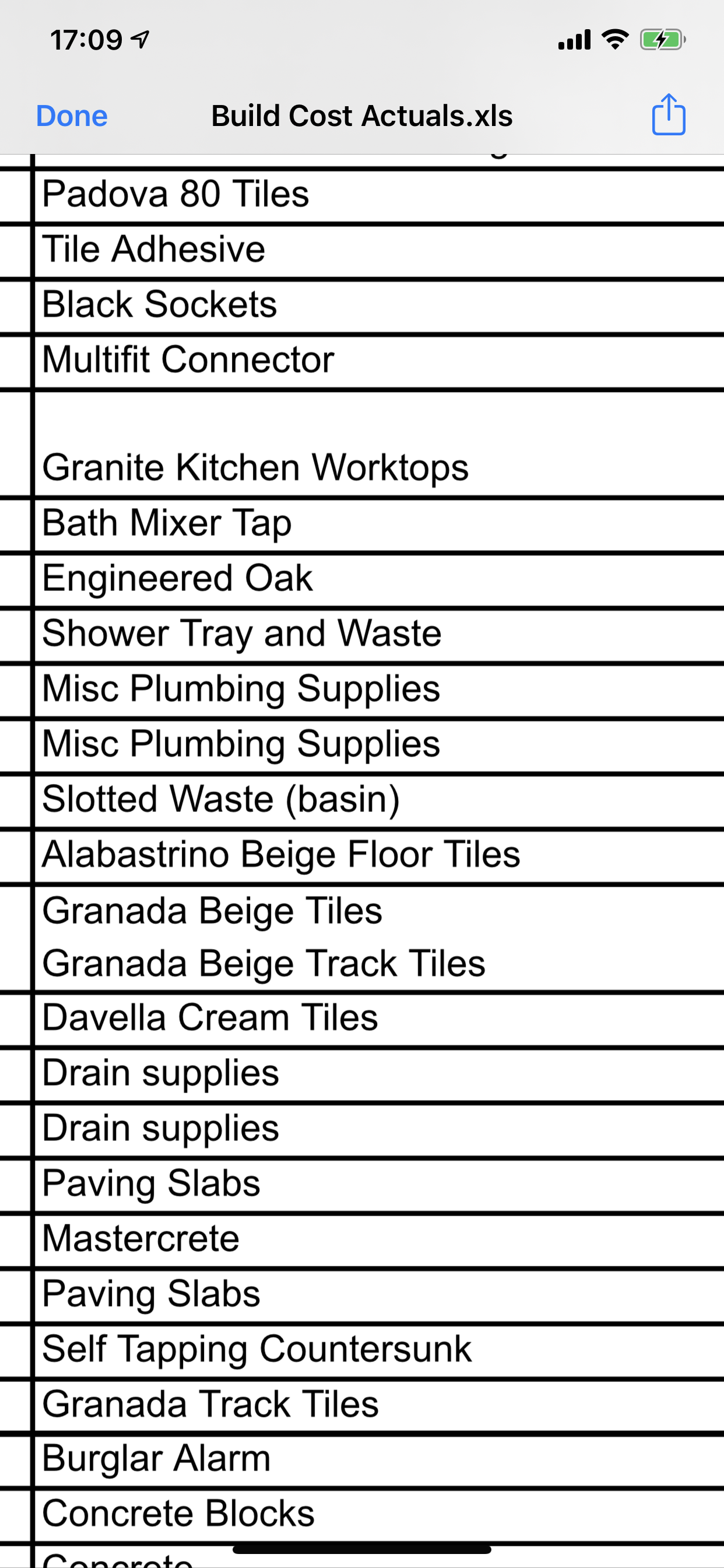

newhome Posted May 10, 2020 Share Posted May 10, 2020 Example of mine. I got 100% of my claim paid. 1 Link to comment Share on other sites More sharing options...
