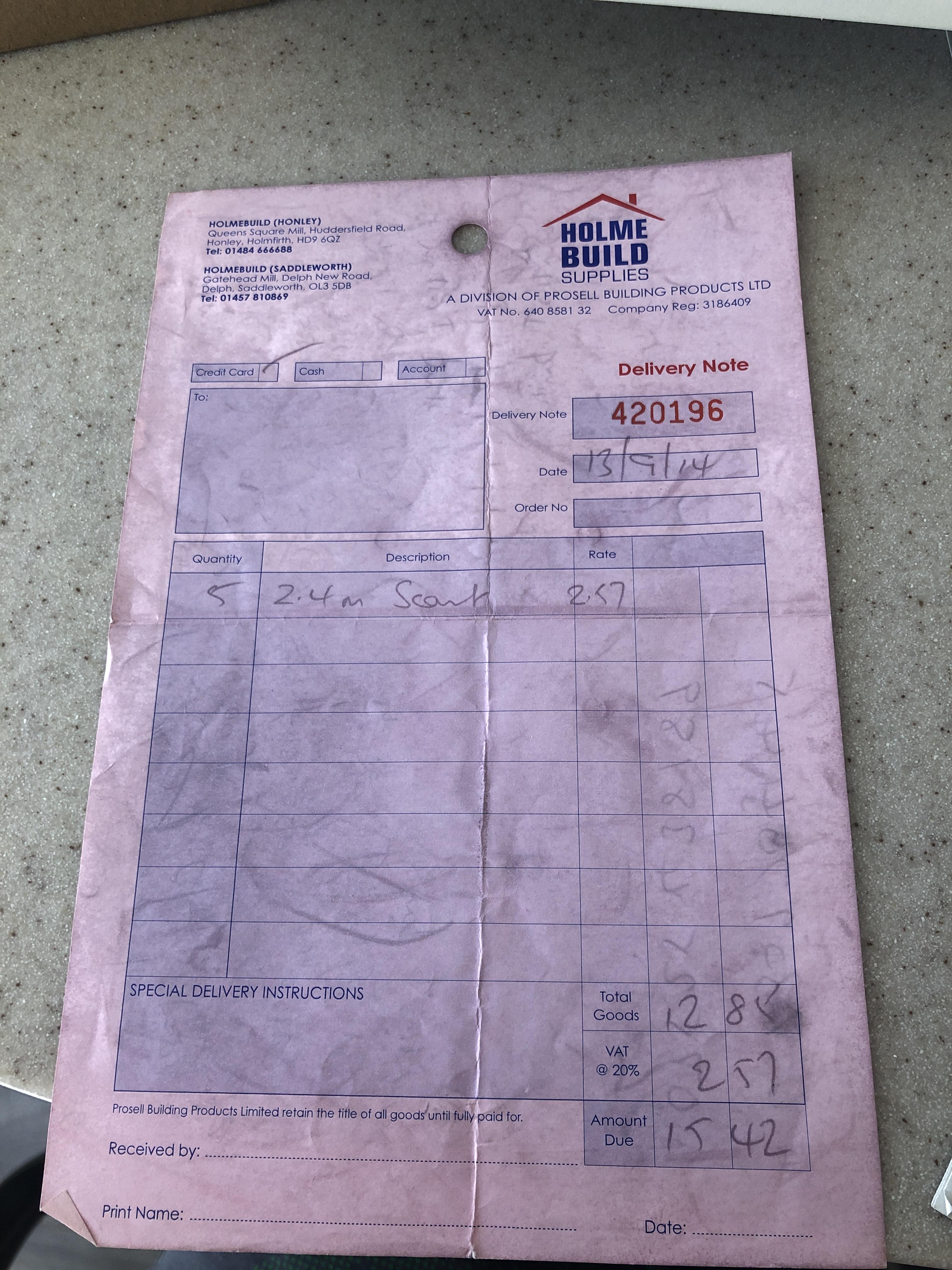

  7. Hi all, I’ve got a number of delivery notes from one supplier (example attached). they include amount, vat amount, address where over £100 and suppliers details including vat reg no. does anyone know if these would be accepted? Or would I need to go back and ask for a receipt that states invoice rather delivery note? any help appreciated many thanks
