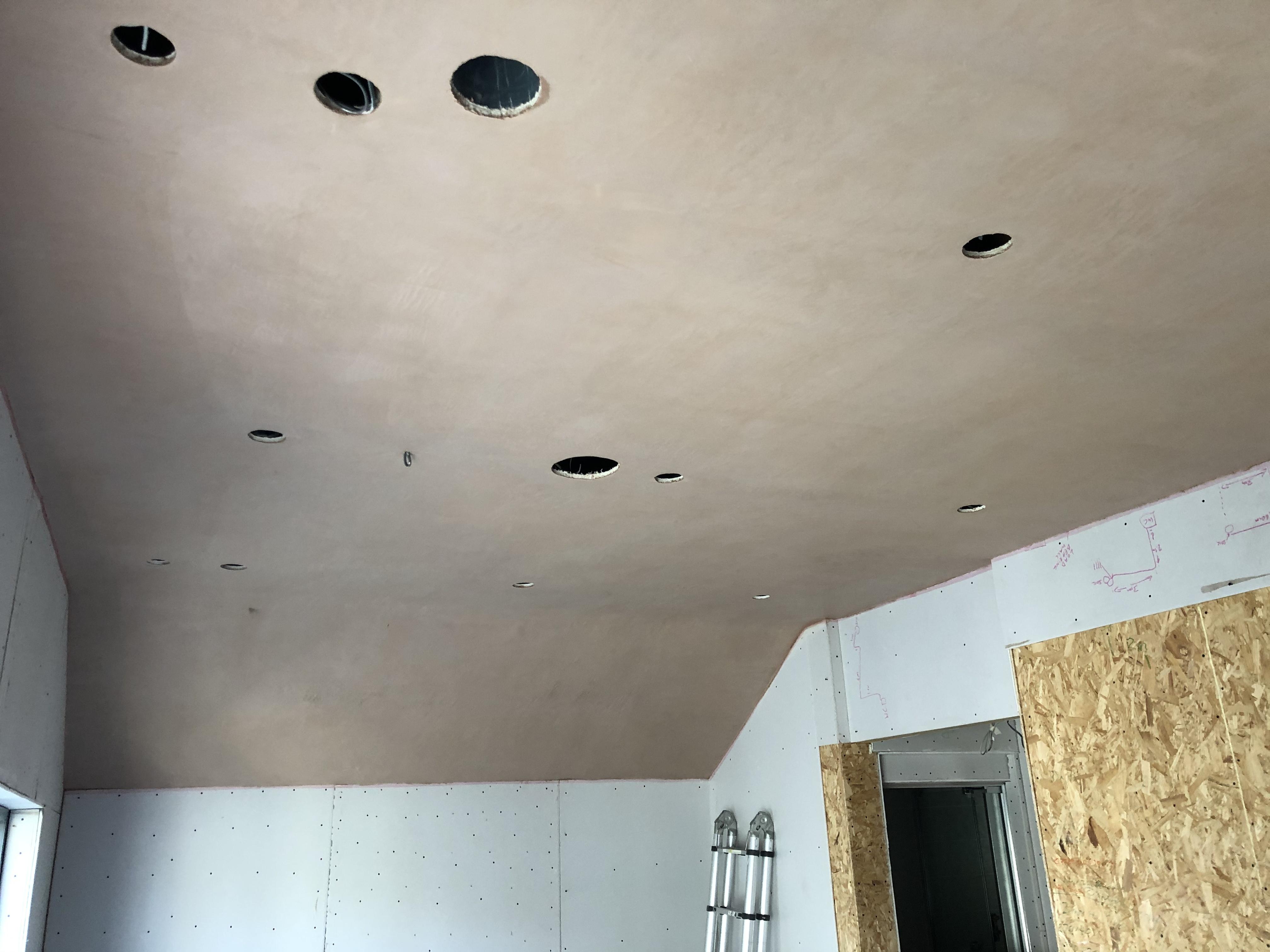

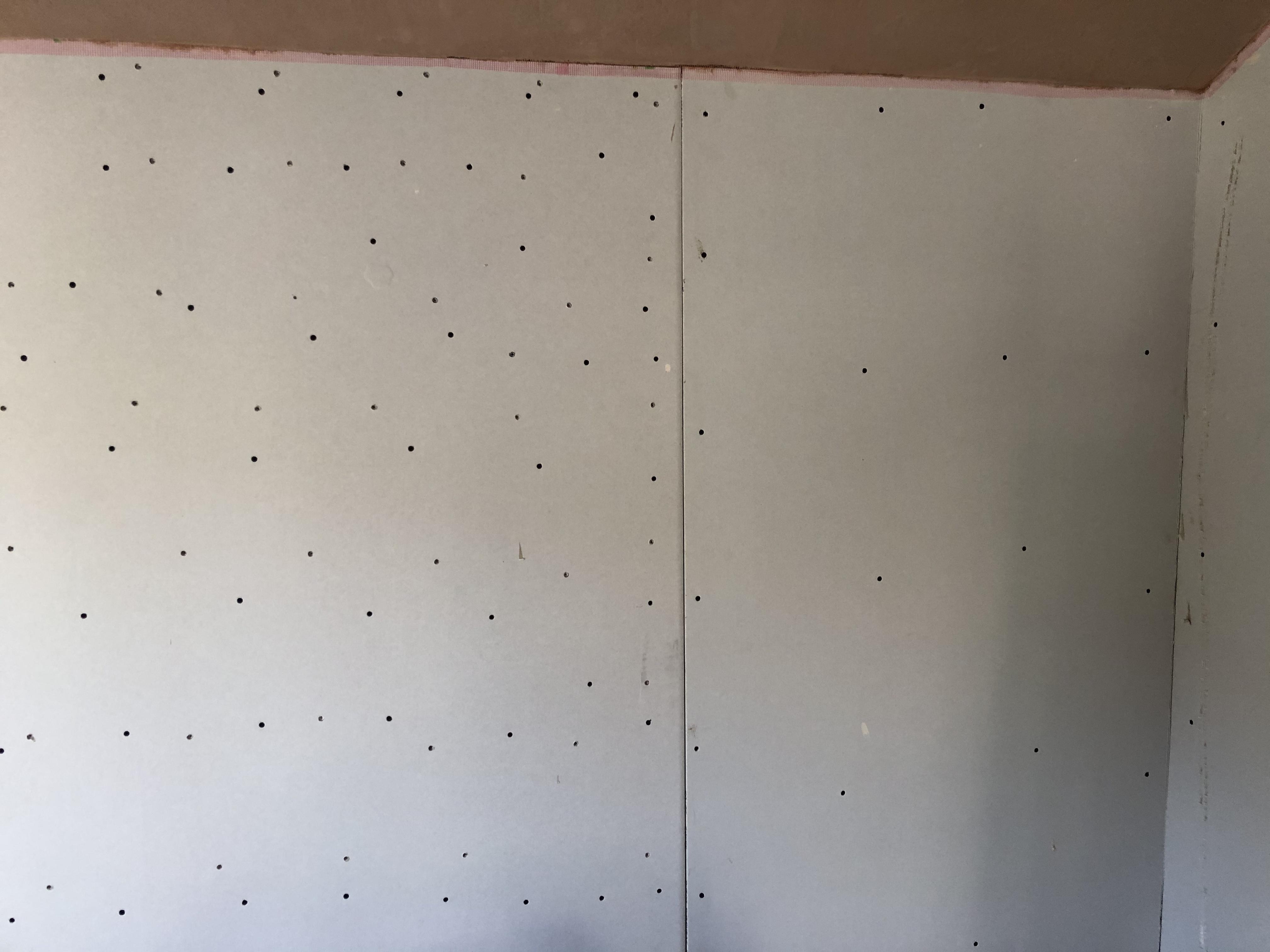

Pocster Posted March 24, 2021 Posted March 24, 2021 Plasterer had to add one board . Splatter gun approach far cooler I think ! Did a good job on the ceiling though
Moonshine Posted March 24, 2021 Posted March 24, 2021 At what point does the cost of screws exceed the cost of the board? 2
Pocster Posted March 24, 2021 Author Posted March 24, 2021 1 minute ago, Moonshine said: At what point does the cost of screws exceed the cost of the board? Should point out that board on the left came off the wall due to “ technical issues “ I.e f up . So all those holes aren’t screws . Just saying ... ?
Mr Punter Posted March 24, 2021 Posted March 24, 2021 That is just silly, especially on a wall backed with OSB. Screws only tend to pop on ceilings.

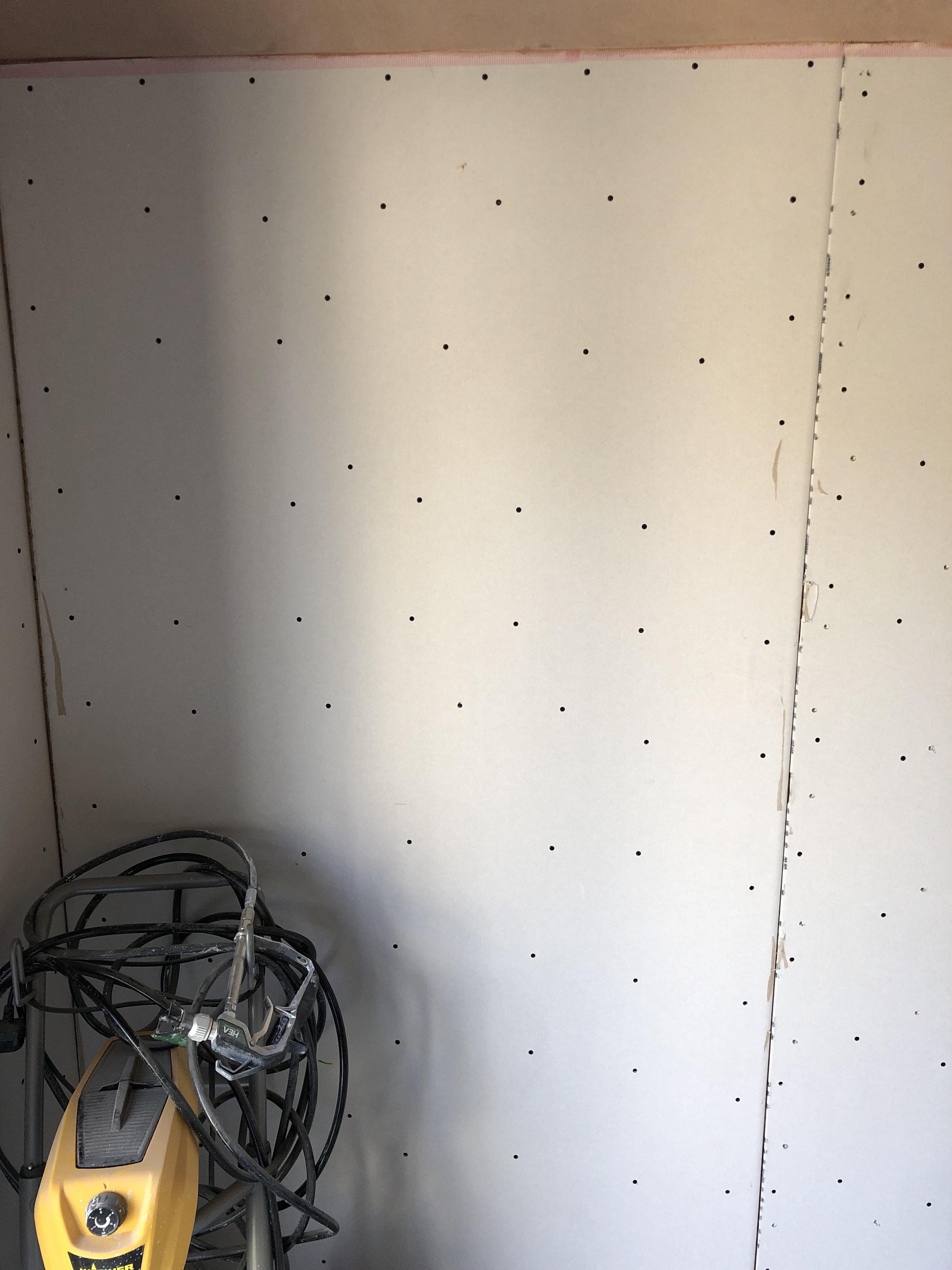

Pocster Posted March 24, 2021 Author Posted March 24, 2021 4 minutes ago, Mr Punter said: That is just silly, especially on a wall backed with OSB. Screws only tend to pop on ceilings. Here’s a normal wall As I said that wall on the left had to be removed and re screwed . So has extra holes
Mr Punter Posted March 24, 2021 Posted March 24, 2021 You have used over double the number of screws needed. It won't make it "work" any better. 28 per board on the walls (4 x 7) and a few more for ceilings is fine.
nod Posted March 24, 2021 Posted March 24, 2021 That’s a lot of screws You know the Xs on the boards are there to follow ?

LA3222 Posted March 24, 2021 Posted March 24, 2021 2 hours ago, pocster said: Here’s a normal wall As I said that wall on the left had to be removed and re screwed . So has extra holes Normal??? 1 1
Pocster Posted March 24, 2021 Author Posted March 24, 2021 11 minutes ago, LA3222 said: Normal??? My normal ! Certainly ain’t coming off the wall !
