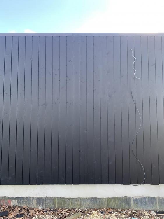

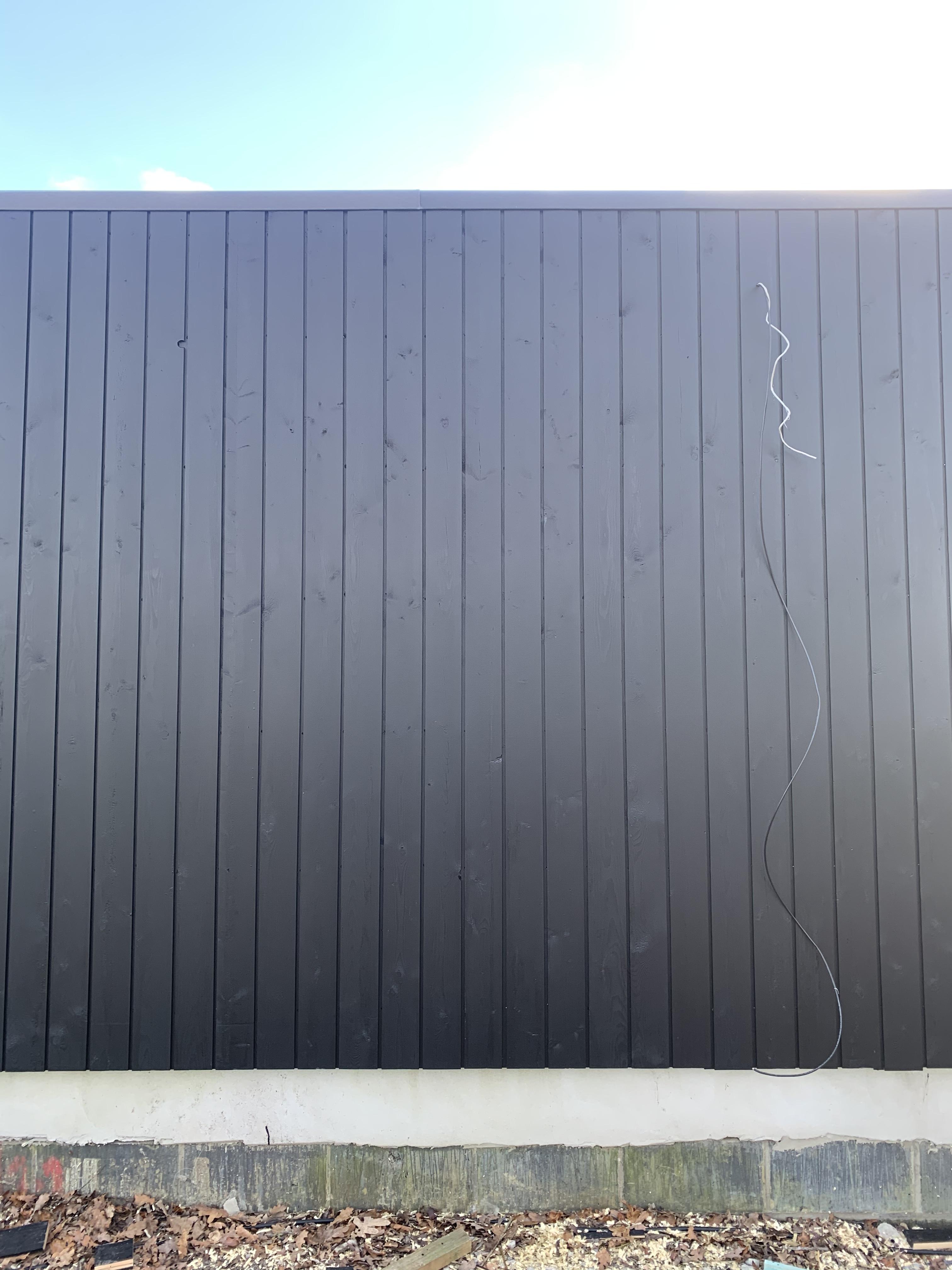

Thorfun Posted June 19, 2023 Share Posted June 19, 2023 2 hours ago, Andehh said: Just a gentle bump to see how people got on with it? Thanks well, we've not finished the house yet but the cladding is done and we love how it looks. it is pretty fragile though so unless your chippie is extremely careful with moving boards etc some of the blackness comes off. that's on the really charred stuff btw. here's a blog I wrote on the subject 1 Link to comment Share on other sites More sharing options...
BartW Posted June 20, 2023 Share Posted June 20, 2023 13 hours ago, Andehh said: Just a gentle bump to see how people got on with it? Thanks I went for it on my house. Ended up overordering by about 25%. I gave some cuts to people I knew, and it kind of caught on in the way that I started selling it. Lovely stuff! But as @Thorfun said, it is so fragile that just by looking at it you are risking damaging it. But if I were to do it again... I defo wooooood 1 Link to comment Share on other sites More sharing options...

Elton Posted June 20, 2023 Share Posted June 20, 2023 We used siberian larch with a heavy charred from inflamed.eu it was cheaper than buying from the uk. I didn't find it hard to work and not too flakey. We nailed gunned it with stainless pin nails It's been up 4months and looks good so far. We have lots of trees around so it may weather overtime but we like a bit of character 1 Link to comment Share on other sites More sharing options...
