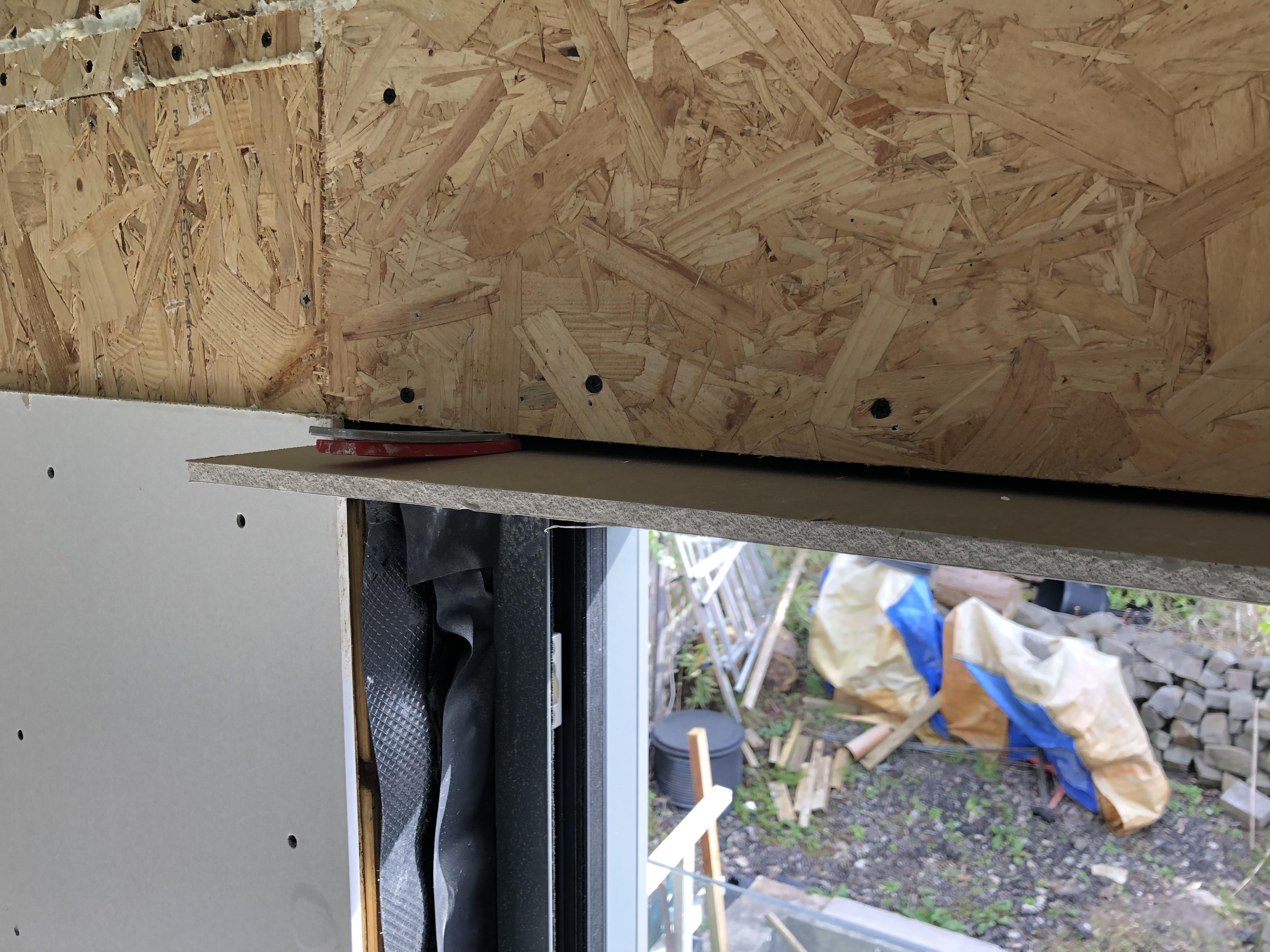

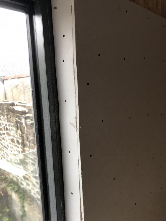

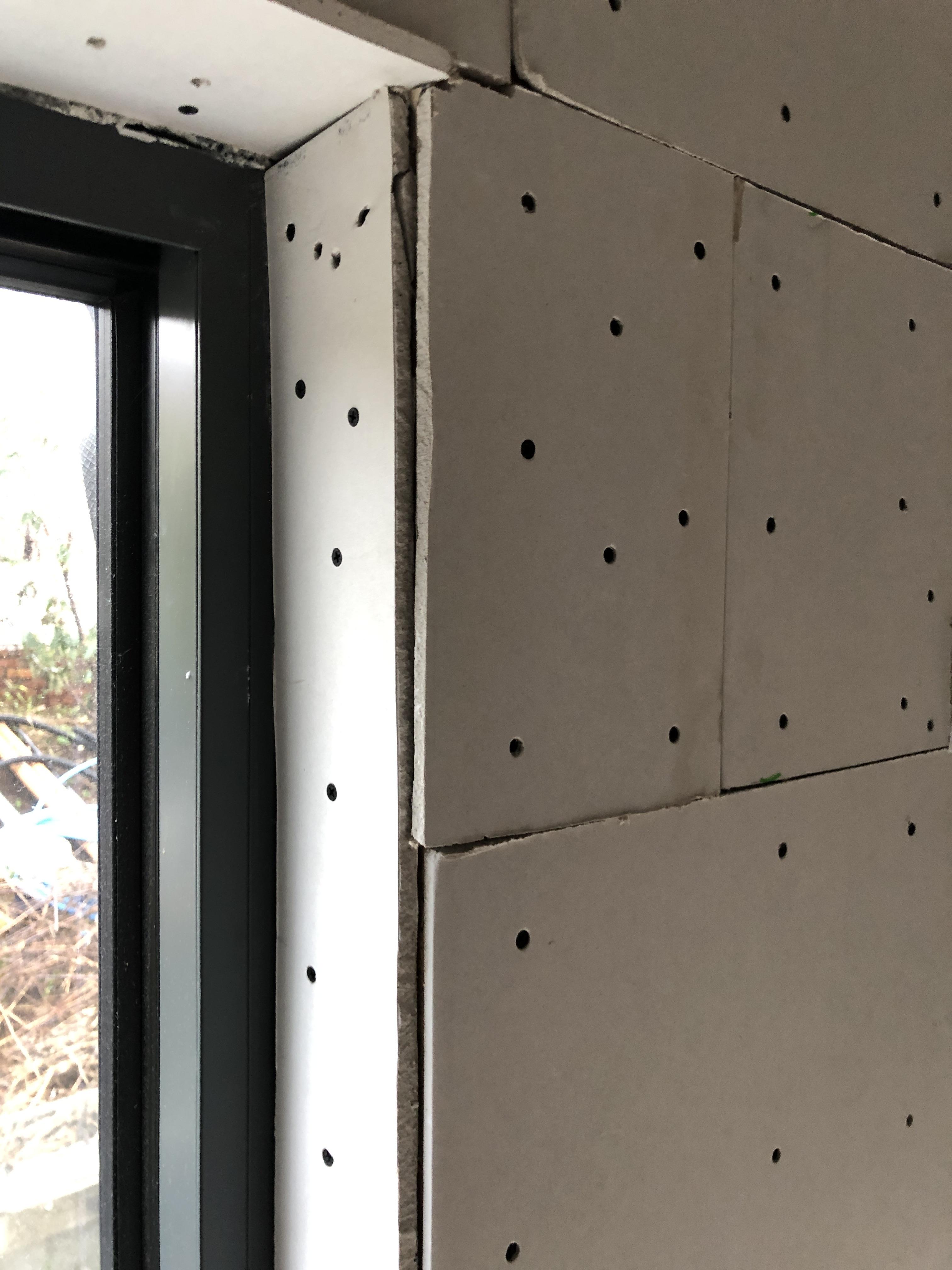

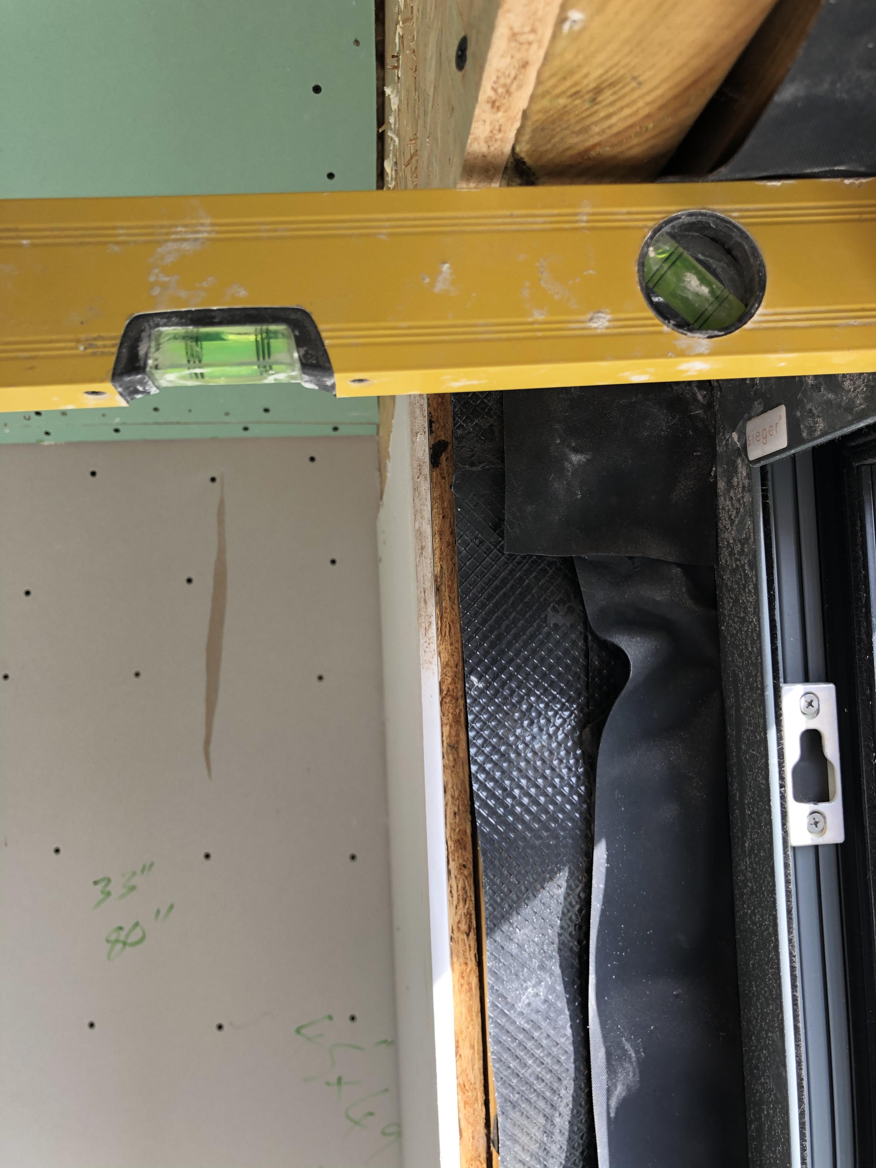

Pocster Posted March 8, 2021 Posted March 8, 2021 It would appear the timber frame is out a bit - warped timber aswell . If I plasterboard this area as it is ; just naturally pulls to the warped angle . What’s the best thing to do here ? Can I ‘pack out’ the plasterboard to get it level ??
Mr Punter Posted March 8, 2021 Posted March 8, 2021 Yes. You can use a few strips of ply / OSB to bring it back in line. With the external walls we normally staple a sheet of clear polythene as a vapour barrier before plasterboarding. 1
Pocster Posted March 8, 2021 Author Posted March 8, 2021 2 minutes ago, Mr Punter said: Yes. You can use a few strips of ply / OSB to bring it back in line. With the external walls we normally staple a sheet of clear polythene as a vapour barrier before plasterboarding. Here’s a better view . My osb is short - but don’t care about that . At the other it’s pretty level - so is a warped timber
Pocster Posted March 8, 2021 Author Posted March 8, 2021 13 minutes ago, ProDave said: No air tight membrane? No service void? membrane is there on outer timber frame . No need for service void - I’ve put in everything I could think of .
bassanclan Posted March 8, 2021 Posted March 8, 2021 You could fix using expanding foam with s couple of loose drywall screws 1
PeterW Posted March 8, 2021 Posted March 8, 2021 Just now, bassanclan said: You could fix using expanding foam with s couple of loose drywall screws Couple of beads of foam and a straight bit of timber to prop it while it goes off would be my weapon of choice. Don’t just prop the plasterboard direct as it will move and it will bend when the foam expands. 1

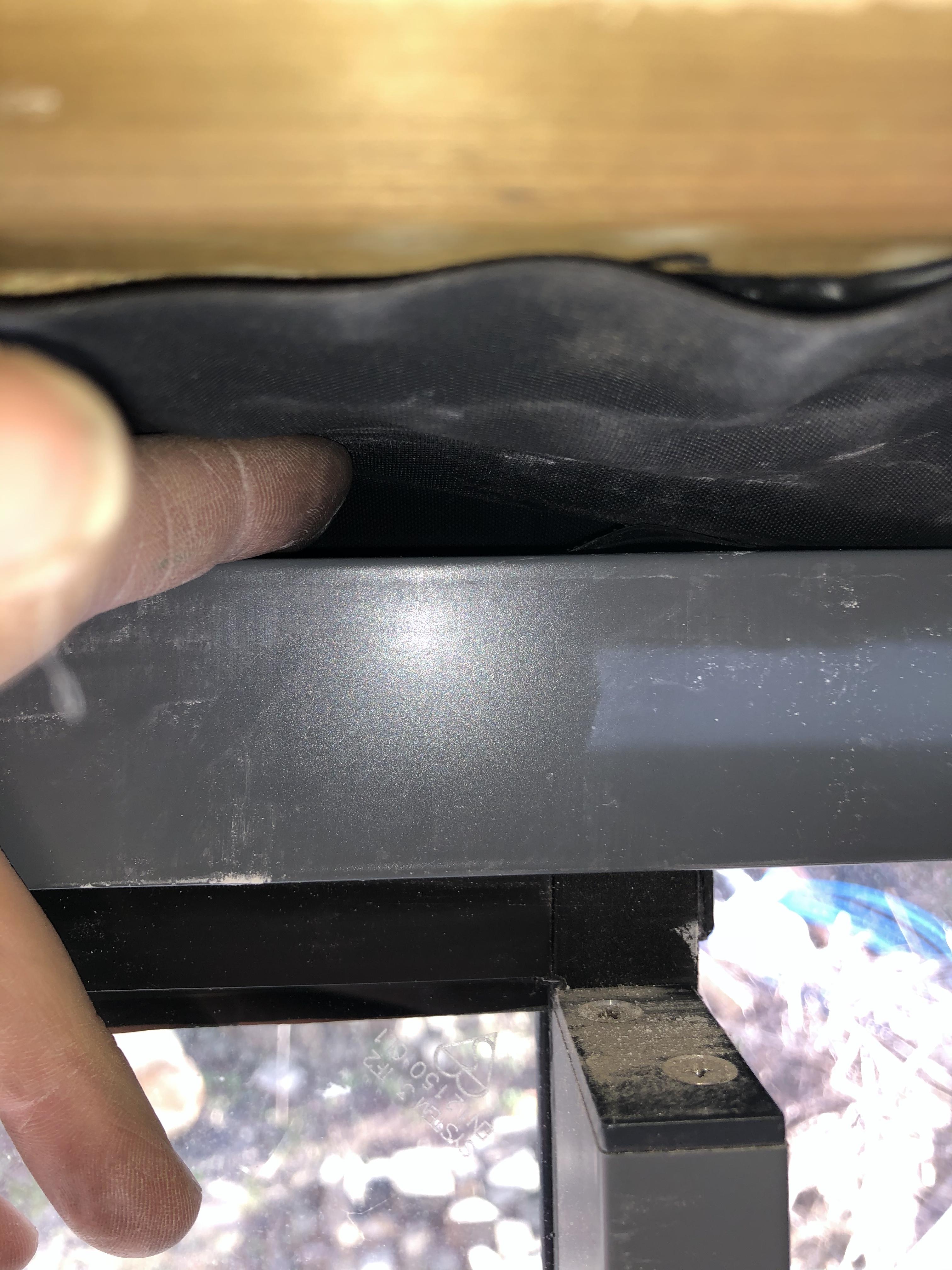

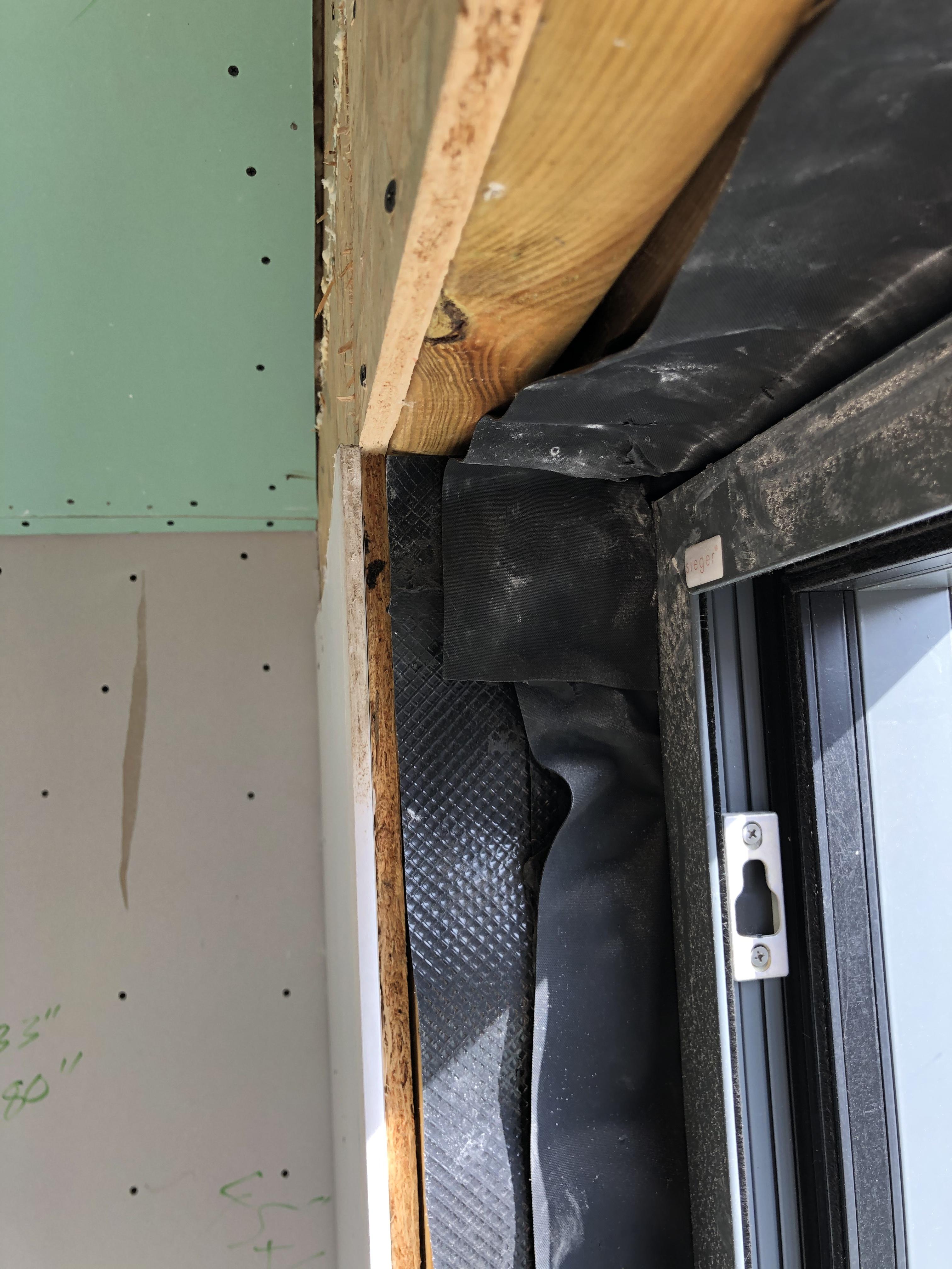

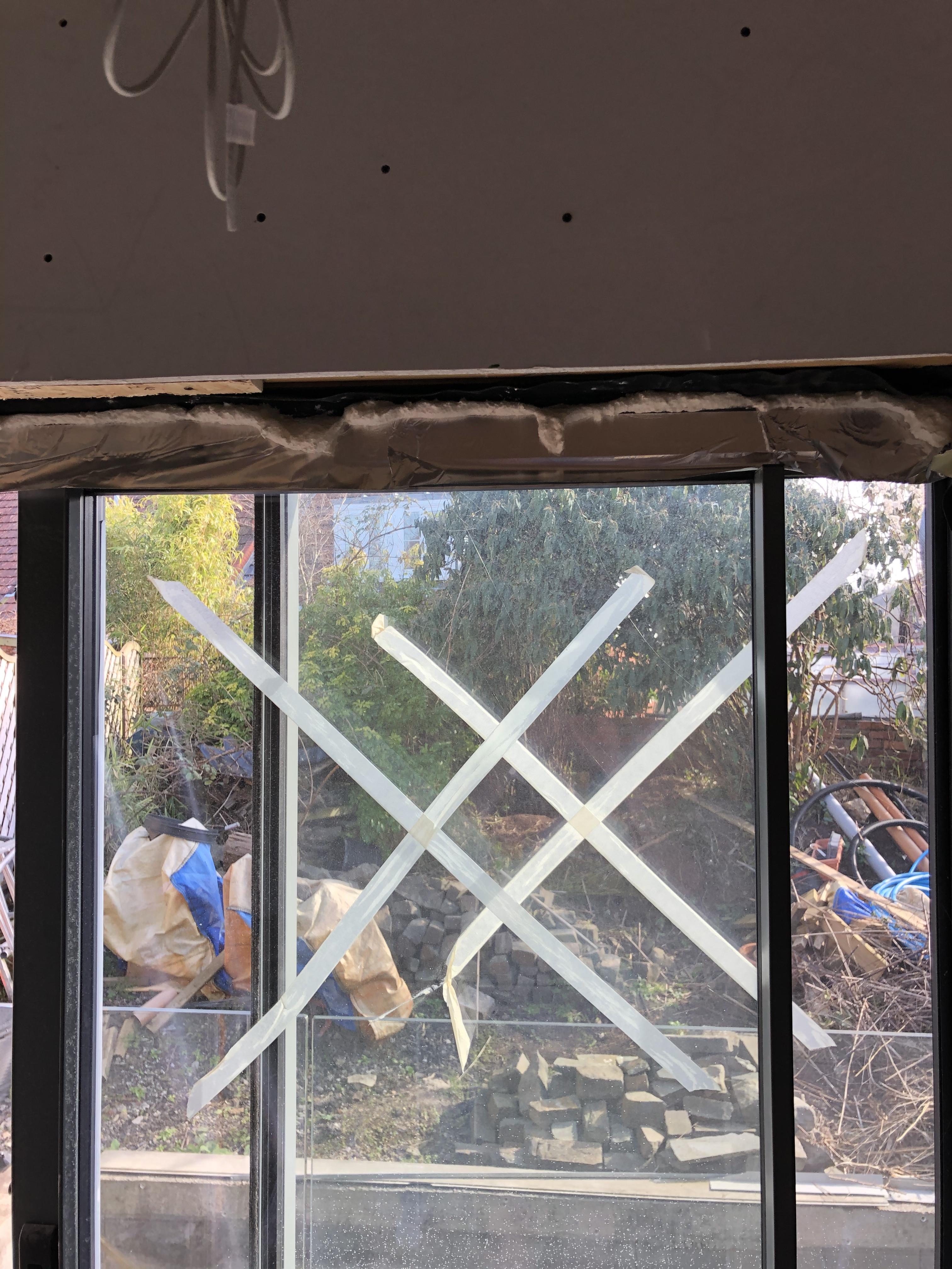

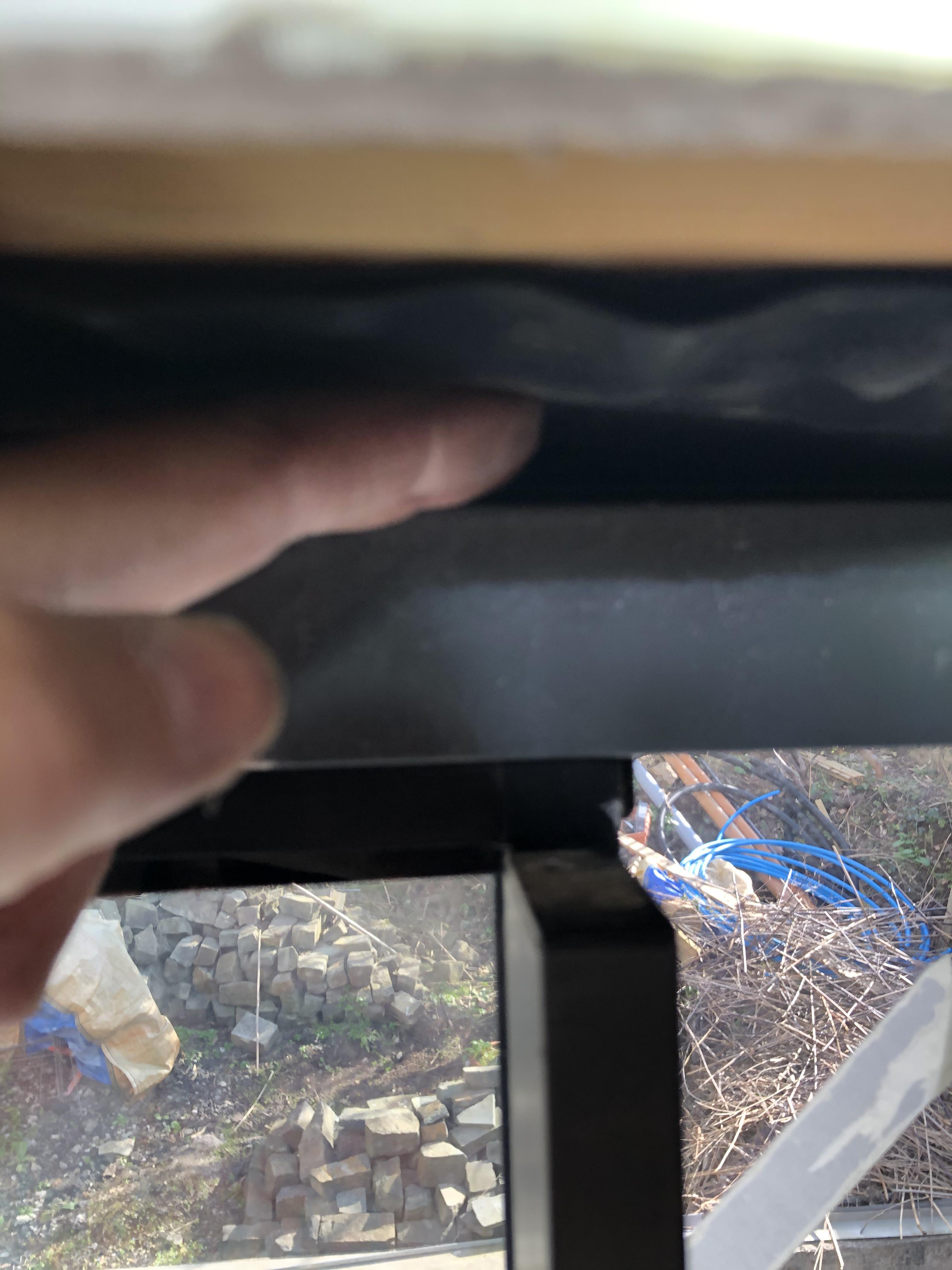

Pocster Posted March 8, 2021 Author Posted March 8, 2021 Not really looked at the fixings of the door frame until now . Does seem a bit of a gap at the top ! - tempted to foam the gap ( between frame and the rubber seal )
Pocster Posted March 8, 2021 Author Posted March 8, 2021 (edited) 12 minutes ago, pocster said: Not really looked at the fixings of the door frame until now . Does seem a bit of a gap at the top ! - tempted to foam the gap ( between frame and the rubber seal ) Going to foam it . There’s no draft or sign of daylight - so not ‘open’ - but if I can get my hand in there it’s to big !! Edited March 8, 2021 by pocster

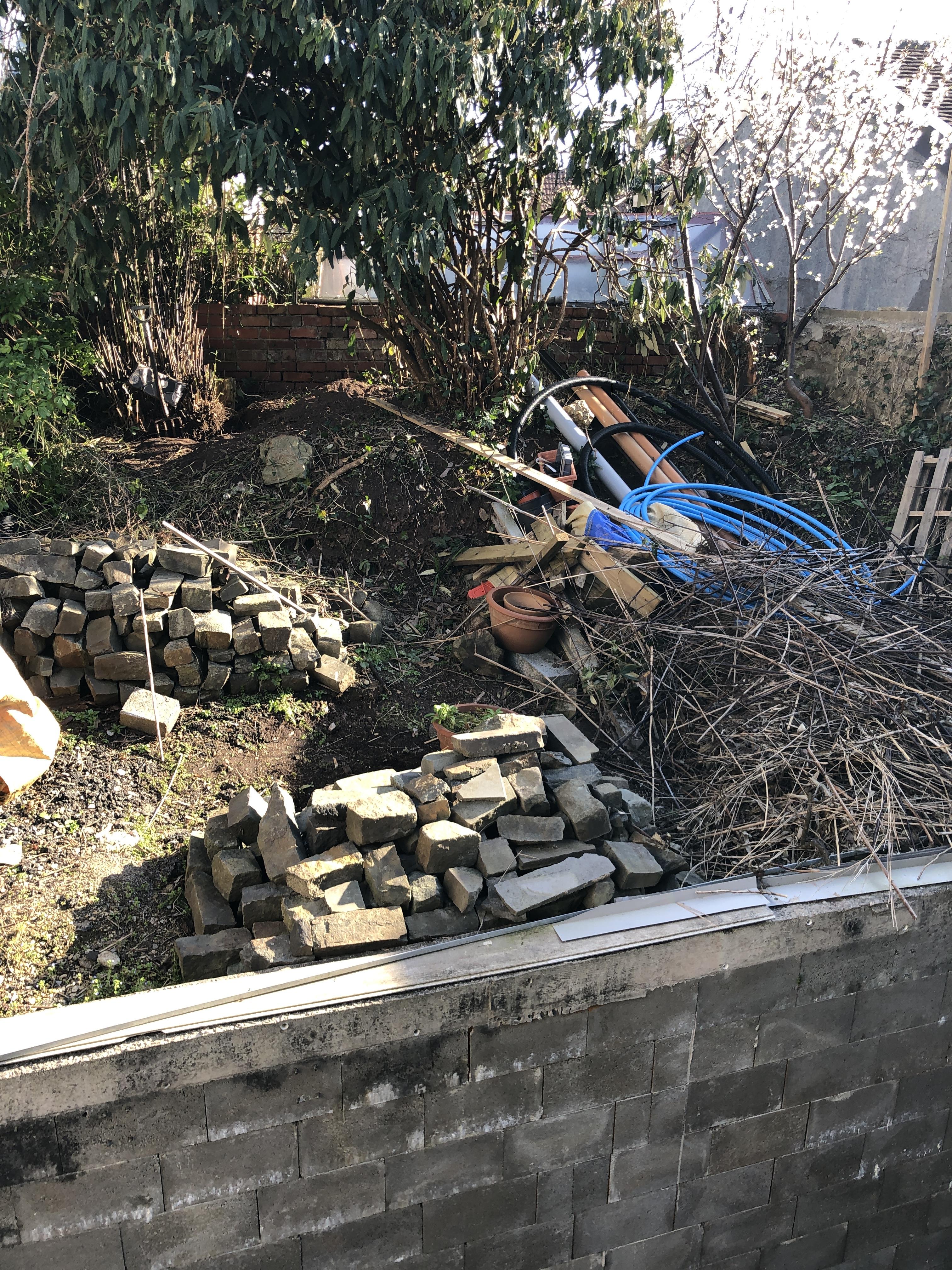

Pocster Posted March 8, 2021 Author Posted March 8, 2021 Have decided I much prefer tiling to plasterboarding . Though I have been saying a lot today “ Plasterer can deal with that “ .... Plasterer will need a sense of humour ?
Pocster Posted March 8, 2021 Author Posted March 8, 2021 Just now, Onoff said: Garden's coming on! ? Just for you ... I did call DIY SOS - but they thought I was taking the piss
joe90 Posted March 8, 2021 Posted March 8, 2021 8 minutes ago, pocster said: Just for you ... I did call DIY SOS - but they thought I was taking the piss ha, take a couple of days to sort that little Space out, I have an Acre of “paddy field”, just had 40 tons of top soil delivered to be distributed about, will take me all summer I reckon (when the ground is dry enough to walk on ?). 1

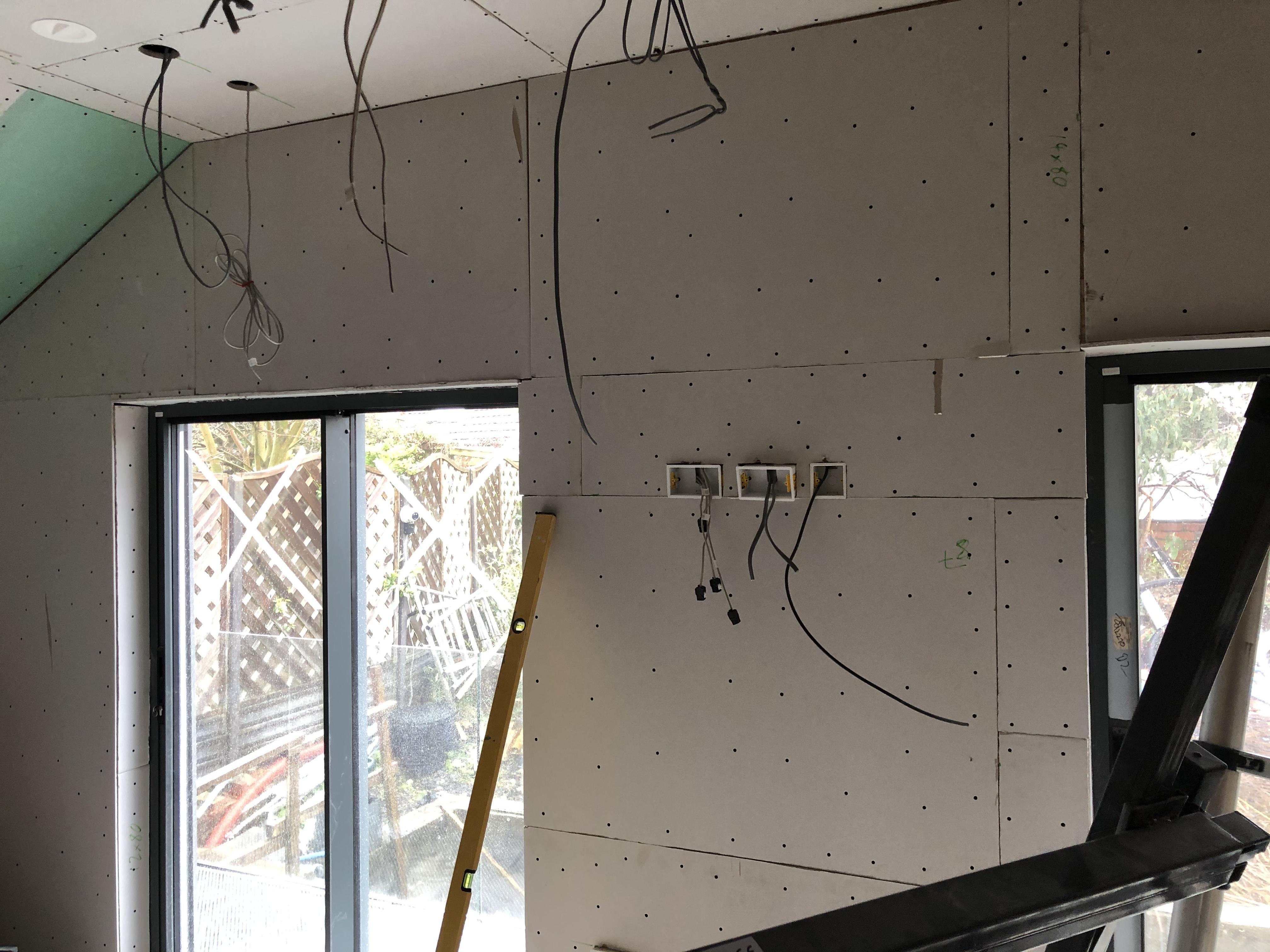

Pocster Posted March 10, 2021 Author Posted March 10, 2021 Plasterer will love filling/taping the (many) joints ...
Pocster Posted March 10, 2021 Author Posted March 10, 2021 Corners were meant to overlap and be neat - oh well “ plasterer can deal with that “ .?
joe90 Posted March 10, 2021 Posted March 10, 2021 2 minutes ago, pocster said: Corners were meant to overlap yes, that might lead to unstable corners beads ?, @nod will be along in a mo with his thoughts!!!! 1
Onoff Posted March 10, 2021 Posted March 10, 2021 17 minutes ago, pocster said: Corners were meant to overlap and be neat - oh well “ plasterer can deal with that “ .? I wonder what percentage trades put on for such pocsterisms?
Onoff Posted March 10, 2021 Posted March 10, 2021 How about a good squidge of "sticks like" in the gap, before the beading goes on?
Pocster Posted March 10, 2021 Author Posted March 10, 2021 17 minutes ago, Onoff said: I wonder what percentage trades put on for such pocsterisms? All trades get bought a coffee , doughnut , pasty and sandwich . This stops any complaints.... 1
ProDave Posted March 10, 2021 Posted March 10, 2021 No to sticks like, my plasterer says so. If anything, fill in those corners with a bit of bonding coat plaster, it does not need to be good. That is certainly some "unique" plasterboarding. 1
LA3222 Posted March 10, 2021 Posted March 10, 2021 42 minutes ago, pocster said: Corners were meant to overlap and be neat - oh well “ plasterer can deal with that “ .? This looks rough as arseholes? Glad you put this pictures up, I know now what I can get away with. Never having plasterboard before I thought it might need to be as neat as possible, good to know that all sins can be sorted by the plasterer ? 1
Pocster Posted March 10, 2021 Author Posted March 10, 2021 34 minutes ago, LA3222 said: This looks rough as arseholes? Glad you put this pictures up, I know now what I can get away with. Never having plasterboard before I thought it might need to be as neat as possible, good to know that all sins can be sorted by the plasterer ? Exactly. That's why I'm paying him. It's his skill I need not mine ?
