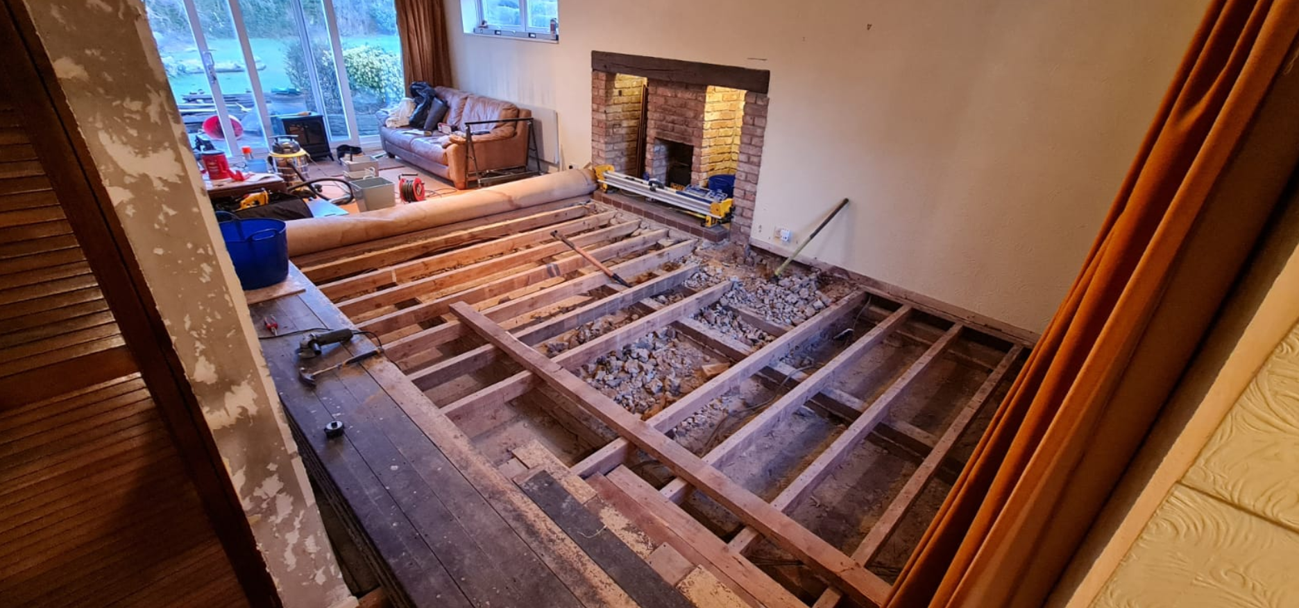

Tetrarch Posted March 1, 2021 Posted March 1, 2021 Hi, I have now removed floorboards and joists in the lounge and have a hole to fill (actually 2 when the dining room is completed). I am looking at a 20mm Eng Wood Floor on top of a 70mm UFH slab and thus have ~30 sq m of 250mm depth to insulate. What is the most economical and effective way to fill this 250mm? After a little research I believe I have three alternatives. A bespoke 250mm Jabfloor EPS (or similar) Layers of off-the-shelf Jabfloor EPS to reach the 250mm A Jabfloor layer topped with a Celotex (or similar) overlay I'm looking for any advice/experience or alternative recommendations Regards Tet PS: Below is a floor schematic where the green is floorboards, the yellow (uninsulated) concrete (to be dug up and replaced) and the orange is the proposed new extension

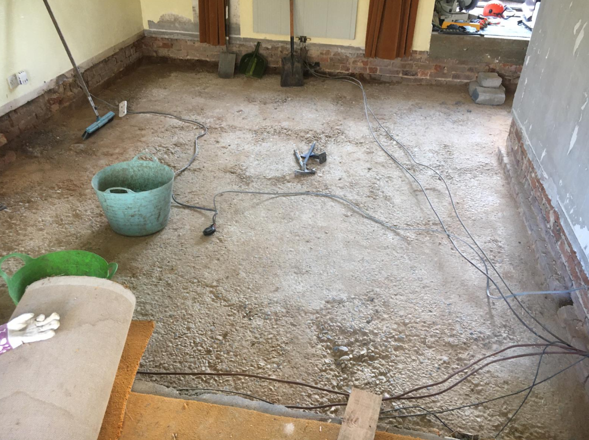

Tetrarch Posted March 1, 2021 Author Posted March 1, 2021 (edited) Hi guys, Thank you for the responses. Floor is hundred year old concrete. It is a bit weird as it is light in colour the stones are larger than I would have thought is normal now, but it appears extremely solid. I attach a couple of pictures. I am a DIY'er and the 70mm value is from my (likely) builder. His recommendation was to remove and use hardcore under a slimmer layer of PIR, but I went the whole hog and removed everything. Just to re-terate the measurements I have a tiled fireplace with a 100mm upstand. It is 300mm to the bottom of the vertical tiles so I was working on 250mm insulation + 70mm UFH screed + 20mm Flooring to bring the final floor level about half way up the tiles Edit: UFH is for long and low as this is not for a working family, but newly retired Regards Tet PS - look closely and you'll see that the double socket by the floor is actually connected by a bakelite junction box and a cooker switch plate - bodes well! Edited March 1, 2021 by Tetrarch
Nickfromwales Posted March 1, 2021 Posted March 1, 2021 Ok, just for clarity, that concrete subfloor is staying yes? Be advised that EPS insulation CANNOT come into contact with the electrical cables.

Tetrarch Posted March 1, 2021 Author Posted March 1, 2021 9 hours ago, Nickfromwales said: Ok, just for clarity, that concrete subfloor is staying yes? Be advised that EPS insulation CANNOT come into contact with the electrical cables. Concrete subfloor is staying, electrical cables and microbore radiator pipework is most definitely going Regards Tet 1
tonyshouse Posted March 1, 2021 Posted March 1, 2021 The concrete subfloor is likely to be insubstantial and not very flat or level, it could be only 50mm thick too
Nickfromwales Posted March 2, 2021 Posted March 2, 2021 11 hours ago, tonyshouse said: The concrete subfloor is likely to be insubstantial and not very flat or level, it could be only 50mm thick too Doesn't matter, as it will make an excellent raft to sit the rest of the floor on. It's been in long enough to have settled, and will be fine to take the non point-load of a new upper deck. What's it like when you walk slowly over it? Any movement in the corners? 2
Tetrarch Posted March 2, 2021 Author Posted March 2, 2021 49 minutes ago, Nickfromwales said: Doesn't matter, as it will make an excellent raft to sit the rest of the floor on. It's been in long enough to have settled, and will be fine to take the non point-load of a new upper deck. What's it like when you walk slowly over it? Any movement in the corners? Absoltely none. May I pop back to my original question. The Jablite (no particular reason for choosing this brand, are others better/cheaper?) comes in standard thicknesses up to 200mm. Listening to the previous comments; to accomodate any unevenness I was thinking of getting a 50mm layer to get a proper level and then laying the 200mm on top - does that seem a sensible plan? Do I need to tape the 50mm layer or just lay the 200mm at an offset and then tape that Finally, the Jablite 70 would seem to suffice - is there any tangible benefit from upping the spec to the Jablite 100? Regards Tet
