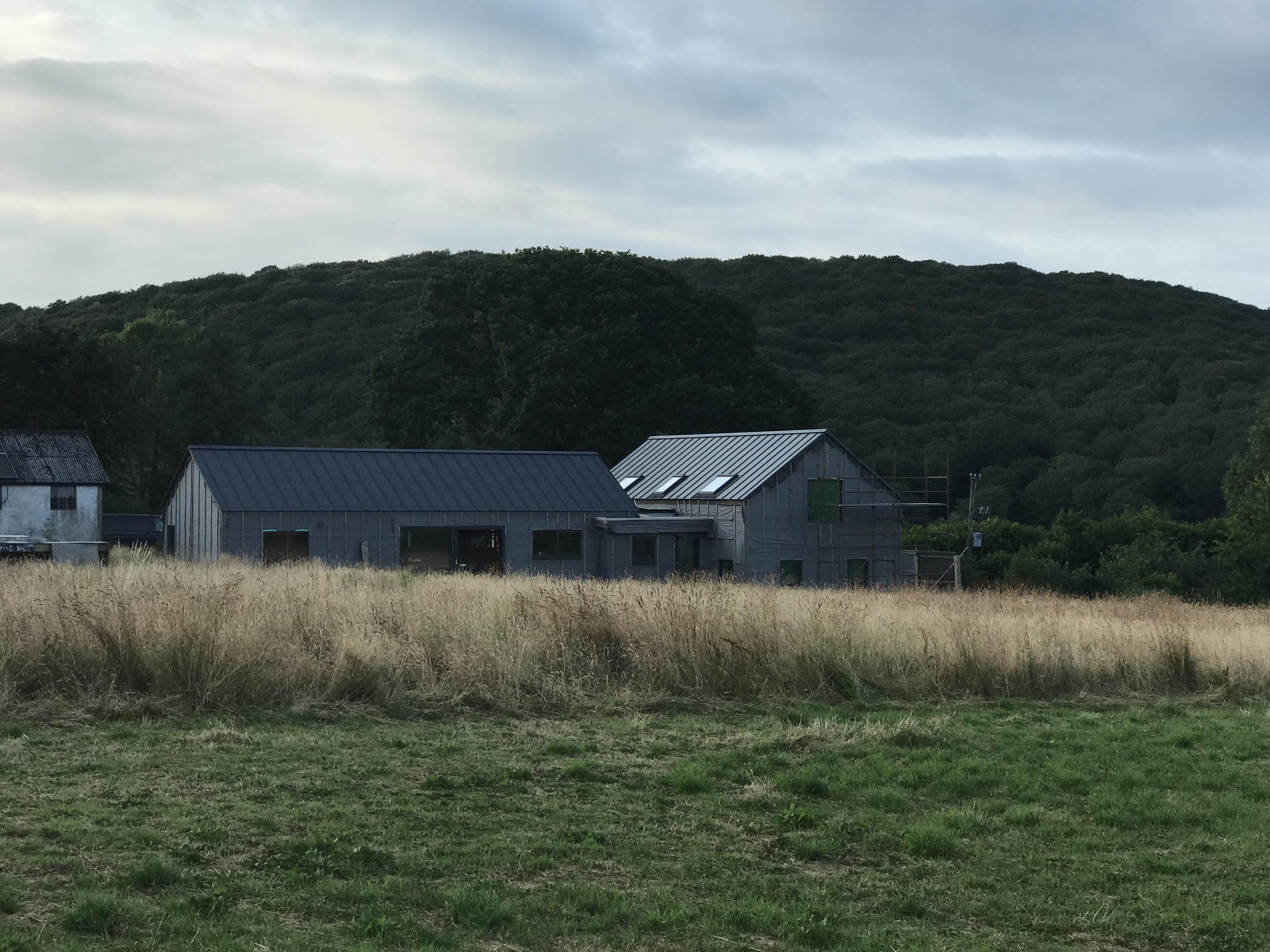

JamesP Posted February 23, 2021 Posted February 23, 2021 You will need 3 tools to fit the Tata / Catnic, listed below. I also purchased a metal blade for a circular saw. Its straight forward to fit, nailing strip on one side and hit with a hammer and block of wood the other. I had 300 sqm to fit and 7 Velux to fit round which was a bit of a challenge. You might find the delivery charge is more than the product. 1 EAVES CLOSER CU094300 Tools 2 STUBAI PLIERS CU094200 Tools 3 FLANGE MATE CU094400 Tools 3
GraemeHM Posted February 25, 2021 Posted February 25, 2021 @JamesP we’ve gone round and round on metal roofing. But back looking at Colorcoat. We actually have a very simple mono pitched roof. Slight complication on the abutment and we are right down there at 5 degrees ?. That said we also have two “flat roof” skylights. How much of a challenge was fitting skylights in? And where should I look to lear what’s required? Cheers 1
JamesP Posted February 25, 2021 Posted February 25, 2021 (edited) 1 hour ago, GraemeHM said: @JamesP we’ve gone round and round on metal roofing. But back looking at Colorcoat. We actually have a very simple mono pitched roof. Slight complication on the abutment and we are right down there at 5 degrees ?. That said we also have two “flat roof” skylights. How much of a challenge was fitting skylights in? And where should I look to lear what’s required? Cheers I did spend half a day up at Tata for some basic training, no great detail. Without openings its very straightforward. You create an upstand on the Colorcoat panels to fit under the Velux flashing kit. Enclosed is the Tata Spec Guide, drawing ASU05 for Top Abutment as well as roof lights and drawings for a warm roof. It might be worth getting quotes from professionals as it is a small roof, I had 300 sq metres so the savings were considerable. Specification-Guide-Tata-Steel.pdf Edited February 25, 2021 by JamesP
GraemeHM Posted February 25, 2021 Posted February 25, 2021 @JamesPThats absolutely amazing thank you.
ruggers Posted March 2, 2021 Author Posted March 2, 2021 Thanks for the photos, looks quite a big job. How do you trim them long ways for the cut ends like each end of yours being 4m ish from the photo? I will have 1 top abutment, 1 side abutment and one verge but it's quite close to an exact sheet size, i haven't yet built it so if required for a better roof, I could tweak sizes 25-50mm. How have you found the noise when it rains?

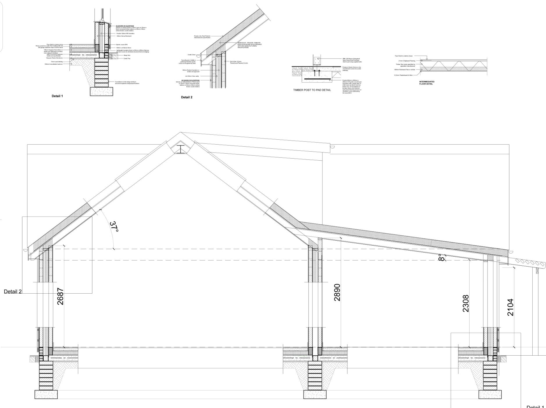

Dunny1234 Posted March 16, 2021 Posted March 16, 2021 Hi all, im about to start building soon. Either zinc or catnip ssr2. The issue i have is a warm or cold roof. The zinc installer wants an extra £19k to install the warm roof, before he even starts the zinc. What’s best, and how easy is it to build up a warm roof? Thanks in advance for any advice
GraemeHM Posted March 17, 2021 Posted March 17, 2021 @Dunny1234We are just about to start building as well and I've been doing research on cold/vented vs warm/unvented. Our zinc installer has always favoured cold/vented. I spoke to a very knowledgeable technical guy at VM Zinc and he said "both will work if done right, but the cold/vented is more forgiving". As you probably know the issue is condensation on the underside of the roof. 2
Russell griffiths Posted March 17, 2021 Posted March 17, 2021 The different types of buildup will have a major effect on other aspects of the build, having 150mm plus of insulation on top of your rafters will make finished heights higher. So needs thinking about quickly. 2
Kevin J Posted March 17, 2021 Posted March 17, 2021 @Dunny1234 A cold ventilated construction has been the method of construction for zinc roofing across Europe. Use 'penny gap' 25mm thick softwood boards as the deck supporting the zinc and you can't go far wrong. If there is condensation with in the roof build up the timber will be able to dry, the air will also protect the back (underside) of the zinc and allow a natural patination on the metal surface. If you build using plywood you MUST isolate the zinc from the plywood using a structured underlay as ISO-Mat Metal. It has always been forbidden to lay zinc directly onto Plywood. Warm roofs have become popular and IF installed correctly can offer some advantages. The Vapour Control Layer (VCL) must be specified in accordance with the level of humidity expected within the building and installed correctly to prevent moisture breaching into the roof construction - for the life of the building. DM Drawings if you need project specific advice or guidance? 1
Dunny1234 Posted March 17, 2021 Posted March 17, 2021 Thanks for the advice. My zinc guy says 75% of zinc he does is cold, and the rest warm. I can see the benefits in warm, I like the idea of voids in ceiling (lights /cable etc), and the improved thermal bridging. He saying that because it needs to be done right, and the importance of the vapour barrier, he’d want to do it. This brings the quandary, can I justify the extra £19k to just build the warm roof, before the £35k for the zinc? my architect says we can go either warm or cold, and he can sort drawings. My original quote from zinc guy was a cold roof, but my architect preferred a warm roof, now I just don’t know. Really want to buy in all the insulation soon too, as it looks like the price are going up. ? thanks again
Dunny1234 Posted March 17, 2021 Posted March 17, 2021 2 hours ago, GraemeHM said: @Dunny1234We are just about to start building as well and I've been doing research on cold/vented vs warm/unvented. Our zinc installer has always favoured cold/vented. I spoke to a very knowledgeable technical guy at VM Zinc and he said "both will work if done right, but the cold/vented is more forgiving". As you probably know the issue is condensation on the underside of the roof. Thanks Graeme, are you going cold roof then?
GraemeHM Posted March 17, 2021 Posted March 17, 2021 @Dunny1234Yes the condensation is a big concern and as @Russell griffiths says all that insulation on top of our rafters makes our roof angle more problematic. Our architect also preferred warm, but soon changed his mind ? I've read things about there being more noise on a cold roof, but not sure about that. I've also read that a vented roof keeps heat (we are south facing) away from the roof structure. Other considerations (as I understand) if you have rooflights, care must be taken to keep the ventilation open and if you are joining another building like us, then the abutment is slightly more complicated.
GraemeHM Posted March 17, 2021 Posted March 17, 2021 @Dunny1234I should say that are also considering using an aluminium roof PREFA / Preflaz and it seems to have a good reputation. 1
Dunny1234 Posted March 17, 2021 Posted March 17, 2021 2 minutes ago, GraemeHM said: @Dunny1234I should say that are also considering using an aluminium roof PREFA / Preflaz and it seems to have a good reputation. Definitely looking at alternatives, the catnic ssr2 looks good. my architect has suggested that if we go with a cold roof, 150mm pir between rafters, and 38mm pir back plasterboard over rafter to sort the cold bridging issue out. But, I cant how I’m going to install down lights, and cable this way. Alternative, with warm roof is 165mm on top. We’ve got large rooflights, and a couple of sun tunnels too, will this be difficult with a warm roof? There definitely seems to be a greyish area of using warm roofs and a standing seam type roof. It’s driving me nuts
Bramco Posted March 17, 2021 Posted March 17, 2021 17 minutes ago, Dunny1234 said: He saying that because it needs to be done right, and the importance of the vapour barrier 1 hour ago, Kevin J said: Warm roofs have become popular and IF installed correctly can offer some advantages. The Vapour Control Layer (VCL) must be specified in accordance with the level of humidity expected within the building and installed correctly to prevent moisture breaching into the roof construction - for the life of the building. So doing it right is speccing the right VCL in accordance with the level of humidity and leaving a ventilated gap? Or is there more to it? Is this an issue only with standing seam? We were looking at Prefa standing seam but have gone back to what was on our planning application which is corrugated steel for both the roof and the cladding. Mainly because of the cost of wrapping the whole thing in 18mm ply or OSB to support the standing seam. Our timber frame co will install the VCL and 25x50 counter battening. The plan is to then mount purlins and the corrugated on that - the corrugated would have the inside coated with an anti condensation coating and of course the whole gap behind the roofing and cladding would be vented (and insect and vermin proofed). Has anyone done this? Any advice? Simon
