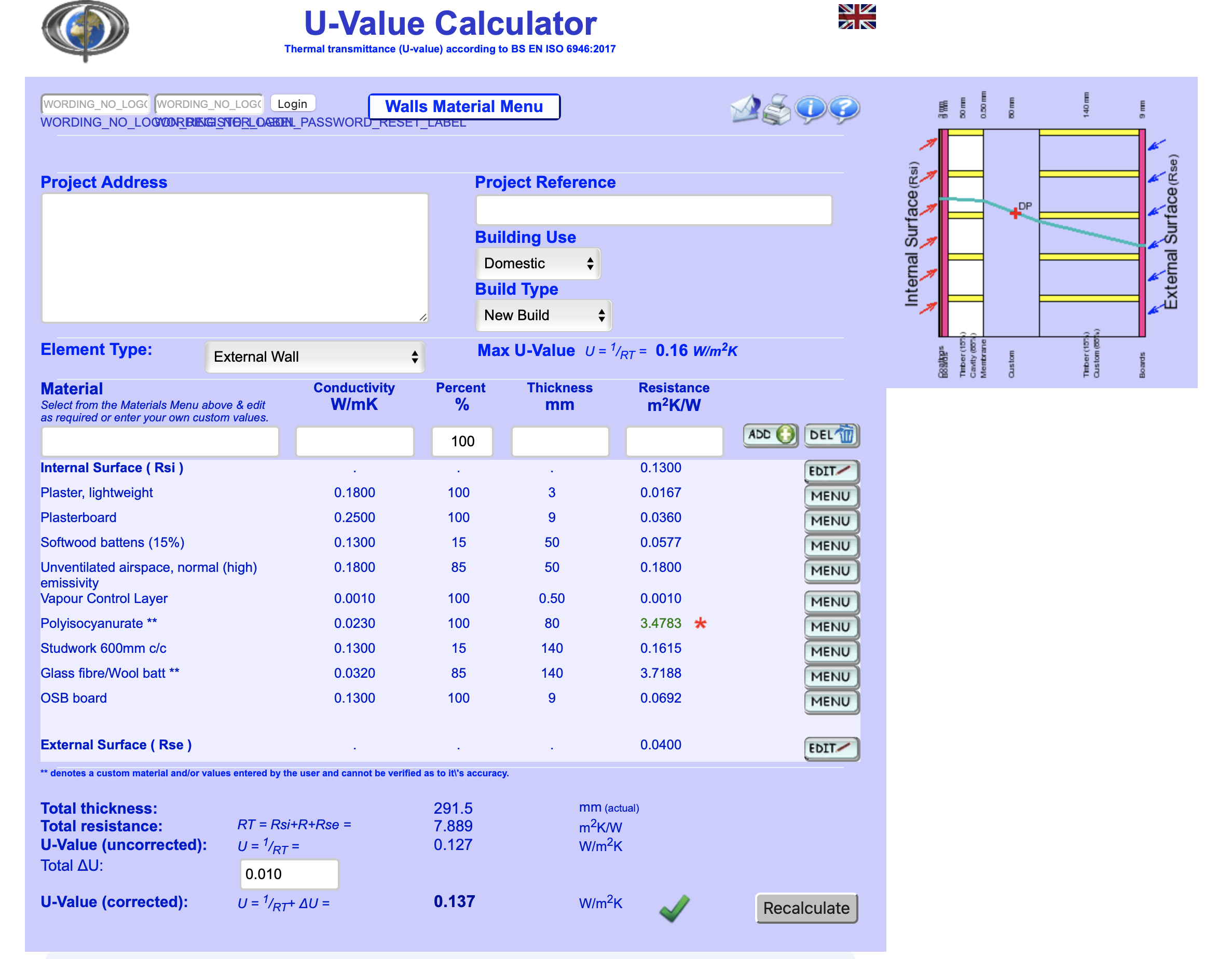

Russell griffiths Posted February 10, 2021 Share Posted February 10, 2021 2 hours ago, Thorfun said: it would be interesting to know the thickness of the ICF walls to get you to 0.12 W/m2K as that's my target U-value in our timber frame and our walls are 140mm studs with mineral wool between the studs and 80mm PIR on top so 220mm (not including VCL or service void which the ICF won't have either). I would reckon that ICF walls would need to be nearer 400mm thick to get similar U-values, but I might be wrong. But I do think TF will get you better U-values with thinner walls simply due to the fact you can put the insulation within the wall whereas ICF is on either side. But, as has been said before, U-values aren't everything and every one needs to make their own decisions on their requirements and ideals. I suppose it depends if you believe what your frame co are telling you regarding u values, have you done the calcs yourself, I’m not convinced by your figures. Link to comment Share on other sites More sharing options...
Thorfun Posted February 10, 2021 Share Posted February 10, 2021 1 minute ago, Russell griffiths said: I suppose it depends if you believe what your frame co are telling you regarding u values, have you done the calcs yourself, I’m not convinced by your figures. I did the calculations myself using changeplan.co.uk. that's Frametherm32 between the studs and 0.22W/mK PIR on top of that. works out to 0.12W/m2K Link to comment Share on other sites More sharing options...
Russell griffiths Posted February 10, 2021 Share Posted February 10, 2021 I’m baffled then, I have a similar build up in a roof pir under rafters, Frametherm in between the rafters, I have more insulation than you and rockwool did my calcs and came out at 0.14. Link to comment Share on other sites More sharing options...
Thorfun Posted February 10, 2021 Share Posted February 10, 2021 5 minutes ago, Russell griffiths said: I’m baffled then, I have a similar build up in a roof pir under rafters, Frametherm in between the rafters, I have more insulation than you and rockwool did my calcs and came out at 0.14. dunno then. I can only go on what the computer says! I think standard PIR on changeplan is 0.023W/mK but I changed that to 0.022W/mK as you can find stuff that has that thermal conductivity but if I change it to 0.023W/mK I still get a 0.126W/m2K U-value. maybe it's changeplan's calculations? or maybe it was Rockwool being conservative? or maybe they didn't include all the other bits of the wall makeup like the external battening and cladding and internal service void etc? I know there are much cleverer people than me at U-value calculations on here so maybe one of them can tell us who's right. ? Link to comment Share on other sites More sharing options...

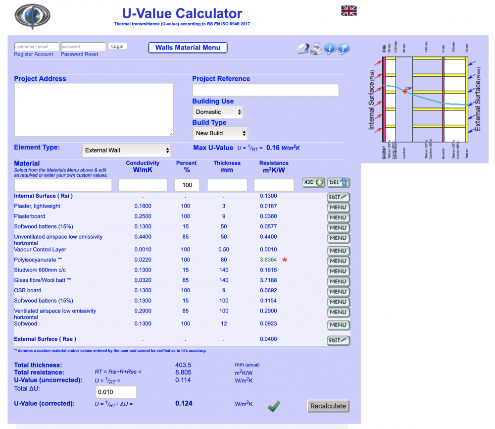

A_L Posted February 10, 2021 Share Posted February 10, 2021 20 minutes ago, Thorfun said: dunno then. I can only go on what the computer says! because of the ventilated cavity you should remove the thermal resistances for the associated softwood/air space/wood cladding, but you can insert an enhanced exterior surface resistance, add a layer of 0.09m2 .K/W to correct. does the VCL have a shiny surface? it needs one to get the enhanced thermal resistance for the unventilated cavity Link to comment Share on other sites More sharing options...
ADLIan Posted February 10, 2021 Share Posted February 10, 2021 Insulation manufacturers are normally exact with their U-values. Looking at the above calcs; the service void airspace is unlikely to be low emissivity (only if AVCL is reflective/foil) anything external to a vent airspace is ignored and external surface resistance set to same as internal See BR443 on U-value conventions and BS EN ISO 6946 Link to comment Share on other sites More sharing options...
Thorfun Posted February 10, 2021 Share Posted February 10, 2021 18 minutes ago, A_L said: because of the ventilated cavity you should remove the thermal resistances for the associated softwood/air space/wood cladding, but you can insert an enhanced exterior surface resistance, add a layer of 0.09m2 .K/W to correct. does the VCL have a shiny surface? it needs one to get the enhanced thermal resistance for the unventilated cavity I know we've had these conversations before but my memory is so poor that I forget everything! did that but it didn't really make much difference. again, bad memory, but I thought that the unventilated cavity was low emissivity if it wasn't a shiny surface? but again, how much of a difference does it really make? Link to comment Share on other sites More sharing options...
Thorfun Posted February 10, 2021 Share Posted February 10, 2021 19 minutes ago, ADLIan said: Insulation manufacturers are normally exact with their U-values. Looking at the above calcs; the service void airspace is unlikely to be low emissivity (only if AVCL is reflective/foil) anything external to a vent airspace is ignored and external surface resistance set to same as internal See BR443 on U-value conventions and BS EN ISO 6946 ok. my bad. again, I'm sure I've had these conversations before with you guys so thanks for setting me straight again. I guess my U-values aren't as good as I think they're going to be! if I remove all the external void and make the unvented one high emissivity then I get 0.137W/m2K which would correlate with @Russell griffiths calculations. looks like I'll need to get my SAP re-done then. the thermal modelling company didn't pick up on it, but I'm not surprised, they were a bit s**t. Link to comment Share on other sites More sharing options...

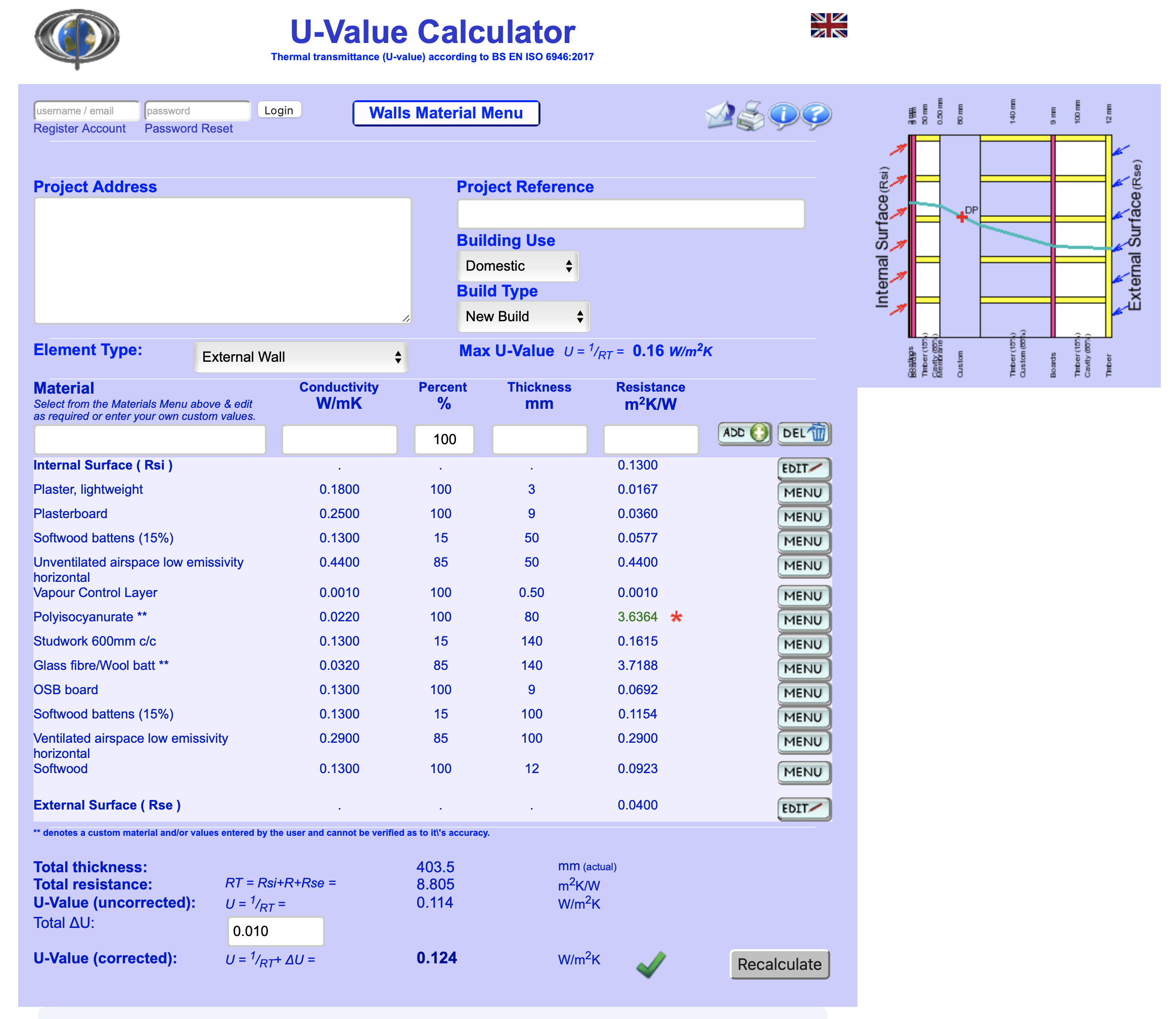

A_L Posted February 10, 2021 Share Posted February 10, 2021 2 minutes ago, Thorfun said: I thought that the unventilated cavity was low emissivity if it wasn't a shiny surface? no, that makes it high emissivity. It is deemed to have a thermal resistance of 0.18m2K/W page 11 attached pdf BR_443_(2006_Edition).pdf Link to comment Share on other sites More sharing options...

Thorfun Posted February 10, 2021 Share Posted February 10, 2021 47 minutes ago, A_L said: no, that makes it high emissivity. It is deemed to have a thermal resistance of 0.18m2K/W page 11 attached pdf BR_443_(2006_Edition).pdf 153.24 kB · 0 downloads yeah, cheers. updated calculations attached. Link to comment Share on other sites More sharing options...
