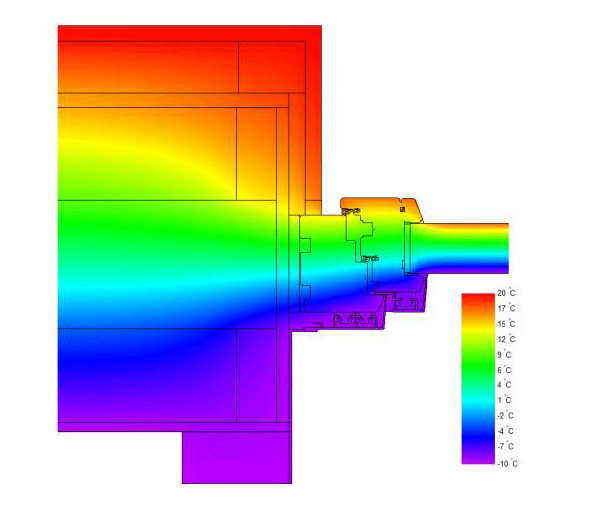

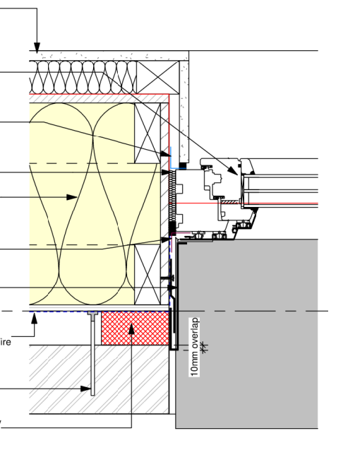

craig Posted February 9, 2021 Posted February 9, 2021 (edited) Do you have a detail? Snapshot of this would be great. Optimal is within the insulation layer. Edited to add thermal modelling of a detail we are currently working on. Edited February 9, 2021 by craig 1
