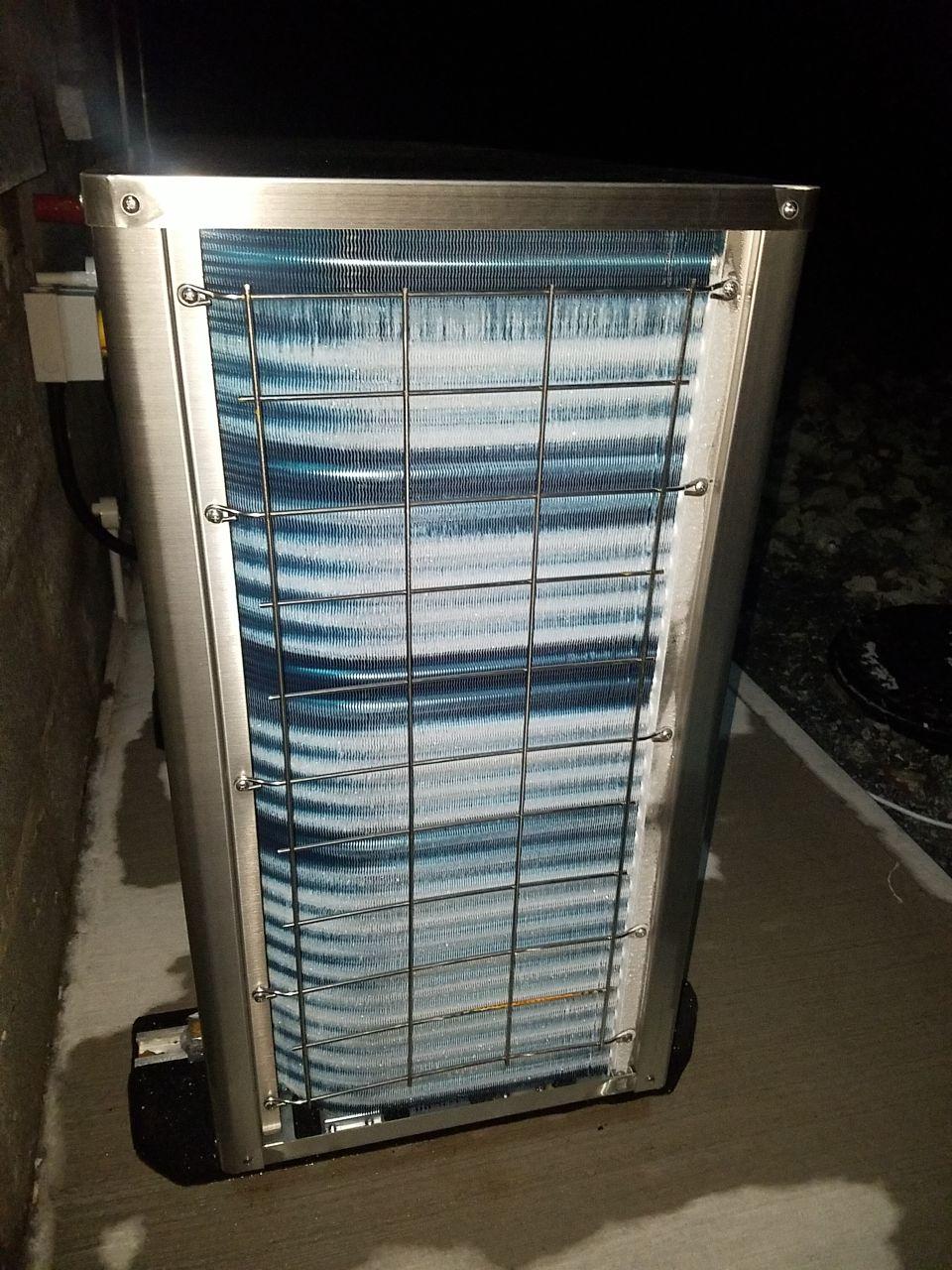

dpmiller Posted February 7, 2021 Share Posted February 7, 2021 some numbers from mine- which has a variable speed fan, tracking compressor load. At Tamb 4c (measured at the rear of the unit) the coil can get down past-2c. I've set defrost to start at -2c, a little colder than the factory setting. Just before defrost started it looked like this: a thin hoare frost over the whole coil, no obstructive solid ice. By the time the unit went through it's processes- fan off, ramp down compressor, change direction, ramp up, repeat, about seven minutes had passed but the coil had de-iced in half that. Link to comment Share on other sites More sharing options...

SteamyTea Posted February 7, 2021 Share Posted February 7, 2021 1 hour ago, dpmiller said: a thin hoare frost over the whole coil, no obstructive solid ice Seems your system is working right. Do you collect data all the time on the air temperatures? 36 minutes ago, joe90 said: After it went off yesterday afternoon, it’s not run again, house warm enough. Phew, got away with it. And you have a nice cosy house. 1 Link to comment Share on other sites More sharing options...
