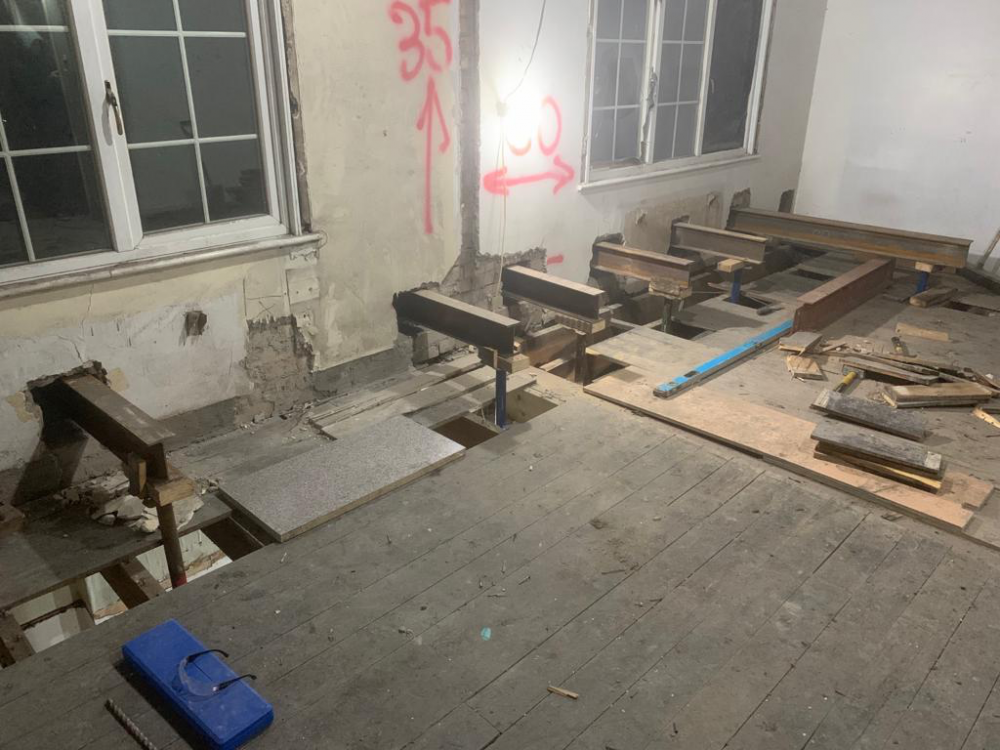

Adsibob Posted January 27, 2021 Posted January 27, 2021 I’m knocking down the full width of the rear ground floor of my house. Have a good structural engineer who has done a detailed design which impressed the architect. But he didn’t specify how to knock down the rear wall, which I guess is normal. No need to teach an experienced builder how to suck eggs. At least that’s what I saw until I saw this. This is a view from upstairs and shows how they have temporary supports coming from the ground up through the first floor and supporting each side of six short RSJs that in turn supports the rear upstairs wall of the house. It is not how I was expecting them to do it, but what do I know. What do you think? Presumably they will add a seventh pair of supports for a seventh RSJ in between the two on the left and middle of the photo so the supports are all more or less equidistant. Thoughts?

Gus Potter Posted January 27, 2021 Posted January 27, 2021 Unfortunately all may be not well from the one photo posted. At first floor level (the photo?) there is no bracing / lateral restraint to prevent rotation of the needles (RSJs) on plan. What is going on at the ground floor. The needles under the windows are only holding up a few course, the props may lift the masonry here. A lot of load could be coming down that masonry pier between the two windows so all the roof load (depending on span direction) could be on the props here and they could easily be very overloaded, buckle and collapse. The tops of the needles have not been dry packed / packed by the looks of things. When you take the wall down you may get some local crushing of the brick.. movement. Also, the props holding up the pier may not be able to carry the load, especially if they are not braced and footed properly at ground floor level. I would strongly recommend that before you progress with taking down the wall you get an SE to have a look at this.
Mr Punter Posted January 27, 2021 Posted January 27, 2021 One or two pins missing. Make sure the acrows are tied together with scaff poles. Make sure they all are vertical and have a proper footing.

Adsibob Posted January 27, 2021 Author Posted January 27, 2021 3 minutes ago, Mr Punter said: have a proper footing What constitutes proper footing?
Mr Punter Posted January 27, 2021 Posted January 27, 2021 1 minute ago, Adsibob said: What constitutes proper footing? Some nice, solid ground. Like if you dropped a sledgehammer where the base was going from a height of a metre, after 50 goes it would not be sinking down.

markc Posted January 28, 2021 Posted January 28, 2021 (edited) You can see the support works are not yet finished (another hole started), the UB`s are not new and pretty much an ideal length - They have done this before Edited January 28, 2021 by markc 1
