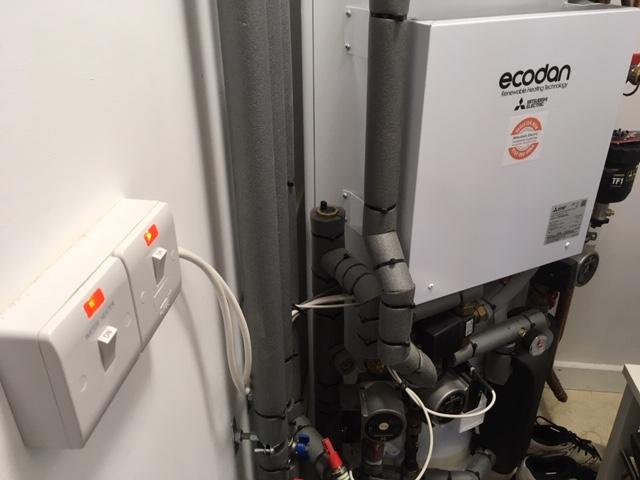

Redoctober Posted January 28, 2021 Posted January 28, 2021 13 hours ago, PeterStarck said: What's the immersion for. It could well be using a lot of electricity, have you tried turning it off. Just bumping this question as I too would like to know - we have an immersion and it is never switched off! Is this something I could change by switching it on and off when necessary? But I suppose in order to do that I would need to know its purpose.
joe90 Posted January 28, 2021 Posted January 28, 2021 5 minutes ago, Redoctober said: Just bumping this question as I too would like to know - we have an immersion and it is never switched off! Is this something I could change by switching it on and off when necessary? But I suppose in order to do that I would need to know its purpose. Immersions are usually back ups, legionella dosing (on a timer) or built into the ASHP to raise DHW to higher temps. What’s your set up?.

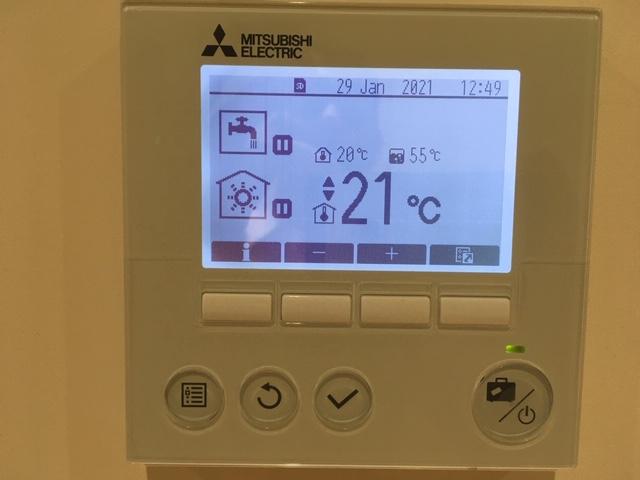

Redoctober Posted January 29, 2021 Posted January 29, 2021 (edited) 14 hours ago, joe90 said: Immersions are usually back ups, legionella dosing (on a timer) or built into the ASHP to raise DHW to higher temps. What’s your set up?. Hi @joe90 Not sure what the set up is other than the "system" is controlled by a central control panel and then there are seperate units for each room. I have attached some images which may help fill in the gaps of my limited knowledge. I do know though that the main control panel has been set up to allow a regular "legionella" flush so to speak, which brings into question my immersion heater switch. Both these wall units are on 24 / 7 and one is labeled "water heater". Edited January 29, 2021 by Redoctober tidy up
joe90 Posted January 29, 2021 Posted January 29, 2021 @Redoctober, personal choice but quite a few of us don’t believe in/operate a legionella cycle. Why not try turning off the immersion and see what happens, mine are only used fir backup.
ProDave Posted January 29, 2021 Posted January 29, 2021 Yes definitely turn off the immersion heater switch. If the immersion is controlled by the HP controller for anti legionaires it should not be in 24/7
Redoctober Posted January 29, 2021 Posted January 29, 2021 Thanks @ProDave and @joe90 i will give that a go - sadly though you are dealing with a right numpty and knowing my luck I will switch the wrong one off - Is the one marked "water heater" that I should turn off and see how things change? ?
ProDave Posted January 29, 2021 Posted January 29, 2021 Yes turn off the "water heater" switch and report back the changes. 1 1
joe90 Posted January 29, 2021 Posted January 29, 2021 I do think the other switch should have a label (if done by a professional ?♂️).
