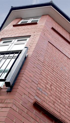

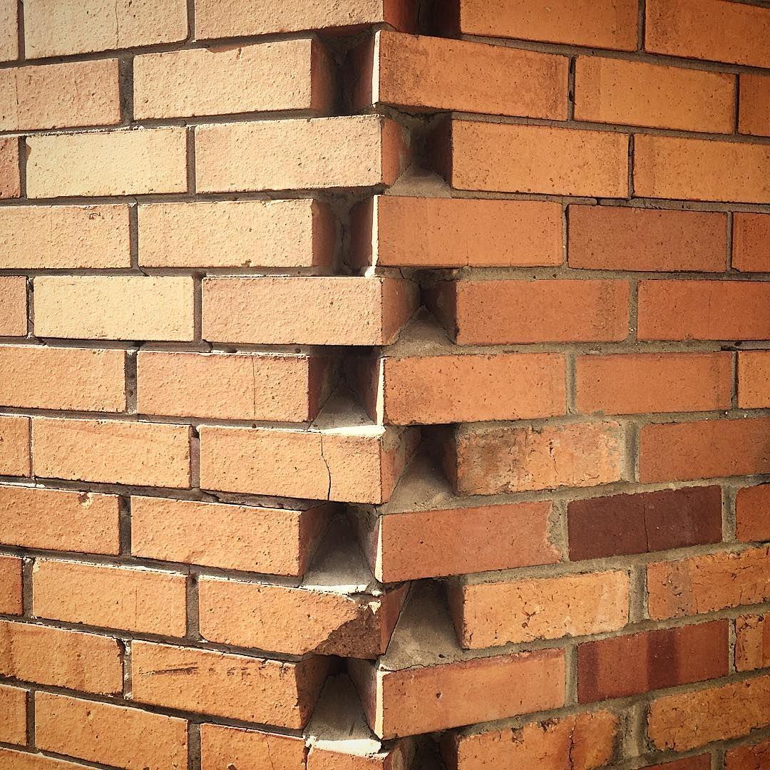

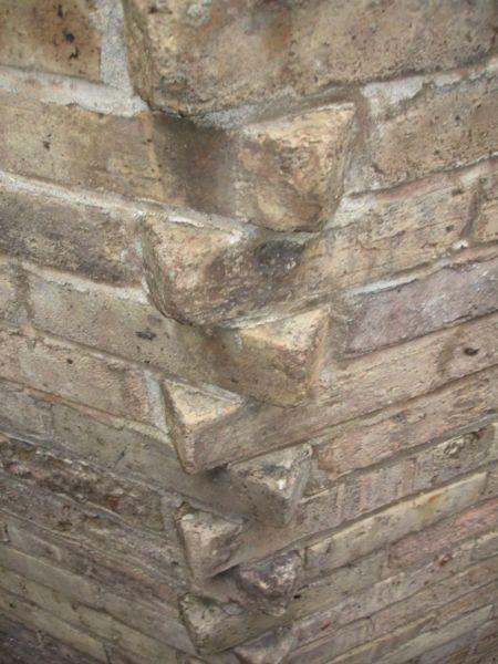

Adsibob Posted January 24, 2021 Posted January 24, 2021 Extension works are underway and my builders will start the brick laying in about 2-3 weeks. I need to order the bricks and have only just found out that the bricks we were going to go with might not be available in the special "dogleg" shape that helps with laying bricks over a 45 degree angle. I have two 45 degree angles on my project so it's quite important we get this right. Are there any structural/damp/longevity issues to consider or is this purely an aesthetic choice? I've uploaded some photos of the different options, as I understand them to be.
wozza Posted January 24, 2021 Posted January 24, 2021 IF you cant get the bricks you want in squints, then could you get some contrasting squints to make a feature of it?
nod Posted January 24, 2021 Posted January 24, 2021 We had the second picture at a previous house They had been payed for over 30 years Can’t remember there being any issues The top one looks better but more cost

Adsibob Posted January 24, 2021 Author Posted January 24, 2021 10 minutes ago, nod said: We had the second picture at a previous house They had been payed for over 30 years Can’t remember there being any issues The top one looks better but more cost Thanks @nod but with the top style, isn't there less brick between the inside and the outside at that corner. Won't it diminish the U value of the wall? Also, why do you say the top one is more cost?

nod Posted January 24, 2021 Posted January 24, 2021 17 minutes ago, Adsibob said: Thanks @nod but with the top style, isn't there less brick between the inside and the outside at that corner. Won't it diminish the U value of the wall? Also, why do you say the top one is more cost? I wouldn’t have thought so 30 minutes ago, nod said: We had the second picture at a previous house They had been payed for over 30 years Can’t remember there being any issues The top one looks better but more cost 30 minutes ago, nod said: We had the second picture at a previous house They had been payed for over 30 years Can’t remember there being any issues The top one looks better but more cost Sorry I meant the bottom pic special order brick

PeterW Posted January 24, 2021 Posted January 24, 2021 @Adsibob you cut the brick to a point so the cut face buts up to the next brick. Easy done but the downside is there is no overlap between courses and you get a mortar join up the corner that can look untidy. That’s why squints or bonded bricks are best. You’ll only do this once so saving £3-400 on this will be something you’ll look at for a lifetime.
