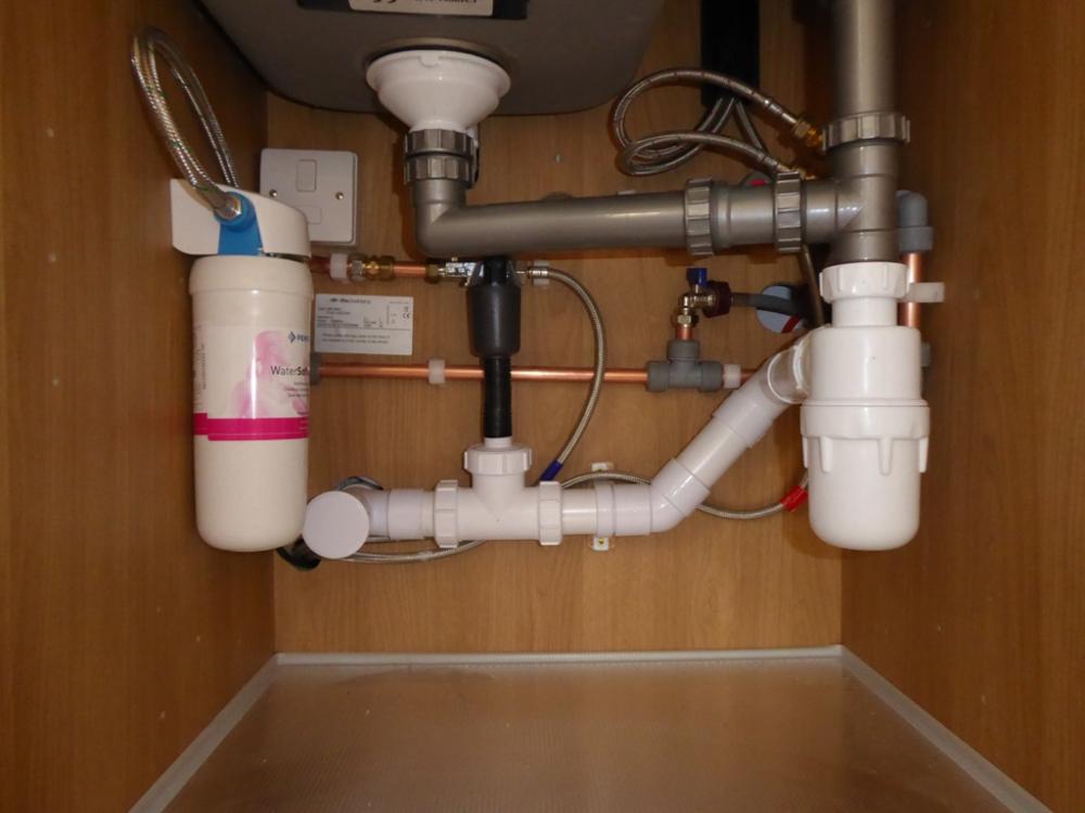

Planning my first fix plumbing and wiring and so it's decision time for my DHW.
As a small building used for holiday lets I will not have a boiler or the need for any bulk hot water storage. I also don't want to be paying for standing losses on a house that might go empty for weeks at a time.
So the options are:
a) Electric shower + two individual under-sink IHW units, one in the kitchen and one in the bathroom
b) Electric shower + multipoint IHW unit feeding both the basin and sink. I could site this near the CU which would be about mid way between the two outlets.
c) Multipoint IHW feeding the shower, basin, and sink.
The last option is very tempting as it would in some ways be the simplest, and possibly the cheapest. Also prevents the possibility of overloading the power supply. But you would want the IHW to produce higher temps, for dish washing, than you'd need for a shower- and I am right in thinking that it's quite inefficient to have to dilute hotter water back down again?

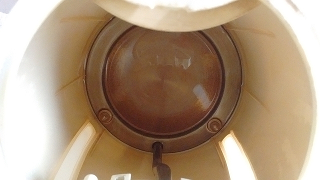

In a soft water area like mine, there is no need to ever worry about plumbing.  Scaling up just does not happen and I think that is one of the biggest problems with plumbing.
Scale is akin to having a huge variable resistor fitted to your electricity supply, and ever day you turn it down a notch.
If you have hard water, you have to fit a water softener.  No argument.
