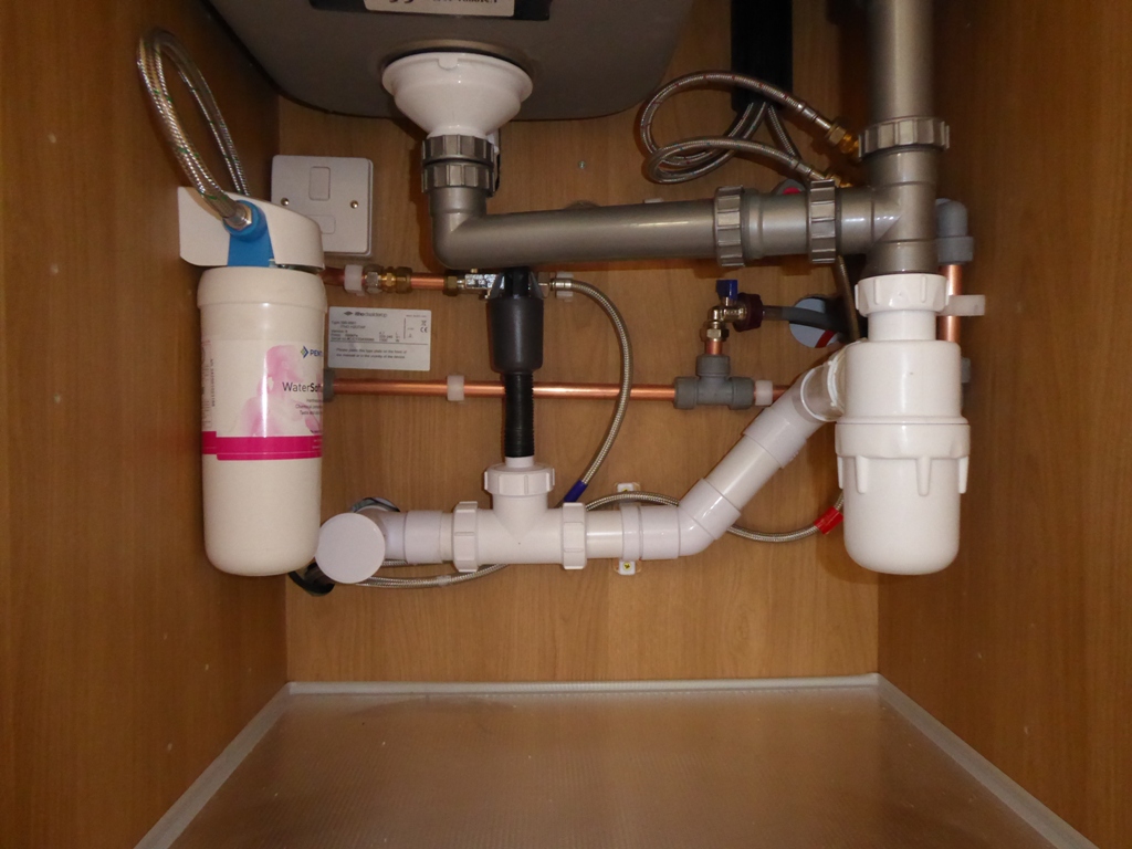

Our Itho boiling water tap came complete with the tundish and trap, plus an adapter to fit it to a 1 1/2" waste pipe.  There are details on this blog entry, towards the bottom, with a photo of the installation inside the cupboard under the sink: http://www.mayfly.eu/2014/04/part-twenty-nine-some-details-that-may-be-of-interest/
Here's the photo from there that shows the PRV and tundish:
The PRV is right next to a needle valve flow rate adjuster, hidden partly behind the grey waste pipe in the centre.  The tundish, with integral water trap, is the black thing in the centre.  What looks like a normal compression tee is actually a special, that allows the waste pipe to go right through it.  The MI's say to cut a vee into the top of the waste pipe, then slide the tee fitting on so that the vertical bit is over the cut out, then fit the tundish reducer/adapter to the top.
Cold water feeds into the flow rate adjustment valve from the 15mm copper on the left, and the cold water feed to the under-plinth tank is the flexible pipe to the right of that.  This pipe also acts as the pressure relief pipe, as the PRV is in the top centre of the tundish.

The reason I asked is I thought discharging (potentially) boiling water into PVC waste pipe was not allowed?
There is an nhbc document around that details how you can use a waterless hepco trap and a particular type of plastic pipe (not pvc, I forget which) to discharge into a stack, but it must be a direct run to the stack in that particular type of pipe that can withstand boiling water.

I'm guessing that they get around that by discharging via the cold feed, so the tiny drips of expansion water that comes out of the PRV will usually not be boiling, but just a bit warm.
In the event of a fault, then it's no different to me running the boiling water tap into the sink above, is it?  I do that all the time, to run off the bit of less than boiling water before making a cup of tea, and to rinse out the small re-usable milk bottle I take over to the new house to disinfect it.
