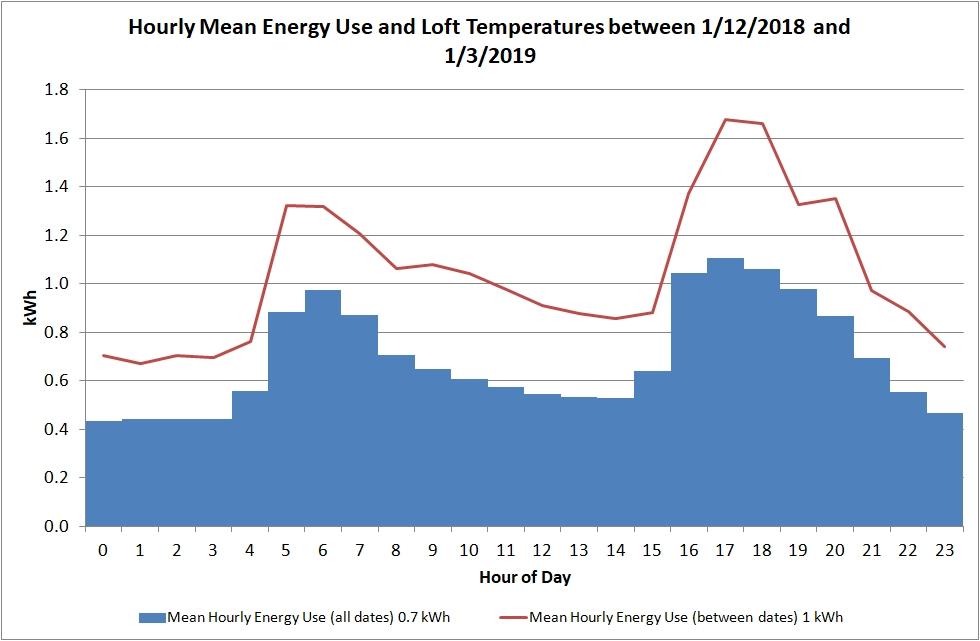

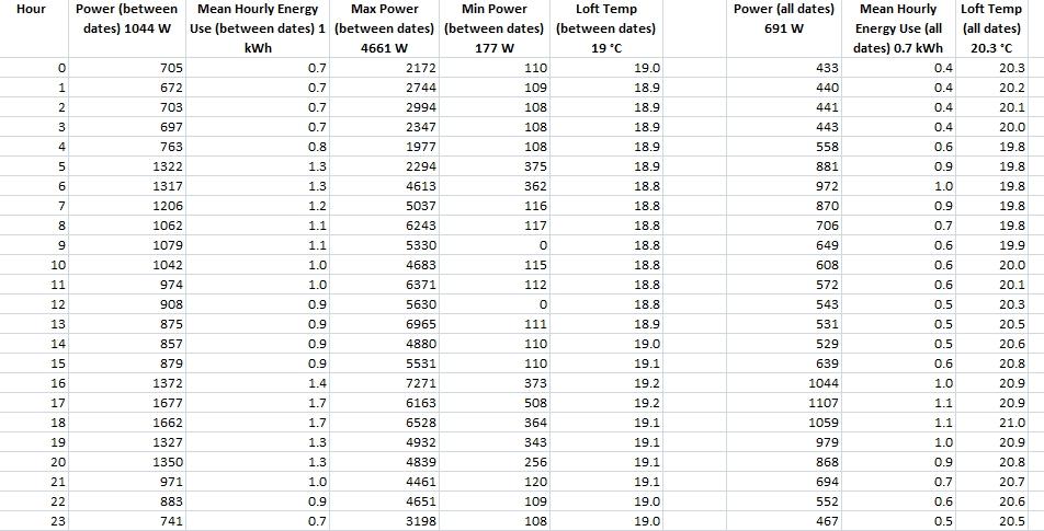

SteamyTea Posted January 21, 2021 Posted January 21, 2021 (edited) 1 hour ago, joe90 said: I don’t have any measuring kit (well @SteamyTea has some kit here but I don’t know what it’s measuring etc I shall see if I have the old spreadsheet I did a couple of summers back. This lockdown is good, means I don't have to 'cross the border, under the cover of darkness' to get into Devon to see you. But come the spring, we should be alright. Here we go. Blue columns are the complete year, red line is the winter, Dec, Jan and Feb. You could possibly benefit financially, but when you look at your absolute numbers, they are pretty low. Edited January 21, 2021 by SteamyTea 1
SteamyTea Posted January 21, 2021 Posted January 21, 2021 (edited) And here are the means for @joe90's Your loft is amazingly stable. Edited January 21, 2021 by SteamyTea
joe90 Posted January 21, 2021 Posted January 21, 2021 (edited) 39 minutes ago, SteamyTea said: Your loft is amazingly stable. It’s a warm roof ? and the whole house is that stable (thermal mass ?) (but I have no idea what the figures mean ?♂️) but the graph looks good ? Edited January 21, 2021 by joe90
SteamyTea Posted January 22, 2021 Posted January 22, 2021 @joe90 Basically, as ~45% of your usage is fixed load i.e. MVHR and Sewage Treatment, which cannot be time shifted, and your ASHP loads are small, peaking at 70% extra (in winter), and as you know, you don't have the heating on for long, there is nothing to be gained by swapping to E7 as you generally need to shift 80% of your load to the 7 hour window. E10, if you can get it (I can't) may offer a slight financial advantage, but it is pennies, not pounds. Really down to finding the overall cheapest price. 1
