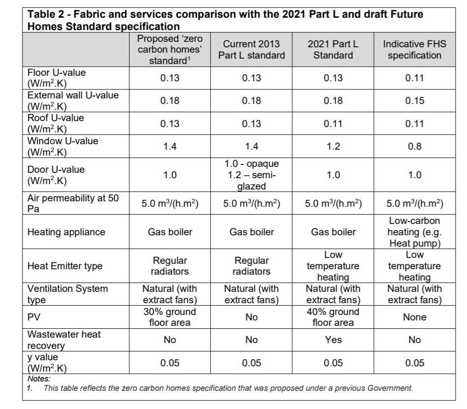

This is the comparison table with past and future regs @the_r_sole. Plus doc attached.
2021-Government_response_to_Future_Homes_Standard_consultation-comparison-table.thumb.jpg.80d855465f10e36bba71647d21e74dbc.jpg
Where do you think the extra cost is?
Column 3 is the interim measures to come in soon. Column 4 is the FHS, which in connection with a decarbonised power supply is the route to Zero Carbon.
I'm not really sure that I see huge extra cost in the interim, though some certainly, and I think that is by design. The big changes are the low temp heating (wonder if big rads count?), and the interesting tactical thing of Wastewater HR and is that compulsory PV (would affect estate layout?), which go away again (later put  them back for a route to carbon positive?), and the gas boiler ban.
To me the fabric changes are not *that* ambitious. I think that including the impact of zero carbon energy supply is probably correct, as that is likely to happen first given where we are at present.

I think the air permeability is not ambitious enough, and perhaps also a couple of others.

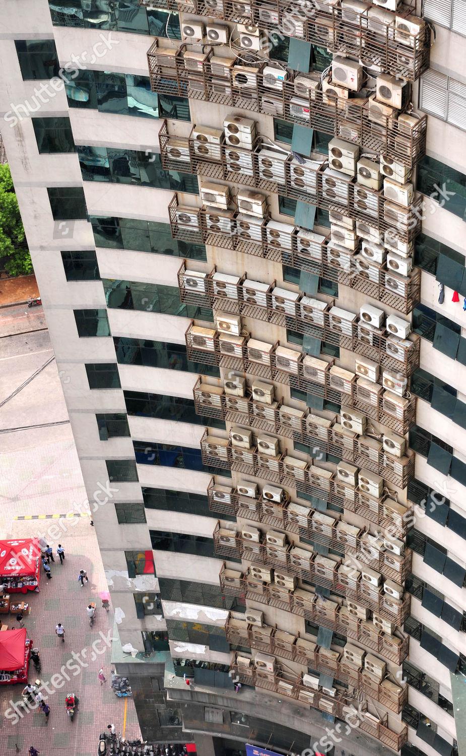

Over half our housing stock is flats.  A quarter is terraced houses.  Most of it is existing.  How the hell will the heat pumps work out?
Flats could have A2A heat pumps, or community heating.  Terraced places may have enough room outside for a monoblock, but could have a split system.
Both flats and terraced have relatively low energy usage by definition (less exterior wall area), so a smaller problem to solve.
