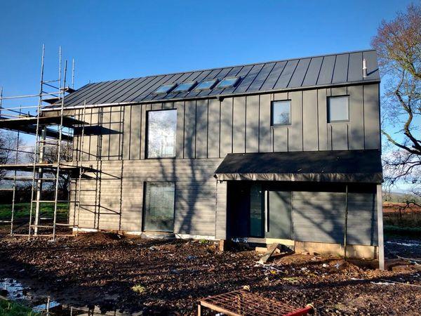

Ralph Posted January 18, 2021 Posted January 18, 2021 Now that we have most of the scaffolding down I'm quite pleased with the look of the house and I'm thinking that I don't really want a big white ASHP sitting against the dark cladding. I was under the impression that you were not supposed to cover the external unit as it had a negative effect on performance, colder exhaust air getting sucked back in etc. I've found these http://www.heatpumpcovers.com/ which claim to be tested and approved by Mitsubishi and others. They only seem to be available in New Zealand but I could make something similar from left over cladding. Any thoughts, good idea or not?

TonyT Posted January 18, 2021 Posted January 18, 2021 I would be more inclined to see if the manufacturer did an option to provide it colour coded. any retrofit cover will kill the air flow to the heat pump and ultimately affect the CoP
joe90 Posted January 18, 2021 Posted January 18, 2021 (edited) 8 minutes ago, TonyT said: any retrofit cover will kill the air flow to the heat pump and ultimately affect the CoP Not sure that is correct, large louvres ! I would bet the area left open would be larger than the area within the plastic fan cover (basing this on looking at my ASHP). or you could just paint it, get it sprayed/powder coated! Edited January 18, 2021 by joe90
AliG Posted January 18, 2021 Posted January 18, 2021 (edited) This company sells wooden ones. They look comically expensive for a small wooden box. https://ecoheatingstore.co.uk/product/air-source-heat-pump-wooden-guards/ I too would be concerned that they would reduce the efficiency. Could you plant a hedge a metre in front of it? That would hide it but be reasonably permeable to the air and not surround it. Maybe even just a few bushes would break it up. Edited January 18, 2021 by AliG

Ralph Posted January 18, 2021 Author Posted January 18, 2021 Bloody hell the large version of that is £772! I think as @joe90 says large enough louvres along with being open at the back should be ok. Weather protection is a good point. None of the manufacturers seem to offer them and I would imagine they would be super expensive if they did.
PeterW Posted January 18, 2021 Posted January 18, 2021 Covers all come off - get them professionally sprayed as the shields /screens reduce performance. 1
Russell griffiths Posted January 18, 2021 Posted January 18, 2021 As peter, take it apart rub it down spray it the colour of the house.
Ralph Posted January 19, 2021 Author Posted January 19, 2021 I'll have a look at painting although even painted I think it's going to look a bit obvious. First world problems and and all that.
Ultima357 Posted January 19, 2021 Posted January 19, 2021 I'd tend to think large louvres made out of Cedral or Hardiplank would have minimal air flow restrictions and not affect it greatly, particularly if the back is left open and the louvres are say 300mm plus from the cabinet. 1

pudding Posted January 21, 2021 Posted January 21, 2021 I literally just finished doing exactly this, disguising my A2A external unit this week (plus radon outlet under there) and put the slates on this morning. Used left over cedar cladding and some old slates. Hopefully it won't kill the airflow too much. You can still feel a nice airflow coming through the vertical slats so dont think the COP is going to be killed from it. There are plenty of places selling stuff like this for a lot of money, so I doubt there's too much effect on performance.
joe90 Posted January 21, 2021 Posted January 21, 2021 Smart, but I would prefer louvres to the front/side to restrict airflow less.
SteamyTea Posted January 21, 2021 Posted January 21, 2021 4 hours ago, pudding said: plus radon outlet under there You have your own nuclear fission reactor, cool. Just pump it into the house to warm it up. 1
Ralph Posted January 22, 2021 Author Posted January 22, 2021 Looks good. I had thought the airflow came in through the front and was expelled out the sides and back which might cause an issue with cold air being deflected from the side of the building round to the front. I now realise it's the opposite so that should not be a problem
