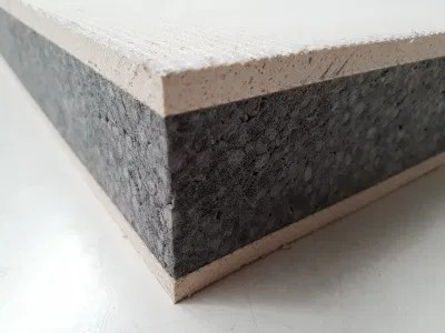

Russell griffiths Posted January 18, 2021 Share Posted January 18, 2021 I just thought I would check something. On another group I’m a member of somebody is suggesting that they are going to build an extension with sips then a membrane and then cement boards screwed directly onto the sips, no battens no air gap or cavity. Now I’m sure that is totally wrong but they reckon it’s the correct spec. Who's the lunatic me or them. Link to comment Share on other sites More sharing options...
SuperJohnG Posted January 18, 2021 Share Posted January 18, 2021 (edited) Them in my opinion. I have SIPS and I will be having a 50mm air gap then my renderboards. Albeit I am now very interested to follow this, only person I know with something attached directly to a kit is @ProDave with his wood fibre cladding which is rendered. Dunno know if thats nearly equivalent? following with interest. Edited January 18, 2021 by SuperJohnG Link to comment Share on other sites More sharing options...

Iceverge Posted January 18, 2021 Share Posted January 18, 2021 1 hour ago, Russell griffiths said: I just thought I would check something. On another group I’m a member of somebody is suggesting that they are going to build an extension with sips then a membrane and then cement boards screwed directly onto the sips, no battens no air gap or cavity. Now I’m sure that is totally wrong but they reckon it’s the correct spec. Who's the lunatic me or them. It might work if they had magnesium oxide based SIPS. Link to comment Share on other sites More sharing options...
ProDave Posted January 18, 2021 Share Posted January 18, 2021 Yes my wood fibre is directly attached and then rendered no cavity anywhere. https://www.natural-building.co.uk/system/timber-frame-render/ Link to comment Share on other sites More sharing options...
ADLIan Posted January 18, 2021 Share Posted January 18, 2021 The above link references a BBA cert that appears to be no longer valid. The replacement certificate now includes the vent cavity behind the cladding system. Check MIs and 3rd party certificates for exact requirement, accepted good practice is that render should not be applied direct to TF or insulation on TF. Link to comment Share on other sites More sharing options...
