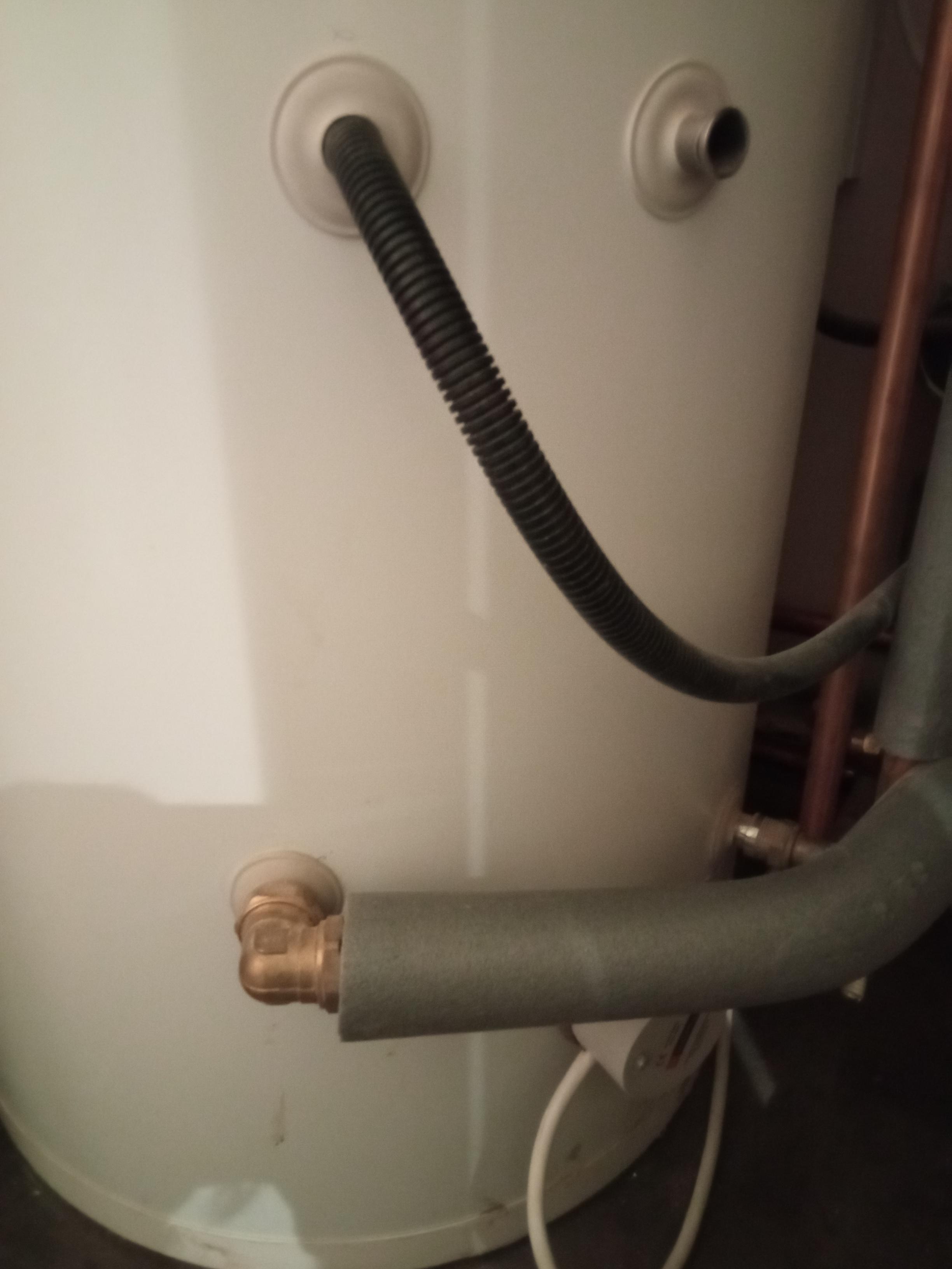

ProDave Posted January 11, 2021 Posted January 11, 2021 An ASHP will usually heat the hot water according to a sensor supplied with the ASHP that is inserted into a thermostat pocket on the cylinder. Can you see anything that just looks like a thin wire disappearing into a small hole on the side of the cylinder? If so post a picture, and an idea of how far up the cylinder that sensor is inserted. When i set ours up first, I put the sensor into the higher of the 2 available pockets, which was half way up the tank. that did not work well, because the ASHP would not sense the water needed heating until half of it was already used up. It works a lot better in the lower pocket. Even so, the lower pocket on my tank is about 1/3 of the way up, so again the HP won't know the water wants heating until 1/3 of it has already been used up. Then remember a HP is much lower power than a normal boiler so takes longer to heat a tank of water than a boiler will. Re shower usage, I measured our rainfall shower at something like 15L per minute full tilt and if used at full would use half a tank of water in not much over 10 minutes.

PeterW Posted January 11, 2021 Posted January 11, 2021 It’s in the conduit going into the left hand port.

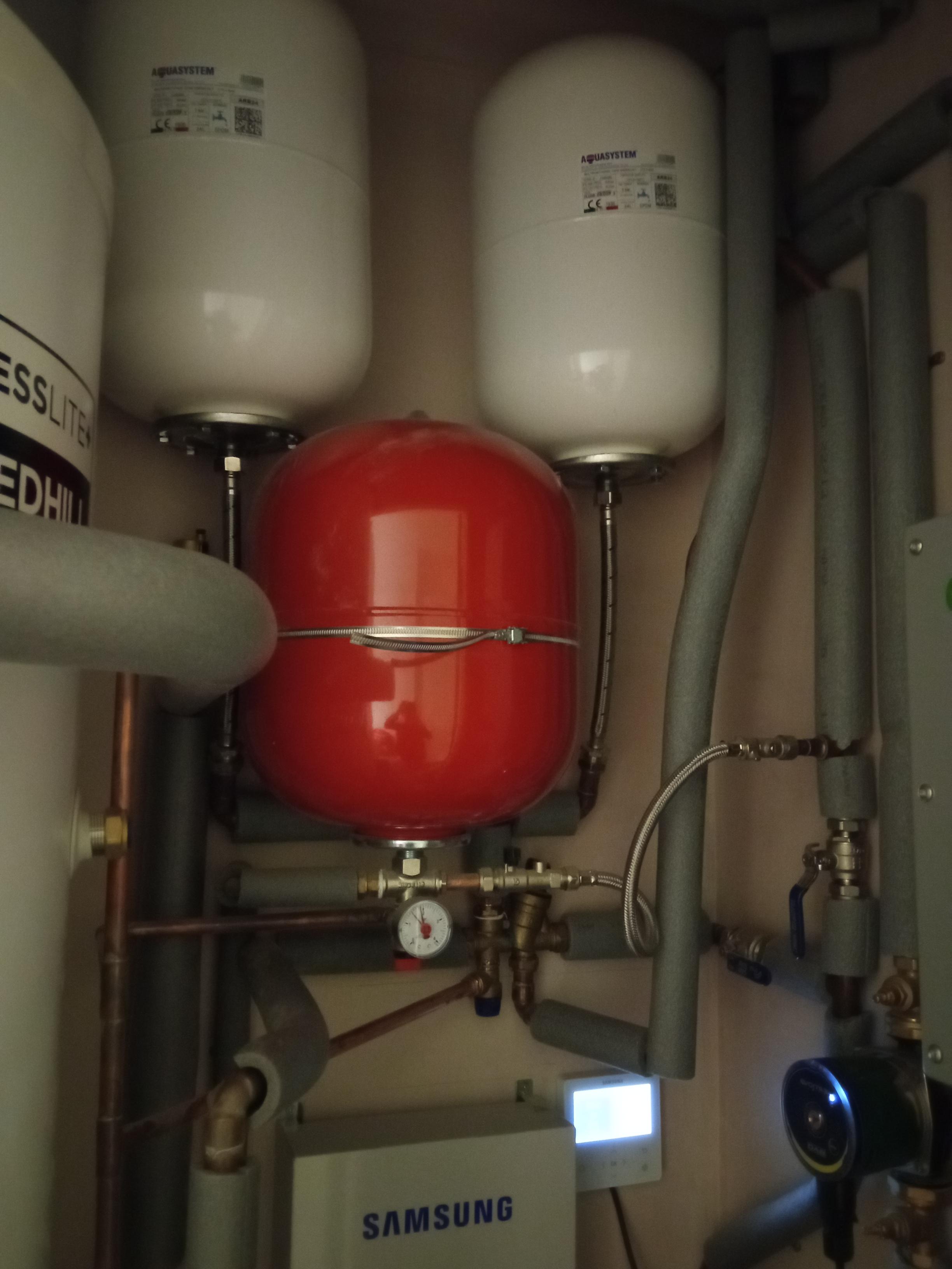

ProDave Posted January 11, 2021 Posted January 11, 2021 That could be it. the temperature probe wire enclosed by a bit of flexible conduit. The white wire at the bottom is the immersion heater. That looks to be halfway up the tank and I don't see a lower down pocket to move it to. If so the ASHP won't even know the tank is getting used up until half your water has gone. Up to that point, the water in the tank stratifies, that is the hot water does not mix with the cold coming in at the bottom to replace the hot that is drawn off. but as soon as the ASHP starts heating the hot water, convection starts within the tank, and that will cause the remaining hot water in the tank to mix with the cold at the bottom, so the first thing that will happen as the ASHP starts to heat the water, is the temperature of the hot water at the top of the tank DROPS before it then starts to heat up again. EDIT hadn't seen the second photo, the sensor looks to be more like 1/3 of the way up the tank.

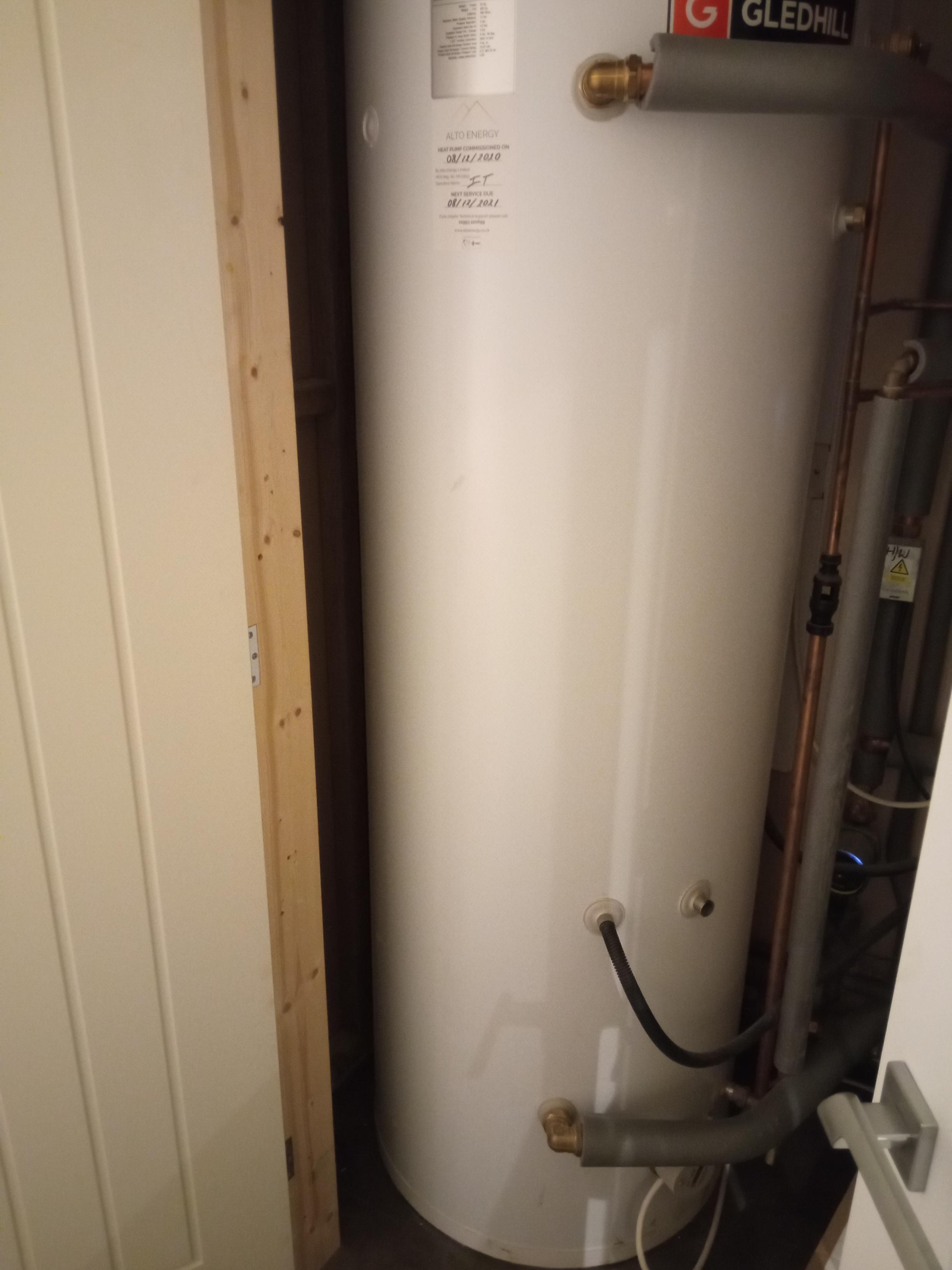

joe90 Posted January 11, 2021 Posted January 11, 2021 That sensor is not at the bottom of the tank so I don’t believe you will have 400litres of hot water. My tank (350l )has two pockets fir thermostats at 1/3 and 2/3 from the top, I put it in the top pocket fir two of us but move it to the lower one if we have visitors.
canalsiderenovation Posted January 11, 2021 Author Posted January 11, 2021 (edited) Hmm so it seems to be almost a third of the way up. Tank height 197cm and that flexi is 68cm. I can't see any lower point - there are higher points not lower ones. I'm presuming it's as good as it gets as it is? Edited January 11, 2021 by canalsiderenovation
canalsiderenovation Posted January 11, 2021 Author Posted January 11, 2021 Wife now thinks she may have been in shower over 20 minutes so it could be she completely used up all the water! This hasn't happened when I've had a big bath and she had the large showerhead on and the Mira shower is really powerful. I should have got on the app whilst she was in and adjusted the temperature to cold..... 2
