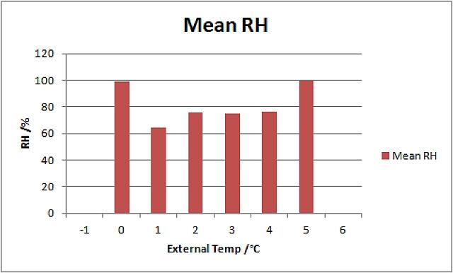

SteamyTea Posted January 9, 2021 Posted January 9, 2021 While our temperatures have been cold for down here, they are not really cold, hovering between 0°C and 4°C. With our relatively high humidity, this is the worse temperature range for an ASHP. Not cold enough, for long enough, to condense moisture our of the air and lock it up as ice, and not hot enough to reduce the density of the air, and hence the amount of gaseous water in the air is at a maximum. We knew it would happen @joe90's, just seems the last few winters have been exceptionally mild, and it is probably just a statistical fluke (stochastic) event, probably would not have noticed it via the house temperature, just that it happened when the ASHP was trying to heat the water. Possibly, as a solution, in this type of weather, running the DHW cycle at the coldest time i.e. <=0°C, would produce less icing when the ASHP is working at its hardest. 1

SteamyTea Posted January 10, 2021 Posted January 10, 2021 (edited) 10 hours ago, SteamyTea said: While our temperatures have been cold for down here, they are not really cold, hovering between 0°C and 4°C. Just done my Sunday morning ritual of processing my weather and energy data. Mean temp has been 2.9°C and the mean RH has been 98% Min Temp 0°C and Min RH 29% (probably last night as there is a hard frost this morning) Max Temp 5.2°C and Max RH is 100% (this is where the sensors tops out, so it may have gone higher, as odd as that sounds) Edited January 10, 2021 by SteamyTea
