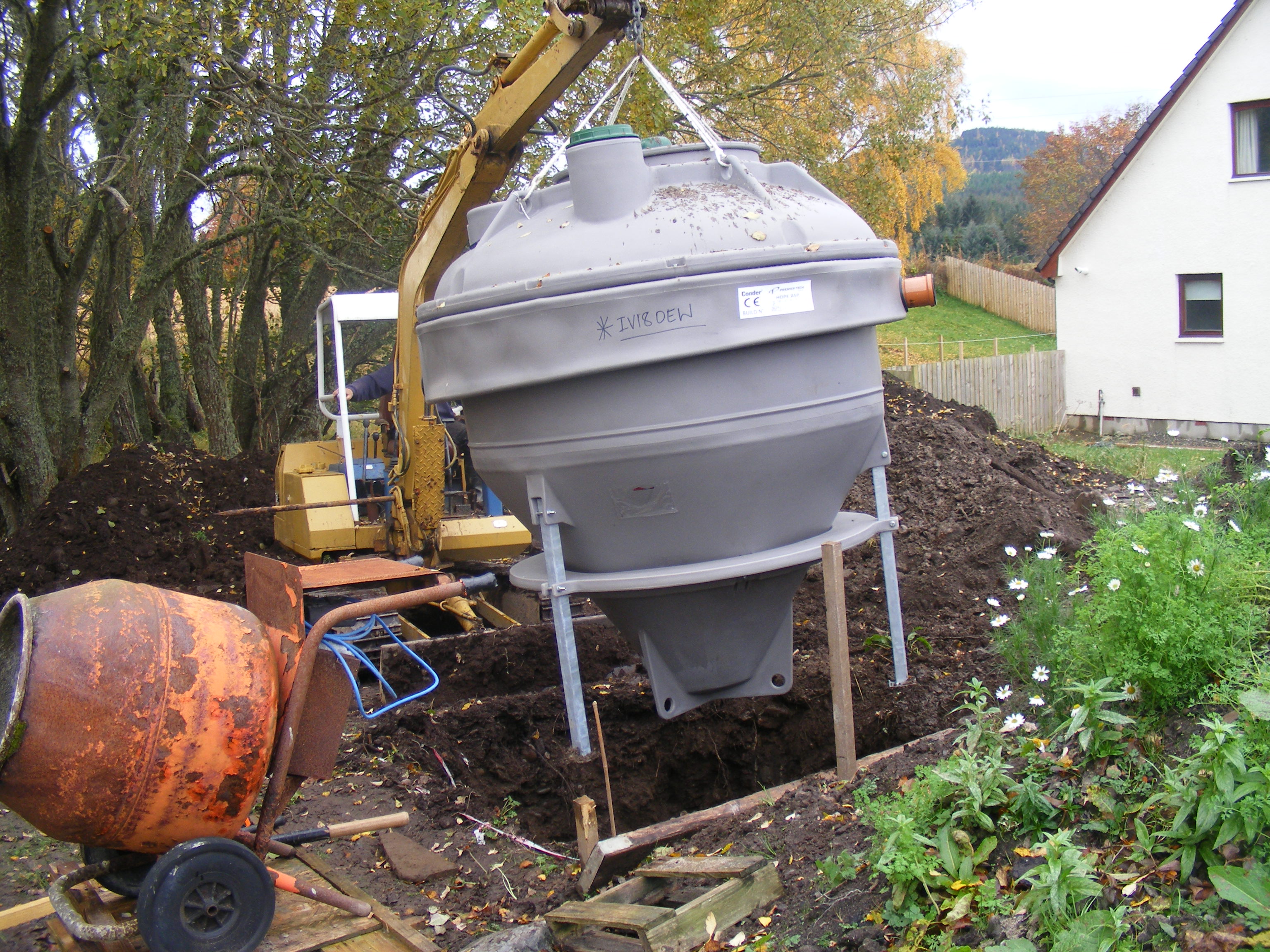

ProDave Posted February 2, 2017 Posted February 2, 2017 Our Conder, is like many of the air pump plants, a conical shape. One of the reasons I chose this one was the retaining "ring" near the base. Once that is encased in concrete that's it solidly anchored into the ground. Our present septic tank was installed by a contractor and I didn't know better then, and it's just encased in pea gravel. I only ever get that emptied in the summer after a long dry spell, I would never empty it in winter, I have seen one "float out of the ground" doing so.
Jeremy Harris Posted February 2, 2017 Posted February 2, 2017 Like Dave, our conical BioPure is set in concrete at the base, which encapsulates moulded-in lugs that act as anchors. The manufacturer offer a ground anchor kit, made up of chains and galvanised angle, but I much preferred the idea of it being held down by their alternative recommended method, the concrete ring around the base. The bottom 1/3rd of our tank is below the water table all the time, and we had to pump the water out of the hole before we put the tank and concrete in.

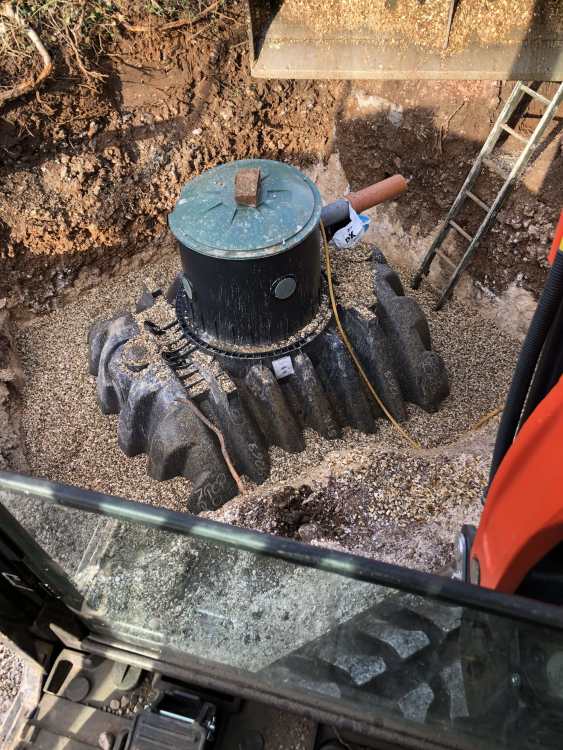

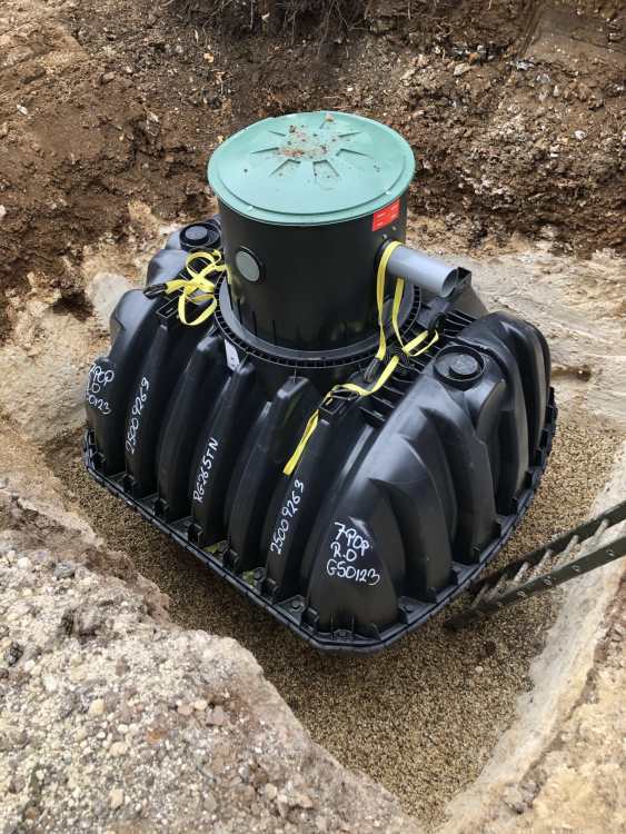

Barney12 Posted April 24, 2017 Posted April 24, 2017 @joe90 We decided on the Graff unit in the end. This one: Link. Its going in this week and will connect to the existing outbuilding and flat so will be 'live' pretty much straight away. Well at least it will be when I fathom how I'm going to get temporary power to it! A few of points of interest: If you download the manual you'll be fooled into thinking it needs assembling. That's not the case in the U.K. they are delivered fully assembled. The manual also states that the air hoses are not supplied. Again wrong. In the U.K. they come with 20m of hose. There is as yet no installation guide for the one2clean units. It apparently hasn't been translated into English yet!! 1

Barney12 Posted April 25, 2017 Posted April 25, 2017 3 hours ago, joe90 said: How noisy is the pump. I could mount it in our cloakroom that doubles as a plant room ( cupboard) Barney12 let us know how you get on with the instal and how you bed it etc, decision time for ours is getting closer. Graff specification is 150mm firm base (we're going to do a weak mix of concrete on our super hard ground) and then back filled with pipe bedding/granular fill 500mm out from the tank. Ill take some photo's 1
