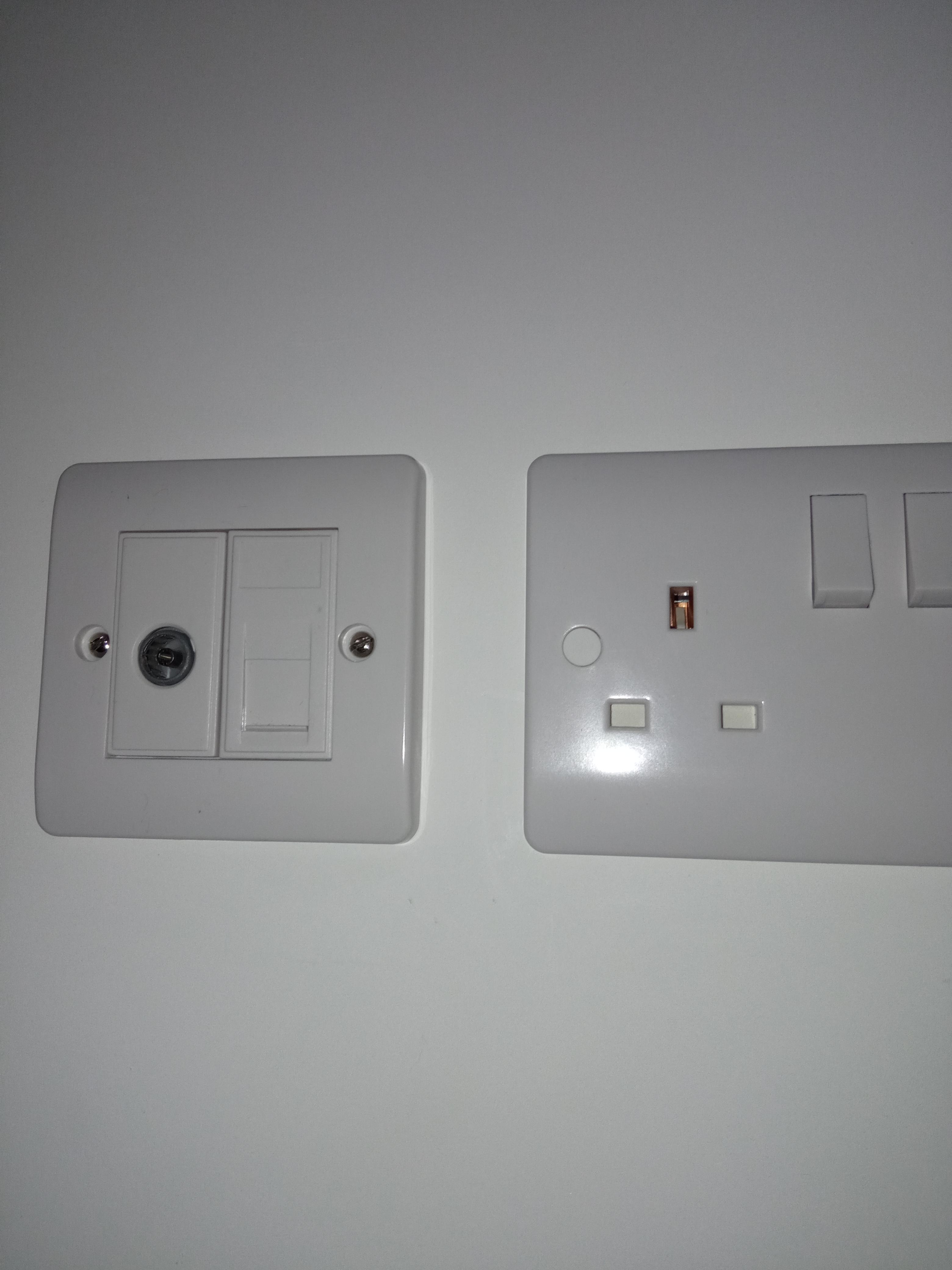

canalsiderenovation Posted January 5, 2021 Posted January 5, 2021 (edited) Finally we got our BT line connected. We suffer generally with poor Wifi and non existent mobile coverage due to our location but I'm pleased to report we have 4 devices connected so which is enabling us to work and watch Netflix! I've not tried the wifi coffee machine or ovens yet on the basis I can't think why I'd need wifi on them! The bedroom/dressing room is the furthest away point and we have no wifi at all. I did take advice and get Cat5/6 whatever it was put in the dressing room (where we may eventually have a TV), in the living room and at the opposite end of the house in a guess bedroom ( the latter two of which are fine on WiFi and closer to the router). So, what can I buy that will give me wifi in the bedroom to plug into this socket/Ethernet? Any particular brands or equipment I should focus on? I think @AliG had some kind of booster and @PeterW I'm sure I read you have similar? Edited January 5, 2021 by canalsiderenovation
ProDave Posted January 5, 2021 Posted January 5, 2021 It looks like you don't have the ethernet socket connected yet, just a tv aerial socket and a blank. Assuming the cable is there you need the ethernet socket connecting there, and at the other end the cable fitted with an RJ45 plug and plugged into one of the ethernet sockets on the router. Someone else will have to advise what to plug into it. We used an old reconfigured BT router (in the static caravan) but it was not a seamless reconnection when you moved from one zine to another. 1
AliG Posted January 5, 2021 Posted January 5, 2021 (edited) A few of us have Ubiquiti systems, but it sounds like you just need a single extra access point so this may be overkill. What you want is a wireless access point. You will plug this into the ethernet socket in the dressing room and then the socket should be connected to your wifi router at the other end. If you think you will never use more than a 100Mbps internet connection then something like this would suffice, despite having a max wifi speed of 450 Mbps it only has a 100Mbps ethernet connection. https://www.amazon.co.uk/TP-Link-TL-WA901N-Wireless-Injector-Ethernet/dp/B087MSF7BR/ref=sr_1_3?dchild=1&keywords=wireless+access+point&qid=1609864374&s=computers&sr=1-3 This one supports gigabit ethernet and AC wifi so will be more future proof for £40 https://www.amazon.co.uk/TP-LINK-TL-WA1201-AC1200-MU-MIMO-Wireless/dp/B084BGKJZT/ref=sr_1_16?dchild=1&keywords=wireless+access+point&qid=1609864374&s=computers&sr=1-16 A Ubiquiti access point starts at around £70. I do think their pricing has become a little high recently as it has not fallen as much as other people have fallen. They are however flat and can be wall or ceiling mounted so are less intrusive. https://www.amazon.co.uk/Ubiquiti-Networks-UAP-AC-LITE-Access-Point/dp/B016K4GQVG/ref=sr_1_4?dchild=1&keywords=wireless+access+point+ubiquiti&qid=1609864852&s=computers&sr=1-4 If your router does not have enough ports to connect everything you will need an ethernet switch, something like this - https://www.amazon.co.uk/dp/B07PYSNSDD/ref=sspa_dk_detail_1?psc=1&pd_rd_i=B07PYSNSDD&pd_rd_w=dsWVI&pf_rd_p=1055d8b2-c10c-4d7d-b50d-96300553e15d&pd_rd_wg=Iubbn&pf_rd_r=1C6GN7PYKR5MNJY0VSKQ&pd_rd_r=967a89c9-1c5b-4216-bdc6-804545f01f51&spLa=ZW5jcnlwdGVkUXVhbGlmaWVyPUFBTDlURFFDNVlYRUgmZW5jcnlwdGVkSWQ9QTA5NDg1MzQxSVdCUFc0NDNQTVk3JmVuY3J5cHRlZEFkSWQ9QTAxNDU0MDk2SlNDRzJMSkc4VEomd2lkZ2V0TmFtZT1zcF9kZXRhaWwmYWN0aW9uPWNsaWNrUmVkaXJlY3QmZG9Ob3RMb2dDbGljaz10cnVl You can set up the access point with the same SSID (network name) and password as your main router and things should pretty seamlessly move between them. Edited January 5, 2021 by AliG 1

Mr Punter Posted January 5, 2021 Posted January 5, 2021 The Ubiquiti APs are powered via the ethernet cable and supplied with a POE injector, which you can either plug in near the access point or near the router.

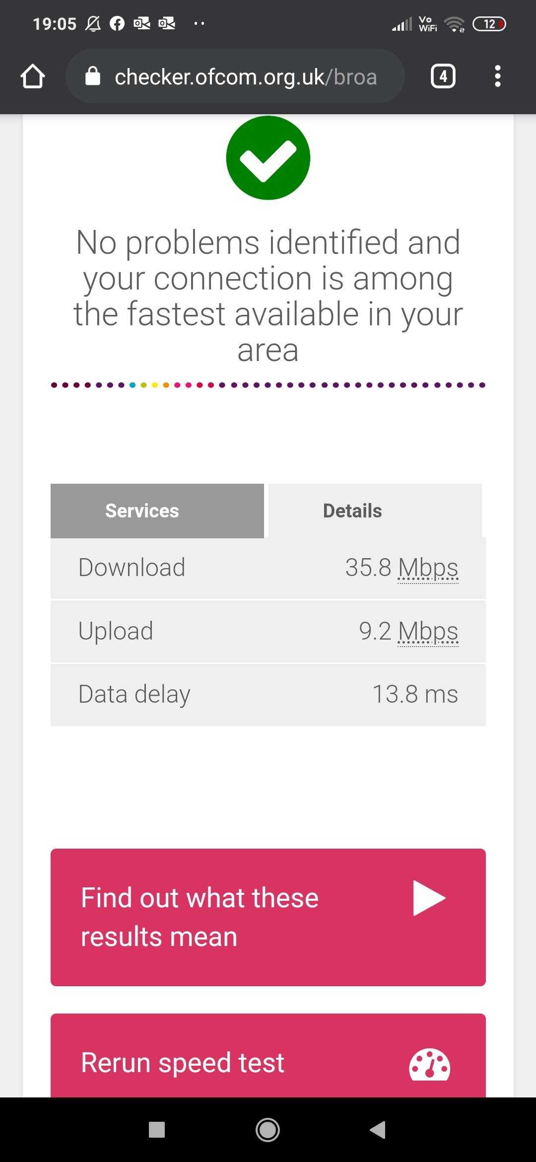

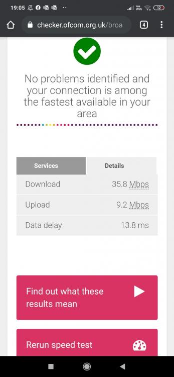

AliG Posted January 5, 2021 Posted January 5, 2021 4 minutes ago, Gav_P said: I only have 36mbps maximum where I live, but now using the Deco mesh I have that speed everywhere. This probably explains things. When I had less than 100Mbps then I saw pretty much the same speed everywhere in the house. As it got faster then I saw more slowdown. @canalsiderenovation has not said what his incoming internet speed is and this does make a difference, if it is more modest then the hits you see to the speed are less.
canalsiderenovation Posted January 5, 2021 Author Posted January 5, 2021 2 minutes ago, AliG said: @canalsiderenovation has not said what his incoming internet speed is and this does make a difference, if it is more modest then the hits you see to the speed are less I'm a her! I've ordered the TP mesh system (1-2 bedrooms) and the Ubiquiti and will see which is better. Just ran a speed test.

Buzz Posted January 5, 2021 Posted January 5, 2021 Hi @canalsiderenovationyour speeds look very similar to mine , over the years I have tried ,with varying degrees of success , different ways of getting a stable signal throughout the house .since covid and having 4 people working or learning at home my old tplink system kept dropping in and out causing more stress at an already stressful time , so got 3 of the bt Black discs on sor and spread them around the house and now get stable signal in all rooms at all times , I don't think they were one of the cheapest but the fact I don't have to act as Internet monitor for half my working day means they are worth every penny.
canalsiderenovation Posted January 5, 2021 Author Posted January 5, 2021 14 minutes ago, Buzz said: Hi @canalsiderenovationyour speeds look very similar to mine , over the years I have tried ,with varying degrees of success , different ways of getting a stable signal throughout the house .since covid and having 4 people working or learning at home my old tplink system kept dropping in and out causing more stress at an already stressful time , so got 3 of the bt Black discs on sor and spread them around the house and now get stable signal in all rooms at all times , I don't think they were one of the cheapest but the fact I don't have to act as Internet monitor for half my working day means they are worth every penny. We are also both working from home, I would be normally anyway but there are both of us with multiple Skype and MS Teams meetings we can be in different rooms/other side of the bungalow. I've got the TP mesh things ordered and the Ubiquiti so I need to get them both out and see which works best then send the other back to Amazon.
