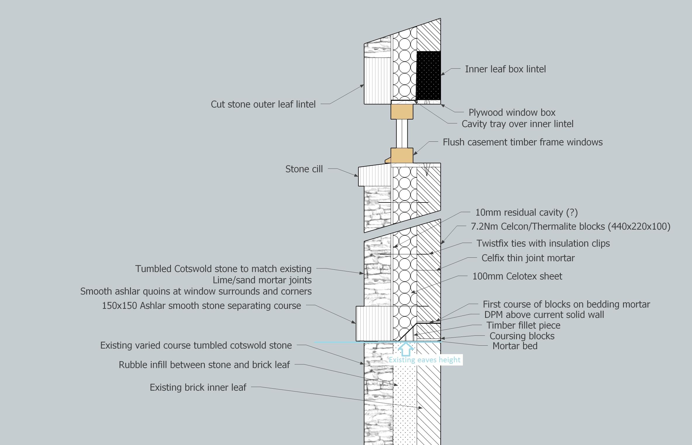

SuperPav Posted December 31, 2020 Share Posted December 31, 2020 Hi all, long time lurker/reader, am just hoping to finalise the building drawings with a view to (finally) get the build started in the new year. It's currently a 1950's Cotswold bungalow, and we will be building up from current eaves height. For a number of various reasons, knocking down and starting again is a non-starter, so it's up up up and away... We have decided on masonry construction. I am hoping to use Celcon/Thermalites with thin joint mortar for the upper storey inner leaf, exterior will be Cotswold stone to match existing. Due to the wall thickness we can't get a cavity much more than around 110mm (possibly 120mm if we can get the Cotswold stone supplied in a narrower bed width). I know that normally Celotex board is a no-no for full-fill due to it being impossible to install without gaps etc. However, we are planning on building the inner leaf up completely to eaves height, which means we will be able to sheath the whole building with rigid boards, with minimal cuts (the only walls over 2.4m tall will be the gable end walls), and all joints can be butted/sealed and taped over before the outer leaf of stone goes up. I am hoping this combined with thin joint construction will reduce the presence of any gaps in the inner leaf, and there should be no mortar snots or other protrusions into the cavity preventing the sheets from sitting flat? I would prefer to use 100m solid boards, rather than the T&G 85-90mm as the benefit of those is limited if erecting the inner leaf first, and they cost several times that of the normal boards. My question is in this instance, would it be acceptable to full-fill with normal celotex boards (or leave 10mm residual cavity)? Otherwise we'd have to reduce the insulation to 75mm which I don't really want to do, and we can't increase the cavity much more without the stone becoming prohibitively expensive due to being non-standard size. I've searched on the topic but can't find any that refer specifically to a build where the inner leaf goes up first in its entirety... Thanks! Link to comment Share on other sites More sharing options...
Russell griffiths Posted December 31, 2020 Share Posted December 31, 2020 I cannot see how this will work, unless you are getting all your stone cut to a regulated size how will you keep a nice regular face, the stone will be all different widths which you then lay to a nice line by having more or less poking backwards into the cavity. 1 Link to comment Share on other sites More sharing options...
Declan52 Posted December 31, 2020 Share Posted December 31, 2020 The insulation boards with t&g are much easier it fit. Having a t&g means there should be no gaps where the boards join. They are also the correct height for your wall ties as well. You might be better using beads blown in as with random size stone your not always at the right position for the wall tie to sit straight and will need moved up/down too suit the stone which will leave holes in the insulation. Link to comment Share on other sites More sharing options...
tonyshouse Posted December 31, 2020 Share Posted December 31, 2020 Sheet insulation is all but impossible to fit, there will likely be a LOT of thermal bypass going on - avoid like the plague mitigation is to fit it all yourself ? Link to comment Share on other sites More sharing options...
SuperPav Posted December 31, 2020 Author Share Posted December 31, 2020 Thanks all, I was hoping that as the inner leaf would be up and complete first, that fitting sheet insulation to it should be straightforward (and we *can* fit it ourselves, but we'll be on site to watch the builder to make sure the detailing is adhered to ). I just wanted to know if as a result of putting the inner leaf up first I can get away with using normal sheet at £15/m2 rather than the T&G Cavitytherm (or equivalent) at double that, given that it's main advantage is its ability to go up easily when coursed with normal block and brick. I assumed that taped 2.4x1.2m sheets going on a smooth thin joint wall will be better in terms of performance than using 1200x450mm T&G panels. If the consensus is that the T&G stuff performs a lot better, I'm happy to go with that. The ties I'm not too worried about as they're impact driven into the celcon blocks so can be inserted as appropriate as the outer leaf goes up, to match the stone coursing heights (the stone courses vary between 60-150mm tall) Link to comment Share on other sites More sharing options...
tonyshouse Posted December 31, 2020 Share Posted December 31, 2020 Big sheets are OK then, I would foam them un place and together others might even tape them 1 Link to comment Share on other sites More sharing options...
PeterW Posted December 31, 2020 Share Posted December 31, 2020 Large sheets aren’t certified for cavity insulation use. The BBA certificate doesn’t include this use case and some BCOs may not accept it as acceptable use. Link to comment Share on other sites More sharing options...

MikeGrahamT21 Posted January 1, 2021 Share Posted January 1, 2021 You have to use an approved product for full fill PIR, either cavitytherm or the kingspan product which they’ve just brought out. I should point out though that neither is compatible with thin joint as I discovered some years ago, as the boards are sized for the normal mortar beds. So if you want thin joint it’ll either have to be wool full fill or PIR partial fill. I know you said about using remedial wall ties, but they are seriously expensive and also void the BBA for the cavitytherm product as it has channels for the ties to sit in. also worth pointing out in a 100mm cavity for example none are actually full fill, there is a small cavity of 5-10mm still left. as others have said for it to get past BC you will have to adhere to the BBA documents. Link to comment Share on other sites More sharing options...
PeterW Posted January 1, 2021 Share Posted January 1, 2021 @SuperPav why not use EPS beads and then line the inside with insulated plasterboard or PIR..? What is the existing cavity below the new extension filled with ..? 1 Link to comment Share on other sites More sharing options...
SuperPav Posted January 1, 2021 Author Share Posted January 1, 2021 9 minutes ago, PeterW said: @SuperPav why not use EPS beads and then line the inside with insulated plasterboard or PIR..? What is the existing cavity below the new extension filled with ..? Hi Peter, thanks for your input. I could use EPS beads, I reckoned even the full 100-110mm cavity with EPS beads the U-value will be lower than with PIR. I'm now reconsidering it. I would prefer to avoid insulated plasterboard inside upstairs due to the (fixed) layout of some of the corridor areas and bathrooms which are limited in space, but can put 35mm PB on if necessary. The walls below (ground floor) are a solid wall with no cavity - the "middle" bit between the outer stone leaf and the internal brick leaf is loosefill rubble/mortar to tie the two skins together. The downstairs will most likely get 35mm insulated plasterboard on the external walls. 14 minutes ago, MikeGrahamT21 said: You have to use an approved product for full fill PIR, either cavitytherm or the kingspan product which they’ve just brought out. I should point out though that neither is compatible with thin joint as I discovered some years ago, as the boards are sized for the normal mortar beds. So if you want thin joint it’ll either have to be wool full fill or PIR partial fill. I know you said about using remedial wall ties, but they are seriously expensive and also void the BBA for the cavitytherm product as it has channels for the ties to sit in. also worth pointing out in a 100mm cavity for example none are actually full fill, there is a small cavity of 5-10mm still left. as others have said for it to get past BC you will have to adhere to the BBA documents. Yes this is what I was worried about with regards to approved use. On the initial pre-visits BCO here seemed fairly practical and reasonable but doesn't seem overly enthusiastic on new stuff/methods! And if all the suppliers only warrant the foil faced PIR board for use with a residual 25mm cavity, the U-values vs EPS beads start to look a lot more comparable, so you've now got me re-thinking! Link to comment Share on other sites More sharing options...
A_L Posted January 1, 2021 Share Posted January 1, 2021 1 hour ago, SuperPav said: I reckoned even the full 100-110mm cavity with EPS beads the U-value will be lower than with PIR. Only if you intended to use 70mm or less of PIR and you use silver/graphite EPS beads. Link to comment Share on other sites More sharing options...
SuperPav Posted January 1, 2021 Author Share Posted January 1, 2021 22 minutes ago, A_L said: Only if you intended to use 70mm or less of PIR and you use silver/graphite EPS beads. Sorry, that should've said values HIGHER. In essence for me it's now a choice of either 80mm PIR with approx 25mm residual cavity, or approx 105mm filled with EPS beads. Using the full-fill cavity (e.g. Celotex CF5000 at 97mm for 100mm cavity) is too expensive, and I'm now concerned that using it with remedial ties will invalidate the certificate anyway! Although if the full fill PIR negates the need for insulated PB on the inside, then maybe the costs even out a bit. The WALLTITE stuff posted above looks impressive but for some reason I would be worried that it doesn't actually fill the full void everywhere, and its benefit and cost only really applies when access to the cavity is difficult, which isn't the case here.. Link to comment Share on other sites More sharing options...
Mr Punter Posted January 1, 2021 Share Posted January 1, 2021 (edited) Celotex CF5000 is no longer available post Grenfell. How about stonework, a 75mm cavity, filled with 75mm Dritherm, inner 7.3N Celcon blockwork, 50mm PIR joins taped, 25mm vertical battens for service void, 15mm plasterboard. Where you have heavy loads, fix 25mm x 150mm timbers. If your SAP person counts the 25mm as a low e gap, you should get a u value of 0.18 W/m².K. Edited January 1, 2021 by Mr Punter Link to comment Share on other sites More sharing options...

Roger440 Posted January 1, 2021 Share Posted January 1, 2021 11 hours ago, SuperPav said: Sorry, that should've said values HIGHER. In essence for me it's now a choice of either 80mm PIR with approx 25mm residual cavity, or approx 105mm filled with EPS beads. Using the full-fill cavity (e.g. Celotex CF5000 at 97mm for 100mm cavity) is too expensive, and I'm now concerned that using it with remedial ties will invalidate the certificate anyway! Although if the full fill PIR negates the need for insulated PB on the inside, then maybe the costs even out a bit. The WALLTITE stuff posted above looks impressive but for some reason I would be worried that it doesn't actually fill the full void everywhere, and its benefit and cost only really applies when access to the cavity is difficult, which isn't the case here.. If you check some other walltite videos, you will see it goes in as a liquid. there wont be voids. It can be used to crate flood proof walls. Link to comment Share on other sites More sharing options...

Iceverge Posted January 3, 2021 Share Posted January 3, 2021 Either would would work fine. The house won't every feel warm however unless you get a descent air tightness strategy and all your hard work is null if wind can blow through the insulation. Building joists into the wall and is a tricky detail to get right. Do you have any drawings of this? Link to comment Share on other sites More sharing options...
