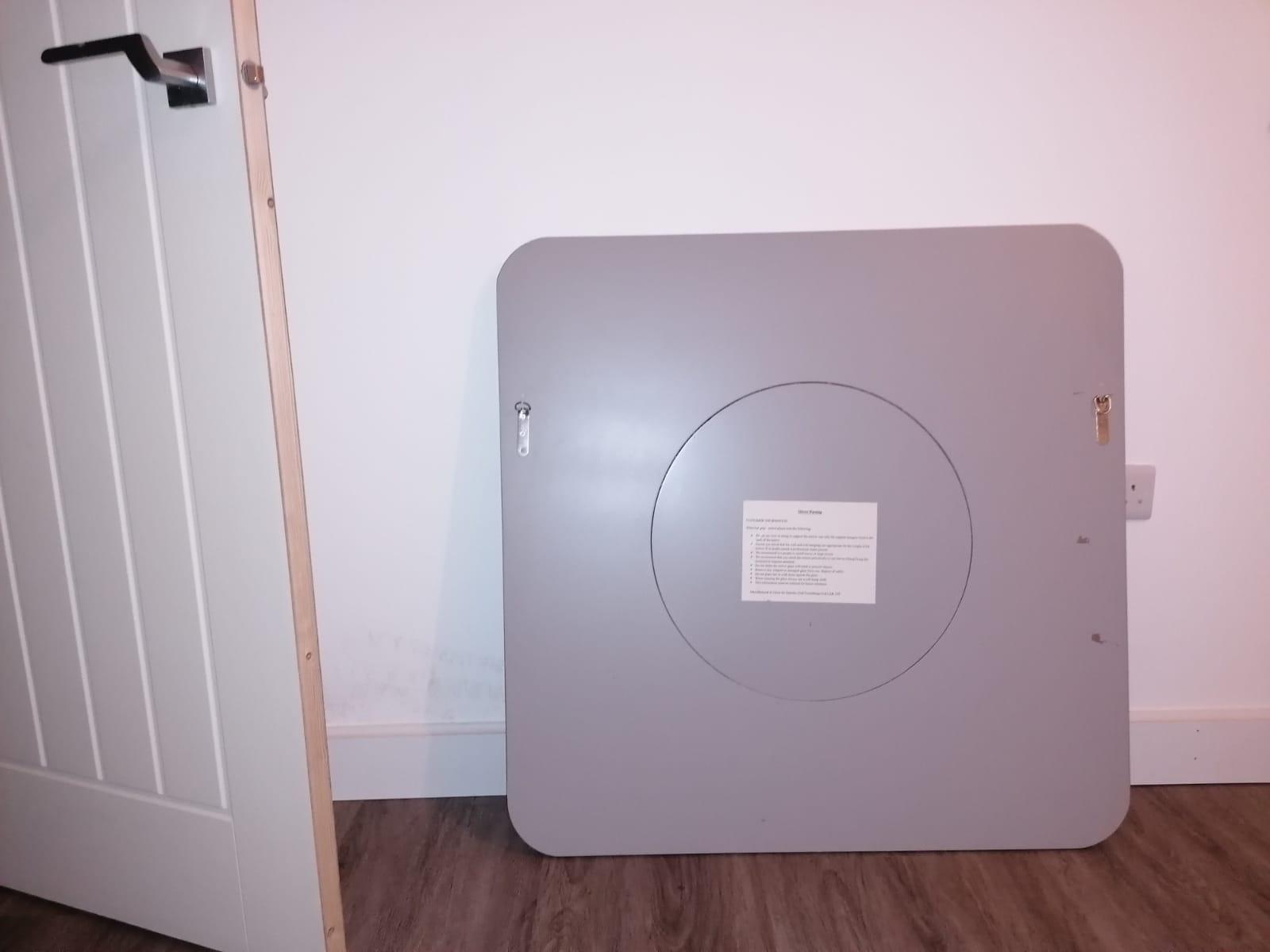

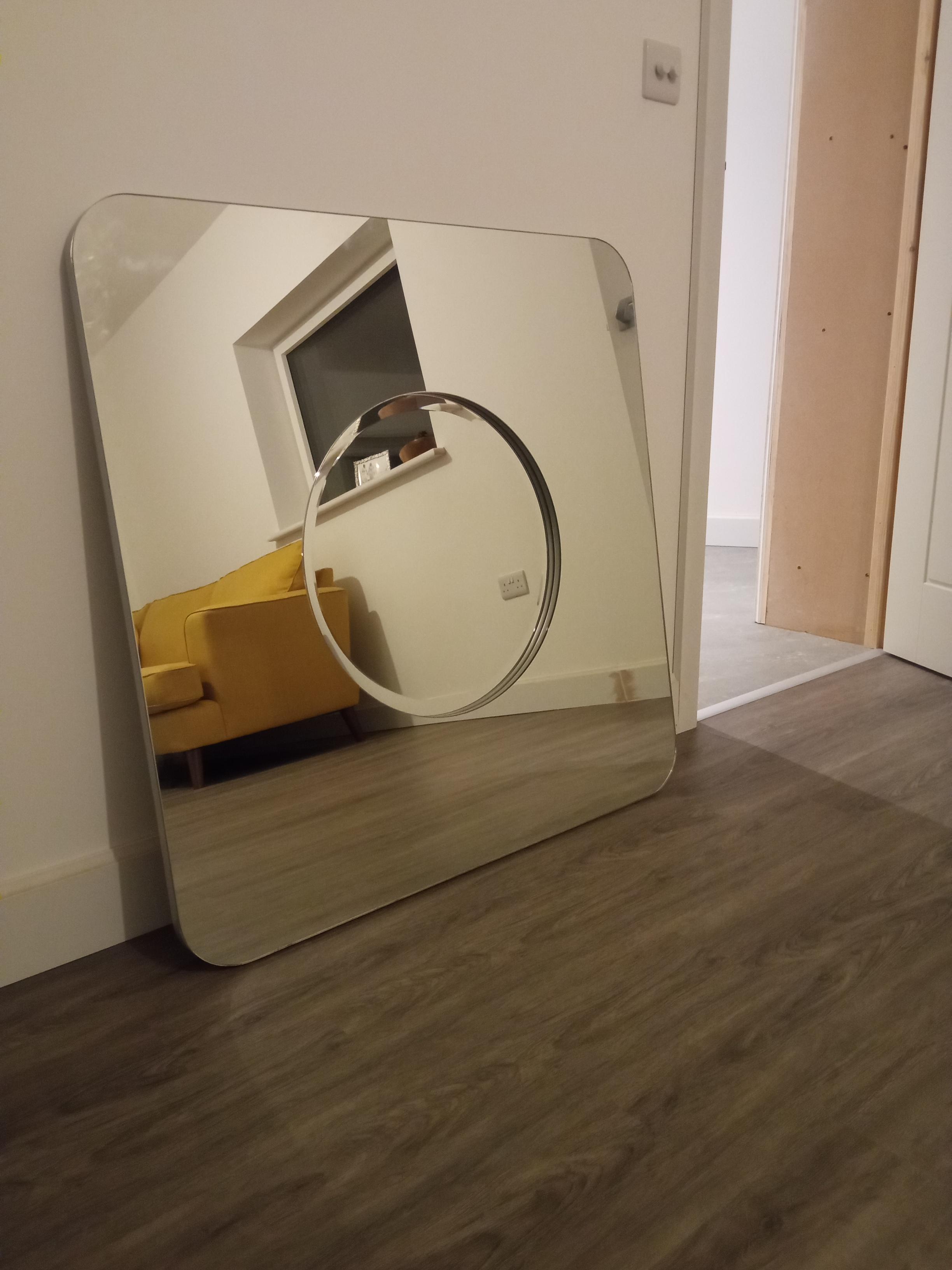

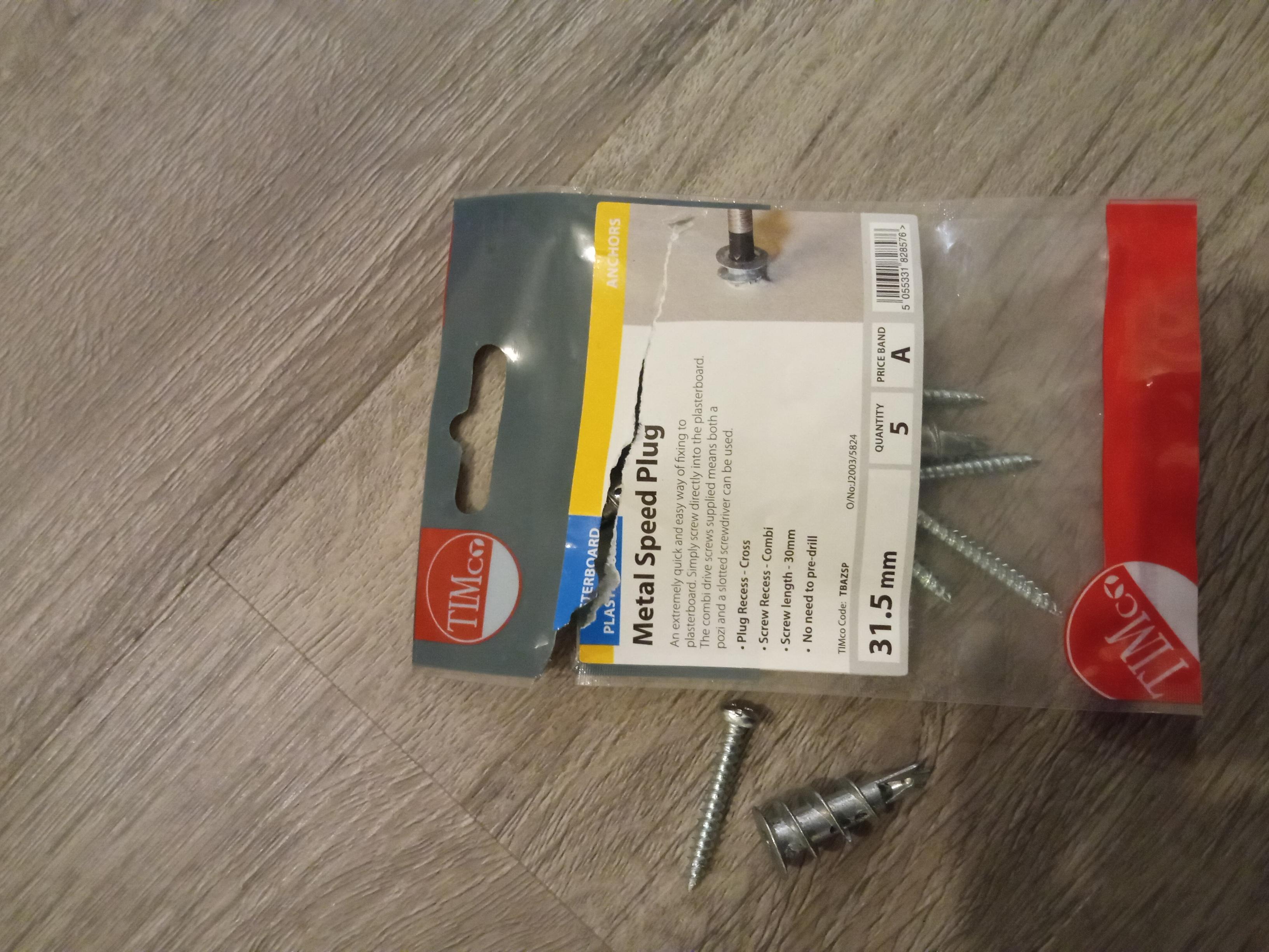

canalsiderenovation Posted December 30, 2020 Posted December 30, 2020 We have a large mirror that weighs about 9kg which we want to fix onto a wall which is plasterboard. Â Â In our last house we had it on a plasterboard wall and I know we used plugs that were metal and our walls were so thin you could have literally put your hand through it. Just been rummaging through some out bits and bobs and found these. Do you think they will be sufficient? Â Â

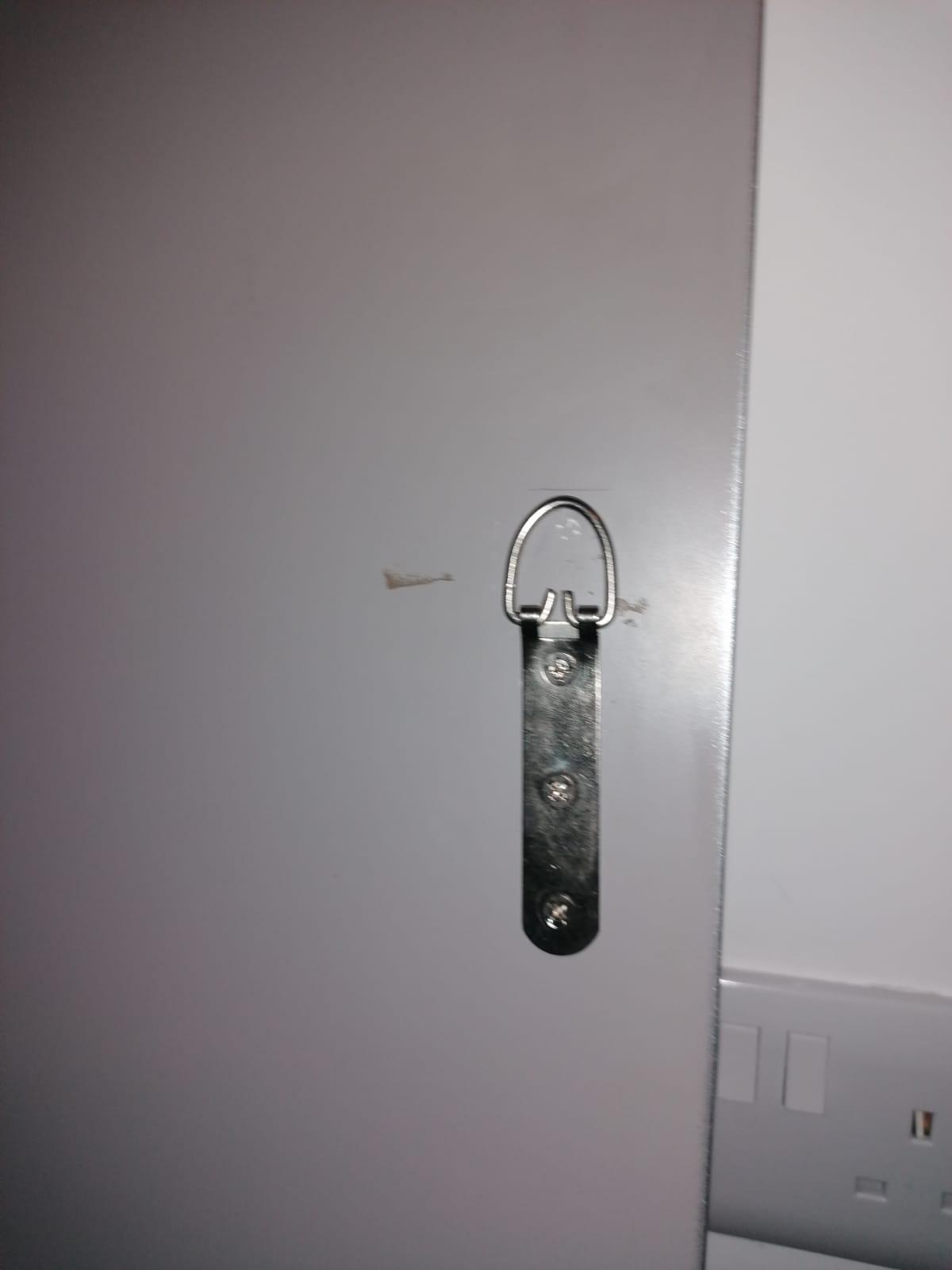

MikeGrahamT21 Posted December 30, 2020 Posted December 30, 2020 (edited) Howâs it fix? Single hanger, double hanger or fixing on each corner? Â similar ones at B&Q state max load 8kg per fixing Edited December 30, 2020 by MikeGrahamT21
canalsiderenovation Posted December 30, 2020 Author Posted December 30, 2020 3 minutes ago, MikeGrahamT21 said: Howâs it fix? Single hanger, double hanger or fixing on each corner?  similar ones at B&Q state max load 8kg per fixing  There are two of these either side. Â
joe90 Posted December 30, 2020 Posted December 30, 2020 I prefer these for plasterboard https://www.screwfix.com/p/easyfix-hollow-wall-anchors-8-16mm-m5-x-52mm-10-pack just make sure itâs not in a stud, but if it is then just use a wood screw ? 1
MikeGrahamT21 Posted December 30, 2020 Posted December 30, 2020 21 minutes ago, canalsiderenovation said: Â There are two of these either side. Â Should be OK in that case, will be 4.5kg per fixing 1
Onoff Posted December 30, 2020 Posted December 30, 2020 If using those metal "curly wurlys" I like to pilot first rather than drilling them straight into the board.

Declan52 Posted December 30, 2020 Posted December 30, 2020 String/chain between the loops on the mirror and screw straight into the 2 different studs.
Onoff Posted December 31, 2020 Posted December 31, 2020 1 hour ago, canalsiderenovation said: Â Pilot where exactly? In typical fashion SWMBO wants it on only one of two stud walls in the whole bungalow.... Â You might want to do a bit of a drawing with the existing wall area, the outline of the two mirrors and where the fixings will go. So on one wall you'll have four "X's". That's where you drill your holes for whatever fixings. Â GRIPITS are another option.Â

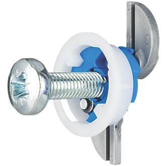

joe90 Posted December 31, 2020 Posted December 31, 2020 (edited) After using nearly all types on offer over the years I still say the hollow wall anchors I posted above are the best, gives you four metal lugs that act as a rivet to the plasterboard that gives a permanent threaded fixing.  gives an example of how they work https://www.theartofdoingstuff.com/the-only-drywall-anchor-you-should-ever-use/ Edited December 31, 2020 by joe90
Nickfromwales Posted December 31, 2020 Posted December 31, 2020 Click and collect today.  https://www.screwfix.com/p/gripit-plasterboard-fixing-25-x-14mm-8-pack/682GK?tc=ET2&ds_kid=92700048793290424&ds_rl=1249413&gclid=CjwKCAiAirb_BRBNEiwALHlnD8I-BBfC7hs_wBI21bKybD1MPEd4UTd3C-6aaCs3zAID7D1cfg6CQRoC5zwQAvD_BwE&gclsrc=aw.ds
Onoff Posted December 31, 2020 Posted December 31, 2020 21 minutes ago, joe90 said: After using nearly all types on offer over the years I still say the hollow wall anchors I posted above are the best, gives you four metal lugs that act as a rivet to the plasterboard that gives a permanent threaded fixing.  gives an example of how they work https://www.theartofdoingstuff.com/the-only-drywall-anchor-you-should-ever-use/  The threaded insert I think is preferable to the curly wurly type where the coarse screw that comes with it has to bite into the fixing and cut its own thread. OK maybe the first time it's used but subsequent unscrewing can undo the fixing too and the pb around it crumbles. I as I say very carefully drill a pilot for them and try not to break out at the back (hence the gentle drilling). I've also "reinforced" the drilled hole with a good slug of PVA on the curly wurly and around the drilled hole. Your "butterfly" type go some way to mitigating a hole that's broken out at the back of the pb.

Onoff Posted December 31, 2020 Posted December 31, 2020 2 minutes ago, Nickfromwales said: Click and collect today.  https://www.screwfix.com/p/gripit-plasterboard-fixing-25-x-14mm-8-pack/682GK?tc=ET2&ds_kid=92700048793290424&ds_rl=1249413&gclid=CjwKCAiAirb_BRBNEiwALHlnD8I-BBfC7hs_wBI21bKybD1MPEd4UTd3C-6aaCs3zAID7D1cfg6CQRoC5zwQAvD_BwE&gclsrc=aw.ds  Don't forget the 25mm flat wood bit. (Though I'd use a 25mm holesaw). 1
MikeGrahamT21 Posted December 31, 2020 Posted December 31, 2020 Don't forget this is only for a mirror, since @canalsiderenovation has already got those fixings and they will work just fine, may as well use them surely?
Nickfromwales Posted December 31, 2020 Posted December 31, 2020 Just now, MikeGrahamT21 said: Don't forget this is only for a mirror, since @canalsiderenovation has already got those fixings and they will work just fine, may as well use them surely? Absolutely not. They work themselves loose, and the mirror will be moved a bit during each wipe down / polish. Itâs a bathroom, not a corridor, so cleaning will be much more frequent / vigorous  Â
ProDave Posted December 31, 2020 Posted December 31, 2020 3 minutes ago, Nickfromwales said: Absolutely not. They work themselves loose, and the mirror will be moved a bit during each wipe down / polish. Itâs a bathroom, not a corridor, so cleaning will be much more frequent / vigorous   I make a 5mm pilot hole. It is a lot cleaner than letting the built in cutter make it's own hole. They then screw in nicely. Half way in, a good smear of your preferred "sticks like...." or similar adhesive before driving them home, will ensure they don't accidentally unscrew.  Some of the self cutting screws can be very tight the first time, I have known in old knackered pb for it to strip the fitting out when cutting the thread, so now I drive the screw in to cut it's thread for the first time before I screw the fitting into the wall.
