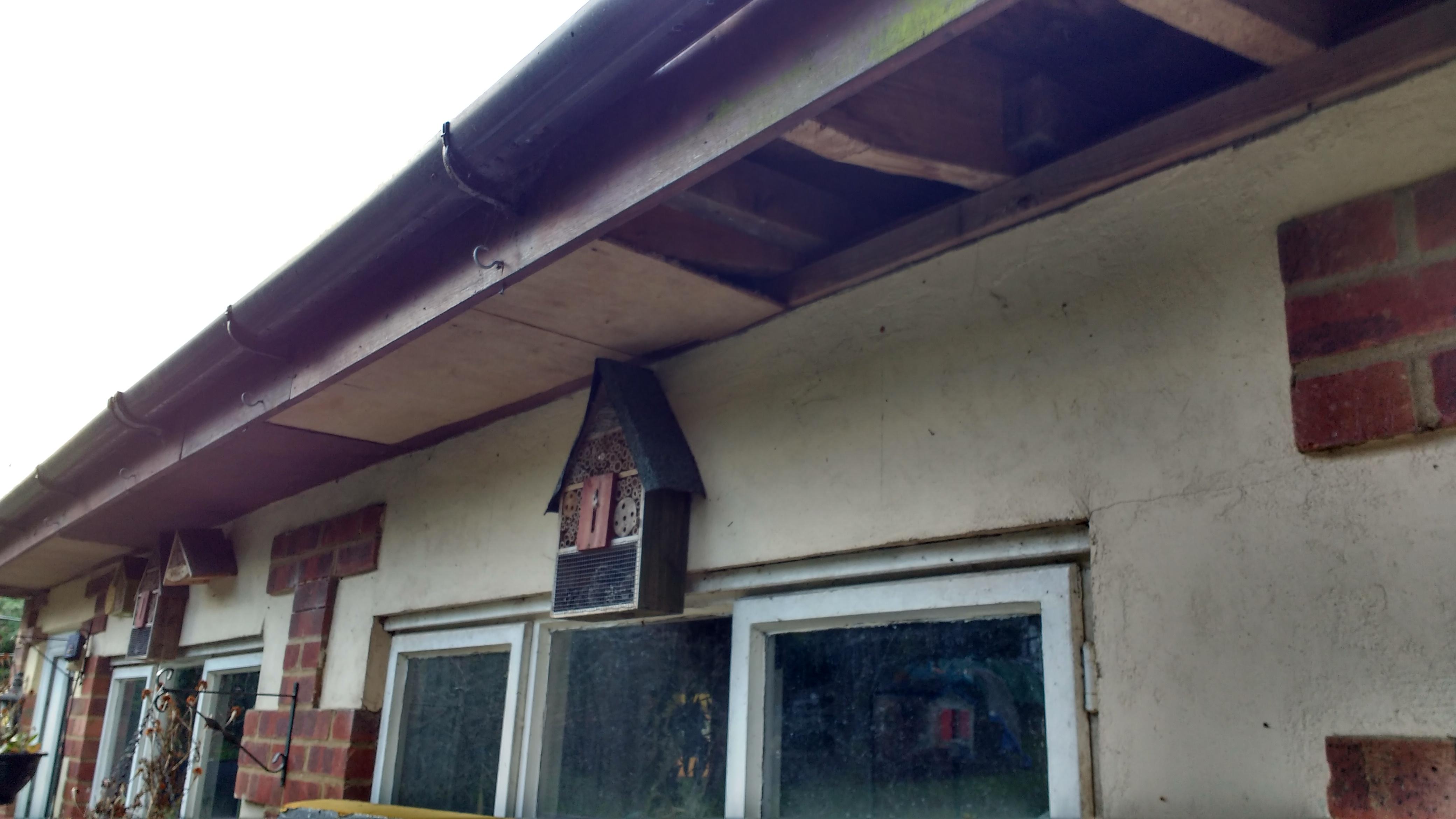

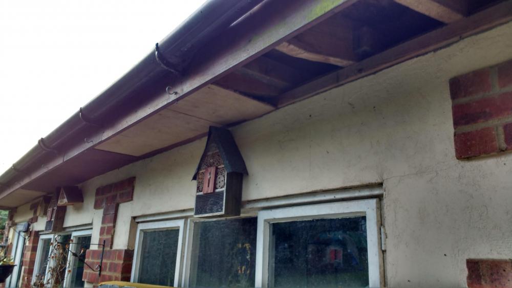

Onoff Posted December 27, 2020 Posted December 27, 2020 What's the ideal overhang distance for a soffit like this? Shallow, tiled roof above. Thinking to redo in uPVC. If it's say 300mm I'll trim all the roof joist ends down. They're a bit in and out anyway.
PeterW Posted December 27, 2020 Posted December 27, 2020 200mm is fine - can go to 150mm if you want to. Just may end up with a shorter fascia. 1
tonyshouse Posted December 27, 2020 Posted December 27, 2020 Taller fascia if cutting back the existing and keeping the soffit in the same place.

Onoff Posted December 27, 2020 Author Posted December 27, 2020 24 minutes ago, Russell griffiths said: Am I missing something if you reduce the soffit size, will you not have to change the roof above ?? Tbh the tile projection over the gutter varies a bit and could do with equalling up along its length. I'll fire the laser along to get a line and see what the minimum is. Might aim for a 300mm wide soffit as that's off the shelf.

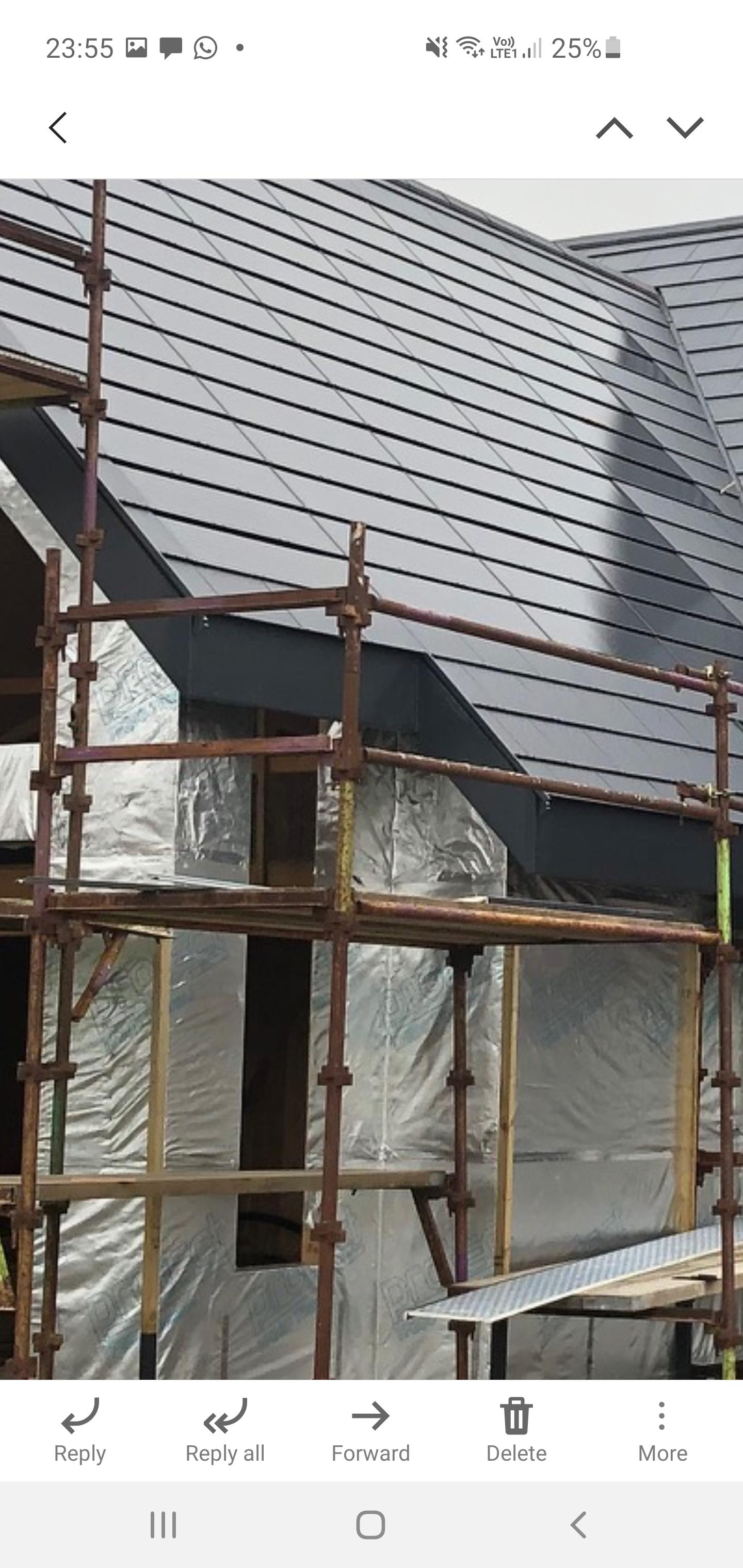

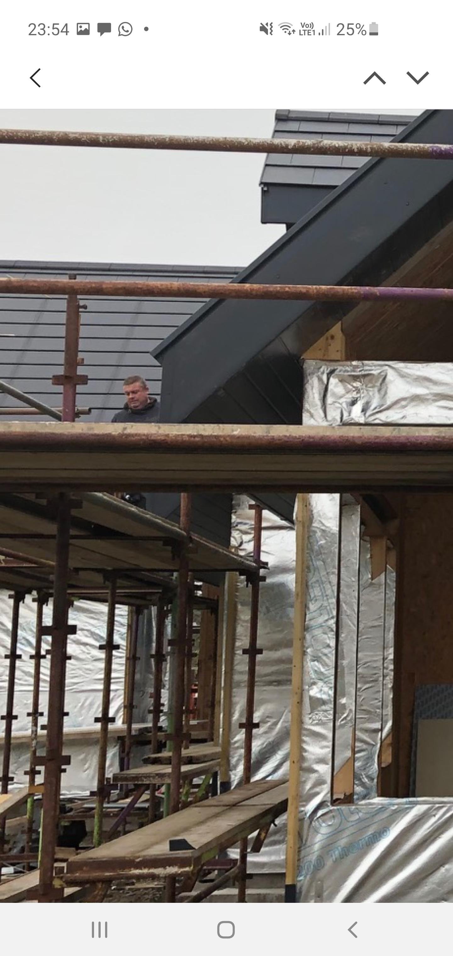

SuperJohnG Posted December 27, 2020 Posted December 27, 2020 I've got 300mm stated on my drawings from architect. Also he's got a note saying boot ends are not allowed.

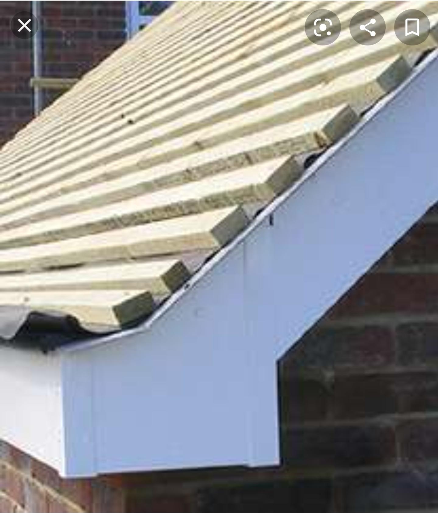

Onoff Posted December 27, 2020 Author Posted December 27, 2020 1 minute ago, SuperJohnG said: I've got 300mm stated on my drawings from architect. Also he's got a note saying boot ends are not allowed. What's a boot end?
SuperJohnG Posted December 27, 2020 Posted December 27, 2020 3 minutes ago, Onoff said: What's a boot end? This. 1
SuperJohnG Posted December 27, 2020 Posted December 27, 2020 My architect likes this...apparently a nicer detail. I've yet to figure out how I get lights in the soffit.
Alexphd1 Posted December 28, 2020 Posted December 28, 2020 Are you redoing the roof? What look/style do you want to achieve? I don't think there is a ideal soffit size, but more down to personal taste. For me I like big soffits and flat on the horizontal run but I also hate boot ends (never heard them called that before). My architect originally drew no soffits and skews which protrude above the slate at the gables, these got changed to make build simpler.

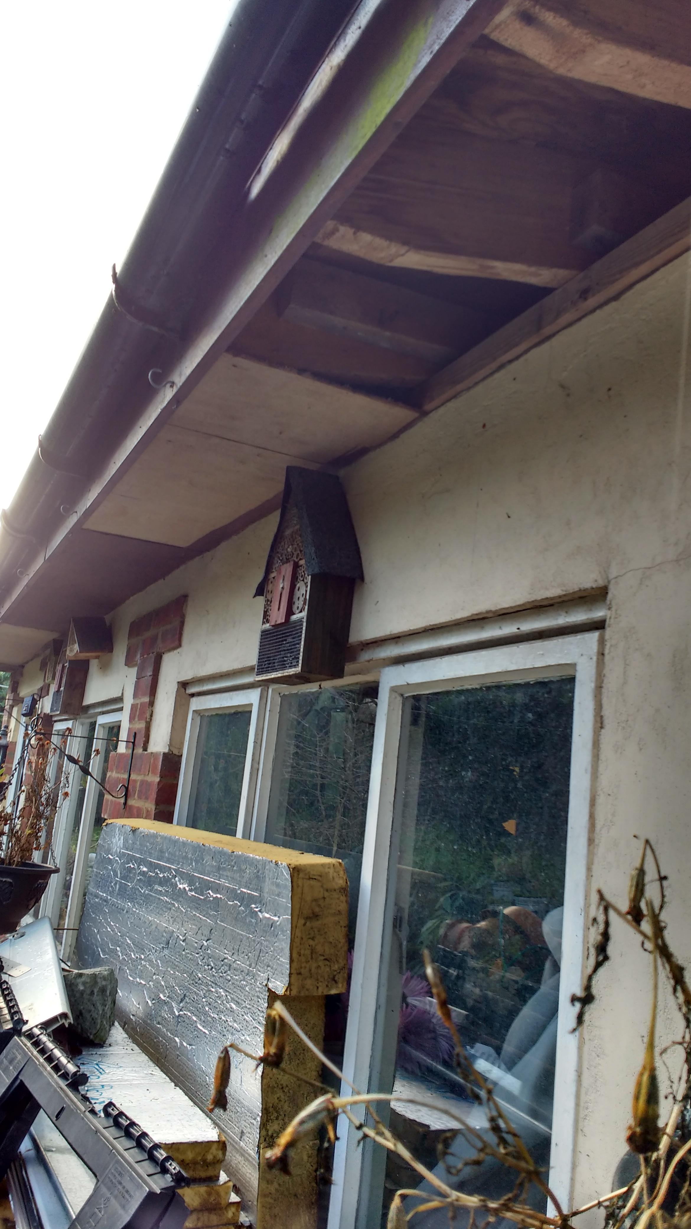

Onoff Posted December 28, 2020 Author Posted December 28, 2020 10 hours ago, Alexphd1 said: Are you redoing the roof? No. All the soffits and fascias need redoing. Rotting in parts tbh. Been putting it off as I want to change the roof but that isn't going to happen anytime soon so I'd best get on it in good old basic, (cheap), white uPVC. Working backwards tbh, all the felt edges are shot and need eaves protectors adding at least.
joe90 Posted December 28, 2020 Posted December 28, 2020 13 minutes ago, Onoff said: Working backwards tbh, all the felt edges are shot and need eaves protectors adding at least. I have done a Lot of those in the past, rip off facia, soffit etc and a few rows of tiles and battens, straighten the joist ends a little, tuck in eave protectors, new facia and soffit, replace battens, tiles and guttering, simples ?.
