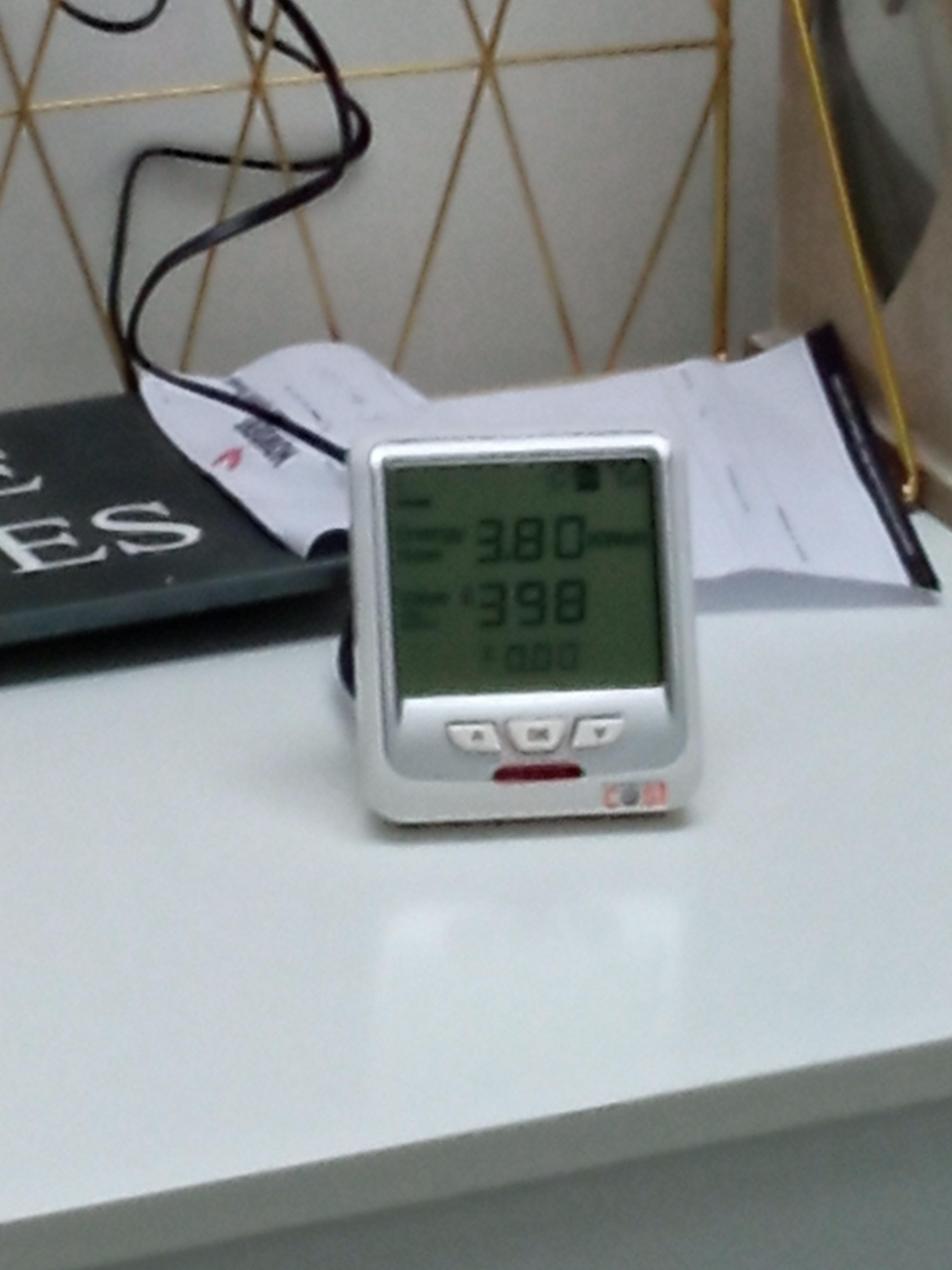

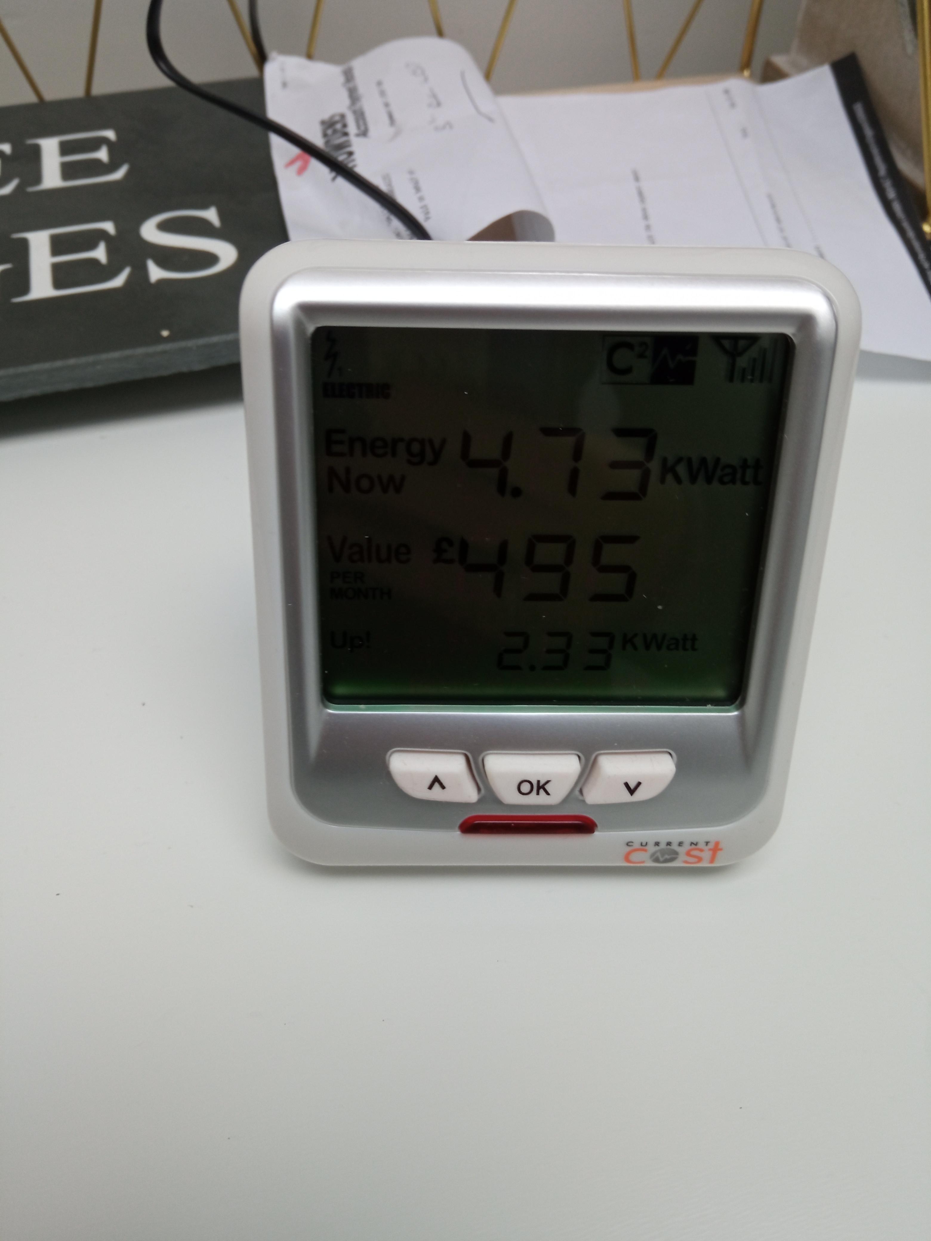

Hmmmm this is going to be a trial and error. Now I know this I'll wait til it goes up again and see what else I can turn off. Wife is in the garage so let me check she didn't have something on up there.
Link to comment
Share on other sites
43 minutes ago, canalsiderenovation said:
Sat in house nothing extra plugged in since I  said it was fairly static at 800-900w and then this...
That jump you are seeing is about the same as a 2 kW heater.
What things do you have in the house that can draw that much energy i.e. kettle, cooker, oven, vacuum cleaner, fan heater (friend of mine left one on in his loft for months).
It is also about the same as your HP draws.

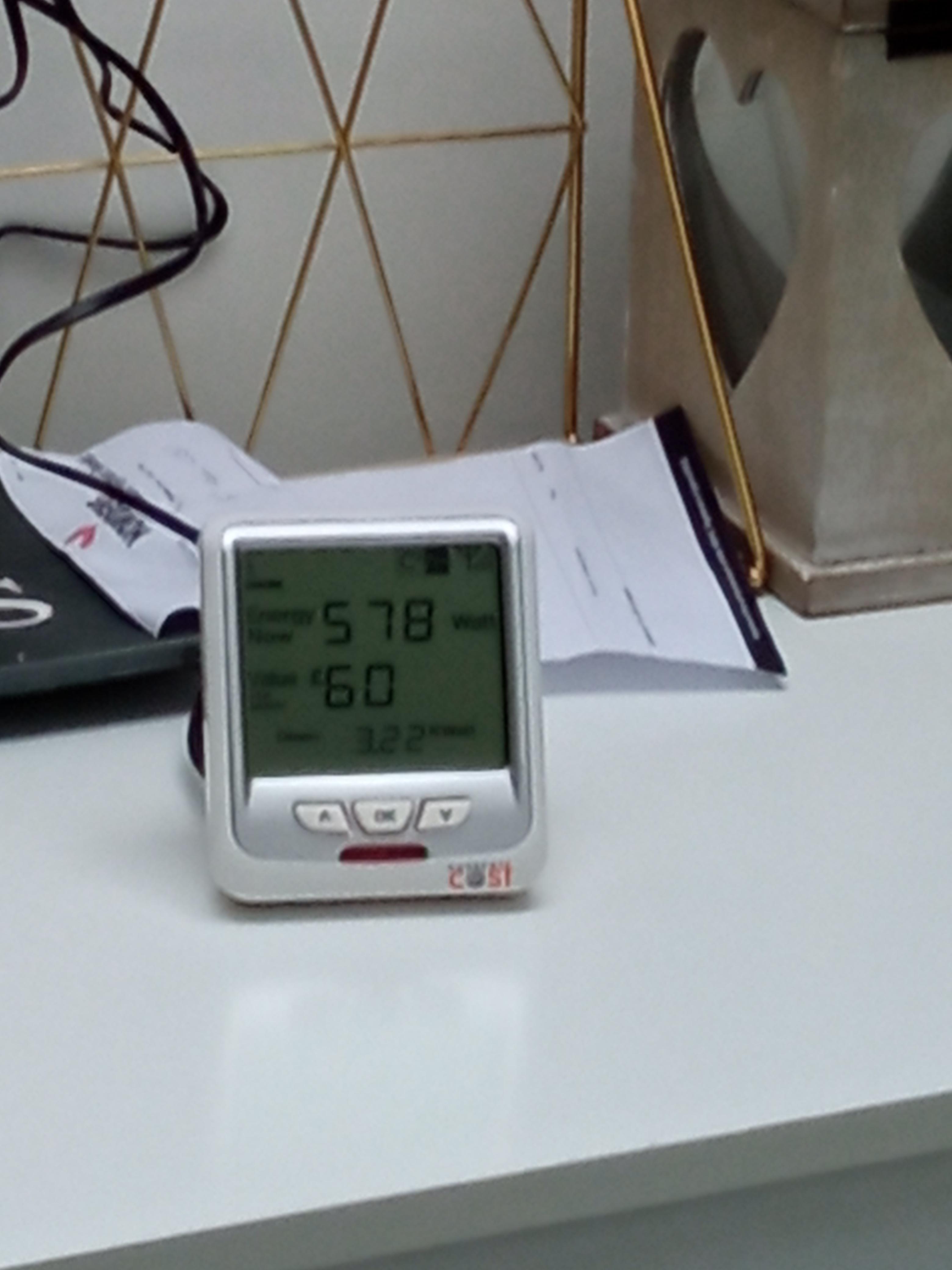

Ovens/coffee machine are off are on standby, where the clock is on but nothing else. Then there is just the fridge and freezer and router and sewage treatment plant but they are all things that are normally on. No lights on. The only thing we don't normally have on is the slow cooker for tea. We turn everything else off at the plugs like TVs, microwave etc. We currently have nothing charging. There is nothing  else I can think of!
I just caught a spike.
Turned off heat pump.

If it's only a few seconds I wouldn't worry about it. When electric motors (such as those in ASHP compressors) start up or change speed they need a brief spike of additional power to do so, meaning you should see the spikes corresponding with the unit starting to provide heat or changing power levels. The energy consumed by these spikes is trivial - you're billed on (power consumption) x (time), so the energy bill you're getting will be driven by the steady state ~500W (12 kWh/day) rather than the odd spike of a few seconds.
