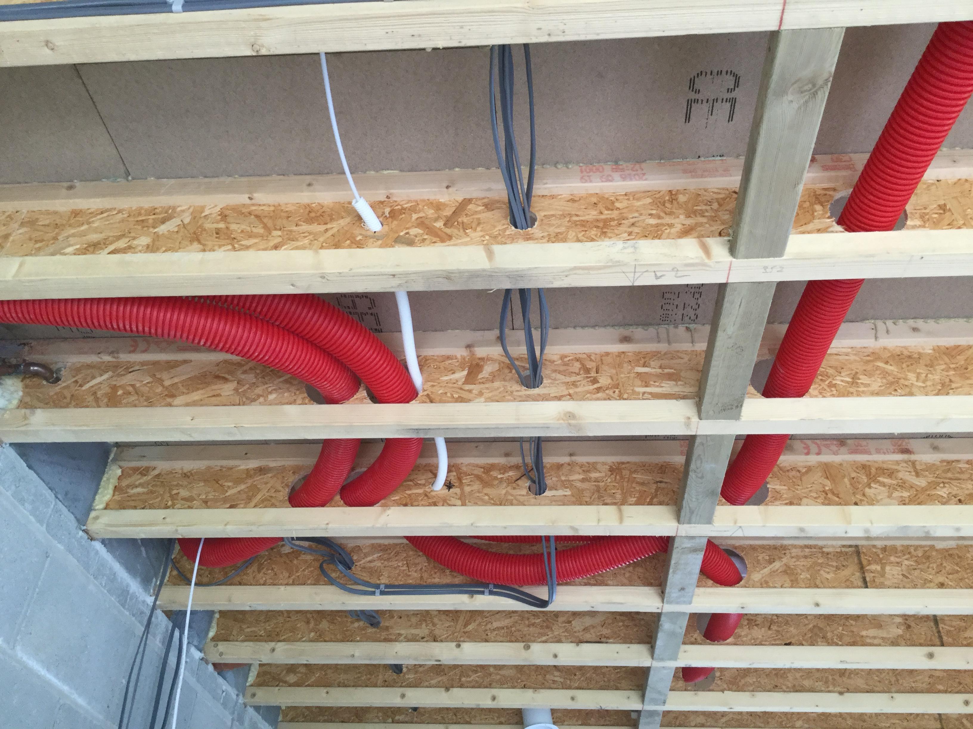

On 19/01/2021 at 23:51, Adsibob said:
Just to make things more confusing, I’m in discussion with a MVHR company that are recommending “semi rigid radial ducting”.
Bin them....!!
No issue so long as it's specced correctly. They are easy to DIY and eliminate cross talk.
Just avoid this style of flexible ducting.
Thanks @Iceverge. Just to clarify, are you saying avoid the example pictured in white, but go for the example pictured in blue, or avoid both?
Avoid the white one.
The blue one is fine but beware of the low flow rates of smaller sizes.  (Noise)
In essence a duct should be non collapsible.
This includes the ducts on the intake exhaust (Outside) side of the MVHR.
Can you get & use 90 degree bends for the blue ducts for say when it is running in the first floor zone and needs to turn to go vertically?
You can just bend it to 90 degrees within the joist depth, no need for joints.  Best to try and avoid too many sharp bends though.
Yes you can, and if needed you can also get a flatter version if there isn’t room for the round.
The more 90 degree bends the more the flow is restricted though.
Great thanks ?
Ok cheers there won’t be many ?

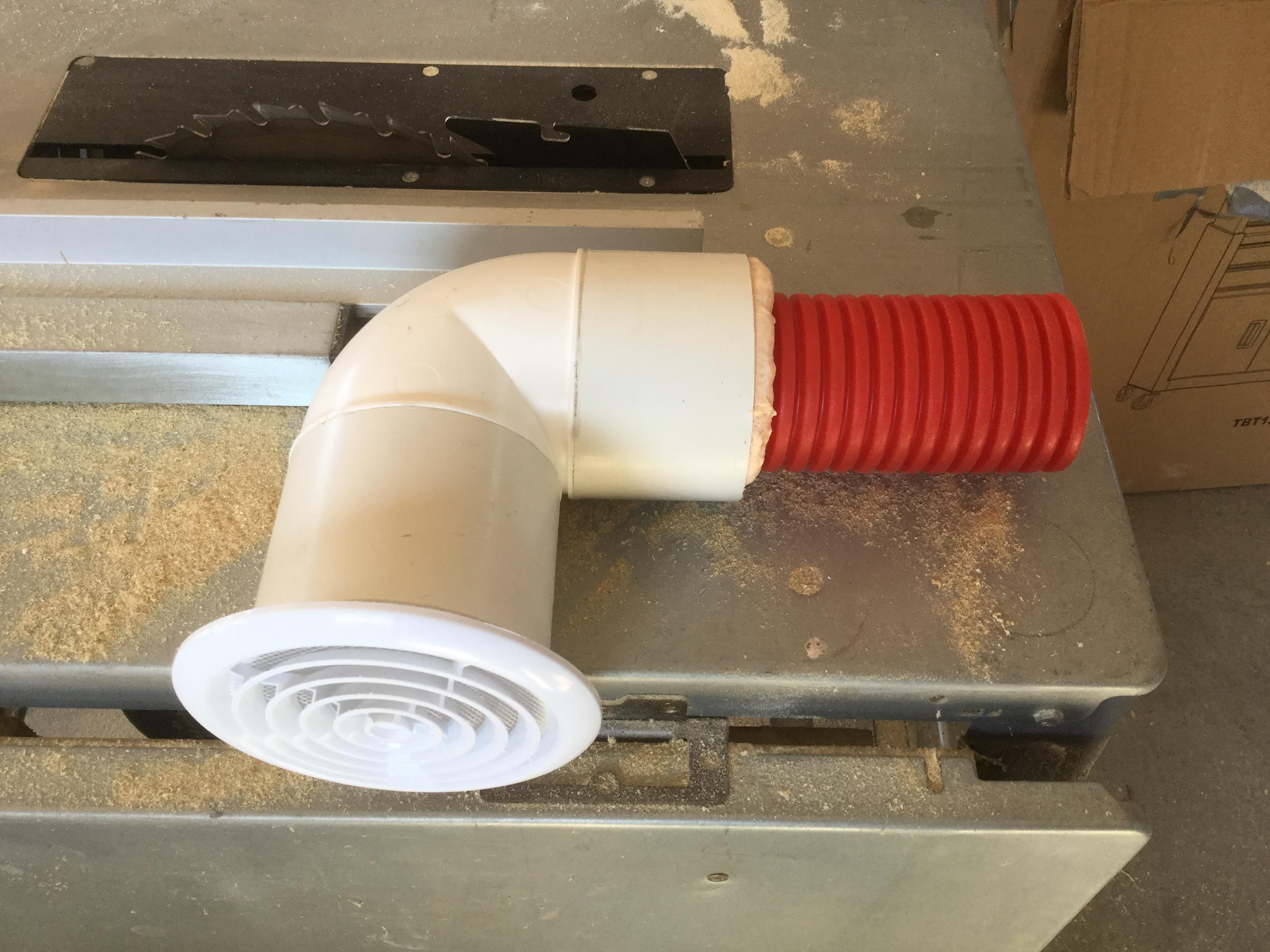

The problem with both the blue and white versions is that the “ribbed” structure creates turbulence within the air-flow which results in increased noise problems and a higher power consumption to move the volume of air you need to achieve satisfactory ventilation + both of those problems will be compounded if the pipes have a smaller bore. The other longer term issue is that the ribbing tends to result in the accumulation of dust/debris within the pipes increasing the risk of mould/bacterial growth. Basically the smoother the internal surface of your ducting the better. The only advantages I can see for flexible ductwork are ease of installation, which I think is only marginal in reality, and a price differential, which is probably also marginal when weighed against the whole system and long term running/maintenance costs.
With my DIY installed MVHR I used a red version of the blue stuff posted earlier. The internal bore is smooth and sooo much easier to instal compared to large diameter metal. Sweeping bends create much less resistance than 90’ bends. The air speed is so slow that noise is not an issue with mine. I created my own terminals, manifold/silencer and it all works great.
 The semi-rigid ducts are smooth-bore.
